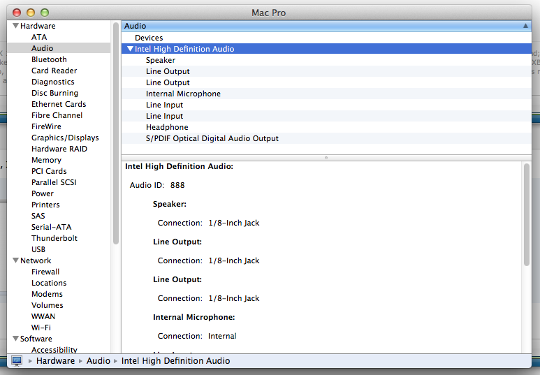

nemof2010 Posted July 31, 2012 Author Share Posted July 31, 2012 alright, i still dont have sound but it shows up in system profile, but not under options   idk i called avga to make sure i had the right audio chip they told me the alc889 but everest tells me the alc888 Link to comment Share on other sites More sharing options...

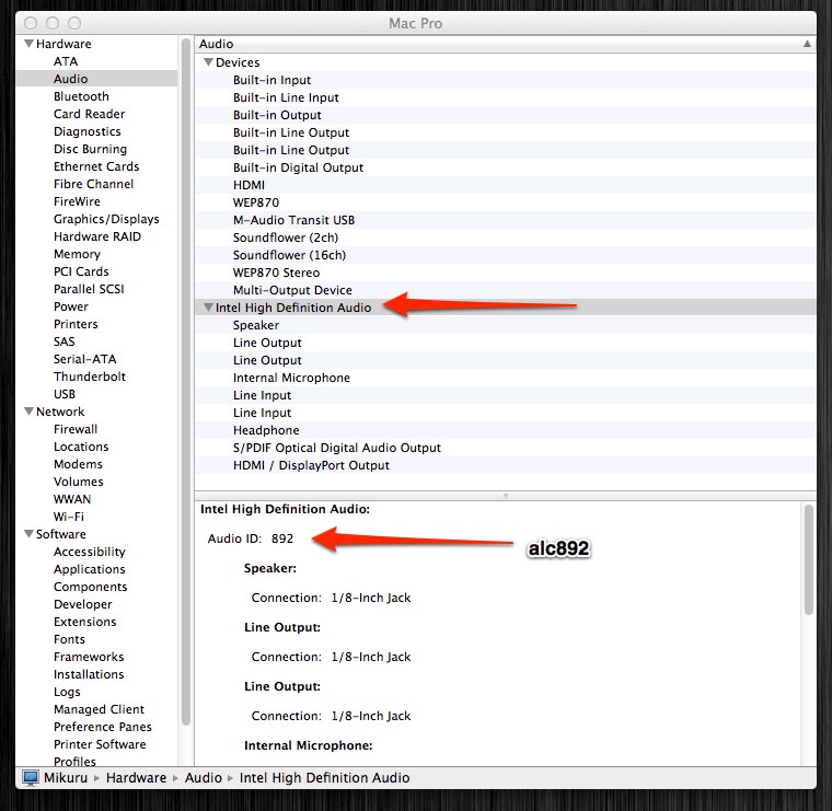

eep357 Posted July 31, 2012 Share Posted July 31, 2012 check Sytem info in Lion. This is mine, alc892 Â Â here is optional 889 DSDT config along with DSDT for ALC888 and appleHDA for alc888 DSDT&HDA888.zip Link to comment Share on other sites More sharing options...

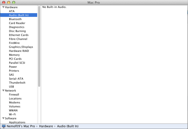

nemof2010 Posted July 31, 2012 Author Share Posted July 31, 2012 is there a special way to install the dsdt because ive just been deleting it out my extra folder and putting ia new one in, and ive tried both alc888 and alc889 files you gave still nothing just system profile changes  this is my system profile under ML Link to comment Share on other sites More sharing options...
eep357 Posted July 31, 2012 Share Posted July 31, 2012 have you installed the corresponding appleHDA.kext using Kext Wizard? Also after installing, use kext Wizards repair permissions and rebuild kernel cache options, then reboot. DSDT install is right though  first appleHDA I posted was for 889, 2nd one was for 888  and Voodoo must be removed first  kext wizard available here http://dl.dropbox.co...d/download.html Link to comment Share on other sites More sharing options...

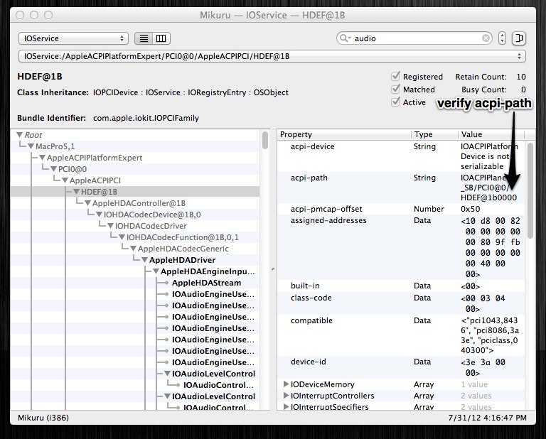

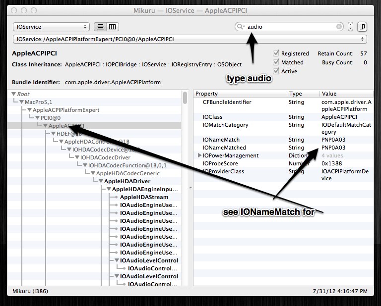

eep357 Posted July 31, 2012 Share Posted July 31, 2012 In lion with audio working however that may be.. run ioreg, if you don't have it, it's free from apple, just google it.   and  Link to comment Share on other sites More sharing options...

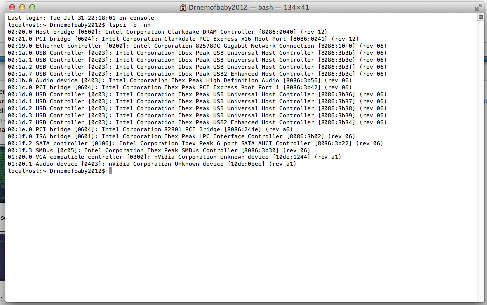

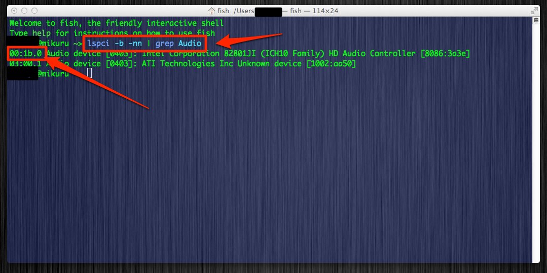

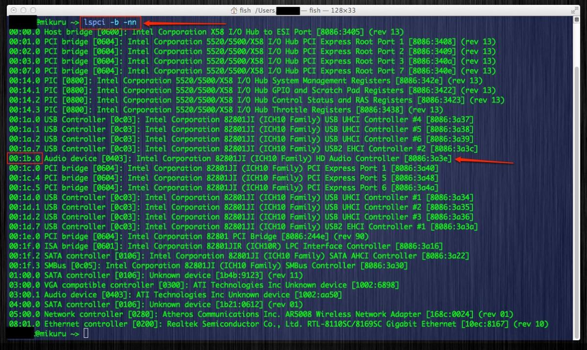

eep357 Posted August 1, 2012 Share Posted August 1, 2012 OK, having some browser problems, let me try that again.... Trying to verify that your audio is located at the usual hardware address, lspci will show all the devices on your PCI bus which includes your audio. Download lspci, http://www.mediafire...qtsqxaz3nux6gsj install it and restart. Then from terminal the typically used command would be: lspci -nn We're going to use: lspci -b -nn this will show the true hardware address of the devices and not just what OSX sees. So here's and example of what is needed:   here, we can refine our search results with the power of grep   The 00:1b.0 seen there, would be 0x001B0000 in DSDT like this: Device (HDEF) { Name (_ADR, 0x001B0000) Method (_DSM, 4, NotSerialized) { Store (Package (0x04) { "layout-id", Buffer (0x04) { 0x79, 0x03, 0x00, 0x00 }, "PinConfigurations", Buffer (Zero) {} }, Local0) DTGP (Arg0, Arg1, Arg2, Arg3, RefOf (Local0)) Return (Local0) } } }  And is the address I used in yours as it is usually at that address, but since that address was completely absent from your DSDT, would be best to double check. Link to comment Share on other sites More sharing options...
nemof2010 Posted August 1, 2012 Author Share Posted August 1, 2012 I believe i did it correctly heres the screenshot, and thank you so much for all your help Link to comment Share on other sites More sharing options...
