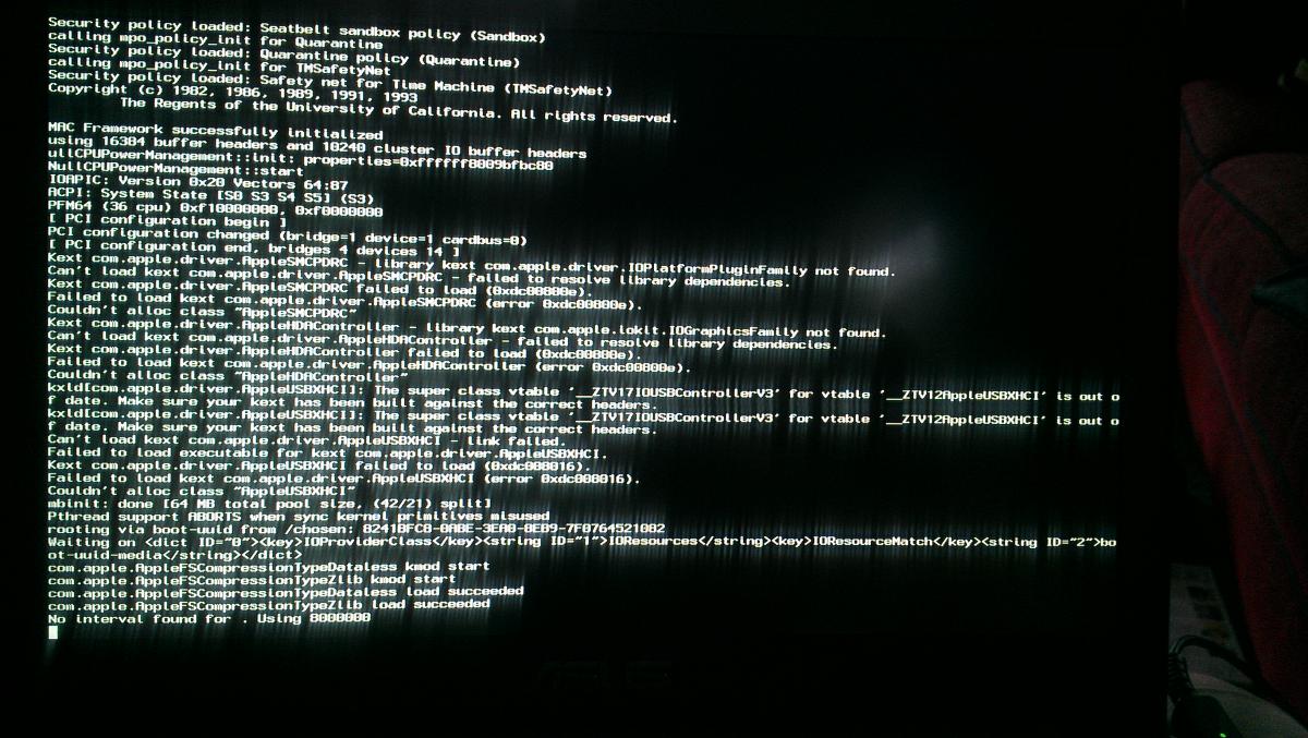

fbrozovic Posted July 29, 2012 Share Posted July 29, 2012 Hi guys, I have created an USB drive with the ML GM Image on it which I now want to use to install OSX on my ultrabook, an Asus UX32VD. However, I am running into a problem - whenever I try to boot the installer, it hangs at "com.apple.AppleFSCompressionTypeZlib load succeeded" (see the attached picture, the machine was booted with -v cpus=1). I have also tried other args in various combinations such as USBBusFix, setting PCIRootUID to 0 or 1 and disabling GraphicsEnabler, to no avail. The boot volume apparently also isn't recognized, but there are no "Still waiting for root device" messages, which leads me to believe that something else is the problem. The machine only has USB3 ports (w/ Intel controller whose pci class id matches the one in the Apple kext, 0x0c0330, so I don't think that is the problem). I have also tried using a fixed DSDT which I made, and that didn't solve the problem either. Anybody have any ideas as to why this machine isn't booting? I'll make sure to write up a How-To if I get OSX running on this model. Thanks in advance EDIT: Sorry, I was in a hurry when writing this post yesterday and didn't notice that the image wasn't uploaded, so here it is: http://imageshack.us/photo/my-images/339/20120729195857.jpg/ Link to comment https://www.insanelymac.com/forum/topic/281201-booting-mountain-lion-on-an-asus-ux32vd/ Share on other sites More sharing options...

zenlion Posted August 2, 2012 Share Posted August 2, 2012 Ive got mountain lion running on my UX32VD. I also first thought it might be because of USB3 controller/stick, but its more because of the graphics and other stuff that it gets stuck i think, install boots ups fine with "-x" (and "unibe@ast" adds some KEXTs to /E/E on the USB Stick, I think those help). Here's what I did: 1) Create USB Install Stick of Mountain Lion GM with "unibe@ast" 1.4 (did this 2 weeks or so ago, now "unibe@ast" 1.5 is available, havnt tested that) 2) Installing on 32GB internal SSD, MBR partition layout so patched the USB Install Stick with OSInstall files 3) In order to boot the install I had to add safe boot, so -x on bootscreen, had to use external USB mouse as touchpad wasnt working (or working very badly) 4) After installation is finished I could not boot from mountain lion partition - get stuck like you guys, had to remove all KEXTs from /S/L/E that were related to bluetooth (2 I believe) and more importantly the ones for Gforce/Nvidia (about 5 of them), and also I had to copy some KEXTs from /E/E folder from the "unibe@ast" USB Stick to the mountain lion partition (it needs the NullCPUPowerManagent, FakeSMC and the 2 USB ones at the very least, otherwise im getting stuck on the bootup without -x), after this can boot without -x Issues: - HD4000 not working, installed Chimera 1.11 which is supposed to support HD4000, but still doesnt work, can get proper 1920x1080 resolution by adding GraphicsMode to boot.plist - Wifi not working, since its an Intel Centrino Wifi it will probably never work - probably other stuff, havnt really done anything with it since without working HD4000 (QE/CI) its pretty useless for me 1 Link to comment https://www.insanelymac.com/forum/topic/281201-booting-mountain-lion-on-an-asus-ux32vd/#findComment-1840046 Share on other sites More sharing options...

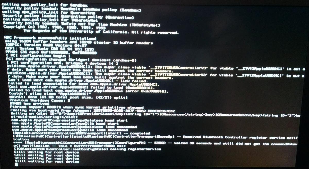

lbowuc Posted August 4, 2012 Share Posted August 4, 2012 boot with -v and post photo Hello, I am having the same problems as gsly. I have replaced the HDD with a Crucial M4 256GB. I just prepared a USB 2.0 flash drive with UB 1.4 and the ML app I downloaded from the App Store. When I boot with -v I get the following screen, I did take the picture before it went to the dreaded, "Still waiting for root device." That seems to be the message I have gotten the most often. Previously, I have tried about every boot flag known to man and downloaded a lot of kexts that have to do with USB and installed them onto S/L/E on the flash drive with KextWizard. I have also tried building my own installer and used UB 1.5 and myhack and none of them worked either. The only way I have gotten to the installer was if I write a boot image to the built-in SanDisk SSD and set the BIOS to boot from it. I want to install OSX to the SSD, so that doesn't really do much for me. Thanks for any help you can provide. Since I can boot to the installer from the SSD, it leads me to believe the problem is definitely related to the USB ports. Thanks for any help you can provide. Link to comment https://www.insanelymac.com/forum/topic/281201-booting-mountain-lion-on-an-asus-ux32vd/#findComment-1841217 Share on other sites More sharing options...

iFIRE Posted August 5, 2012 Share Posted August 5, 2012 Thanks. I tried -x, which I had tried before but forgot to mention, and I got the same message. So I grabbed a different flash drive and remade it again with UB 1.4 and ML. I followed zenlion's directions to the letter through #3 and got the same result. Here's another screenshot when I booted with -x -v. Any other ideas? I have been messing around with this for a few days and I am about out of ideas. try this :#30 Link to comment https://www.insanelymac.com/forum/topic/281201-booting-mountain-lion-on-an-asus-ux32vd/#findComment-1841455 Share on other sites More sharing options...
