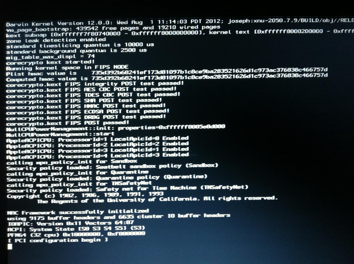

mtek Posted August 4, 2012 Share Posted August 4, 2012 Meanwhile I ventured using the patched ML kernel posted here to try to make my Asus 1201n (Atom N330 dual-core 64bit) install. The patched kernel worked fine with the ML installer and I was able to make the full installation on my 8GB pen USB partition without any issues. After that I copied the same patched kernel to the root of the final ML partition and it booted correctly up to a point where it stuck/stopped. This is my verbose screen output - any ideas/suggestions on what might have gone wrong? 1 Link to comment https://www.insanelymac.com/forum/topic/281072-thoughts-about-mountain-lion-with-atom-yes-atom/#findComment-1840971 Share on other sites More sharing options...
theconnactic Posted August 4, 2012 Author Share Posted August 4, 2012 I think you're almost there. Did i tel you that i experienced a lot of checksum errors when i tried to install it with pacifist? (with installer it was a no-go). What version did you use, retail or GM? Maybe my dmg is somehow corrupted. As for your question: boot with npci=0x2000 or npci=0x3000. I think is simple like that. Link to comment https://www.insanelymac.com/forum/topic/281072-thoughts-about-mountain-lion-with-atom-yes-atom/#findComment-1841062 Share on other sites More sharing options...
mtek Posted August 4, 2012 Share Posted August 4, 2012 I think you're almost there. Did i tel you that i experienced a lot of checksum errors when i tried to install it with pacifist? (with installer it was a no-go). What version did you use, retail or GM? Maybe my dmg is somehow corrupted. As for your question: boot with npci=0x2000 or npci=0x3000. I think is simple like that. Hi, I'm booting with npci=0x2000 already but for some weird reason had to boot ML (Retail) for the first time with -X flag. After that I rebooted and everything was just fine. So I've got my 1201n running with ML right now, but with some kext issues. Checkout this post: http://www.insanelymac.com/forum/index.php?showtopic=264740&st=540 Good luck! Link to comment https://www.insanelymac.com/forum/topic/281072-thoughts-about-mountain-lion-with-atom-yes-atom/#findComment-1841116 Share on other sites More sharing options...
