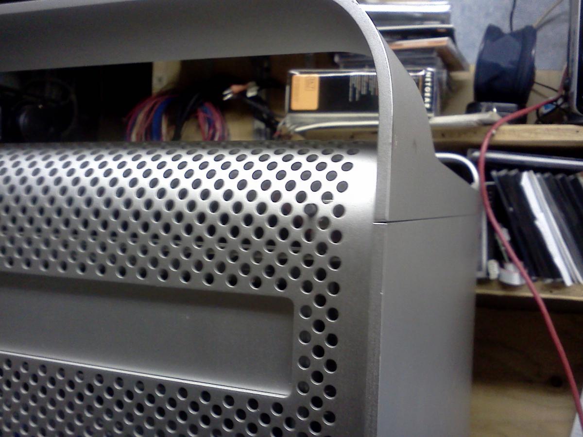

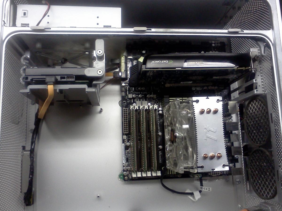

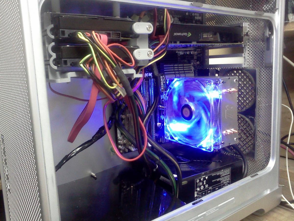

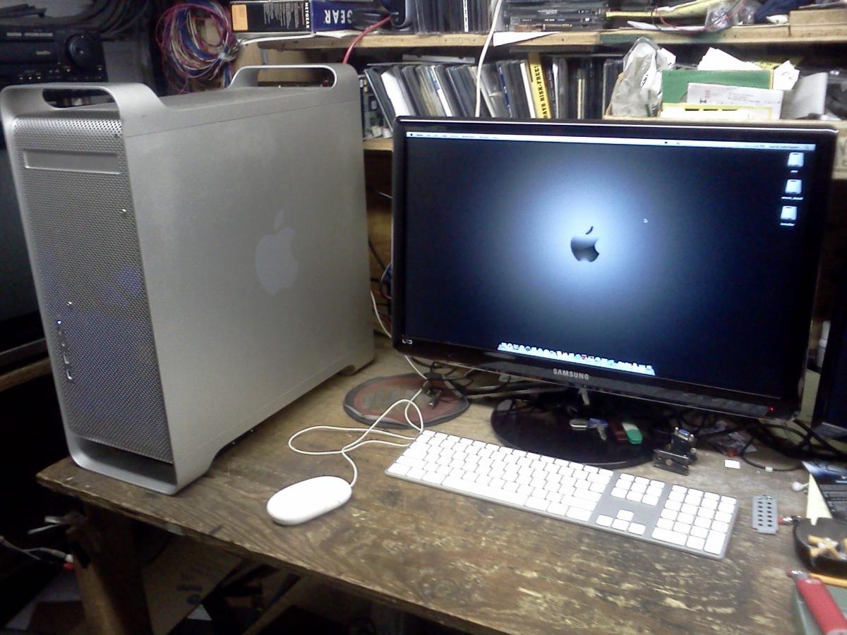

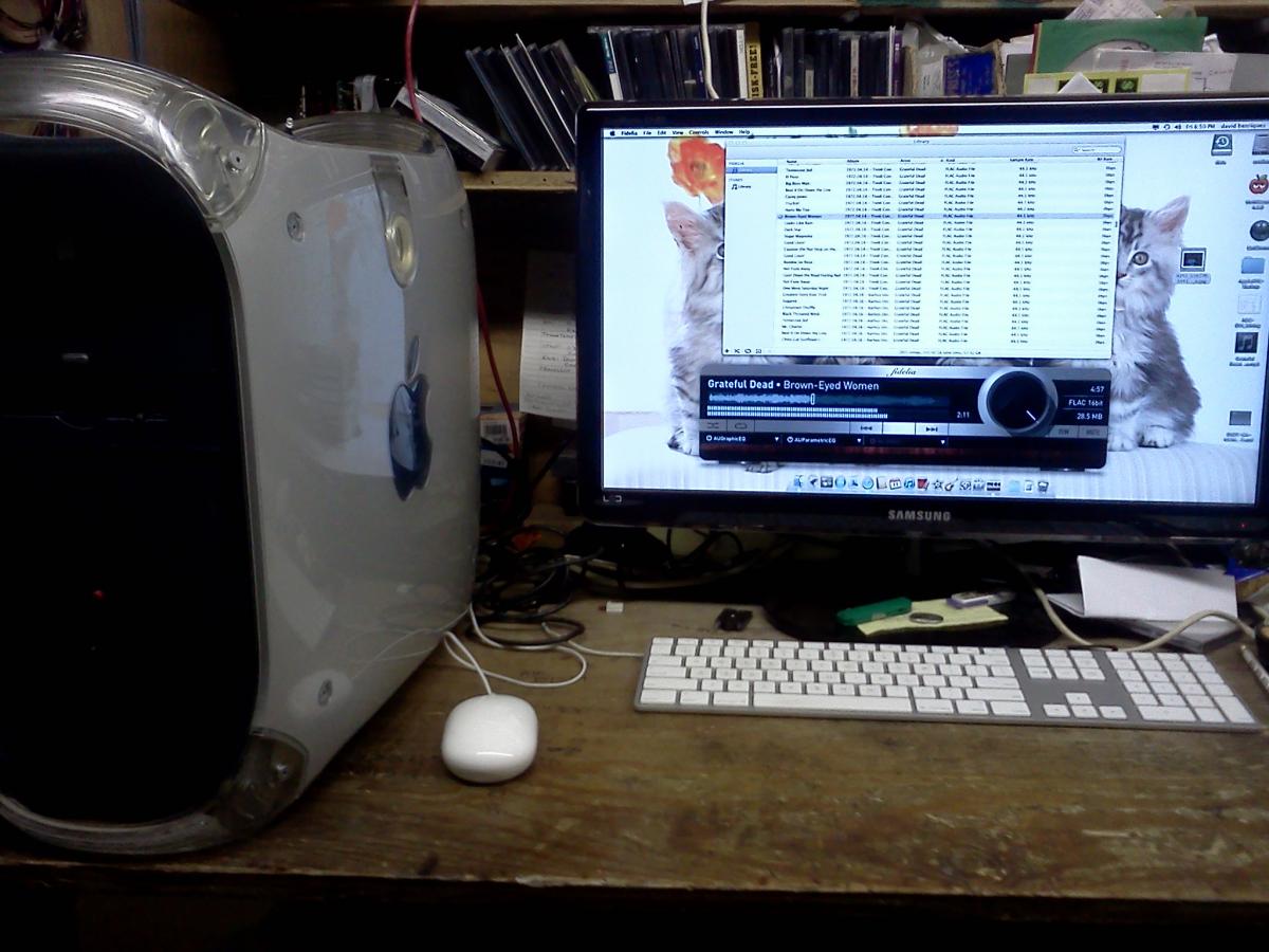

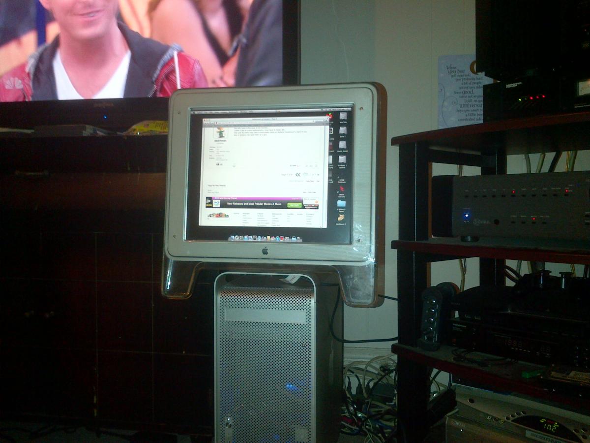

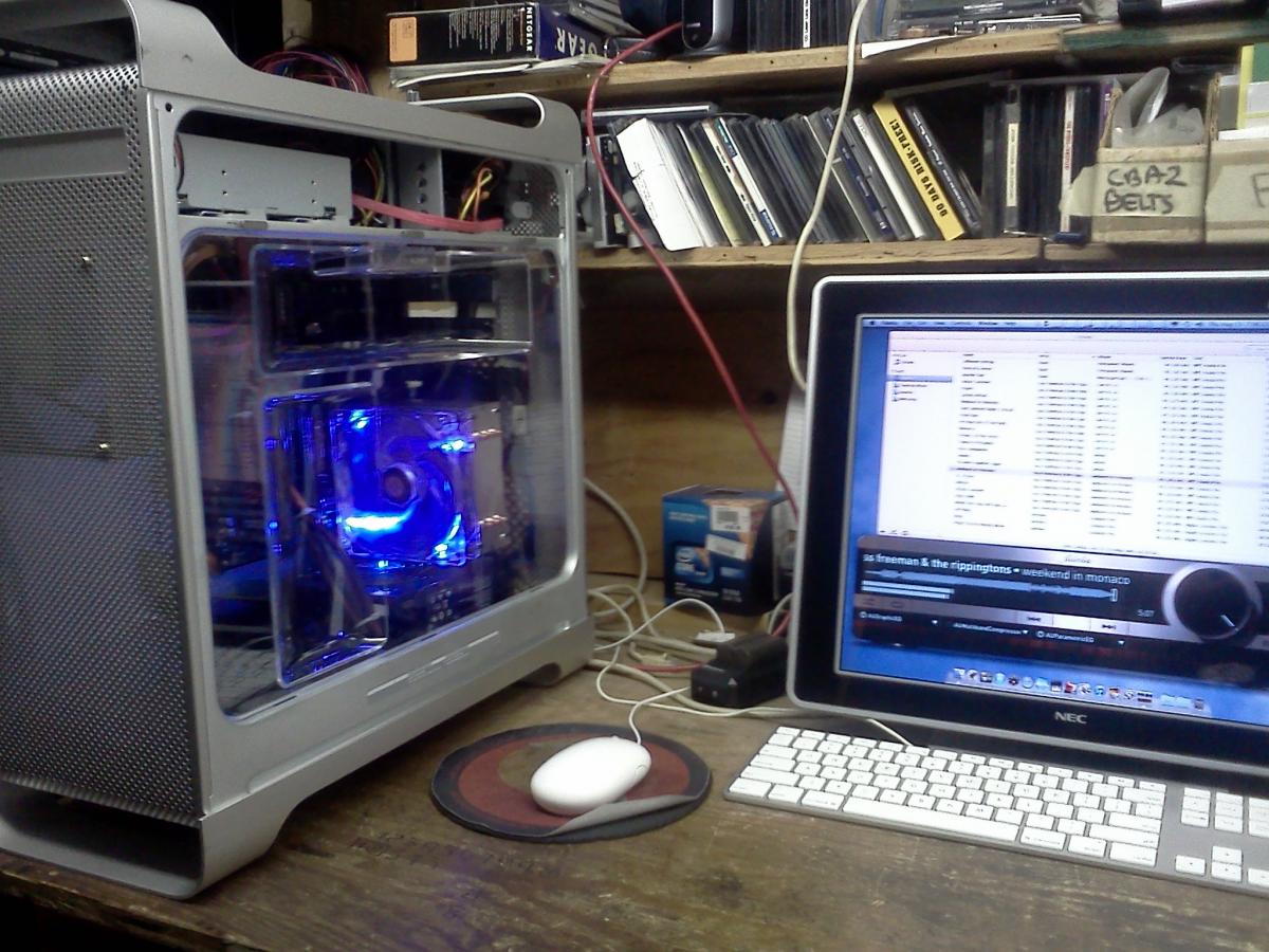

dddirtman Posted July 18, 2012 Share Posted July 18, 2012 here u gog5 caseasus sabertooth x58/i7 9502 1tb hds(osx10.11.6,data)1 ssd windows 10 1 500g solarisgeforce gtx 750 ti16gb ddr3 1200corsair 850w psuthermitake air coolersamsung 24" hd display(led) 1 Link to comment Share on other sites More sharing options...
dddirtman Posted July 21, 2012 Author Share Posted July 21, 2012 well thats sad no one likes the builds? Link to comment Share on other sites More sharing options...

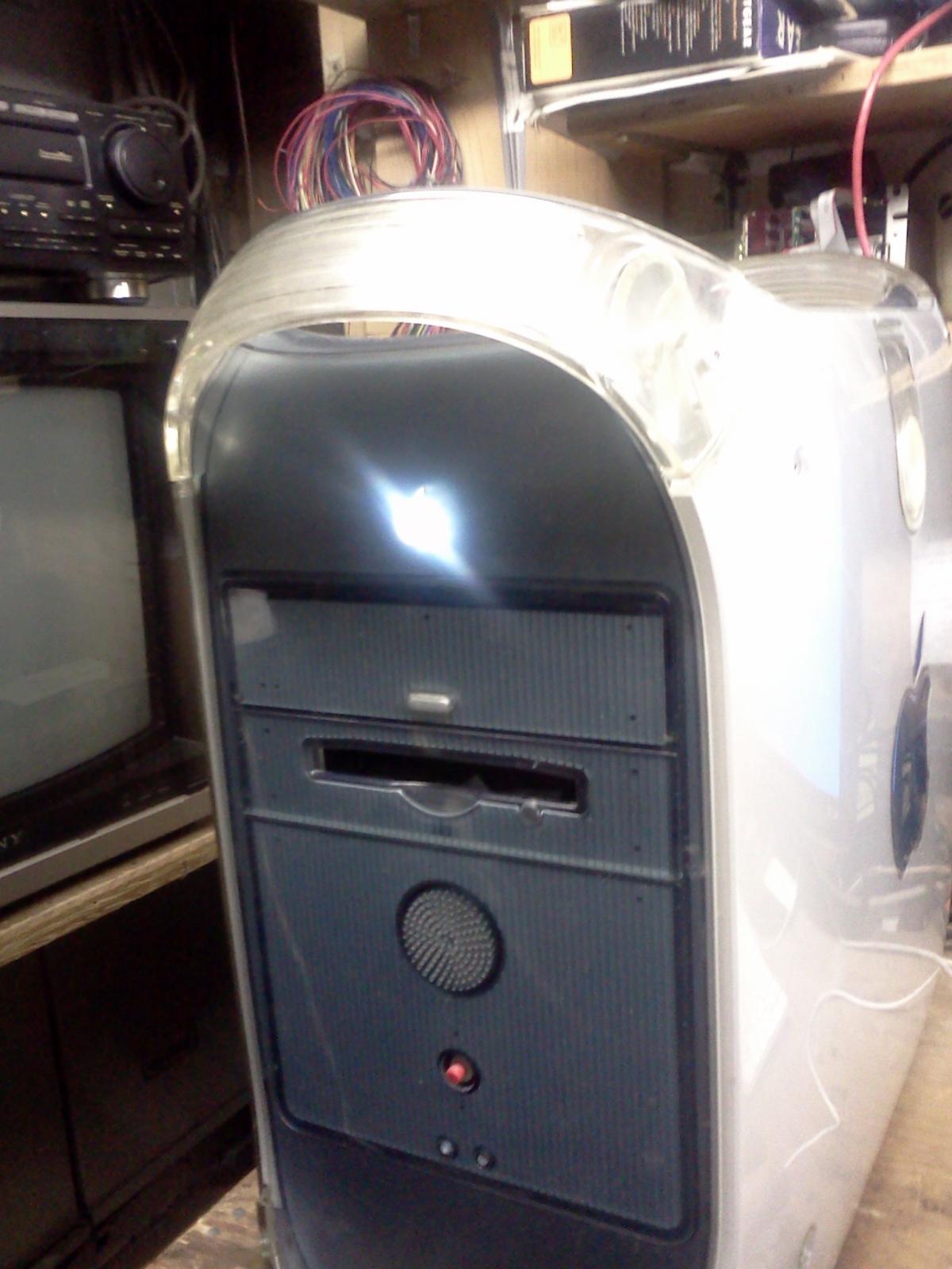

TH3L4UGH1NGM4N Posted July 21, 2012 Share Posted July 21, 2012 Like the build problem is that I so easily fly over this section of the forum countless times. For starters, the sabertooth is undoubtedly my favorite x58 board so great choice with that. I'd definitely grab me a new gtx card with the 850 psu as it could easily handle another card. Dunno if it's because of the G5s case structure but boy oh boy... cable management! Looks quite crazy by the IO disks on the left side would be nice to see the cables somehow routed behind it? The bubbly look of the g4 case looks lovely with the glowing in front. Overall, solid builds. I def like the G5 build as it's the classic professional go to Mac with quite the powerful guts inside it. Link to comment Share on other sites More sharing options...
dddirtman Posted July 22, 2012 Author Share Posted July 22, 2012 yup i hear u the weak point is the gfx card... but i don't play games so its enough for me but the x58 build is very fast indeed if i do upgrade ill just sli another board(windows) im not using a tray for the board so wiring under the board is tight that said i might redo this one with a tray to hide wires i love the g4 case a bit tight for larger motherboards thanks for looking... Link to comment Share on other sites More sharing options...

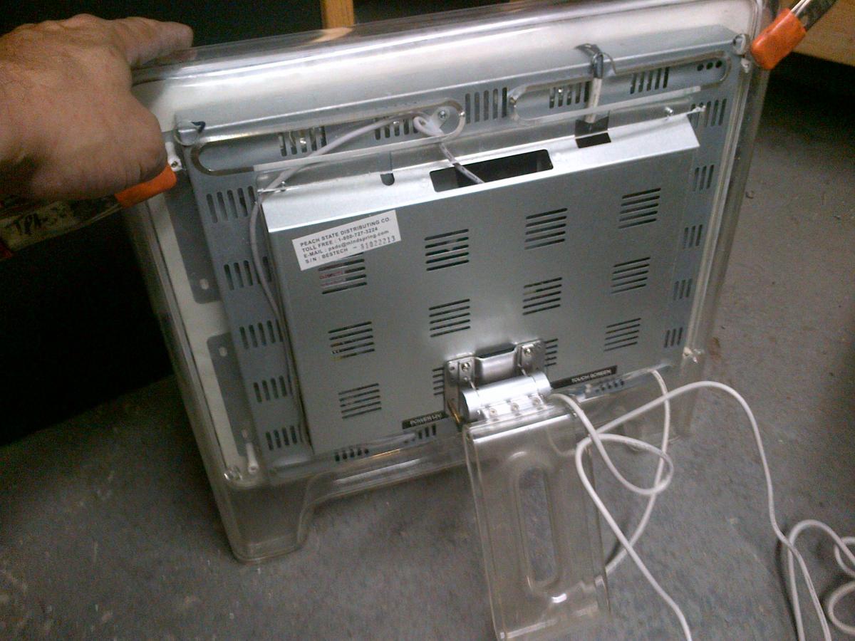

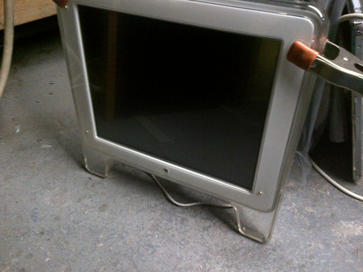

dddirtman Posted August 1, 2012 Author Share Posted August 1, 2012 moddin a cinema display.. 17" touch screen will be testing tomorrow moddin a cinema display.. 17" touch screen will be testing tomorrow Link to comment Share on other sites More sharing options...
eep357 Posted August 3, 2012 Share Posted August 3, 2012 yup i hear u the weak point is the gfx card... but i don't play games so its enough for me but the x58 build is very fast indeed if i do upgrade ill just sli another board(windows) im not using a tray for the board so wiring under the board is tight that said i might redo this one with a tray to hide wires i love the g4 case a bit tight for larger motherboards thanks for looking... That's what I was thinking, maybe a 2nd thin sheet of aluminum to the left of the mobo just to route the wires under, you could stencil it, decal it, paint it, or just have it blend in as bare aluminum, and turn the HD's 180deg so the plug in the back. If you can pick up a couple sata backplanes and some rt angle sata cables, you could have a true hot swap style HD bay there and would totally throw a heap of icing allover that cake Link to comment Share on other sites More sharing options...
dddirtman Posted August 4, 2012 Author Share Posted August 4, 2012 lol i feel the wire issue workin on it just updated my g4(i3) to 10.8 works nice Link to comment Share on other sites More sharing options...
dddirtman Posted September 26, 2012 Author Share Posted September 26, 2012 got the touch screen to work nice on osx and windows.. downloaded drivers from 3m site,installed calibrated...works great on lion(10.7.4) and windows 7 1 Link to comment Share on other sites More sharing options...

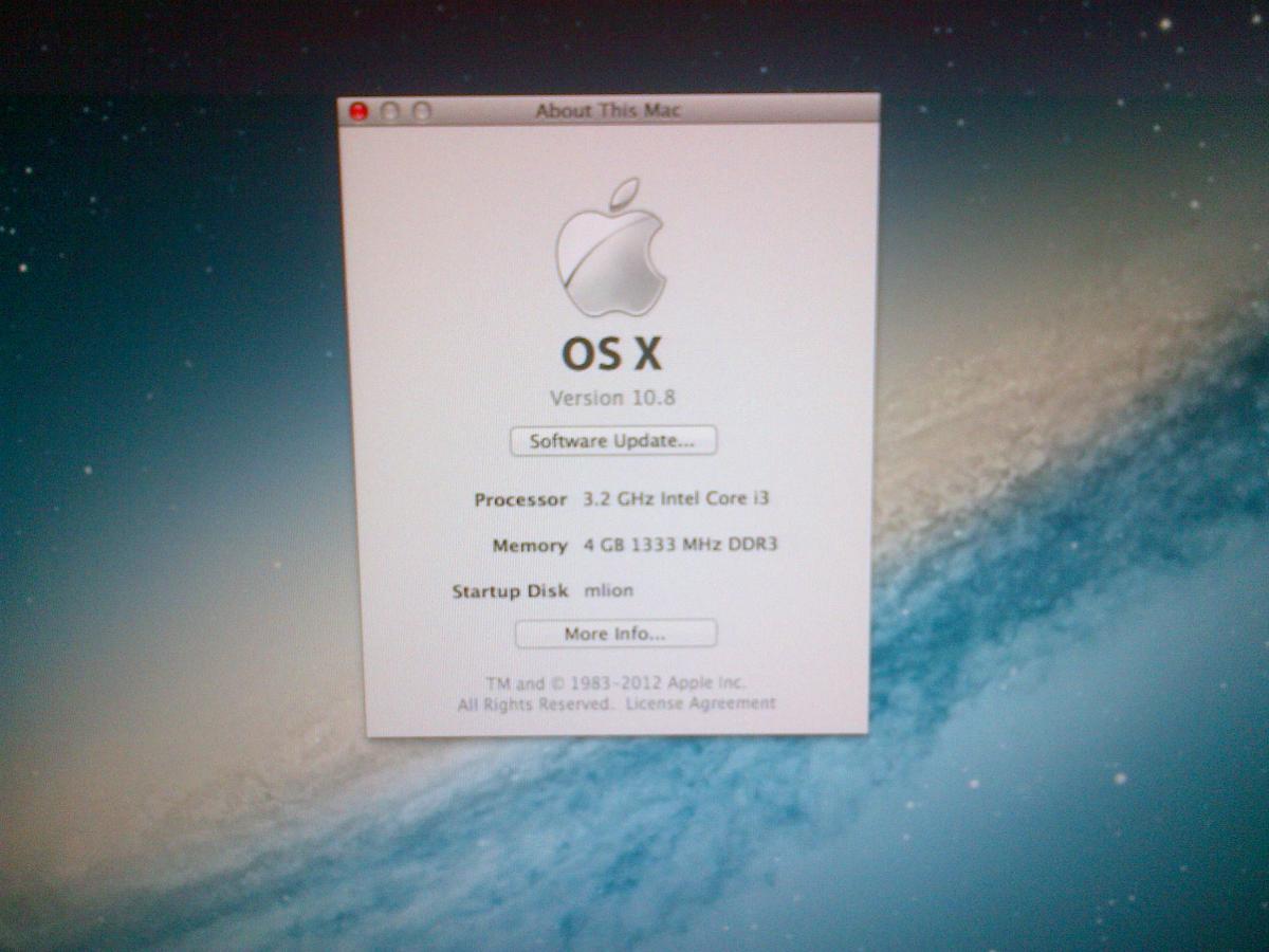

dddirtman Posted November 23, 2012 Author Share Posted November 23, 2012 just put a gtx 650 card in my i3 build.(osx10.8.2) only removed AppleTymcedriver.kext(white screen issue?)then set graphicsenabler=no installed cuda(5)drivers from nvidia site result-faster graphics for osx and windows 7 i purchased the card for 104usd a kepler card on the cheap.... :wink2: Link to comment Share on other sites More sharing options...

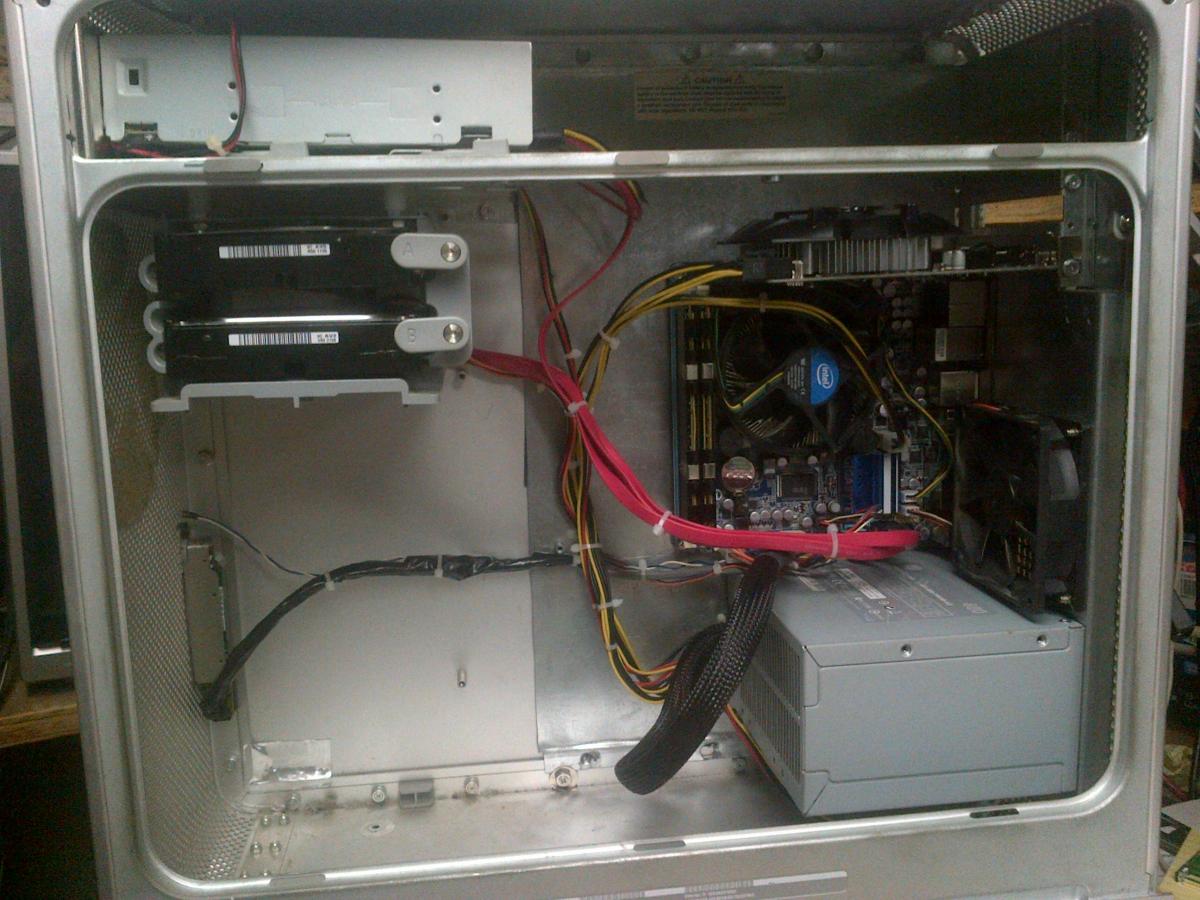

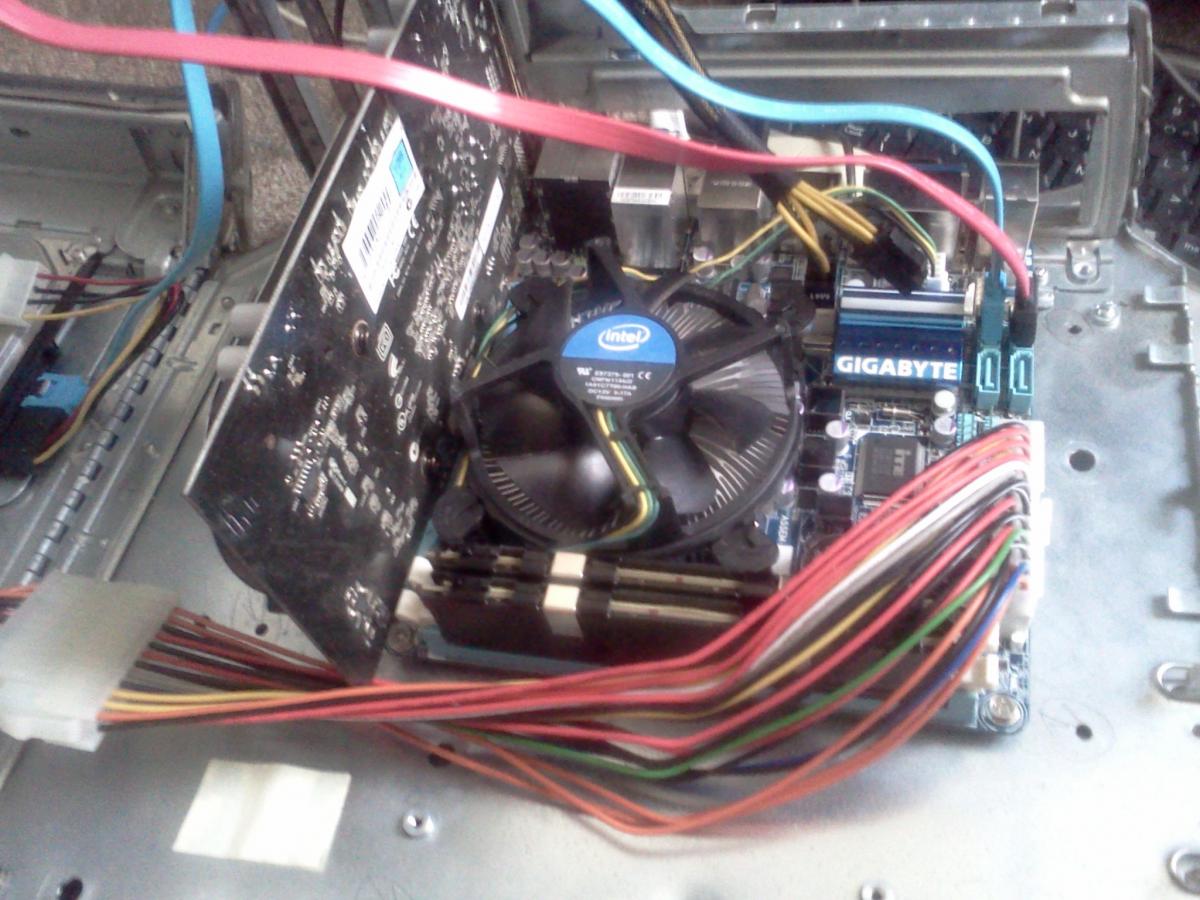

dddirtman Posted December 12, 2013 Author Share Posted December 12, 2013 i put my h55 build in a g5 case/with a tray.. a little neater,(I'm not so good in dressing wires)but it works and came out good... Link to comment Share on other sites More sharing options...
