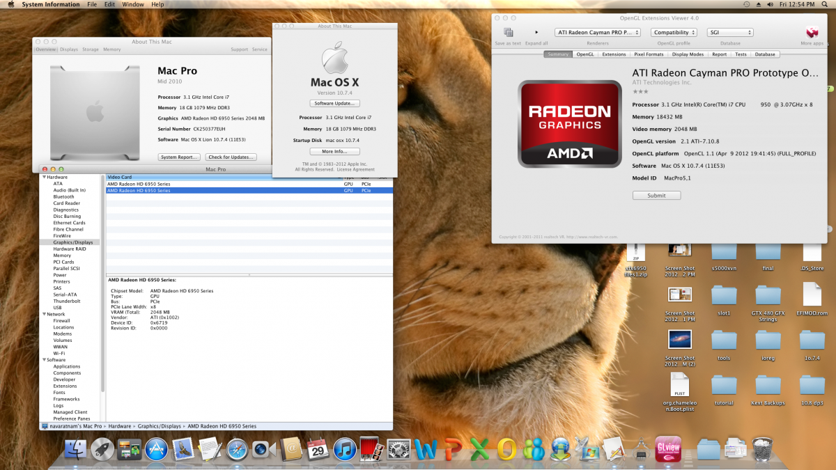

I have 2x6950
bios setting
Init display first-2nd card
and look my dsdt also.you have to set SMBios.plist Model Identifier: MacPro5,1
http://www.mediafire...z3buzhxu960w7e2

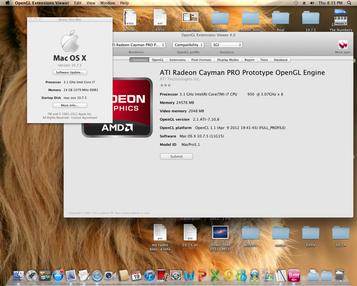

10.7.5 worked now
remove
/System/Library/PrivateFrameworks/GPUSupport.framework
replace
you have to replace mac pro 10.7.4
/System/Library/Frameworks/OpenGL.framework
/System/Library/Frameworks/OpenCL.framework
install this
http://www.mediafire...yg175ou2sqt52z3
GraphicsEnabler=Yes
install without ati_init
enjoy.

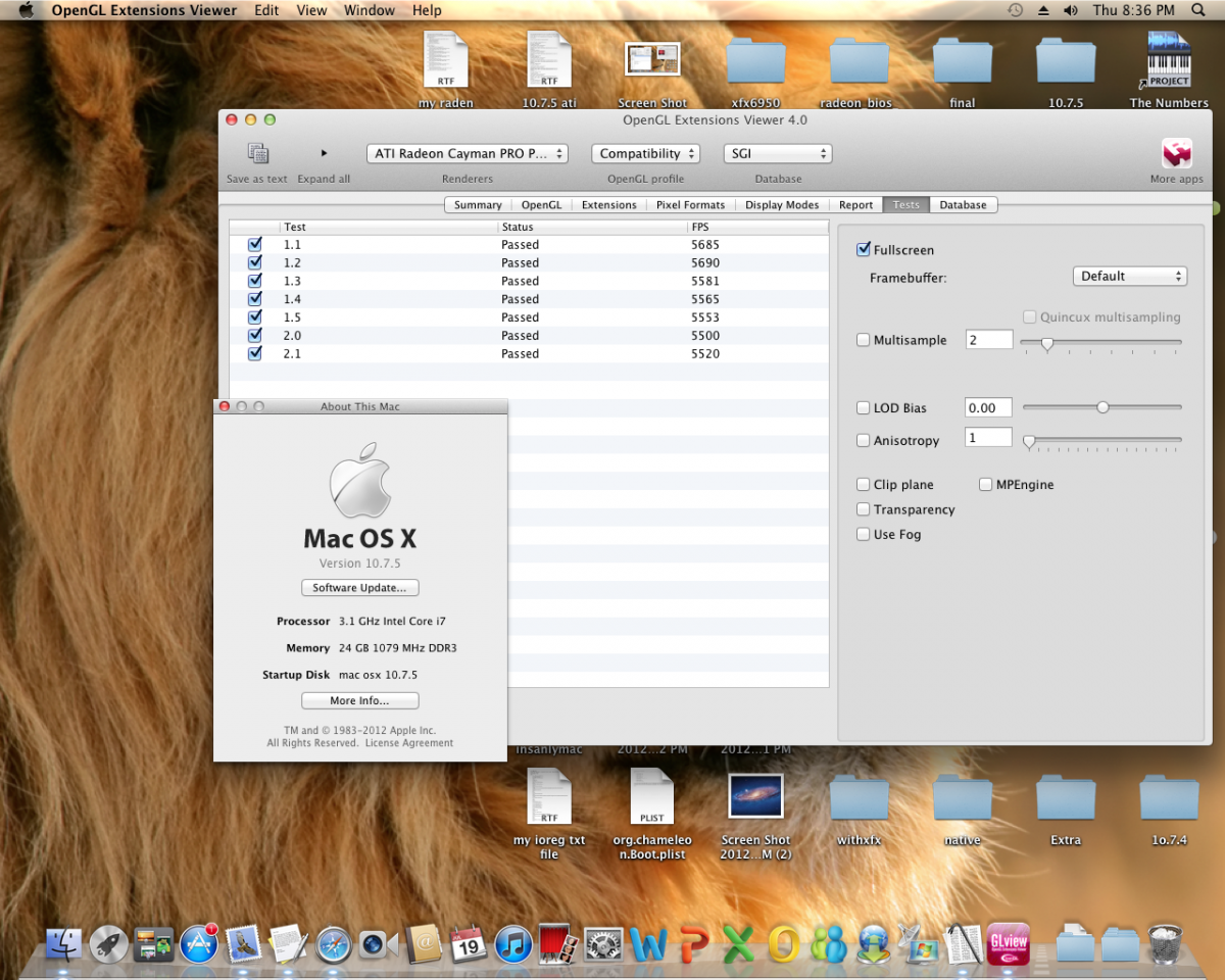

this for 10.7.5 look screen shots
remove
update
copy 10.7.4 to replace10.7.5
OpenGL.framework
OpenCL.framework
ioreg for pi of cake just look.

10.7.5 worked now
remove
replace
install this
GraphicsEnabler=Yes
enjoy.

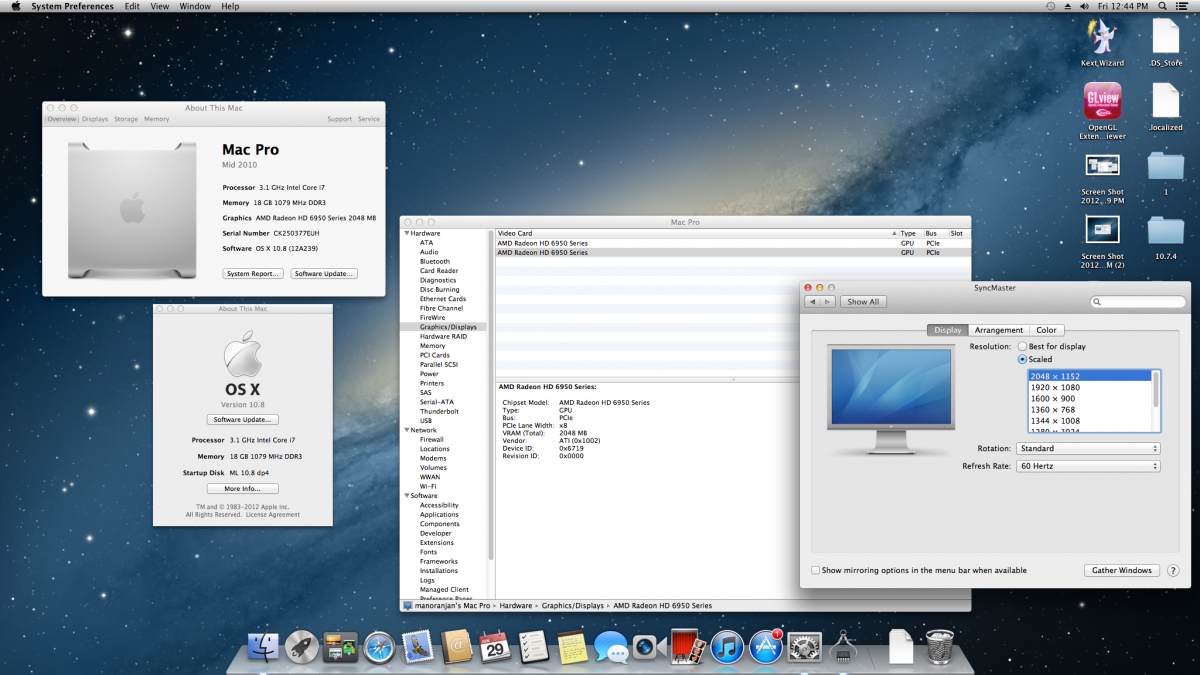

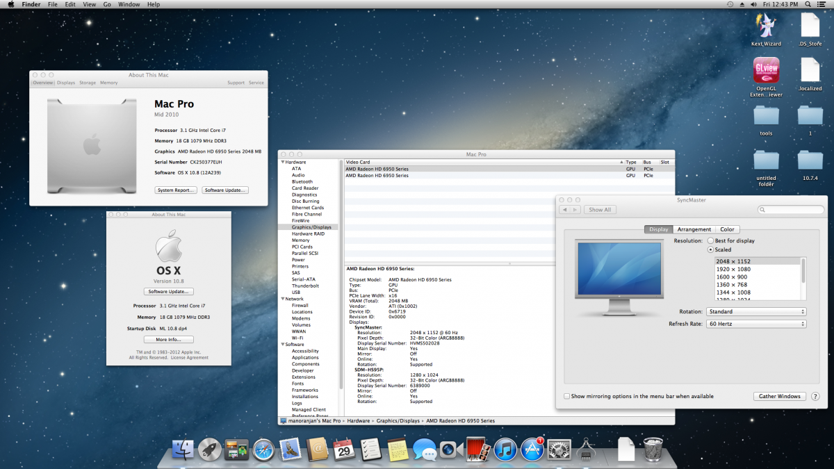

I try this for ML with Sapphire 6950 2GB and its work with GraphicsEnabler=No. But many features are lagging misson control, dashboard notification etc. And no bluetooth for me.
Share this post
Link to post

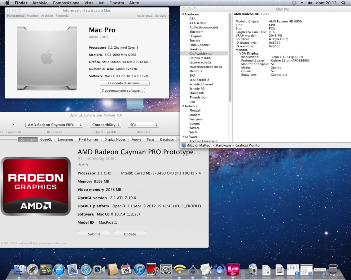

can you post screen like mine with info of system?

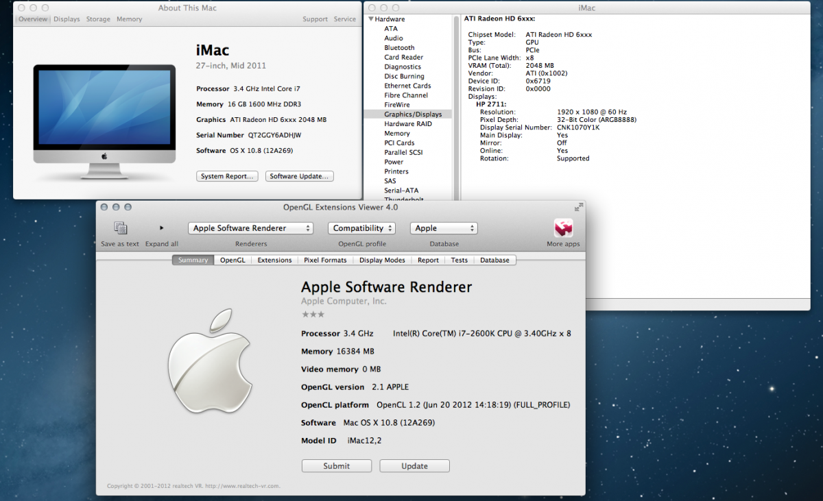

Your Chess and iTunes cover Flow working on 10.7.4 ? Mine 10.8 is look like this;
Share this post
Link to post
nope. anyway you don't have hardware acceleration enabled... Have you replace the "boot" file with that into folder?
Share this post
Link to post
I delete AMDRadeonAccelerator.kext and I changed the boot with latest chameleon! If I dont delete AMDRadeonAccelerator.kext I get just white screen.
I have the same problem..How can I enable hardware acceleration in ML 10.8? thanks!

Hey manor!
I followed your guide, updated to 10.7.5 then delete GPUSupport.framework, copy OpenGL and OpenCL.framework back and finally copy all the kexts file back.
I currently can boot but there's no OpenGL or anything. I have full res though. I saw your pictures that you could make 10.7.5 boot with ATI opengl, could you show me how?
Or if it even possible in 10.8, that would be great.
Thanks for your time!
Edit: Finally able to make it work on 10.7.5. Thank a lot manor!!

with your guide the hardware acceleration (fundamental) isn't enable and all system and app's graphics is too slow...How can I enable it? thanks!
Share this post
Link to post
It does. But with 10.7.4 and 10.7.5 only. Our best bet is using 10.7.4.
Youtube is still slow even with 480p though.
Share this post
Link to post
so I attend a version full compatible also with 10.8...
