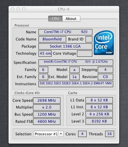

The K man Posted June 13, 2012 Author Share Posted June 13, 2012 Ok here it's my CPU-x Link to comment https://www.insanelymac.com/forum/topic/279582-problem-with-ga-ex58-ud5-very-low-results-from-geekbench-other-problems/page/2/#findComment-1826503 Share on other sites More sharing options...
Foxic Posted June 13, 2012 Share Posted June 13, 2012 does the multiplier value change under CPU load? Link to comment https://www.insanelymac.com/forum/topic/279582-problem-with-ga-ex58-ud5-very-low-results-from-geekbench-other-problems/page/2/#findComment-1826518 Share on other sites More sharing options...
The K man Posted June 13, 2012 Author Share Posted June 13, 2012 It's remaining stable at x 2.0 Link to comment https://www.insanelymac.com/forum/topic/279582-problem-with-ga-ex58-ud5-very-low-results-from-geekbench-other-problems/page/2/#findComment-1826573 Share on other sites More sharing options...
eep357 Posted June 13, 2012 Share Posted June 13, 2012 CPU-x figures are not 100% accurate for i7, mine looks just like yours other than the bus and core speed due to overclock including 16 threads, it does not show the correct multiplier or show dynamic changes. CPU-z under windows will show full range of p-states in real time. HWMonitor in osx (available here in updates and releases section) will show changes in real time between low and high mult and speed Link to comment https://www.insanelymac.com/forum/topic/279582-problem-with-ga-ex58-ud5-very-low-results-from-geekbench-other-problems/page/2/#findComment-1826577 Share on other sites More sharing options...
Foxic Posted June 13, 2012 Share Posted June 13, 2012 There you go then, try HWMonitor as eep suggests. Link to comment https://www.insanelymac.com/forum/topic/279582-problem-with-ga-ex58-ud5-very-low-results-from-geekbench-other-problems/page/2/#findComment-1826581 Share on other sites More sharing options...

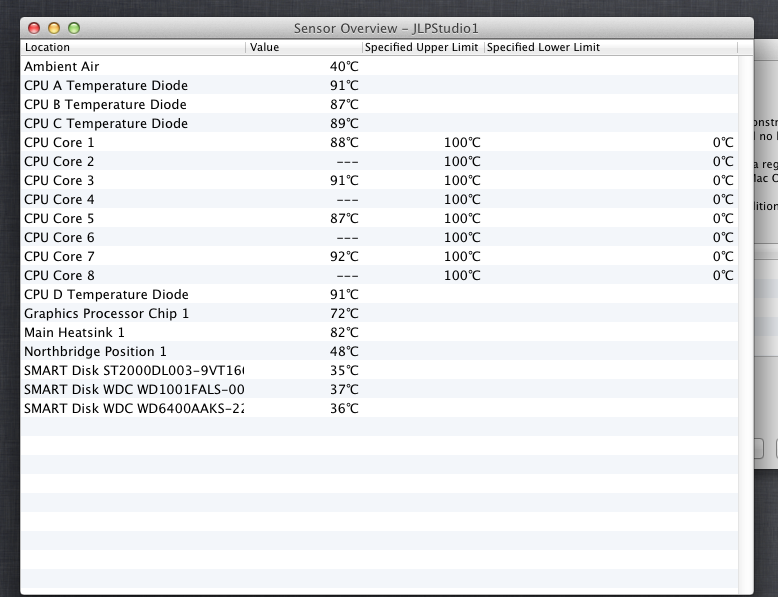

The K man Posted June 15, 2012 Author Share Posted June 15, 2012 I have noticed very high cpu temperatures.. the following temps are at the start-up ... when i have the computer on for a while they jump up to 95-98 degrees Celcius NOTE: I am not Overclocking Ambient (room) temp: 33 degrees Celcius Link to comment https://www.insanelymac.com/forum/topic/279582-problem-with-ga-ex58-ud5-very-low-results-from-geekbench-other-problems/page/2/#findComment-1827015 Share on other sites More sharing options...
eep357 Posted June 16, 2012 Share Posted June 16, 2012 You will need to install the version of fakesmc that is included in that download along with the motherboard plugins, not sure how they are labeled in the installer but should be easy to figure out. also uncheck any plugins for graphics cards you do not have, but can basically check everything else. THE INSTALLER WILL NOT REPLACE YOUR EXISTING FAKESMC so you need to delete or move it first then run the installer. If your cpu temps are really getting that high, I'm surprised it doesn't crash and KP. Proper DSDT can help with temps too, as example speedstep and native power management will work on my asus without DSDT and without chameleon generate P&C states, but temps will be 15 degrees hotter than with DSDT including SSDT tables Also in sysctl the cpu.flex.ratio.desired should not be 0 but should be 20 for your multipliers. If using a patched DSDT and you can boot without it, try removing it from /Extra for a bit and see if there is a difference. If you used scripted DSDT autopatcher that could be a problem Link to comment https://www.insanelymac.com/forum/topic/279582-problem-with-ga-ex58-ud5-very-low-results-from-geekbench-other-problems/page/2/#findComment-1827213 Share on other sites More sharing options...
Foxic Posted June 17, 2012 Share Posted June 17, 2012 He should be using the DSDT I included in the download. Those temps are high! Mine spikes to 62-63 when under 100% load but never increases even if I leave it hand braking films all day, ambient is 25-30 (2 bearded dragons and a snake in the same room...who needs central heating!) and that's at 3.4GHz. I don't understand what is going on here. AppleCPUPowerManagement is loaded, turbo ratios are good which means turbo mode is working. Chameleon should be generating your P-states for you. Try removing my DSDT, installing NullCPUPowerManagement, rebuild caches etc then reboot and extract your DSDT using DSDT patcher. Once you have 'your' dsdt, run through d00ds post I linked you to earlier and perform the steps I highlighted. Once finished, compile and save the dsdt and place it in /Extra. Rename my dsdt to dsdt_backup.aml and place both dsdts in /Extra. Delete NullCPUPowerManagement and rebuild caches, repair permissions. Reboot. If you get a panic, boot with dsdt=dsdt_backup.aml There may be a fundamental difference in our dsdts due to using slightly different processors. Link to comment https://www.insanelymac.com/forum/topic/279582-problem-with-ga-ex58-ud5-very-low-results-from-geekbench-other-problems/page/2/#findComment-1827272 Share on other sites More sharing options...
eep357 Posted June 17, 2012 Share Posted June 17, 2012 Do you both have same mobo revision and on same bios version? Nothing other than improperly installed heatsink, no fan, using fireplace as a PC case, or watercooling with a boiler included in the loop, should let the temps get that high at stock speeds, but again hard to believe it would even stay running. OSX usually KP before TJmax. James, does DSDT have SSDT tables in it for native speed step without using chameleon generate P&C states? Did clean reinstall get done as James had orig suggested? Can you boot windows or linux to just see quickly and easily if this is hardware of software problem and go from there at least knowing that much for sure? I think putting Bearded Dragons inside PC case with their hot rocks and heater lights would still have lower CPU temps. 1 Link to comment https://www.insanelymac.com/forum/topic/279582-problem-with-ga-ex58-ud5-very-low-results-from-geekbench-other-problems/page/2/#findComment-1827280 Share on other sites More sharing options...
Foxic Posted June 17, 2012 Share Posted June 17, 2012 There's no SSDT tables in there. I rely on Chameleon to generate them for me. Link to comment https://www.insanelymac.com/forum/topic/279582-problem-with-ga-ex58-ud5-very-low-results-from-geekbench-other-problems/page/2/#findComment-1827390 Share on other sites More sharing options...
eep357 Posted June 18, 2012 Share Posted June 18, 2012 Ahhh, well fairly easy to copy and paste in if you want to have both options available? But I think for our friend, no more time should be wasted working on OSX tweaks until at least a linux live boot or something can be done to verify it's even a software related problem, cause it seems to go beyond a few buggy extra kexts if the sensors are accurate Assuming he followed your excellent advice and did a clean reinstall to eliminate that x-factor, the bios should also be reset to start on a completely level playing field, cause guessing games are no fun after the first guess is wrong. And I'm all out of guesses without having the system in front of me to be able to look through every setting...Oh the joys of virtual tech support!...Which reminds me, did you check to make sure it's plugged in? If you are having trouble connecting to the internet, please visit our web site for support. Link to comment https://www.insanelymac.com/forum/topic/279582-problem-with-ga-ex58-ud5-very-low-results-from-geekbench-other-problems/page/2/#findComment-1827407 Share on other sites More sharing options...
The K man Posted June 19, 2012 Author Share Posted June 19, 2012 Sorry for the problem guys i found the solution.. I would like to thank eep357 for his help and of course JamesLittler for his excellent support and help.. Also i am sorry for the late reply since I didn't want to risk my CPU by turning it on.. It seems that my CPU fan was not running properly thus the high temps did not allowed the computer to run at normal speeds.. I cleaned the FAN and remove all the dust from there, and added an extra one.. now I am going to buy a watercooling system.. The temps now are from 50-60 degrees.. Thank you guys for your support.. and sorry for bothering you! P.S: Still Bios F12 is more stable than F13 on my machine.. But there is no problem for that! Link to comment https://www.insanelymac.com/forum/topic/279582-problem-with-ga-ex58-ud5-very-low-results-from-geekbench-other-problems/page/2/#findComment-1827723 Share on other sites More sharing options...
