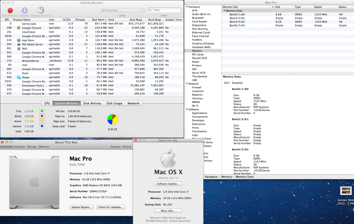

sgrinalds Posted May 19, 2012 Share Posted May 19, 2012 So i just upgraded my Mighty Hack Mini from 2x4gb(8gb) sticks to 2x8gb(16gb). The 16bg is showing up in my about mac and in my system info, but when i look at my activity monitor it's only using 8gb. I've tried to reseat the ram and made sure its plugged in properly, and it works in my windows partition, but not sure whats up. It is a Mini ITX board so I only have two slots? Running 10.7.3 flawlessly other than this. I have the Mac Mini system definition installed using the newest ###### (4.3 and chameleon). I have tried removing a stick and everything goes back to 8gb, then when I reinstall, it shows the 16gb in my Sys profile but just doesn't seem to be using it in activity monitor. Any suggestions? Ca anyone with 16gb in a Mini ITX chime in ? Thanks! Build: Gigabyte H55N-USB3 Intel i7 860 Radeon HD 6870 Here is a link of a picture of my Activity Monitor, About Mac, and Sys INFO Link to comment https://www.insanelymac.com/forum/topic/279198-displaying-sys-info-display-16gb-ram-but-only-using-8gb-miniitx/ Share on other sites More sharing options...

Foxic Posted May 29, 2012 Share Posted May 29, 2012 That looks fine to me. Can you post a screenshot of activity monitors memory screen. Link to comment https://www.insanelymac.com/forum/topic/279198-displaying-sys-info-display-16gb-ram-but-only-using-8gb-miniitx/#findComment-1823473 Share on other sites More sharing options...
sgrinalds Posted May 29, 2012 Author Share Posted May 29, 2012 Here is my activity monitor, about this mac, and system report Link to comment https://www.insanelymac.com/forum/topic/279198-displaying-sys-info-display-16gb-ram-but-only-using-8gb-miniitx/#findComment-1823666 Share on other sites More sharing options...
Gringo Vermelho Posted May 30, 2012 Share Posted May 30, 2012 Yeah that motherboard only has two memory slots, Chameleon's memory detection is having a fit. Are you using a patched DSDT? You must re-extract and patch it again after installing more memory. Use a Linux live CD (Mint is good) or Lavalys Everest (or whatever it's called now) on Windows. Don't extract on OS X, any tool or script you use will extract your already patched DSDT. Link to comment https://www.insanelymac.com/forum/topic/279198-displaying-sys-info-display-16gb-ram-but-only-using-8gb-miniitx/#findComment-1823682 Share on other sites More sharing options...

Gringo Vermelho Posted June 2, 2012 Share Posted June 2, 2012 Try booting without it, if you can. See if anything changes. Type DSDT=none at the Chameleon boot prompt to bypass the automatic DSDT override. Link to comment https://www.insanelymac.com/forum/topic/279198-displaying-sys-info-display-16gb-ram-but-only-using-8gb-miniitx/#findComment-1824360 Share on other sites More sharing options...
