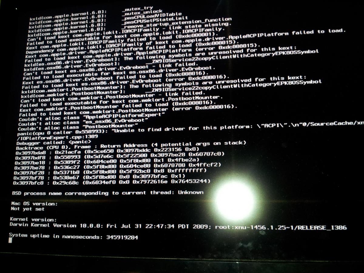

Ð обертом Карона Posted May 7, 2012 Share Posted May 7, 2012 im trying to get an ultimate pc going with ubuntu win 7 and mac osx 10.6 i have finished my installs of win 7 and ubuntu my specs are as follows: ASUS M4A87TD EVO motherboard (am3) AMD Athlon II x4 645 (stock 3.1ghz) OC to 3.7ghz =h70 watercooling on it 10gb of kingston dual channel ram (not any specific other than ddr3 1333mhz) HIS ATI Radeon HD 6750 1gb vid card 1x 500gb WD partioned 100 gbs aprox for each OS 1x750gb storage drive with all my games music ect i cant find any way to install osx snow leopard . i have tried alot of diffrent ways but they all just freeze after a bunch of text while trying to boot plz help in anyway Quote Link to comment https://www.insanelymac.com/forum/topic/278798-trying-all-day-to-get-snow-leopard-to-work-on-my-amd-custom-pc/ Share on other sites More sharing options...

eep357 Posted May 7, 2012 Share Posted May 7, 2012 a few lines higher there might be some relevant info, unless it sats moc osx version=none yet, or something like that. if u can take a picture with a camera and upload it that would be great Quote Link to comment https://www.insanelymac.com/forum/topic/278798-trying-all-day-to-get-snow-leopard-to-work-on-my-amd-custom-pc/#findComment-1818689 Share on other sites More sharing options...

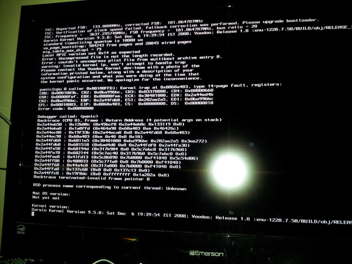

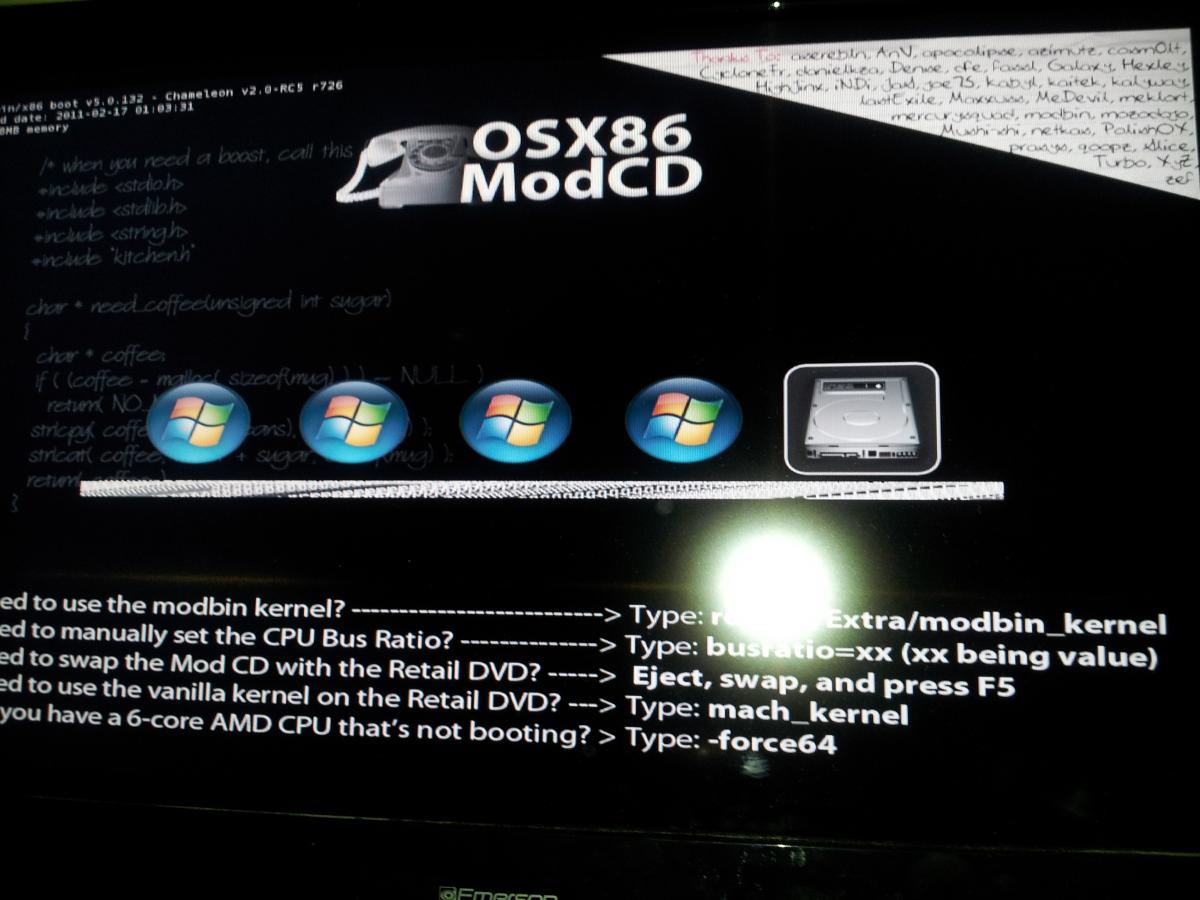

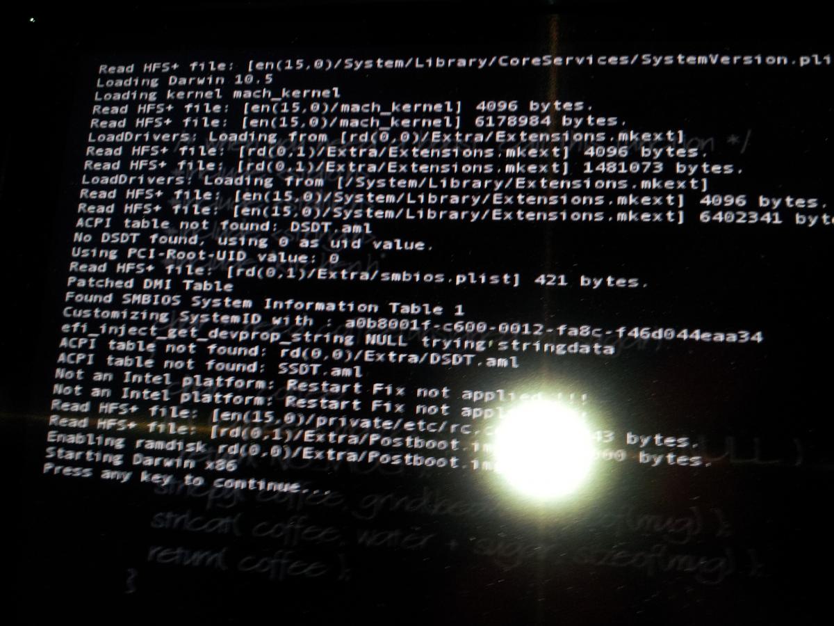

Ð обертом Карона Posted May 7, 2012 Author Share Posted May 7, 2012 this first one is after i put modcd in and then swaped for snow leopard cd the second one is right at boot when it stops the thrid is when boot stops right after presing enter for sec pic Quote Link to comment https://www.insanelymac.com/forum/topic/278798-trying-all-day-to-get-snow-leopard-to-work-on-my-amd-custom-pc/#findComment-1818722 Share on other sites More sharing options...
eep357 Posted May 8, 2012 Share Posted May 8, 2012 looks like a problem with the kernel it's loading, have you tried any different boot flags or just hittin enter? if you haven't already try the the modbin kernel by typing exactly what it says in the first shot, can't quite read it cause your flash bulb reflection. If that fails, try mach_kernel. also can try adding additional boot flags that may help, a bit of trial and error though. Some to try are -x, -f, arch=i386, -force64, cpus=1, and any combination may work, but try to go through them with some sort of order so you can remember what you already tried and know what seems to be working. Quote Link to comment https://www.insanelymac.com/forum/topic/278798-trying-all-day-to-get-snow-leopard-to-work-on-my-amd-custom-pc/#findComment-1818742 Share on other sites More sharing options...
Ð обертом Карона Posted May 8, 2012 Author Share Posted May 8, 2012 i did that one with boot flags mach_kernel -force64 and one that i read about i think it was busratio=20 Quote Link to comment https://www.insanelymac.com/forum/topic/278798-trying-all-day-to-get-snow-leopard-to-work-on-my-amd-custom-pc/#findComment-1818743 Share on other sites More sharing options...
eep357 Posted May 8, 2012 Share Posted May 8, 2012 in the pic u uploaded, mach_kernel was chosen, try modbin kernel or legacy_kernel(chocolate), also use -x -v and try both busratio=17 and busratio=20 with different kernels, if still not working, try 18 and 19. you"ll get the right combonation eventually, but mach_kernel is not gonna work, sorry I kinda meant that as if all else fails last resort thing, but would be surprised if it did. Just get past that part you froze at before then can move on to the next spot it freezes but here's hoping it doesn't Quote Link to comment https://www.insanelymac.com/forum/topic/278798-trying-all-day-to-get-snow-leopard-to-work-on-my-amd-custom-pc/#findComment-1818756 Share on other sites More sharing options...
Ð обертом Карона Posted May 8, 2012 Author Share Posted May 8, 2012 i did the first option from the photo and got this im sure its father than the last photos I just tryed all the combinations it just ened up at the same point as the last ones Quote Link to comment https://www.insanelymac.com/forum/topic/278798-trying-all-day-to-get-snow-leopard-to-work-on-my-amd-custom-pc/#findComment-1818759 Share on other sites More sharing options...
eep357 Posted May 8, 2012 Share Posted May 8, 2012 and you have your sata controller set to ahci in bios right? very important that it is. Also make sure your including -x and try the different bus ratios. repeat all combination possibilities on each optional kernel. unhook your other spare data HD to be safe-although seperate hd for each OS prefered. Windows is already installed so your safe for now but if given the chance, windows will overwrite and bootloader it can get it's claws on. Turn off your overclock for now too. can also add cpus=1 into the boot flag mix and it may help Quote Link to comment https://www.insanelymac.com/forum/topic/278798-trying-all-day-to-get-snow-leopard-to-work-on-my-amd-custom-pc/#findComment-1818763 Share on other sites More sharing options...
