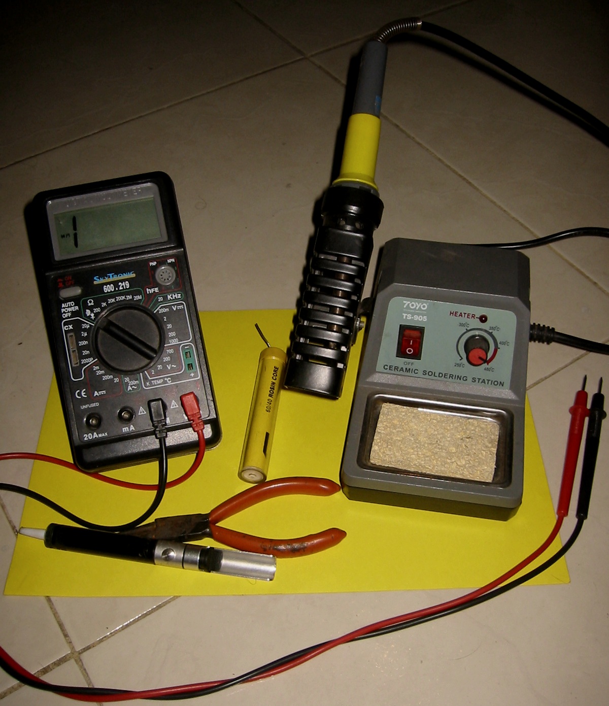

Gringo Vermelho Posted March 30, 2012 Share Posted March 30, 2012 My wife's PC has a 450 watt PSU and my old 9800 GTX+, also with an adapter for the second power plug. It works fine - although the 9800 GTX+ is a die-shrunk version of the 9800 GTX and so it uses less power then the 9800 GTX. 500 Watts should be plenty I would think. But if the power supply is old maybe it's not able to deliver anymore. You can solder in new capacitors yourself if the old ones are shot. Unless the problem is with some other component, this will bring the PSU back to factory specs. Look for bulging or leaking caps inside the PSU and replace them. It's a bit fiddly because of the tight space, but with some patience and the right tools it can be done, you don't have to be an electronics expert for this task. It's a good idea to practice soldering and de-soldering on a broken circuit board first however. Desolder the busted caps, take them to your electronics store and ask for identical ones. Make sure to note the polarity, component values and placement, I recommend taking photos of the PCB to help you remember what goes where. I've somehow managed to pull this off twice, I've even fixed an old Geforce 2 Ti video card this way. It's very satisfying. But first you need to determine if the problem is with the video card or the PSU. I would try another PSU (or install the video card in another PC) to see if the same thing happens. Link to comment https://www.insanelymac.com/forum/topic/277603-geforce-9800-gtx-power-problem-or-card-problem/#findComment-1809682 Share on other sites More sharing options...
PookyMacMan Posted March 30, 2012 Author Share Posted March 30, 2012 mitch, I got it used but the person said it was like-new. Gringo, that might be a good idea...the PSU is brand-new, so I don't think the PSU has bad caps, but maybe the GPU? I'd have to take off the heatsink, but that might be something to look at...I've replaced iMac G5 caps before, so I might be able to pull it off if necessary. I'm going to be going over to my bro's place over the weekend and test it in his PC...he's been using a 9800 GT with either a 550 or 600W PSU (he doesn't remember what he has ), so hopefully we'll see what's wrong. If the graphics card does turn out to be failing, is there possibly anything I can do? Link to comment https://www.insanelymac.com/forum/topic/277603-geforce-9800-gtx-power-problem-or-card-problem/#findComment-1809734 Share on other sites More sharing options...
Gringo Vermelho Posted March 30, 2012 Share Posted March 30, 2012 Well, that of course depends on your talents, and what is wrong with it. Usually all a mere mortal can do is replace capacitors, the rest is surface mount which you need special tools and l33t skills to replace. Even a brand new PSU can have bad caps. Pop the lid and take a quick look, can't hurt. 1 Link to comment https://www.insanelymac.com/forum/topic/277603-geforce-9800-gtx-power-problem-or-card-problem/#findComment-1809780 Share on other sites More sharing options...
PookyMacMan Posted March 30, 2012 Author Share Posted March 30, 2012 Thanks, I will do that. Would you recommend a chisel tip for replacing the caps (if they're bad)? It'll be lead-free, right? Link to comment https://www.insanelymac.com/forum/topic/277603-geforce-9800-gtx-power-problem-or-card-problem/#findComment-1809806 Share on other sites More sharing options...
Gringo Vermelho Posted March 30, 2012 Share Posted March 30, 2012 I don't know if a chisel tip will make a difference. I use the one that came with my iron. No idea what it's made of honestly. I apply a spring loaded solder sucker while heating with the iron. Once you remove enough, the little bastards pop right out. Soldering/de-soldering is a {censored}, you always seem to be a hand short. Link to comment https://www.insanelymac.com/forum/topic/277603-geforce-9800-gtx-power-problem-or-card-problem/#findComment-1809822 Share on other sites More sharing options...
PookyMacMan Posted March 30, 2012 Author Share Posted March 30, 2012 I can echo that last statement!! I was wondering because I have a tiny cone tip, and when I did the iMac caps it didn't heat up enough to loosen the solder well (and my iron is 60W), and everyone was using a chisel tip for the iMac caps. Link to comment https://www.insanelymac.com/forum/topic/277603-geforce-9800-gtx-power-problem-or-card-problem/#findComment-1809823 Share on other sites More sharing options...

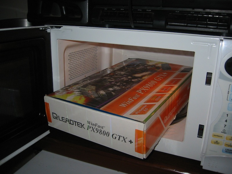

mrsentraser Posted May 7, 2012 Share Posted May 7, 2012 Look into baking that 9800GTX and you might be able to get some more life out of it. I baked over a dozen 8800 and 9800 series cards and they are all still working today... folding ofcourse, since i've moved on to AMD Graphics. Link to comment https://www.insanelymac.com/forum/topic/277603-geforce-9800-gtx-power-problem-or-card-problem/#findComment-1818605 Share on other sites More sharing options...
PookyMacMan Posted May 7, 2012 Author Share Posted May 7, 2012 Baking?? Like in the oven?? Anyway, I've decided to sell the 9800 GTX in favor of the GTS 250...thanks though. Link to comment https://www.insanelymac.com/forum/topic/277603-geforce-9800-gtx-power-problem-or-card-problem/#findComment-1818655 Share on other sites More sharing options...
Gringo Vermelho Posted May 7, 2012 Share Posted May 7, 2012 Five minutes in the microwave at full blast, just leave it in the box!! 1 Link to comment https://www.insanelymac.com/forum/topic/277603-geforce-9800-gtx-power-problem-or-card-problem/#findComment-1818690 Share on other sites More sharing options...
PookyMacMan Posted May 7, 2012 Author Share Posted May 7, 2012 You're kidding, right? Link to comment https://www.insanelymac.com/forum/topic/277603-geforce-9800-gtx-power-problem-or-card-problem/#findComment-1818694 Share on other sites More sharing options...
Gringo Vermelho Posted May 7, 2012 Share Posted May 7, 2012 Hahah, no comments! 1 Link to comment https://www.insanelymac.com/forum/topic/277603-geforce-9800-gtx-power-problem-or-card-problem/#findComment-1818696 Share on other sites More sharing options...
PookyMacMan Posted May 7, 2012 Author Share Posted May 7, 2012 Holy {censored}, I just saw some videos of people doing this!! That's amazing! Link to comment https://www.insanelymac.com/forum/topic/277603-geforce-9800-gtx-power-problem-or-card-problem/#findComment-1818699 Share on other sites More sharing options...
