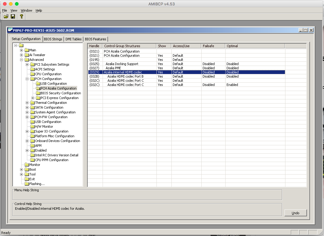

Krazubu Posted January 6, 2019 Share Posted January 6, 2019 Hey, better late than never, I FINALLY FOUND HOW TO GET SOUND WITH APPLE HDA AND LAST BIOS (3602) ! The solution is actually pretty simple : - Get AMIBCP tool somewhere on the web - Run it (you can run it fine in OSX using Wine). - Load your 3602 bios image. - Expand the tree to Advanced / PCI Subsystem Settings / PCH Configuration / PCH Azalia Configuration - Find "Azalia internal HDMI codec" entry in the list on the right - Put settings for "Failsafe" and "Optimal" to disabled. - Save your ROM - Flash - Sound works (considering the rest is properly configured, you should use Layout-ID #1). This is a good thing as 3xxx is a huge update that brings lots of new features and also UEFI compatibility as opposed to previous versions 2xxx that are ony EFI1.1 and have really exotic compatibility with clover and efi modules. It only took 7 years 1 2 Link to comment https://www.insanelymac.com/forum/topic/276380-the-inevitable-p8p67-pro-install-guide/page/8/#findComment-2657616 Share on other sites More sharing options...
BuckSS Posted January 27, 2019 Share Posted January 27, 2019 On 1/6/2019 at 9:46 PM, Krazubu said: Hey, better late than never, I FINALLY FOUND HOW TO GET SOUND WITH APPLE HDA AND LAST BIOS (3602) ! The solution is actually pretty simple : - Get AMIBCP tool somewhere on the web - Run it (you can run it fine in OSX using Wine). - Load your 3602 bios image. - Expand the tree to Advanced / PCI Subsystem Settings / PCH Configuration / PCH Azalia Configuration - Find "Azalia internal HDMI codec" entry in the list on the right - Put settings for "Failsafe" and "Optimal" to disabled. - Save your ROM - Flash - Sound works (considering the rest is properly configured, you should use Layout-ID #1). This is a good thing as 3xxx is a huge update that brings lots of new features and also UEFI compatibility as opposed to previous versions 2xxx that are ony EFI1.1 and have really exotic compatibility with clover and efi modules. It only took 7 years Hey! Thank you for update! How you made macos and clover work and even boot on 3602? Do you have a Clover config to share and maybe kexts (for CLOVER boot) to share? =) (and BIOS settings also which are crucial to set) Because when I update to 3602 macos just dont even boot up. I think it doesnt even load a FakeSMC or some sort. Tried even vanilla clover config. Thank you! Link to comment https://www.insanelymac.com/forum/topic/276380-the-inevitable-p8p67-pro-install-guide/page/8/#findComment-2661545 Share on other sites More sharing options...

Careless Posted November 29, 2019 Share Posted November 29, 2019 (edited) On 1/6/2019 at 1:46 PM, Krazubu said: Hey, better late than never, I FINALLY FOUND HOW TO GET SOUND WITH APPLE HDA AND LAST BIOS (3602) ! Hi Krazubu, Thanks for directing me to this fix in the other thread about 3602 bios during Catalina install. I managed to have the ALC codec working for a while now, I just never knew how or where to put the alcid=layout flag or didn't notice that it was a requirement, lol! I always thought I must have done something wrong. Anyway, I applied your patch to my rom anyway and flashed and reconfigured bios after taking cell phone pics to put the settings back to previous config. Everything seems great now. I don't use the audio onboard anyways, I only have headphones connected via bluetooth- but the latest versions of macOS do not allow video playback without an audio device connected. Sometimes when I am editing video and my headphones are charging, I require an audio device present to preview editing changes. I had been using Soundflower fake audio rerouting driver, but this fix allows me to use AppleALC instead of Soundflower.kext which is no longer supported for future updates anyway. Thanks again! EDIT: I just switched to alcid=11 to see if it reduced the number of input/outputs in the sound device list, and it looks like it works well. I only have 'Digital Out' and 'Internal Speaker' now, which is just what I needed. I don't use the integrated audio IO anyways, so I just need something there to allow audio-off video playback. The layout 11 menu is less cluttered. Have not tried layout 12 but see no reason to. Edited November 29, 2019 by Careless Link to comment https://www.insanelymac.com/forum/topic/276380-the-inevitable-p8p67-pro-install-guide/page/8/#findComment-2699048 Share on other sites More sharing options...
