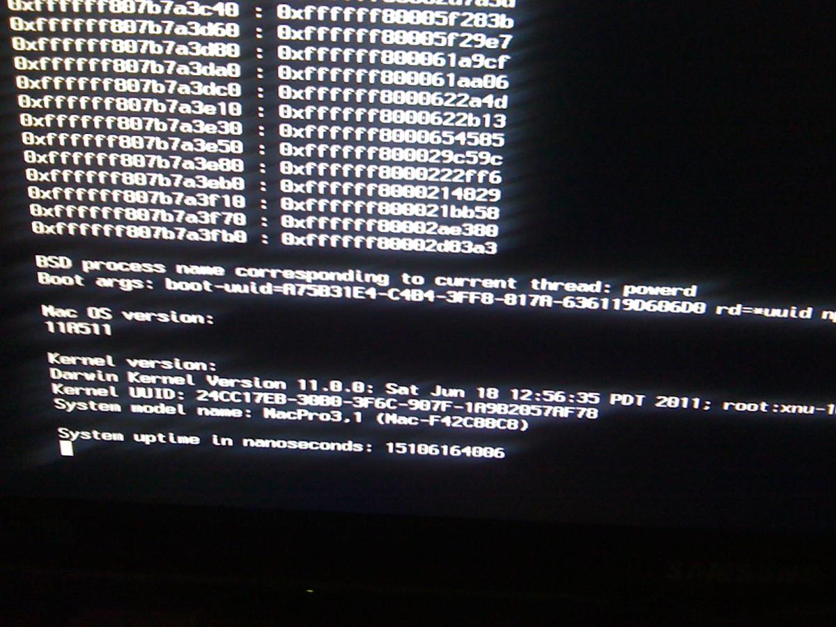

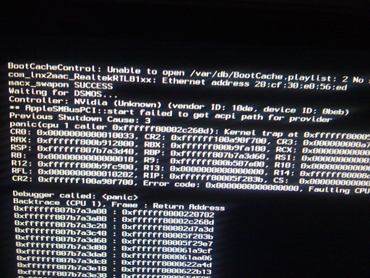

darkmanvini Posted December 24, 2011 Share Posted December 24, 2011 Bom dia, estou tendo um problema com meu hackintosh,que estava tudo ok,cheguei a reiniciar o PC 2 vezes e ligou normal, porém agora esta dando um erro,creio eu que na placa de video. Seguem as fotos : O Hackintosh é Lion 10.7 Placa mae P7h55M BR I 3 - 3.02 4 GB Ram Geforce GTX 460 Link to comment https://www.insanelymac.com/forum/topic/273843-os-lion-107-kernel-panic/ Share on other sites More sharing options...
artur_pt Posted December 25, 2011 Share Posted December 25, 2011 olá feliz natal o teu video é habilitado somente no Chameleon com GraphicsEnabler=Yes se usares kernelCache=Yes tenta fazer o boot -v UseKernelCache=No bom hack Link to comment https://www.insanelymac.com/forum/topic/273843-os-lion-107-kernel-panic/#findComment-1781087 Share on other sites More sharing options...

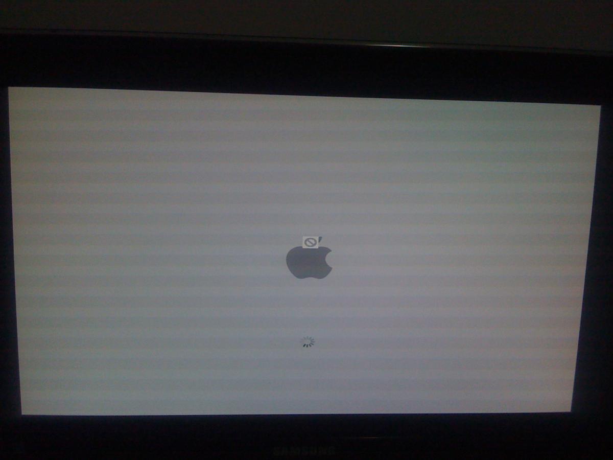

darkmanvini Posted December 25, 2011 Author Share Posted December 25, 2011 Feliz natal! Entao segui os passos porém agora ele fica apenas nessa tela: Link to comment https://www.insanelymac.com/forum/topic/273843-os-lion-107-kernel-panic/#findComment-1781154 Share on other sites More sharing options...
artur_pt Posted December 25, 2011 Share Posted December 25, 2011 olá tenta o boot - v GraphicsEnabler=No bom hack e mete sempre -v para saber qual é o erro Link to comment https://www.insanelymac.com/forum/topic/273843-os-lion-107-kernel-panic/#findComment-1781167 Share on other sites More sharing options...
darkmanvini Posted December 27, 2011 Author Share Posted December 27, 2011 Boa noite,muito obrigado agora consegui reiniciar tranquilo! Teria algum metodo que eu possa reiniciar sem ter que ficar sempre digitando no inicio do boot? Link to comment https://www.insanelymac.com/forum/topic/273843-os-lion-107-kernel-panic/#findComment-1781463 Share on other sites More sharing options...
