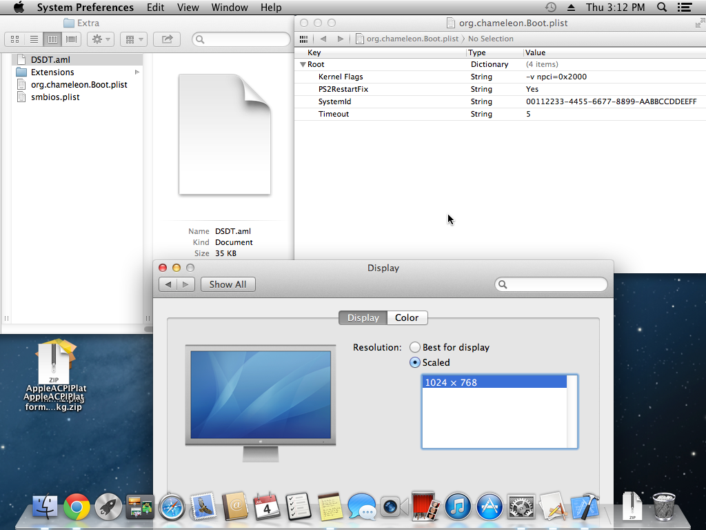

cmputr Posted July 2, 2013 Share Posted July 2, 2013 Good news, I think we are making progress. Both DSDT's from alt2-dsdt.zip got me past [ PCI Configuration Begin ] but graphics are still at 1024 x 768. (9400M G + G210M) EDIT: no battery status. LID close detection works but when I open the laptop I see a black screen and I lose mouse function. Link to comment https://www.insanelymac.com/forum/topic/272546-osx-107-108-and-109-on-the-dell-xps-1340-laptop/page/11/#findComment-1929754 Share on other sites More sharing options...
bcc9 Posted July 3, 2013 Author Share Posted July 3, 2013 Good news, I think we are making progress. Both DSDT's from alt2-dsdt.zip got me past [ PCI Configuration Begin ] but graphics are still at 1024 x 768. (9400M G + G210M) With the dsdt, your graphics strings should be getting injected into your ioregistry automatically. Check and or post your ioregistry to verify. GraphicsEnabler should no longer be used as it erroneously adds injection strings to both graphics pci IDs intead of just the 9400m part. Newer nvidia drivers only work with the injection strings on the 9400m part. Link to comment https://www.insanelymac.com/forum/topic/272546-osx-107-108-and-109-on-the-dell-xps-1340-laptop/page/11/#findComment-1929831 Share on other sites More sharing options...
cmputr Posted July 3, 2013 Share Posted July 3, 2013 With the dsdt, your graphics strings should be getting injected into your ioregistry automatically. Check and or post your ioregistry to verify. GraphicsEnabler should no longer be used as it erroneously adds injection strings to both graphics pci IDs intead of just the 9400m part. Newer nvidia drivers only work with the injection strings on the 9400m part. not using GraphicsEnabler. would you mind pointing me in the right direction to find the string in ioregistry? thanks Edit: Very sorry, I'm new to hackintosh. I'm a long time Windows user. Anyway, Im looking in ioregistry and I see .. IGPU@0 model data <"NVidia Geforce 9400M G"> I also just looked in About This Mac>Graphics/Displays and it says: "There was an error while gathering this information." Link to comment https://www.insanelymac.com/forum/topic/272546-osx-107-108-and-109-on-the-dell-xps-1340-laptop/page/11/#findComment-1929835 Share on other sites More sharing options...
bcc9 Posted July 5, 2013 Author Share Posted July 5, 2013 not using GraphicsEnabler. would you mind pointing me in the right direction to find the string in ioregistry? thanks Edit: Very sorry, I'm new to hackintosh. I'm a long time Windows user. Anyway, Im looking in ioregistry and I see .. IGPU@0 model data <"NVidia Geforce 9400M G"> I also just looked in About This Mac>Graphics/Displays and it says: "There was an error while gathering this information." Failing to get working battery status or native resolution (which in turn is due to failure to get the nvidia accelerated framebuffer kext to run) are symptoms of a misconfig. I think if you'll look back at previous posts in this thread you'll see this is almost always the case. The exception is when a new release comes out and something breaks. You should look back to see if the previous solutions apply to you. Usually people say they are following post #1 but they are instead just cherry picking what parts of post #1 they think are important, and they wind up with a misconfig. The easiest way to get a misconfig is to use tonymac's installers which will configure a bunch of things without your knowledge. If your ioregistry output really shows "NVidia Geforce 9400M G" (sic) not "NVidia GeForce 9400M G" then you installed something else such as an old nvidia kext injector that is messing things up. Some of the older injectors mis-capitalized GeForce (compared to a genuine mac). Not that the capitalization matters to the driver, but it's a telltale sign. If you don't know what to look for, posting all of the ioreg -lw0 output is the usual starting point. For your particular case, you want the IGPU@0 sub-tree to be populated with the expected nvidia injection strings, ie all of those found in my dsdt edit especially NVCAP, and you want the XVR0 subtree to have no nvidia injection strings attached. Additionally you want to see that both of these subtrees are flagged as matched&active, and that the nvidia driver added the other usual strings such as NVDA,gart-width. As for the system_profiler output, I did just tell you that v5 of my dsdt breaks this as a side effect. This probably can be fixed, but I don't even know whether the v5 changes are necessary vs v4. I do not have a 1340 with discrete graphics so again I've been waiting for feedback before doing anything. Link to comment https://www.insanelymac.com/forum/topic/272546-osx-107-108-and-109-on-the-dell-xps-1340-laptop/page/11/#findComment-1930434 Share on other sites More sharing options...
cmputr Posted July 7, 2013 Share Posted July 7, 2013 bcc9 your alt2-dsdt.zip files worked. Everything is working now. I'm not exactly sure where I went wrong but after reading your post I went back and looked over everything in ioreg. Everything you said that should be in there was in there. So I decided to just start from scratch. So I redid my usb installer and reinstalled everything over again. After following your guide the second time and using the DSDT-alt2 everything is working. If your ioregistry output really shows "NVidia Geforce 9400M G" (sic) not"NVidia GeForce 9400M G" then you installed something else such as an old nvidia kext injector that is messing things up. Some of the older injectors mis-capitalized GeForce (compared to a genuine mac). Not that the capitalization matters to the driver, but it's a telltale sign. Sorry, "NVidia Geforce 9400M G" was a typo on my part. It does infact say "NVidia GeForce 9400M G" If someone would benchmark which of these two actually lowers the power consumption for discrete GPU users (with kill-a-watt or some time-based measurements as asked for), then I'd know what to do next to clean things up. Here you go. Hope this is what you need. DSDTv4 ( Laptop sitting with screen on - not running anything ) START: 3:45pm @100% battery STOP: 5:30pm @7% battery Total :: 105 mins. DSDTv5 ( Laptop sitting with screen on - not running anything ) START: 7:53pm @100% battery STOP: 10:06pm @7% battery Total :: 133 mins. I know you've done tutorials for OS X on this laptop for a while now ( Without you we wouldn't be running this great OS on our laptops ) so I hope you don't mind me asking but will you be doing a tutorial on OS X Mavericks? If not then that's cool I just thought I'd ask. Thank You for this tutorial and for helping me out! Link to comment https://www.insanelymac.com/forum/topic/272546-osx-107-108-and-109-on-the-dell-xps-1340-laptop/page/11/#findComment-1930641 Share on other sites More sharing options...
