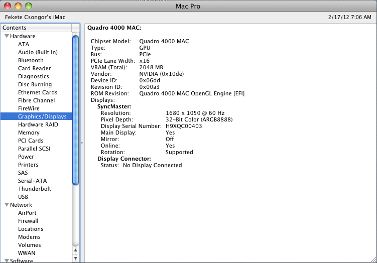

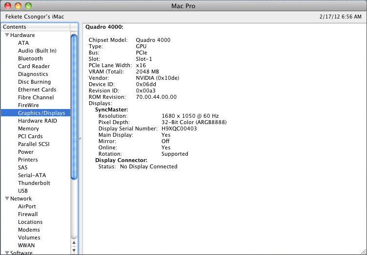

FecsoMAC Posted February 15, 2012 Share Posted February 15, 2012 Hi! I tried EFI string, I think this is the good way. I used the old OSX86Tools. Only thing what I don't know, what is the string of display port? <?xml version="1.0" encoding="UTF-8"?> <!DOCTYPE plist PUBLIC "-//Apple//DTD PLIST 1.0//EN" "http://www.apple.com/DTDs/PropertyList-1.0.dtd"> <plist version="1.0"> <dict> <key>Boot Graphics</key> <string>Yes</string> <key>EthernetBuiltIn</key> <string>Yes</string> <key>GraphicsEnabler</key> <string>no</string> <key>Kernel</key> <string>mach_kernel</string> <key>Kernel Flags</key> <string>npci=0x2000</string> <key>Theme</key> <string>Apple Default</string> <key>Timeout</key> <string>2</string> <key>device-properties</key> <string>5e0200000100000001000000520200000d00000002010c00d041030a000000000101060000010101060000007fff04001e00000072006f006d002d007200650076006900730069006f006e0000002700000051756164726f2034303030204d4143204f70656e474c20456e67696e65205b4546495d22000000400030002c006400650076006900630065005f00740079007000650000000b000000646973706c6179100000004e00560043004100500000001800000004000000000003000c00000000000007000000000e0000006e0061006d00650000000b000000646973706c617914000000400030002c006e0061006d0065000000120000004e5644412c446973706c61792d41100000006d006f00640065006c0000001300000051756164726f2034303030204d41430e0000004e00560050004d000000200000000100000000000000000000000000000000000000000000000000000014000000400031002c006e0061006d0065000000120000004e5644412c446973706c61792d4220000000400031002c0063006f006d00700061007400690062006c00650000000e0000004e5644412c4e564d6163220000005600520041004d002c0074006f00740061006c00730069007a0065000000080000000000008020000000400030002c0063006f006d00700061007400690062006c00650000000e0000004e5644412c4e564d616322000000400031002c006400650076006900630065005f00740079007000650000000b000000646973706c61791c0000006400650076006900630065005f00740079007000650000000f0000004e5644412c506172656e74</string> <key>PciRoot(0x0)/Pci(0x1,0x0)/Pci(0x0,0x0)</key> <dict> <key>@0,compatible</key> <string>NVDA,NVMac</string> <key>@0,device_type</key> <string>display</string> <key>@0,name</key> <string>NVDA,Display-A</string> <key>@1,compatible</key> <string>NVDA,NVMac</string> <key>@1,device_type</key> <string>display</string> <key>@1,name</key> <string>NVDA,Display-B</string> <key>NVCAP</key> <data> BAAAAAAAAwAMAAAAAAAABwAAAAA= </data> <key>NVPM</key> <data> AQAAAAAAAAAAAAAAAAAAAAAAAAAAAAAAAAAAAA== </data> <key>VRAM,totalsize</key> <string>0x80000000</string> <key>device_type</key> <string>NVDA,Parent</string> <key>model</key> <string>Quadro 4000 MAC</string> <key>name</key> <string>display</string> <key>rom-revision</key> <string>Quadro 4000 MAC OpenGL Engine [EFI]</string> </dict> </dict> </plist> Link to comment https://www.insanelymac.com/forum/topic/271396-another-method-to-gain-your-nvidia-qeci-more-cleaner-way/#findComment-1796278 Share on other sites More sharing options...
FecsoMAC Posted February 17, 2012 Share Posted February 17, 2012 I installed on other HDD Snow Leopard 10.6.8 and Nvidia Retail_256.02.25f1v1.dmg. Now I see 2 display output, but only the DVI is working. Why can I see more output? I tried with GraphicsEnabler and EFI. I think the problem is I have MAC version of the card, and the Chameleon GraphicsEnabler recognize my card as PC version!? I think I can solve it with EFI string, but I don't how... Link to comment https://www.insanelymac.com/forum/topic/271396-another-method-to-gain-your-nvidia-qeci-more-cleaner-way/#findComment-1797376 Share on other sites More sharing options...
Gringo Vermelho Posted February 17, 2012 Share Posted February 17, 2012 Like I said already, investigate display-cfg and NVCAP. Those control display type and order. Look for more information in the NVEnabler release thread over at the ProjectOSX forums. Also, you can delete this from your boot.plist, it doesn't do anything: PciRoot(0x0)/Pci(0x1,0x0)/Pci(0x0,0x0) @0,compatible NVDA,NVMac @0,device_type display @0,name NVDA,Display-A @1,compatible NVDA,NVMac @1,device_type display @1,name NVDA,Display-B NVCAP BAAAAAAAAwAMAAAAAAAABwAAAAA= NVPM AQAAAAAAAAAAAAAAAAAAAAAAAAAAAAAAAAAAAA== VRAM,totalsize 0x80000000 device_type NVDA,Parent model Quadro 4000 MAC name display rom-revision Quadro 4000 MAC OpenGL Engine [EFI] That up there is your device properties string before you converted it to hex. Only the device-properties string is being parsed, what I quoted here does not do anything at all, it's safe to delete. Link to comment https://www.insanelymac.com/forum/topic/271396-another-method-to-gain-your-nvidia-qeci-more-cleaner-way/#findComment-1797443 Share on other sites More sharing options...
FecsoMAC Posted February 25, 2012 Share Posted February 25, 2012 hi! I have solved the problem: :angel_not: http://www.projectosx.com/forum/index.php?s=&showtopic=370&view=findpost&p=16987 Thx, for all helps! Link to comment https://www.insanelymac.com/forum/topic/271396-another-method-to-gain-your-nvidia-qeci-more-cleaner-way/#findComment-1800573 Share on other sites More sharing options...
