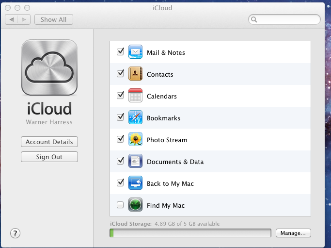

Everything with 10.7.2 & iCloud seems ok on my system! apart from 1 problem. Find My Mac.
I can select this option in iCloud no problem and them go and locate my mac at www.icloud.com BUT when every time I reboot Find My Mac is unselected.... I have an Apple Recovery partition and have installed the HD recovery update with 10.7.2 no problems but this is bugging me!
Works fine on my Macbook pro
any ideas?

I suspect that what may be happening is this.
If you have it Recovery HD etc. and you can select Find My Mac in iCloud then Recovery HD is certainly being used.
Then 1 of 2 things may happen:
1. As the Recovery HD is NOT normally visible from any system, some sort of configuration file is written to it.
You could check this by enabling the option and then checking before reboot.
2.Its more than likely put into the NVRAM as a boot parameter.
1.Then when you reboot it actually loads the Recovery HD and sets up Find My Mac and then continues to load as normal.
2. Reboot reads the NVRAM and sets a flag in Recover HD and continues...
Of course on a real Mac all this happens but on a hack it just reboots to your normal system and the setting gets turned off.
More than likely its number 2 though.
Could be a future option for Chameleon if we can find out what it actually does.

Installing Lion in VMWare Fusion (Mac Version) also makes the Recovery HD.
Good for checking a few things.
In a real Mac
Info is stored to NVRAM,
namely this key: fmm-mobileme-token-FMM
When you select Find My Mac.
On a Hack, there is no NVRAM
subsequently when you reboot the option is unticked.
Share this post
Link to post
there must be some way past this, the issue prob is with the boot loader!
slice has a boot loader with NVRAM emulation, maybe he can add the value.
