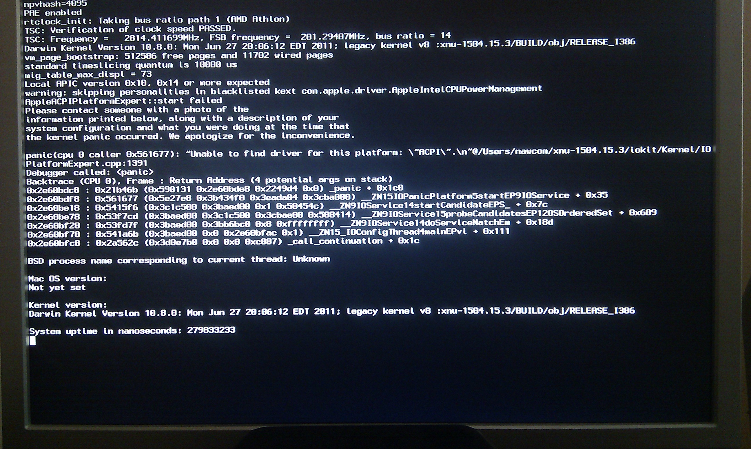

NickRiley Posted August 31, 2011 Share Posted August 31, 2011 I had a perfectly working 10.6.4 running on my hardware, untill I decided to upgrade to 10.6.8 following the guide from here and using the combo update. I installed the custom 10.8 kernel according to the guide. after restart I've got the KP [see attachment] I've been trying many things, boot with -f flag, create new .mkext, installing AppleACPIPlatform.kext & IOPCIFamily.kext from 10.6.7, nothing helped, not even being able to boot with -s. I was looking for a solution for days now already, and I'm out of ideas, so any other ideas and help will be really appreciated! Link to comment https://www.insanelymac.com/forum/topic/266874-kernel-panic-after-updating-to-1068-need-help-booting/ Share on other sites More sharing options...
smartie77 Posted September 1, 2011 Share Posted September 1, 2011 IOPCIfamily and AppleACPIplatform need to be of the same release version. Are you sure both are of 10.6.7 ? try booting with npci=0x2000. As you are on a AMD as far as I can see, try adding a maxmem and a bus ratio value. for example to boot -v arch=i386 npci=0x2000 busratio=20 maxmem=2096 Link to comment https://www.insanelymac.com/forum/topic/266874-kernel-panic-after-updating-to-1068-need-help-booting/#findComment-1743151 Share on other sites More sharing options...
Gringo Vermelho Posted September 1, 2011 Share Posted September 1, 2011 Here's how to find your actual bus ratio: http://www.insanelymac.com/forum/index.php?showtopic=240542 Link to comment https://www.insanelymac.com/forum/topic/266874-kernel-panic-after-updating-to-1068-need-help-booting/#findComment-1743169 Share on other sites More sharing options...
