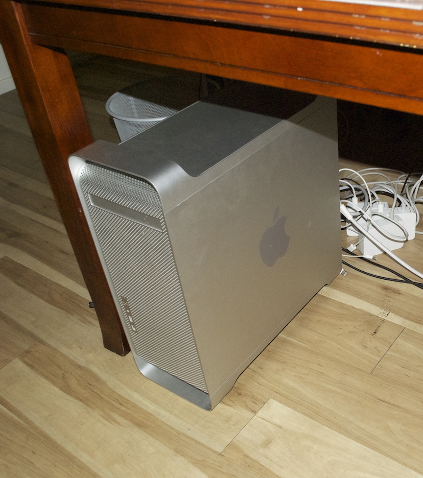

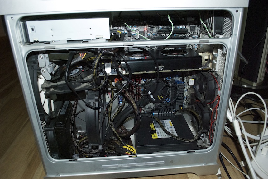

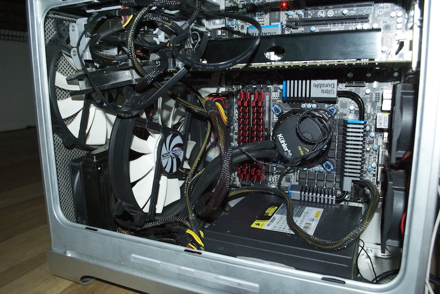

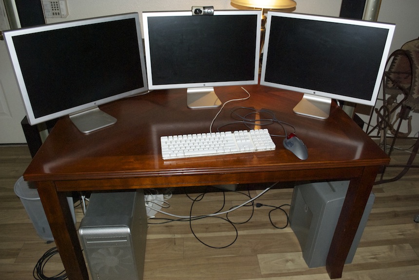

MacModifier Posted February 11, 2012 Author Share Posted February 11, 2012 PunkNugget, I have pretty much come to the same conclusion that I will not get sleep working with this version of OS X. I swapped out another hard drive today installed a fresh version of Lion on it and tried tons of stuff to make sleep work. I poured over the forums for anything I thought might work and tried it. I changed and read up on all the bios commands to see if there was something that would get it working. I have spent too much time on this, I really want this feature to work so, I don't have to leave it on all day when not in use but that is just a small issue in the big picture of the Hackintosh world. Outside of that I am really happy with my Hack. Here are some pictures of my current Hack, I took a G5 Mac Case and did a mod on it. I did this a while back, in fact, I sold the original board and Quad core that I had in it when I ran Snow Leopard and upgraded to a i5 2500K, I have 16 Gigs of ram in this machine. The upgrade difference after selling the Quad Core and Old board was around $140, not bad, you can't upgrade a 1 and a half year old real mac for 150 I still hold out hope that there's an answer out there but it will have to come to me cause I can't find it as of now. Link to comment https://www.insanelymac.com/forum/topic/266415-i-need-help-with-gigabyte-ga-z68x-ud5-b3-sleep-wake-issue/page/2/#findComment-1795081 Share on other sites More sharing options...
PunkNugget Posted February 12, 2012 Share Posted February 12, 2012 I see that you got 3 monitors. Is that only for working for the PC end of things or do have those 3 working for Mac OS X Lion 10.7 as well? BTW, Nice build... PS - you ought to go on TonyMacX86.com and register and post your question on their forums as well... Link to comment https://www.insanelymac.com/forum/topic/266415-i-need-help-with-gigabyte-ga-z68x-ud5-b3-sleep-wake-issue/page/2/#findComment-1795366 Share on other sites More sharing options...
MacModifier Posted February 12, 2012 Author Share Posted February 12, 2012 I see that you got 3 monitors. Is that only for working for the PC end of things or do have those 3 working for Mac OS X Lion 10.7 as well? BTW, Nice build... PS - you ought to go on TonyMacX86.com and register and post your question on their forums as well... Thanks, the only thing I wish, when I was doing my case, I did not destroy the power button case on the front inside, I found a guy in another thread that builds and sells the harnesses (for around 30 bucks) so that you can plug right into the Mac hook up and plug it right into your PC motherboard and everything works the front power button and usb connections, oh well, next time I will know better. Your build is a real BEAST! I would love to have that much power in my hands, 1K for each processor is a little out of my budget but your system ROCKS! I am registered at Tony Macs and I have posted there too. Not spent that much time with the post like in here though. I actually emailed Tony Mac for help, not sure I will here back he is supper busy I am sure. My guess he probably gets thousands of email a day. Last, I found a guy that has the same board in another thread with everything working, I really think that the system profile needs to be edit for this graphics card so that it will link to it on the wake command. Little out of my reach right now. I am only a Mac person, all three monitors work PERFECTLY with Lion. It's a ATI RADEON HD4850 x2 HD (Got it for 70 bucks on craigslist, good deal lol) there are four DVI connections on the card. I used [url="http://www.insanelymac.com/forum/topic/279450-why-insanelymac-does-not-support-tonymacx86/"]#####[/url] with ATI Inject then on the reboot I installed the ATI Patch for 10.7.2 and it works great. Link to comment https://www.insanelymac.com/forum/topic/266415-i-need-help-with-gigabyte-ga-z68x-ud5-b3-sleep-wake-issue/page/2/#findComment-1795374 Share on other sites More sharing options...

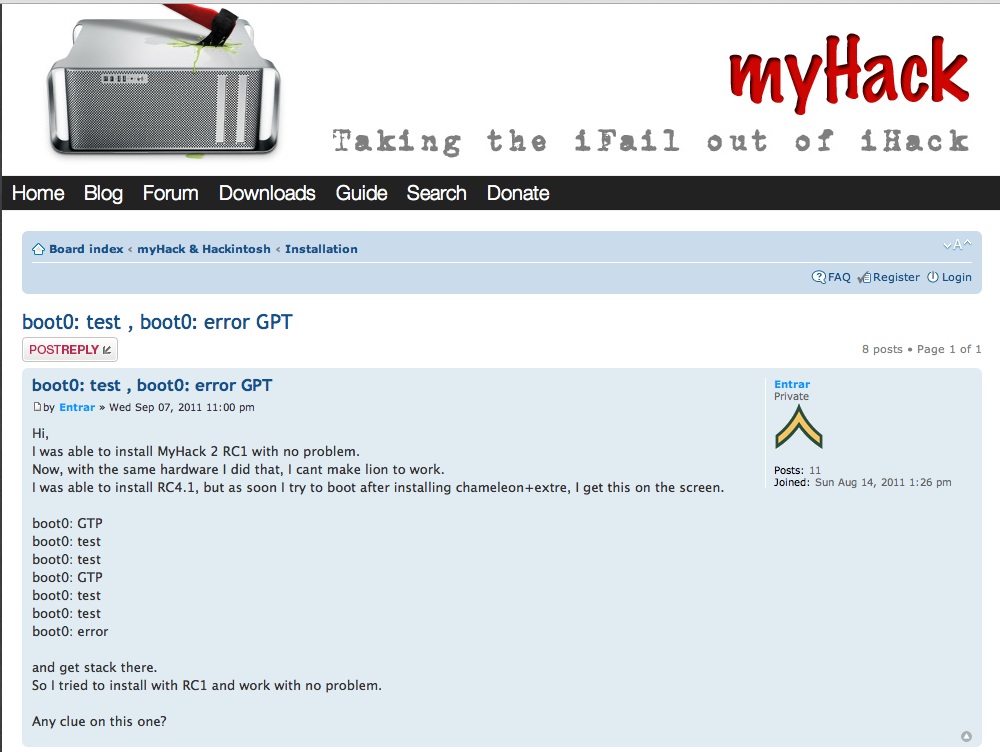

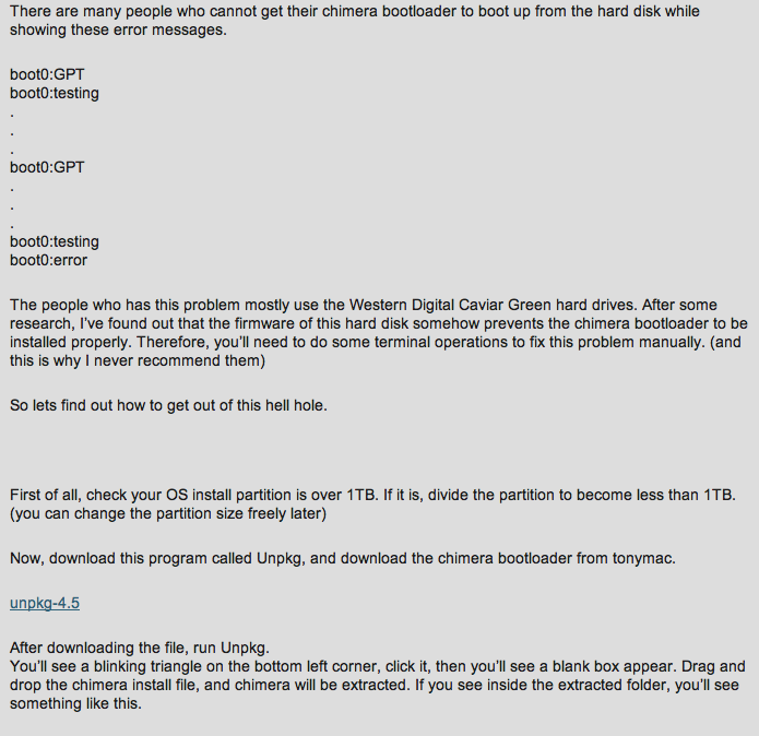

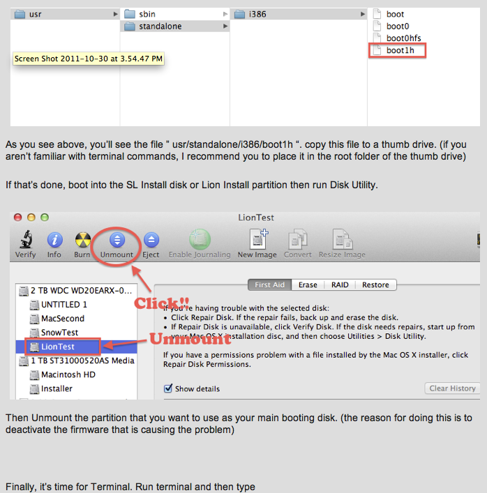

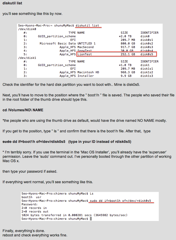

MacModifier Posted February 14, 2012 Author Share Posted February 14, 2012 *** UPDATE ONE LESS PROBLEM SOLVED, CLOSER TO THE SLEEP FIX *** Well I thought by only having one hard drive installed, with a clean install of Lion from Tony Mac [url="http://www.insanelymac.com/forum/topic/279450-why-insanelymac-does-not-support-tonymacx86/"]#####[/url], and no partitions and the boot loader working from the installed drive that sleep would come online, unfortunately that did not happen however I did find a solution to a problem that many other people have. The solution is not mine, it was the hard work of mymac4music.com. I tired many solutions and this is the only one that worked and it was pretty easy to do. If you get this error boot 0: GPT boot 0: test boot 0: test boot 0: GPT boot 0: test boot 0: test boot 0 error or something close to it on the boot up after installing Tony Macs Chimera or the boot loader Chameleon go to this website http://www.mymac4mus...10/boot0-error/ and follow this guys tutorial and it will fix the problem. Here are screen shots of the tutorial, thanks MyMac4Music Link to comment https://www.insanelymac.com/forum/topic/266415-i-need-help-with-gigabyte-ga-z68x-ud5-b3-sleep-wake-issue/page/2/#findComment-1796233 Share on other sites More sharing options...
