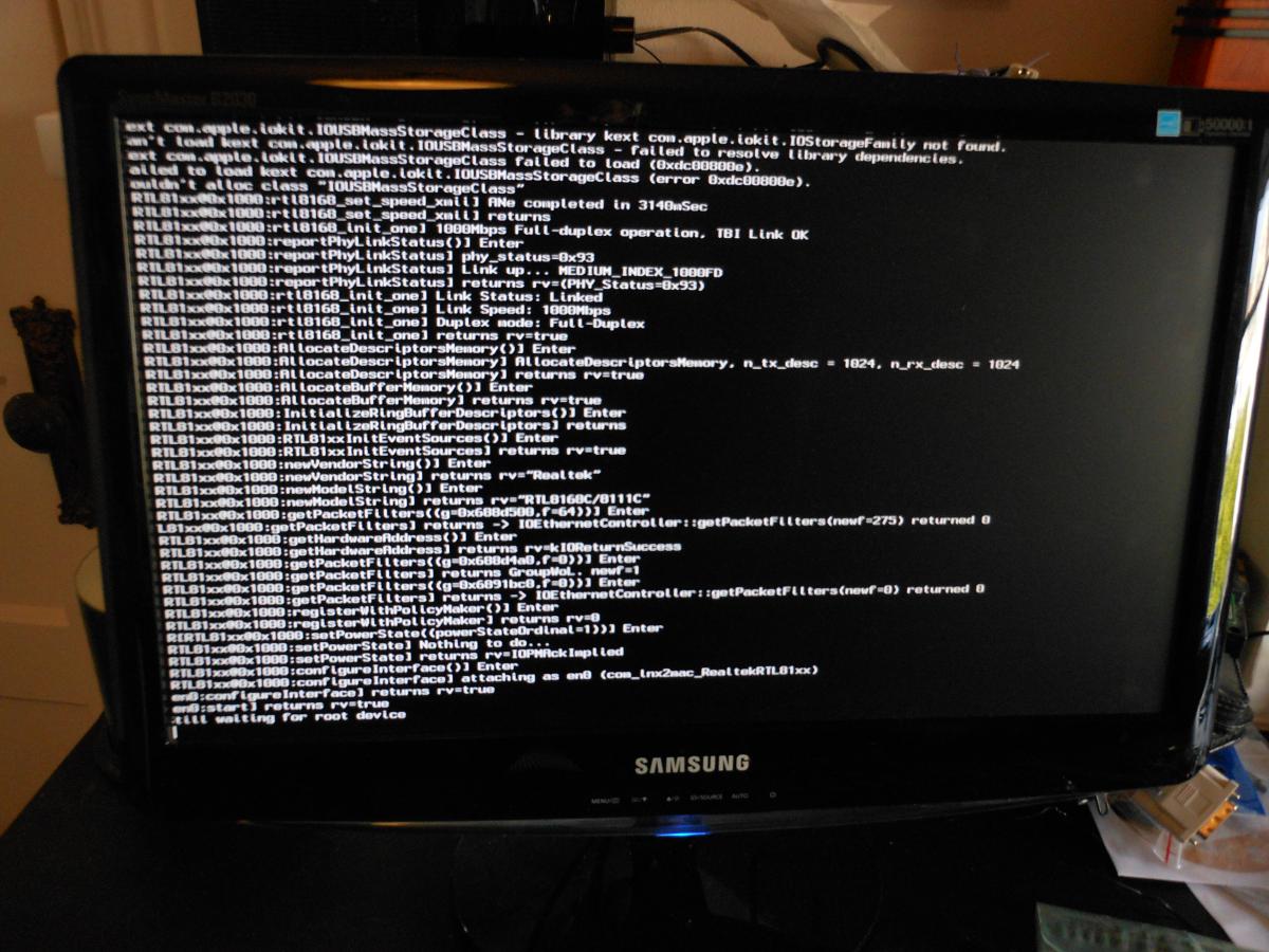

gusz Posted July 19, 2012 Share Posted July 19, 2012 I have an Intel D945GCLF2D and successfully installed Snow Leopard using Nozyczek's Guide. Now I want to install Lion based on Install Disk downloaded from Apple store. I followed Nozyczek's Guide for Lion and made the USB install stick, but no joy, when I boot from install stick the boot stalls at "Still waiting for root device". Initially the stall was directly preceded by "couldn't alloc class IOUSBMassStorageClass", and based on Googling that message I tried boot flags npci=0x2000 and USBFix=Yes, still no joy. Based on further ideas in this thread I then installed Lnx2Mac's Realtek RTL81xx Driver on the boot stick, still shows IOUSBMassStorageClass error, followed by messages about RTL81xx adapter, and then the "Still waiting ...." message. I've attached hereto the screen image at the stall. I'd appreciate ideas on what's wrong and how to fix. Thx, Gus Link to comment https://www.insanelymac.com/forum/topic/264760-guide-os-x-lion-on-intel-d945gclf2-atom-330/page/3/#findComment-1835277 Share on other sites More sharing options...
gusz Posted July 24, 2012 Share Posted July 24, 2012 I later got this to work, using Nozyczek's Guide, with the following changes: -Revert to Lion 10.7.3 (I had downloaded latest Lion 10.7.4 from Apple site, which causes USB problems on some hackintoshs) -Use RealtekRTL81xx-0_0_90 kexts (download on Nozyczek is 0_0_67) -Use Chimera-1.11.0 (download on Nozyczek is 1.7) Link to comment https://www.insanelymac.com/forum/topic/264760-guide-os-x-lion-on-intel-d945gclf2-atom-330/page/3/#findComment-1836611 Share on other sites More sharing options...
