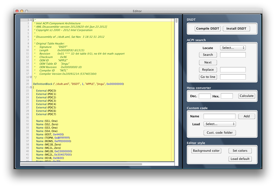

Jingu Posted November 25, 2012 Share Posted November 25, 2012 Okay. I made some progress with getting AppleSmartBatteryManager to work in Lion 64-bit. My dsdt ComplianceRevision is 1 (32-bit width integers). However, I discovered that I can force the dsdt header ComplianceRevision to any number I want. From the iasl instructions: AML Code Generation: -r<Revision> Override table header Revision (1-255) So with: iasl -r2sa dsdt.dsl I forced the dsdt header ComplianceRevision to 2. But it's still not working. At least with ComplianceRevision 2, now I get battery numbers instead of zeros like in revision 1, but it's still the wrong numbers. It should have worked even with ComplianceRevision 1, because according to the ACPI Spec manual, the battery specs are in DWORD format (32-bit). I decided to try an old Snow Leopard install in 64-bit and surprise!: AppleSmartBatteryManager works fine in Snow Leopard 64-bit, whether the ComplianceRevision is 1 or 2. Now, the only difference between the Snow Leopard dsdt and the Lion dsdt is that in Lion there is a conversion to 8-bit EC access with Zprod's formula: Method (B1B2, 2, NotSerialized) { Or (ShiftLeft (Arg1, 0x08), Arg0, Local0) Return (Local0) } Where Arg1 is the high 8-bit EC number and Arg0 is the low 8-bit EC number. Those are 8-bit numbers. Maybe that's where the problem is in Lion. But, I'm using the same formula in Lion to read the fan rpm with 8-bit EC access and fan rpm reading works fine in lion 32-bit or 64-bit. Something tells me that the problem is still with the conversion to 8-bit EC access. Maybe that conversion adds extra bits that throw off the calculations. Like for example, the formula to retrieve the power units is: Method (BIF0, 0, NotSerialized) { If (ECAV ()) { If (BSLF) { Store (B1MD, Local0) } Else { Store (B1B2 (BMD0, BMD1), Local0) } If (LNotEqual (Local0, 0xFFFF)) { ShiftRight (Local0, 0x0F, Local1) And (Local1, One, Local1) XOr (Local1, One, Local0) } } Else { Store (Ones, Local0) } Return (Local0) } Where BMD0 and BMD1 are the low and high 8-bit EC numbers for the power units and the value is returned in Local0. Works fine in Lion 32-bit, but doesn't work in Lion 64-bit. Link to comment https://www.insanelymac.com/forum/topic/264597-hp-dvx-acpi-3x4x-battery-driver-106107/page/9/#findComment-1868809 Share on other sites More sharing options...
RehabMan Posted November 25, 2012 Share Posted November 25, 2012 Okay. I made some progress with getting AppleSmartBatteryManager to work in Lion 64-bit. My dsdt ComplianceRevision is 1 (32-bit width integers). However, I discovered that I can force the dsdt header ComplianceRevision to any number I want. From the iasl instructions: So with: I forced the dsdt header ComplianceRevision to 2. But it's still not working. At least with ComplianceRevision 2, now I get battery numbers instead of zeros like in revision 1, but it's still the wrong numbers. It should have worked even with ComplianceRevision 1, because according to the ACPI Spec manual, the battery specs are in DWORD format (32-bit). I decided to try an old Snow Leopard install in 64-bit and surprise!: AppleSmartBatteryManager works fine in Snow Leopard 64-bit, whether the ComplianceRevision is 1 or 2. Now, the only difference between the Snow Leopard dsdt and the Lion dsdt is that in Lion there is a conversion to 8-bit EC access with Zprod's formula: Method (B1B2, 2, NotSerialized) { Or (ShiftLeft (Arg1, 0x08), Arg0, Local0) Return (Local0) } Where Arg1 is the high 8-bit EC number and Arg0 is the low 8-bit EC number. Those are 8-bit numbers. Maybe that's where the problem is in Lion. But, I'm using the same formula in Lion to read the fan rpm with 8-bit EC access and fan rpm reading works fine in lion 32-bit or 64-bit. Something tells me that the problem is still with the conversion to 8-bit EC access. Maybe that conversion adds extra bits that throw off the calculations. Like for example, the formula to retrieve the power units is: Method (BIF0, 0, NotSerialized) { If (ECAV ()) { If (BSLF) { Store (B1MD, Local0) } Else { Store (B1B2 (BMD0, BMD1), Local0) } If (LNotEqual (Local0, 0xFFFF)) { ShiftRight (Local0, 0x0F, Local1) And (Local1, One, Local1) XOr (Local1, One, Local0) } } Else { Store (Ones, Local0) } Return (Local0) } Where BMD0 and BMD1 are the low and high 8-bit EC numbers for the power units and the value is returned in Local0. Works fine in Lion 32-bit, but doesn't work in Lion 64-bit. Without seeing the definition for the EC registers, I can't be sure, but what about the access to B1MD above?? Link to comment https://www.insanelymac.com/forum/topic/264597-hp-dvx-acpi-3x4x-battery-driver-106107/page/9/#findComment-1868842 Share on other sites More sharing options...
Jingu Posted November 25, 2012 Share Posted November 25, 2012 Thanks. Here's my full dsdt. My BAT0 is a little complex. It's doing all kinds of calculations based on what it detects. dsdt.zip Link to comment https://www.insanelymac.com/forum/topic/264597-hp-dvx-acpi-3x4x-battery-driver-106107/page/9/#findComment-1868845 Share on other sites More sharing options...
RehabMan Posted November 25, 2012 Share Posted November 25, 2012 Thanks. Here's my full dsdt. My BAT0 is a little complex. It's doing all kinds of calculations based on what it detects. B1MD is a 16-bit field into the same structure where BMD0 and BMD1 are. Seems you have more 16-bit to 8-bit conversion to do on this DSDT... Unless you are certain the code that touches these is not being executed. The best way to do this is to convert all these to 8-bit by renaming / splitting into two parts: // example //B1VL, 16, B1V0, 8, B1V1, 8 B1RC, 16, B1FC, 16, B1MD, 16, B1ST, 16, B1CC, 16, B1DC, 16, B1DV, 16 Then fix all the code that references them. Read access is easy, because you just call B1B2 method. Write access requires a bit more coding... Link to comment https://www.insanelymac.com/forum/topic/264597-hp-dvx-acpi-3x4x-battery-driver-106107/page/9/#findComment-1868851 Share on other sites More sharing options...
Jingu Posted November 25, 2012 Share Posted November 25, 2012 The original 16-bit EC registers: B0VL, B0RC, B0FC, B0MD, B0ST, B0CC, B0DC, B0DV are mirrored into B1VL, B1RC, B1FC, B1MD, B1ST, B1CC, B1DC, B1DV But these B1 series are not used. That's why I did not convert them to 8-bit EC registers. It works fine in Lion 32-bit without the conversion. I also tried the dsdt with all those B1 variables converted to 8-bit. It still did not work in Lion 64-bit or Mountain Lion. A system kext regression is never optimal, but in the meantime until permanent solution, I found an old AppleACPIPlatform kext v1.3.5 from 10.6.7 (Snow Leopard): http://www.osx86.net...8_mount_...html With that, AppleSmartBatteryManager works fine in Lion 64-bit and Mountain Lion. The problem could be with the recent AppleACPIPlatform kexts in 64-bit. I had AppleSmartBattery working fine in 64-bit in Snow Leopard 10.6.8. So, it really looks like the problem in 64-bit is with the recent AppleACPIPlatform kexts, at least for me. Screenshot of AppleSmartBatteryManager working in Mountain Lion with AppleACPIPlatform v1.3.5 (from Snow Leopard 10.6.7) Link to comment https://www.insanelymac.com/forum/topic/264597-hp-dvx-acpi-3x4x-battery-driver-106107/page/9/#findComment-1868876 Share on other sites More sharing options...
RehabMan Posted November 25, 2012 Share Posted November 25, 2012 The original 16-bit EC registers: B0VL, B0RC, B0FC, B0MD, B0ST, B0CC, B0DC, B0DV are mirrored into B1VL, B1RC, B1FC, B1MD, B1ST, B1CC, B1DC, B1DV But these B1 series are not used. That's why I did not convert them to 8-bit EC registers. It works fine in Lion 32-bit without the conversion. I also tried the dsdt with all those B1 variables converted to 8-bit. It still did not work in Lion 64-bit or Mountain Lion. A system kext regression is never optimal, but in the meantime until permanent solution, I found an old AppleACPIPlatform kext v1.3.5 from 10.6.7 (Snow Leopard): http://www.osx86.net...8_mount_...html With that, AppleSmartBatteryManager works fine in Lion 64-bit and Mountain Lion. The problem could be with the recent AppleACPIPlatform kexts in 64-bit. I had AppleSmartBattery working fine in 64-bit in Snow Leopard 10.6.8. So, it really looks like the problem in 64-bit is with the recent AppleACPIPlatform kexts, at least for me. Screenshot of AppleSmartBatteryManager working in Mountain Lion with AppleACPIPlatform v1.3.5 (from Snow Leopard 10.6.7) Yes, the new 64-bit AppleACPIPlatform.kext is a lot more picky. You have to go over things in your DSDT with a fine-tooth-comb. Usually this involves actually reviewing the DSDT code, and trying to understand it as much as you can. Then you can start to eliminate non-critical parts (ie. hard coding results), to simplify, find problem areas, etc. It requires a lot of time, trial-and-error style, and a lot of studying the code to discern its intent. Link to comment https://www.insanelymac.com/forum/topic/264597-hp-dvx-acpi-3x4x-battery-driver-106107/page/9/#findComment-1868882 Share on other sites More sharing options...

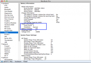

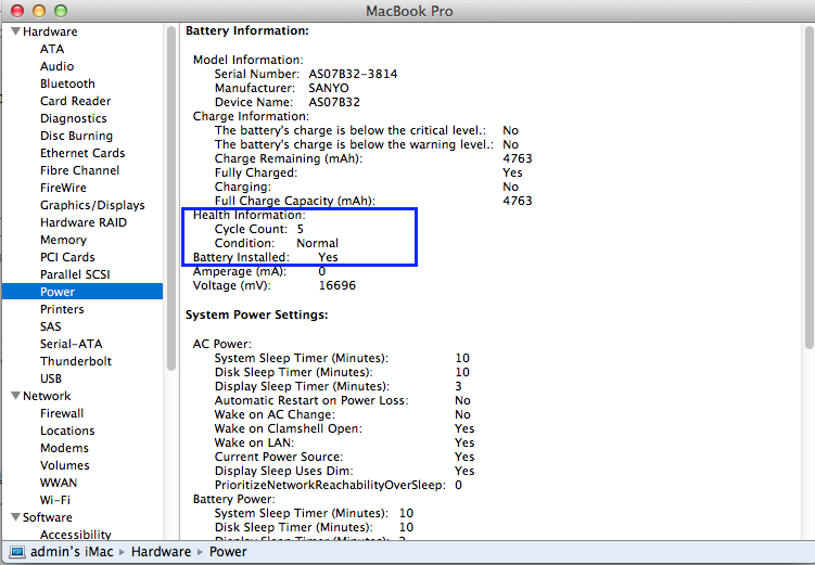

Alex009988 Posted January 20, 2013 Share Posted January 20, 2013 Hi. I added to SmartBattery the one thing -> Approximation of the number of cycles. It gives me condition my battery I found on AppleSmartBattery.cpp this thing //rehabman: zprood's technique of expanding the _BIF to include cycle count uint32_t cycleCnt = 0; if (acpibat_bif->getCount() > BIF_CYCLE_COUNT) { cycleCnt = GetValueFromArray(acpibat_bif, BIF_CYCLE_COUNT); } setCycleCount(cycleCnt); correct cycleCnt = 0 to -1, and remove setCycleCount(cycleCnt); Because the actual number of cycles can be 0, if the battery is new, but the -1 is unlikely. then add /* If the cycle count can not be obtained through _BIF, it will be estimated according to the design capacity and maximum capacity, otherwise will be set based on the acquired cycle count from _BIF*/ if (-1 == cycleCnt) { if (fDesignCapacity > fMaxCapacity) { setCycleCount((fDesignCapacity - fMaxCapacity) / 7); } else { setCycleCount((fMaxCapacity - fDesignCapacity) / 7); } } else { setCycleCount(cycleCnt); } Ver2_AppleSmartBatteryManager.kext.zip 1 Link to comment https://www.insanelymac.com/forum/topic/264597-hp-dvx-acpi-3x4x-battery-driver-106107/page/9/#findComment-1882244 Share on other sites More sharing options...

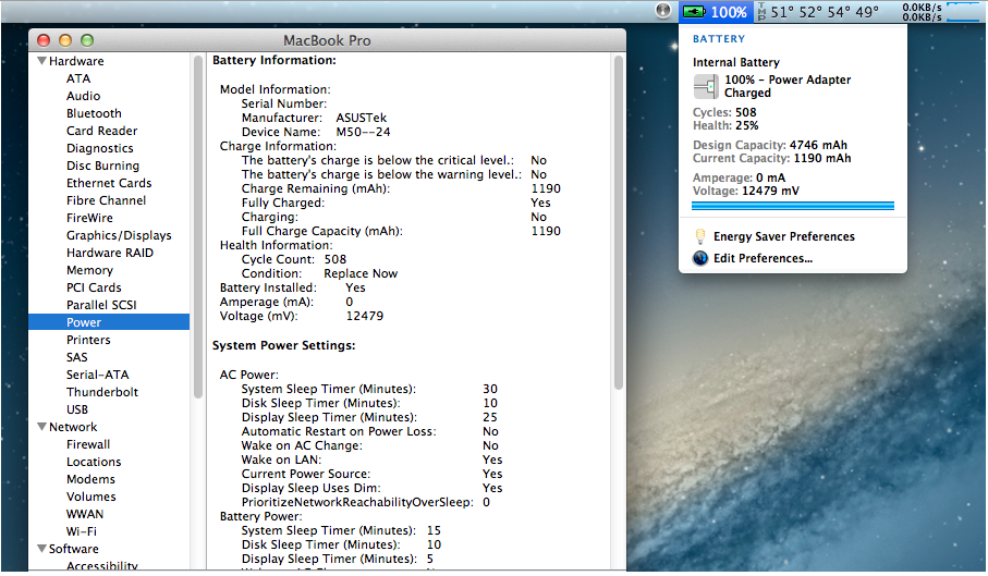

Jingu Posted April 19, 2013 Share Posted April 19, 2013 Okay. For my Asus M60J: Rehabman's new AppleSmartBatteryManager works perfect in Mountain Lion and Lion 64-bit, but only if I use the Snow Leopard 10.6.8 AppleACPIPlatform. AppleSmartBatteryManager just doesn't work in 64-bit with vanilla AppleACPIPlatform from Lion and Mountain Lion, but it works in 32-bit with Vanilla Lion AppleACPIPlatform. Link to comment https://www.insanelymac.com/forum/topic/264597-hp-dvx-acpi-3x4x-battery-driver-106107/page/9/#findComment-1908811 Share on other sites More sharing options...
RehabMan Posted April 19, 2013 Share Posted April 19, 2013 Okay. For my Asus M60J: Rehabman's new AppleSmartBatteryManager works perfect in Mountain Lion and Lion 64-bit, but only if I use the Snow Leopard 10.6.8 AppleACPIPlatform. AppleSmartBatteryManager just doesn't work in 64-bit with vanilla AppleACPIPlatform from Lion and Mountain Lion, but it works in 32-bit with Vanilla Lion AppleACPIPlatform. It is because newer versions of 64-bit AppleACPIPlatform.kext are very picky that EC access from DSDT code is only 8-bit. So you have to change the DSDT to convert all access to EC registers larger than 8-bit to use only 8-bit access. See post #1 of this thread for examples. The specifics will depend on the code in your DSDT. Link to comment https://www.insanelymac.com/forum/topic/264597-hp-dvx-acpi-3x4x-battery-driver-106107/page/9/#findComment-1908820 Share on other sites More sharing options...
fingerr Posted October 6, 2013 Share Posted October 6, 2013 ASUS NOTEBOOK. Working both in Snow Leopard 10.6.8 and Lion 10.7.2 Yes. Got gsly's AppleSmartBatteryManager to work on my Asus M60J. In the interest of helping other Asus notebook owners with similar dsdts, I'll provide how I made it happen. But, it is not my intent to steal gsly's glory. All this was made possible thanks to him. I'm only adapting his project to my Asus notebook. Also thanks to bcc9 for deriving the formula for taking a 16-bit reference and breaking it down into high-byte and low-byte to do byte (8-bit) references. Back in post# 47, gsly provided abundant comments for another Asus notebook dsdt, the G53S. My BAT0 dsdt is nearly identical. So, all those comments on that Asus dsdt were really helpful in helping me figuring out what was going on with my own dsdt. Thanks gsly for doing that. My Asus doesn't seem to use much SMBus access to the battery register sensors. It's making much use of EC access to the battery registers. The Asus notebook BAT0 dsdt is quite different from the HP BAT0 dsdt. It has several more Method subroutines and it does all kinds of calculations based on what it detects. In the end, it does quite a good job of returning the battery values in accordance with the ACPI 3.x specs. The problem is that it was set to convert the units mAh to mWh and 2 things were happening wrong with that conversion. Design Capacity and Last Full Charge Capacity were kept in mAh and were 1000 times too small while the Current Capacity was converted to mWh. That created remaining percentages of over 115,000% and the inability to calculate remaining time. So, my goal was to prevent the conversion and fix it so it returns mAh units. If the original Methods FBIF, CBIF and CBST in your Asus dsdt look like below, then the modification should work for you. CODE // If the Methods FBIF, CBIF and CBST in your original Asus notebook battery look like below, the // recommended modifications shoud work for you Method (FBIF, 5, NotSerialized) { Store (Arg0, PUNT) Store (Arg1, Local1) Store (Arg2, Local2) If (LEqual (PUNT, 0x00)) { Multiply (Local1, 0x0A, Local1) Multiply (Local2, 0x0A, Local2) } Store (Arg0, Index (PBIF, 0x00)) Store (Local1, Index (PBIF, 0x01)) Store (Local2, Index (PBIF, 0x02)) Store (Local2, LFCC) Store (Arg3, Index (PBIF, 0x03)) Store (Arg4, Index (PBIF, 0x04)) Divide (Local1, 0x0A, Local3, Local5) Store (Local5, Index (PBIF, 0x05)) Divide (Local1, 0x64, Local3, Local6) Store (Local6, Index (PBIF, 0x06)) Store (Local6, LOW2) Divide (Local1, 0x64, Local3, Local7) Store (Local7, Index (PBIF, 0x07)) Store (Local7, Index (PBIF, 0x08)) } Method (CBIF, 0, NotSerialized) { If (PUNT) { Store (DerefOf (Index (PBIF, 0x04)), Local0) Add (Local0, 0x01F4, Local0) Divide (Local0, 0x03E8, Local1, DVOT) Store (Zero, Index (PBIF, 0x00)) Multiply (DerefOf (Index (PBIF, 0x01)), DVOT, Index (PBIF, 0x01 )) Multiply (DerefOf (Index (PBIF, 0x02)), DVOT, Index (PBIF, 0x02 )) Multiply (DerefOf (Index (PBIF, 0x05)), DVOT, Index (PBIF, 0x05 )) Multiply (DerefOf (Index (PBIF, 0x06)), DVOT, Index (PBIF, 0x06 )) Multiply (DerefOf (Index (PBIF, 0x07)), DVOT, Index (PBIF, 0x07 )) Multiply (DerefOf (Index (PBIF, 0x08)), DVOT, Index (PBIF, 0x08 )) } } Method (CBST, 0, NotSerialized) { If (PUNT) { Multiply (DerefOf (Index (PBST, 0x01)), DVOT, Index (PBST, 0x01 )) Multiply (DerefOf (Index (PBST, 0x02)), DVOT, Index (PBST, 0x02 )) } } 1) IN SNOW LEOPARD -mWh Units If you're fine with having the units in mWh, then all you need to do is change Store (Zero, Index (PBIF, 0x00)) to Store (One, Index (PBIF, 0x00)) in the Method CBIF. That's it! iStat will report a battery current about 10 times too high, but the capacity values and remaining times and percentages will all be accurate. -mAh Units This is the preferred unit in Mac OS X. It requires a little editing of Methods FBIF, CBIF and CBST. For some reason, when retrieving values in mAh, the capacities will be 1.85% too small. 1.85% doesn't sound like much, but my capacities are in the 4000 mAh range. That was causing them to be about 79 mAh too small compared to the mAh values in Windows 7 with BatteryEater Pro. It was also causing a little percentage anomaly. Percentages would go straight from 100% down to 97% when discharging and straight from 97% to 100% when recharging, never seeing 98% and 99%. That's why I'm applying a 1.85% correction (that's times 185 divided by 10,000) Here's the Mehod FBIF, CBIF and CBST edits to accurately have to units in mAh. Just replace your Methods FBIF, CBIF and CBST with my corrected ones. Asus_SnowLeo_Corrected.dsl.zip 2) LION 10.7.2 -mAh Units Okay. I was in for a surprise on this one. My battery EC registers are all 16-bit at Offset (0xA0) from B0VL to B0DV. They're all mirrored by B1VL to B1DV also 16-bit. But those B1xx variables are never executed in the conditional loops, so the battery EC registers that matter are the B0xx. I converted all of those to 8-bit reference based on bcc9's method. I did this for the all 8 battery B0xx registers and one B0SN register. With all that conversion to 8-bit, gsly's AppleSmartBattery was still working flawless in Snow Leopard, as a testimony that my 8-bit conversion was done correctly. But it wasn't working Lion, all I had was 0, -1 and unknown for the values. Then I made a puzzling discovery. I discovered that the only reason why the Fill Battery Information Method (Method FBIF) or Method _BIF was failing in Lion, was not because the battery EC registers were accessed in 16-bit, but because the Method that extracts the Battery OEM information string (Method BIF9) has an incompatibility with Lion and that alone was causing the whole Method FBIF or Method _BIF to fail. There's something incompatible with this Method BIF9 CODE Method (BIF9, 0, NotSerialized) { Name (BSTR, Buffer (0x20) {}) Store (SMBR (RDBL, BADR, 0x21), Local0) If (LNotEqual (DerefOf (Index (Local0, Zero)), Zero)) { Store (MNAM, BSTR) Store (Zero, Index (BSTR, 0x04)) } Else { Store (DerefOf (Index (Local0, 0x02)), BSTR) Store (Zero, Index (BSTR, DerefOf (Index (Local0, One)))) } Return (BSTR) } I don't know how to fix that one. *** EDIT 26 Nov **: SOLVED!! With the help of gsly rewriting Method SMBR to read Word and Block (string) 8-bit at a time, combined with deleting one line in Method SMBR, SmartBattery fully works now in Lion and can extract the battery name string without crashing. Below is my dsdt corrected for Lion on my Asus M60J. Attached are also the complete edit instructions that should apply to all Asus core i3/i5/i7 Notebooks. Asus_Coreix_Lion_Edits.zipAsusM60J_Lion.zip Hi all, I've tried to modify DSDS of my Asus U30Jc i5-560M equipped notebook for Mountain Lion and result is battery showing 0% and remaining time says "Calculating", but I can see info about battery in system profiler. Values in system profiler seems to be cosmic: - Charge remainig: 429445 - Amperage (mA): 429645937 - Voltage (mV): -230 Without any changes made to stock DSDT battery shows 0%, no battery information in system profiler, but remaining time seems to be caltulated properly. Can someone have a look at my DSDT (DSDT2IGPUBAT2.dsl) and check what can be the cause? Thanks in advance and best regards, fingerr. DSDT2IGPUBAT2.dsl.zip Asus_Coreix_Lion_Edits.zip Link to comment https://www.insanelymac.com/forum/topic/264597-hp-dvx-acpi-3x4x-battery-driver-106107/page/9/#findComment-1951291 Share on other sites More sharing options...
