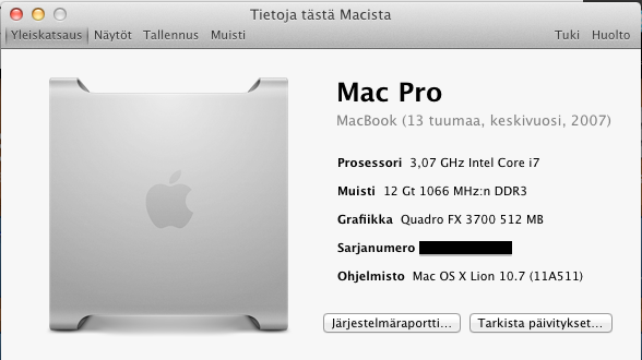

Well.... sort of works.. no sound yet, but it should be easy .. using GB X58A-UD7 (bios F8) and i needed to use DSDT from Snow because it is made for that BIOS. Fast boot !
Had to make fresh install, used Kakewalk (One thing that is from Sweden aqnd works !, not many others ...) and it was fast as they say. Some minor things / kext's from Snow.. added RealtekRTL81xx - for net, AHCIPortInjector - now is my NTFS - HDD's also in Devices. Using GraphicsEnabler=YES, got both screens and Quadro FX 3700 correctly identified. No QE/CI yet...
In one sentence: Works, but has some "features".
