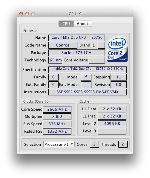

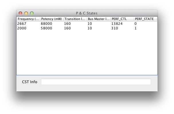

nyolc8 Posted July 20, 2011 Share Posted July 20, 2011 Anyone can help me to get speedstep working? I have these on the end with the bdmesg: Read HFS+ file: [hd(0,4)/Extra/DSDT.aml] 15601 bytes. Read HFS+ file: [hd(0,4)/Extra/SSDT.aml] 554 bytes. Read HFS+ file: [hd(0,4)/Extra/SSDT-1.aml] 338 bytes. Read HFS+ file: [hd(0,4)/Extra/SSDT-2.aml] 939 bytes. ACPI table not found: SSDT-3.aml FADT: Restart Fix applied! FADT: Using custom DSDT! Found ACPI CPU: CPU0 Found ACPI CPU: CPU1 Found ACPI CPU: CPU2 Found ACPI CPU: CPU3 SSDT with CPU C-States generated successfully SSDT with CPU P-States generated successfully RSDT: Added 5 SSDT table(s) Starting Darwin x86_64 (I extracted the ssdt files with Everest on Windows and just copied them to /Extra. Is this right or do I need to modify something in them?) In com.apple.Boot.plist I have <key>GeneratePStates</key><string>Yes</string> <key>GenerateCStates</key><string>Yes</string> <key>dropSSDT</key><string>Yes</string> I have this with SMC Monitor: (So there is two states - In Windows it gets down to 2000 when not used.) But the MHz is always 2666: I have these kexts (all unmodified): AppleIntelCPUPowerManagement - Loaded, Satisfied AppleIntelCPUPowerManegementClient - Loaded, Satisfied AppleHPET - Loaded, Satisfied AppleLPC - Loaded, Satisfied AppleRTC - Loaded, Satisfied What else do I need to get this work? Link to comment https://www.insanelymac.com/forum/topic/262801-how-to-get-speedstep-work/ Share on other sites More sharing options...
Noam AA Posted July 20, 2011 Share Posted July 20, 2011 you have a working speedstep CPU-X does not display core speed, you can use SMC Monitor for this Link to comment https://www.insanelymac.com/forum/topic/262801-how-to-get-speedstep-work/#findComment-1717809 Share on other sites More sharing options...
nyolc8 Posted July 21, 2011 Author Share Posted July 21, 2011 Thanks for the reply, and how to set SMC Monitor to see this? Cause I can't get anything from it just the p-c states. Link to comment https://www.insanelymac.com/forum/topic/262801-how-to-get-speedstep-work/#findComment-1718393 Share on other sites More sharing options...
