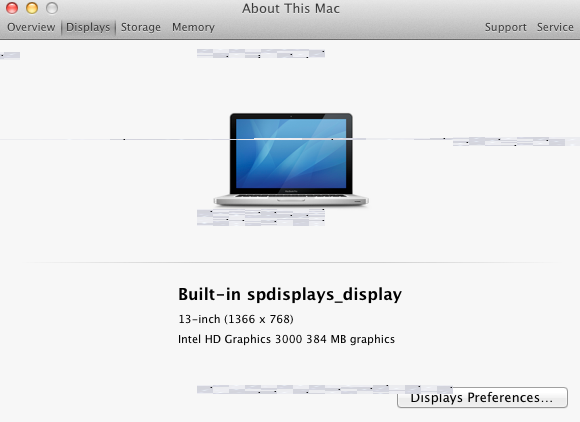

Veeper Posted August 18, 2011 Share Posted August 18, 2011 Just got a E6320 with no Nvidia, only Intel HD graphics. Lion is installed and updated to 10.7.1 Not working: Wireless Keyboard mouse (will try other kext here shortly) Graphics are detected but I'm getting tearing. Haven't tried power or CPU settings testing yet. I'm a huge noob at this so I'll keep my chatter to a minimum here and let you guys know if something does/doesn't work as I go at this. Thanks. Link to comment https://www.insanelymac.com/forum/topic/261313-osx-on-dell-latitude-e6520/page/2/#findComment-1736680 Share on other sites More sharing options...
Aim Posted August 18, 2011 Share Posted August 18, 2011 Hey, I'm wondering if you didn't anything specific to get the graphics to work. Do you have native resolution and QE/CI? If so, what smbios did you use? Any DSDT mods? Thanks, C. Just got a E6320 with no Nvidia, only Intel HD graphics. Lion is installed and updated to 10.7.1 Not working: Wireless Keyboard mouse (will try other kext here shortly) Graphics are detected but I'm getting tearing. Haven't tried power or CPU settings testing yet. I'm a huge noob at this so I'll keep my chatter to a minimum here and let you guys know if something does/doesn't work as I go at this. Thanks. Link to comment https://www.insanelymac.com/forum/topic/261313-osx-on-dell-latitude-e6520/page/2/#findComment-1736829 Share on other sites More sharing options...
Veeper Posted August 22, 2011 Share Posted August 22, 2011 Hey, I'm wondering if you didn't anything specific to get the graphics to work. Do you have native resolution and QE/CI? If so, what smbios did you use? Any DSDT mods? Thanks, C. Greetings! I used TonyMac's install method for 10.6.3 -> 10.6.7 Then I set the system identifier to MacBookPro 8,1 and Lion had no issues installing after that, and it automagically saw that I had an Intel 3000. Initially I had some graphics tearing, but today it hasn't shown up yet. I'll see if it shows up again. EDIT - Screen tearing is still a huge issue. I must have the wrong device ID or something? QE/CI seems to be working aside from that. Res shows up as native 1366x768. I'll paste a screenshot on here from that notebook shortly. Hope this helps. (Me being such a hackintosh n00b, you may need to be more specific with your question, or ask me for screenshot or information from the console.) Anyone (6420, 6520, 6320) have a sleepenabler or power kexts/edit/config suggestion for me? EDIT - going to see if I can get a DSDT from Maldon. Link to comment https://www.insanelymac.com/forum/topic/261313-osx-on-dell-latitude-e6520/page/2/#findComment-1738482 Share on other sites More sharing options...
Veeper Posted September 2, 2011 Share Posted September 2, 2011 I forgot to reply to this and add that 10.7.1 and Chimera 1.5 seemed to fix all of my video issues. Also there's an extra PCIe slot in the 6320 which allowed me to add a BCM94322 which seemed to work OOB in Lion. Still no sleep. Anyone have luck with sleep on their 6320/6420/6520? Link to comment https://www.insanelymac.com/forum/topic/261313-osx-on-dell-latitude-e6520/page/2/#findComment-1743526 Share on other sites More sharing options...
