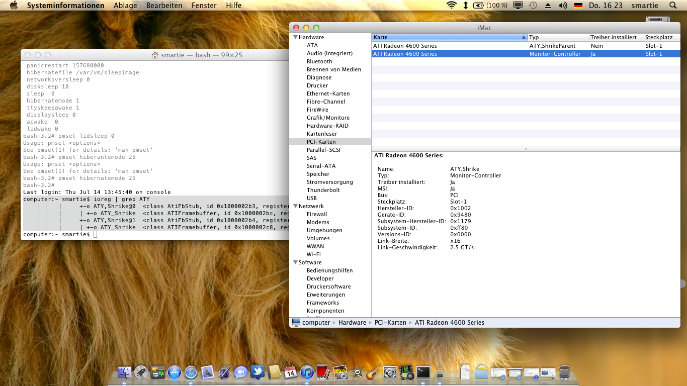

smartie77 Posted July 14, 2011 Author Share Posted July 14, 2011 I think I have found the answer to my DVD player crash, I am not actually using the Shrike frame buffer This post (http://www.tonymacx86.com/viewtopic.php?f=15&t=19991) had the same issue. He used a different frame buffer and then converted back to his original and after that it worked. I ran the ioreg |grep ATY to see what frame buffer I am using, and it shows as the default RadeonFramebuffer, not shrike. So if I can somehow activate the frame buffer I think DVD player will work. Any ideas? 192-168-1-5:~ p_board$ ioreg | grep ATY | | | +-o ATY,ATY,RadeonFramebuffer@0 <class AtiFbStub, id 0x1000002$ | | | | +-o ATY_ATY,RadeonFramebuffer <class ATIFramebuffer, id 0x10$ | | | +-o ATY,ATY,RadeonFramebuffer@1 <class AtiFbStub, id 0x1000002$ | | | | +-o ATY_ATY,RadeonFramebuffer <class ATIFramebuffer, id 0x10$ 192-168-1-5:~ p_board$ this is mine in lion : computer:~ smartie$ ioreg | grep ATY | | | +-o ATY,Shrike@0 <class AtiFbStub, id 0x1000002b3, registered,$ | | | | +-o ATY_Shrike <class ATIFramebuffer, id 0x1000002bc, regist$ | | | +-o ATY,Shrike@1 <class AtiFbStub, id 0x1000002b4, registered,$ | | | | +-o ATY_Shrike <class ATIFramebuffer, id 0x1000002c8, regist$ now i don't know if 10.6.8 is using this output where the name of the Fb is actually printed in ioreg but "RadeonFramebuffer" is no valid fb name . Ati uses funny names like shrike,motmot,megalodon and so .. also the system profiler should show the name of the FB used : you might want to boot with AtiConfig=Shrike ( if you use my boot file or the SL/Lion chameleon.shrike installer I link to you should use Shrike by default as long as GraphicsEnabler=Yes is used ) . To avoid confusion : you can only have 1. my ATY_INIT and GE=NO 2. or one of my boot loaders ( have all shrike and 9480 as ID ) in combination with GE = YES OR 3. a newer generic chameleon/chimera/pc-efi with AtiConfig=xyz actually these are three options to choose from. also take note that no "RadeonHD.kext" or "RadeonPCIdump.kext" ( any next from 3rd partys that deal with the gpu ) should be in your system -- just in case you played with that solution before .. Link to comment https://www.insanelymac.com/forum/topic/260786-multi-update-qeci-kextpack-1068-new-mobility4650-kexts-toshiba/page/2/#findComment-1714521 Share on other sites More sharing options...
Peter Board Posted July 15, 2011 Share Posted July 15, 2011 this is mine in lion : computer:~ smartie$ ioreg | grep ATY | | | +-o ATY,Shrike@0 <class AtiFbStub, id 0x1000002b3, registered,$ | | | | +-o ATY_Shrike <class ATIFramebuffer, id 0x1000002bc, regist$ | | | +-o ATY,Shrike@1 <class AtiFbStub, id 0x1000002b4, registered,$ | | | | +-o ATY_Shrike <class ATIFramebuffer, id 0x1000002c8, regist$ now i don't know if 10.6.8 is using this output where the name of the Fb is actually printed in ioreg but "RadeonFramebuffer" is no valid fb name . Ati uses funny names like shrike,motmot,megalodon and so .. also the system profiler should show the name of the FB used : you might want to boot with AtiConfig=Shrike ( if you use my boot file or the SL/Lion chameleon.shrike installer I link to you should use Shrike by default as long as GraphicsEnabler=Yes is used ) . To avoid confusion : you can only have 1. my ATY_INIT and GE=NO 2. or one of my boot loaders ( have all shrike and 9480 as ID ) in combination with GE = YES OR 3. a newer generic chameleon/chimera/pc-efi with AtiConfig=xyz actually these are three options to choose from. also take note that no "RadeonHD.kext" or "RadeonPCIdump.kext" ( any next from 3rd partys that deal with the gpu ) should be in your system -- just in case you played with that solution before .. Ok, I changed over to your newer Boot Chamelon, the Lion compatible one and got rid of ATI_INIT.KEXT. If I boot with a -s for single user mode, and do an ioreg | grep ATY, it is now giving me the Shrike frame buffer. However when I go to boot, after getting the normal boot logo, or watching what happens using -v, I get a black screen and my monitor says that there is no signal - in other words, its activating the card, but I think the LVDS connection, or however my Internal LCD display is connected is not being turned on. I tried both your LVDS version and the vga,hdmi lvds ati4600 kext. I have an ati 545v (ati mobility 4670, model 9488, not the 9480 in your toshiba laptop). So if I can figure out how to modify the frame buffer for my screen, I think I'll have a winner. Where did your newer Chameleon come from, as it seems to have been designed for my video card, I just need to use that new Script you have to modify the ATI4600 Kext to match my display output. If I go back to your older Boot file, then I get my screen activated, but no Shrike frame buffer, just the generic Raedon one. I tested out a theory as well that using your ati4600 kext wth vga output, I might get the Lion compatible Chameleon going but it also produced a blank screen. However I am able to confirm that the VGA output is working using the at4600 kext, but since I am not using shrike, but the generic frame buffer, I am not sure if its your code that makes this work, or just the generic frame buffer. I have attached my screenshots of both the Graphics Display and the Framebuffer in System Profiler. I feel like the solution is very close, I now know that the newer Boot loader fixes the selecting of the Shrike Frame buffer, I just don't know why my monitor output goes blank using the newer bootloader. I tried the RC5 build 1083 which doesn't detect my card, but tried using AtiConfig=Shrike, but it simply gave me a Vesa display at 1024x768. No 3d acceleration ati4670withvga.tiff AtiFrameBuffer.tiff Link to comment https://www.insanelymac.com/forum/topic/260786-multi-update-qeci-kextpack-1068-new-mobility4650-kexts-toshiba/page/2/#findComment-1714968 Share on other sites More sharing options...
smartie77 Posted July 16, 2011 Author Share Posted July 16, 2011 Ok, I changed over to your newer Boot Chamelon, the Lion compatible one and got rid of ATI_INIT.KEXT. If I boot with a -s for single user mode, and do an ioreg | grep ATY, it is now giving me the Shrike frame buffer. However when I go to boot, after getting the normal boot logo, or watching what happens using -v, I get a black screen and my monitor says that there is no signal - in other words, its activating the card, but I think the LVDS connection, or however my Internal LCD display is connected is not being turned on. I tried both your LVDS version and the vga,hdmi lvds ati4600 kext. I have an ati 545v (ati mobility 4670, model 9488, not the 9480 in your toshiba laptop). So if I can figure out how to modify the frame buffer for my screen, I think I'll have a winner. Where did your newer Chameleon come from, as it seems to have been designed for my video card, I just need to use that new Script you have to modify the ATI4600 Kext to match my display output. If I go back to your older Boot file, then I get my screen activated, but no Shrike frame buffer, just the generic Raedon one. I tested out a theory as well that using your ati4600 kext wth vga output, I might get the Lion compatible Chameleon going but it also produced a blank screen. However I am able to confirm that the VGA output is working using the at4600 kext, but since I am not using shrike, but the generic frame buffer, I am not sure if its your code that makes this work, or just the generic frame buffer. I have attached my screenshots of both the Graphics Display and the Framebuffer in System Profiler. I feel like the solution is very close, I now know that the newer Boot loader fixes the selecting of the Shrike Frame buffer, I just don't know why my monitor output goes blank using the newer bootloader. I tried the RC5 build 1083 which doesn't detect my card, but tried using AtiConfig=Shrike, but it simply gave me a Vesa display at 1024x768. No 3d acceleration the different device Id is obviously the culprit. ATY_init is software based and contains only device ID ( 9480 ) and the Shrike info to load. YOu can easily edit the kexts plist so that it uses 9488 and Shrike ( or any other Framebuffer ) - However, the Bootloading solution is compiled fixed into the boot header of chameleon. In both loaders I use and re-offer here in my topics this is 9480 and Shrike alone. Chameleon is open source code, you can download it and modify the contents of the ATI.C file for device ID 9488 and recompile it, this would need a Xcode environment set up on your OSX and set up svn tree to the chameleon subversion repo. I can't help you out with that - I took the boot as work from others ( after trying out tons of different ones ). The first "boot" was ok, working all the time, but I needed a new one for Lion, so I found the chameleon installer on a russian site , and the one who did it obviously has the same card and same lids table as I do .. was just luck to find it. However, I can not help . I only know how it works for this card, this ID and this connection, naturally- so you might need to dig deeper into Ati personality patching , this here is a good starting point at this board . This is a excessive topic for 46xx mobility patching. The most basic knowledge I gained there. Link to comment https://www.insanelymac.com/forum/topic/260786-multi-update-qeci-kextpack-1068-new-mobility4650-kexts-toshiba/page/2/#findComment-1715364 Share on other sites More sharing options...

Peter Board Posted July 18, 2011 Share Posted July 18, 2011 I got the Radeon Dump tool and ran it over my Video bios dump So I now know my connector info, I just have to use this to make the right Shrike Connector changes I also tested using the original 10.6.8 ati4600 kext as I realised that it had my Device ID already in it, so I don't have to modify the Device ID bit. Using the older Chameleon boot it starts up fine but uses the generic frame buffer. So to get my graphics card going I just need the right Chameleon boot loader, which is actually your newer Lion compatible one. After that I simply need to use the info below to make up a modified version of the no_pain script, to set my connector info right. So all I need to do now is work out the right hex sequence from the info below. 192-168-1-2:atimobility p_board$ ./radeon_bios_decode < 1002_9488.rom ATOM BIOS Rom: SubsystemVendorID: 0x1462 SubsystemID: 0xae11 IOBaseAddress: 0xa000 Filename: SV36833a.bin BIOS Bootup Message: 113-AE111M96-H01-1GB M96 DDR3 128bit 675e/800m PCI ID: 1002:9488 Connector at index 0 Type [@offset 45434]: VGA (1) Encoder [@offset 45438]: INTERNAL_KLDSCP_DAC1 (0x15) i2cid [@offset 45478]: 0x90, OSX senseid: 0x1 Connector at index 1 Type [@offset 45444]: HDMI-A (11) Encoder [@offset 45448]: INTERNAL_UNIPHY (0x1e) i2cid [@offset 45501]: 0x91, OSX senseid: 0x2 Also attached the ioreg output for the LCD display as shown when using Generic Framebuffer incase thats needed to work out some of the values Hi Smartie, I'm almost there. I can boot my LCD screen now! My screen does this funny flicker thing every once in a while when I move things around or move the mouse. if I can work out why, then I am all fixed! DVD Player Works now. I have modified the script to this so far.... using info from IoReg explorer. Port 0 (vga) \x02\x00\x00\x00\x40\x00\x00\x00\x09\x01\x00\x00\x02\x01\x00\x03| Original Shrike \x10\x00\x00\x00\x10\x00\x00\x00\x00\x01\x00\x00\x00\x10\x00\x01| New Shrike Port 1 (hdmi) \x00\x04\x00\x00\x04\x03\x00\x00\x00\x01\x00\x00\x10\x00\x01\x01| Original Shrike \x00\x08\x00\x00\x04\x02\x00\x00\x00\x01\x00\x00\x00\x01\x01\x02| New Shrike I've put a more detailed version of what I have worked out so far here Detailed info Link to comment https://www.insanelymac.com/forum/topic/260786-multi-update-qeci-kextpack-1068-new-mobility4650-kexts-toshiba/page/2/#findComment-1716369 Share on other sites More sharing options...
Peter Board Posted July 19, 2011 Share Posted July 19, 2011 Hi Smartie, I'm almost there. I can boot my LCD screen now! My screen does this funny flicker thing every once in a while when I move things around or move the mouse. if I can work out why, then I am all fixed! DVD Player Works now. I have modified the script to this so far.... using info from IoReg explorer. Port 0 (vga) \x02\x00\x00\x00\x40\x00\x00\x00\x09\x01\x00\x00\x02\x01\x00\x03| Original Shrike \x10\x00\x00\x00\x10\x00\x00\x00\x00\x01\x00\x00\x00\x10\x00\x01| New Shrike Port 1 (hdmi) \x00\x04\x00\x00\x04\x03\x00\x00\x00\x01\x00\x00\x10\x00\x01\x01| Original Shrike \x00\x08\x00\x00\x04\x02\x00\x00\x00\x01\x00\x00\x00\x01\x01\x02| New Shrike I've put a more detailed version of what I have worked out so far here Detailed info Fixed it, just needed to make Feature 09 01, instead of 00 01 00 08 00 00 - HDMI connector 04 02 00 00 - ATY,ControlFlags, Number, 0x204 as found in IO Registry Explorer 09 01 - Features #define LVDS compatible 0x09 + FEATURE_USE_INTERNAL 0x01 00 00 - unknown 00 - Transmitter #define UNIPHY 0x00 01 - Encoder #define DIG2 0x01 // = DIGB 01 - HotPlug ID (connector at index) 02 - SenseID Link to comment https://www.insanelymac.com/forum/topic/260786-multi-update-qeci-kextpack-1068-new-mobility4650-kexts-toshiba/page/2/#findComment-1716862 Share on other sites More sharing options...
smartie77 Posted July 20, 2011 Author Share Posted July 20, 2011 Fixed it, just needed to make Feature 09 01, instead of 00 01 00 08 00 00 - HDMI connector 04 02 00 00 - ATY,ControlFlags, Number, 0x204 as found in IO Registry Explorer 09 01 - Features #define LVDS compatible 0x09 + FEATURE_USE_INTERNAL 0x01 00 00 - unknown 00 - Transmitter #define UNIPHY 0x00 01 - Encoder #define DIG2 0x01 // = DIGB 01 - HotPlug ID (connector at index) 02 - SenseID wonderful. So we have a new device ID with a unique solution. Please add it to a topic where it is useful for future searchers. Notice to L500 visitors : this find here is not for you- "peter board" has a slightly different card, so toshiba 4650m (devid 9480 ! ) owners: stick with my kexts and booter(s) or (Aty_init). Link to comment https://www.insanelymac.com/forum/topic/260786-multi-update-qeci-kextpack-1068-new-mobility4650-kexts-toshiba/page/2/#findComment-1717378 Share on other sites More sharing options...
