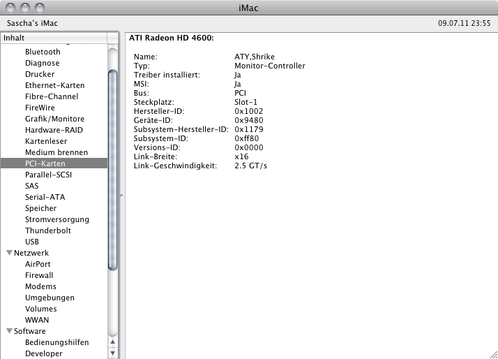

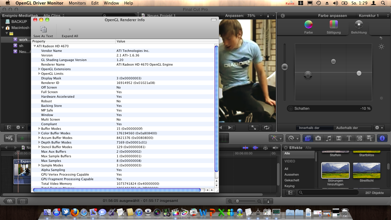

Peter Board Posted July 4, 2011 Share Posted July 4, 2011 I finally got my ATI Mobilty 4670 (aka 545v) card going with your kexts! What I did was use ATI Injector (http://www.kexts.com/view/1262-aty_init_lion_+_snow.html) instead of your Boot Rom and used the Easy Beast install option of [url="http://www.insanelymac.com/forum/topic/279450-why-insanelymac-does-not-support-tonymacx86/"]#####[/url] 3.7.3 from TonyMacx86. I put DevIDs of 1002 (ATI) 9488 ( = 4670 mobility radeon family ) in both Ati4600Controller.kext and AtiRadeonX2000.kext After that I modified my com.apple.Boot.plist as follows: <dict> <key>Kernel</key> <string>mach_kernel</string> <key>Kernel Flags</key> <string>arch=i386</string> <key>GraphicsEnabler</key> <string>Yes</string> <key>Timeout</key> <string>2</string> <key>Legacy Logo</key> <string>Yes</string> <key>EthernetBuiltIn</key> <string>Yes</string> <key>USBBusFix</key> <string>Yes</string> </dict> End result, I can now boot Snow Leopard 10.6.8 with full 3D,QE/CI. Now I just need to get my webcam going and my wireless NIC (possibly I might need to get a USB one as my builtin realtek RTL8191SE doesn't seem to have a driver). Their seems to be a USB version of this, but the driver doesn't seem to work with my internal version. If I want to access the internet with my Mac OS X, I boot up under Windows, load Vmware Player and boot off the hard disk partition. It then gets access via my windows driver. Anyone got a fix for the wireless NIC? Link to comment https://www.insanelymac.com/forum/topic/260786-multi-update-qeci-kextpack-1068-new-mobility4650-kexts-toshiba/#findComment-1708191 Share on other sites More sharing options...
Peter Board Posted July 6, 2011 Share Posted July 6, 2011 After a bit more testing I have a few bugs (its not working 100% as I thought). OpenGL / 3D seems to be working as in iTunes I can run the visualiser and the 3d screen savers work. However DVD player crashes on startup (can't get to the options to choose Deinterlace mode that some people talk about). This might be because of a video overlay issue that I think exists. Also by using Evocam I found out that my Bison Cam NB Pro is actually working, I could see myself. However when I run Photo Booth, I get a black screen, even though it says its using the Web camera fine. So I think it might be a video overlay problem. This would explain why under Vmware the camera was working fine (using the Vmware video driver with its on video overlay routine) but not working when running with ATI driver. I have a attached a screenshot of my ATI as shown in System Profiler. I am using the SMBIOS from [url="http://www.insanelymac.com/forum/topic/279450-why-insanelymac-does-not-support-tonymacx86/"]#####[/url] for iMac 11,2. I tried putting the ATI rom file in the /Extra's folder but possibly the ATI injector is over ridding this as it didn't seem to make any difference. Link to comment https://www.insanelymac.com/forum/topic/260786-multi-update-qeci-kextpack-1068-new-mobility4650-kexts-toshiba/#findComment-1709669 Share on other sites More sharing options...

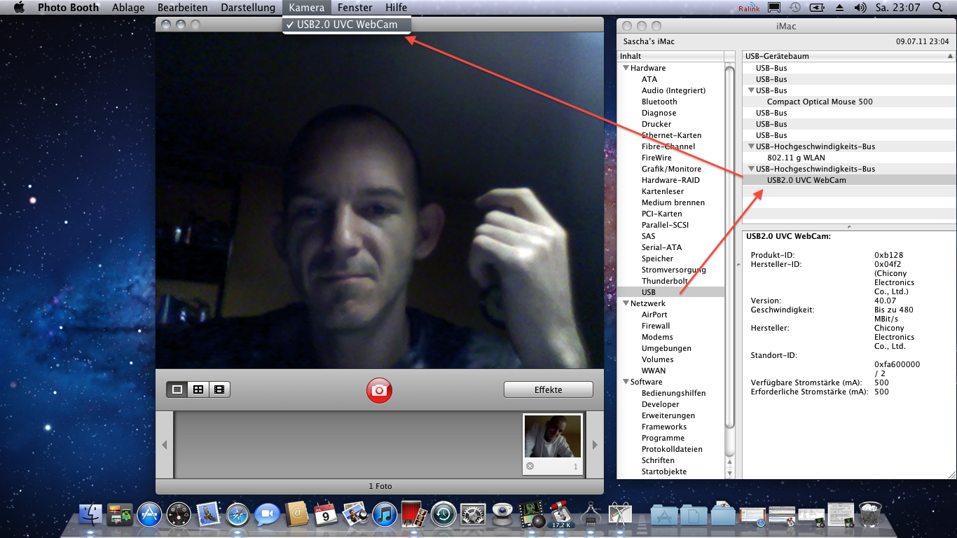

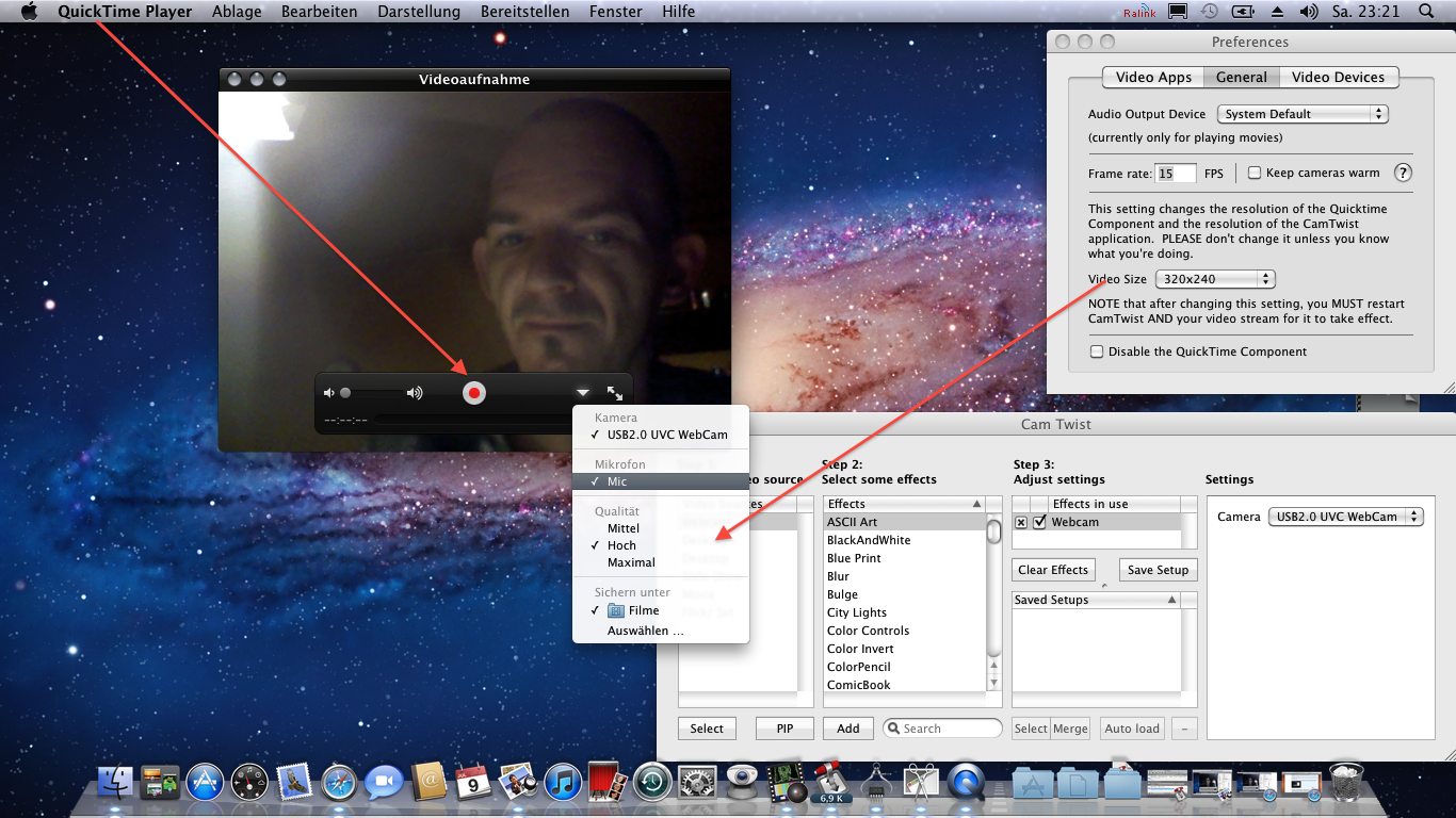

smartie77 Posted July 6, 2011 Author Share Posted July 6, 2011 congrats. For your Webcam problem : I have the same issue with the built-in Webcam ( vendor : chicory ). But you can use Photobooth,ichat and Quicktime X with it : Grab a copy of the freeware "cam twist" and install. Best put the icon for cam twist in the dock. Launch Photobooth, then launch cam twist and activate the webcam from there ( double-click "webcam" under source ), you will see now video in the Apple Apps. It is no overlay problem but Apples fault : the UVC protocol is not correct in OSX, so only external devices work the right way, but not the internal cams. EvoCam works always. They have written some better implementation, but that does not help Apples Apps. For adjustment of light/contrast and so on you best use "iglasses". It works with the cam twist trick. Tragically cam twist no longer works in Lion ( testing right now with modded kexts and a new booted - 1366x768 ,power modes already works with shrike and ati kexts but opengl seems not working). A Webcam that works in every case and in every program with sound and good quality is Logitech C310 , 720p HD model. It even works in FaceTime under Lion. ( Photobooth needs 3d working, can't test yet ). Link to comment https://www.insanelymac.com/forum/topic/260786-multi-update-qeci-kextpack-1068-new-mobility4650-kexts-toshiba/#findComment-1709876 Share on other sites More sharing options...
Peter Board Posted July 7, 2011 Share Posted July 7, 2011 congrats. For your Webcam problem : I have the same issue with the built-in Webcam ( vendor : chicory ). But you can use Photobooth,ichat and Quicktime X with it : Grab a copy of the freeware "cam twist" and install. Best put the icon for cam twist in the dock. Launch Photobooth, then launch cam twist and activate the webcam from there ( double-click "webcam" under source ), you will see now video in the Apple Apps. It is no overlay problem but Apples fault : the UVC protocol is not correct in OSX, so only external devices work the right way, but not the internal cams. EvoCam works always. They have written some better implementation, but that does not help Apples Apps. For adjustment of light/contrast and so on you best use "iglasses". It works with the cam twist trick. Tragically cam twist no longer works in Lion ( testing right now with modded kexts and a new booted - 1366x768 ,power modes already works with shrike and ati kexts but opengl seems not working). A Webcam that works in every case and in every program with sound and good quality is Logitech C310 , 720p HD model. It even works in FaceTime under Lion. ( Photobooth needs 3d working, can't test yet ). I have attached the debug output from the DVD player crash. I am not sure however if you can see the text file, I uploaded it again as an RTF. Are you able to give me any guidance as to why its crashing from this? Thanks for your work on the KEXT's to get my 4670 card going. Peter Process: DVD Player [190] Path: /Applications/DVD Player.app/Contents/MacOS/DVD Player Identifier: com.apple.DVDPlayer Version: 5.4 (5.4) Build Info: DVDPlayer-54000401~1 Code Type: X86 (Native) Parent Process: launchd [107] Date/Time: 2011-07-07 13:14:07.993 +0000 OS Version: Mac OS X 10.6.8 (10K540) Report Version: 6 Interval Since Last Report: 9256 sec Crashes Since Last Report: 932 Per-App Interval Since Last Report: 21 sec Per-App Crashes Since Last Report: 11 Anonymous UUID: 8CB9C14E-CFBE-4BC7-8702-466717EE19DA Exception Type: EXC_BREAKPOINT (SIGTRAP) Exception Codes: 0x0000000000000002, 0x0000000000000000 Crashed Thread: 0 Dispatch queue: com.apple.main-thread Application Specific Information: TF->from:1 to:0 *** Terminating app due to uncaught exception 'NSInvalidArgumentException', reason: '-[NSCFString bytes]: unrecognized selector sent to instance 0x6565020' DVD_Player_Crash.rtf Link to comment https://www.insanelymac.com/forum/topic/260786-multi-update-qeci-kextpack-1068-new-mobility4650-kexts-toshiba/#findComment-1710289 Share on other sites More sharing options...
Peter Board Posted July 8, 2011 Share Posted July 8, 2011 ok, I went out and bought a Logitech c910 and it works like a charm. Picture quality is fabulous, as is 1080p HD recording. So I am glad I purchased it. The other thing is that Logitech support it for Mac and it comes with HD video calling software for Mac and Windows. As for the DVD player, I have defaulted the system to use VLC instead of MAC DVD player. If anyone can ever figure out why Mac DVD player crashes, that would be great. But apart from that the system runs a treat now. Just waiting on my Realtek USB wifi to arrive from eBay which has Mac OS drivers and I can go back to wireless instead of ethernet cable (used to make this post). Thanks Smartie for the modified Kexts. One day I might learn to do the changes myself. But my Internal screen on my MSI AIO 2400 which has the mobility 4670 works fine with your Kexts. I ended up dumping my ATI rom using Everest and got rid of the ATI_init.kext and set the ATI rom to enabled in my com.apple.Boot.plist file. So the basic modifications are, use your two ATI kexts, used [url="http://www.insanelymac.com/forum/topic/279450-why-insanelymac-does-not-support-tonymacx86/"]#####[/url] to set Mac11,2 profile, dumped ATI 1002_9488.rom using everest and update boot.plist file. Link to comment https://www.insanelymac.com/forum/topic/260786-multi-update-qeci-kextpack-1068-new-mobility4650-kexts-toshiba/#findComment-1711013 Share on other sites More sharing options...
smartie77 Posted July 8, 2011 Author Share Posted July 8, 2011 ok, I went out and bought a Logitech c910 and it works like a charm. Picture quality is fabulous, as is 1080p HD recording. So I am glad I purchased it. The other thing is that Logitech support it for Mac and it comes with HD video calling software for Mac and Windows. As for the DVD player, I have defaulted the system to use VLC instead of MAC DVD player. If anyone can ever figure out why Mac DVD player crashes, that would be great. But apart from that the system runs a treat now. Just waiting on my Realtek USB wifi to arrive from eBay which has Mac OS drivers and I can go back to wireless instead of ethernet cable (used to make this post). Thanks Smartie for the modified Kexts. One day I might learn to do the changes myself. But my Internal screen on my MSI AIO 2400 which has the mobility 4670 works fine with your Kexts. I ended up dumping my ATI rom using Everest and got rid of the ATI_init.kext and set the ATI rom to enabled in my com.apple.Boot.plist file. So the basic modifications are, use your two ATI kexts, used [url="http://www.insanelymac.com/forum/topic/279450-why-insanelymac-does-not-support-tonymacx86/"]#####[/url] to set Mac11,2 profile, dumped ATI 1002_9488.rom using everest and update boot.plist file. Well well sounds near to perfect, congratulations and that's even for a non-Toshiba Laptop;-) For me sleep is not working, that's all. I am sure if I make a real good DSDT and not use Nullcpupowermanagement.kext this would be fixable but on the other hand a DSDT with only one bad entry can hose the whole installation, so I am not to experimental. A very basic one is more then enough to use OSX like we do . With DVD Player I can't help.Analysing a crash report is only easy if it prints the name of a kext or a framework that is broken. DVDplayer general: Some Hack-People have issues with it, some don't. Mine works but I cannot say why yours not. If programs crash on startup the first solution is repairing permissions ( with Apples disk utility from the utilities folder , because "kext utility" is only to repair the /Extra and /S/L/E folder with our "non-Apple" kexts. I always do a full repair whenever I install lots of new software or if a Apple update is installed.1st kext utility then disk utility. I also install "Applejack" on each OSX install , its a emergency console for single user boot ( boot arg -s ). removes caches,repairs permissions, fixes broken preferences. Once a month launch applejack is good . So .. problems must not be related to Hackintoshing, but can be also on real macs. After all it is Unix and needs a bit mainteance here and there. Apples own support forums are full of people that have issues like we. My next thing is Lion, and the problem is in Lion the Ati kexts have changed, correct resolution at internal screen but no QE/CI, but at least all the other hardware works like in SL with the same kexts ( voodobattery needs a little change ). In the meantime I have edited the 10.6.8 kexts for ATI once more, now VGA out and HDMI should work. ( I cannot test that , but I have taken proven hexedit entries ). Internal screen works like with the old kexts - so nothing to risk if you try my newer kexts . see above first topic, I upload them now and replace the older ones. Also have a look there above for a newer chameleon I have found to work : this updates the boot file for SL/Lion-compatibility and still works with the shrike ATI patch that we use here as solution. Maybe this will help for the DVD player, who knows. After all all of our success is the result of simple software hacks.. give it a try, it wont break the OS, so nothing to loose. You might also try to replace the SMBIOS file with my new added "iMac9,1" file - this will identify the CPU as Core2Duo and not Intel Xenon like the 11,1 file ( iMAc9,1 also has Ati mobility ) . SMBIOS is only that the hack-mac believes what model he is.. but it is needed so that the fans in the 46xx cards are working correctly for us, so imac9,1 ( maybe 10,1 too ) and iMac11,1 will work. But I can imagine that DVDPlayer looks (" are we running on a powerful enough machine ? " ) .. maybe thats a possible solution,too.. Link to comment https://www.insanelymac.com/forum/topic/260786-multi-update-qeci-kextpack-1068-new-mobility4650-kexts-toshiba/#findComment-1711130 Share on other sites More sharing options...

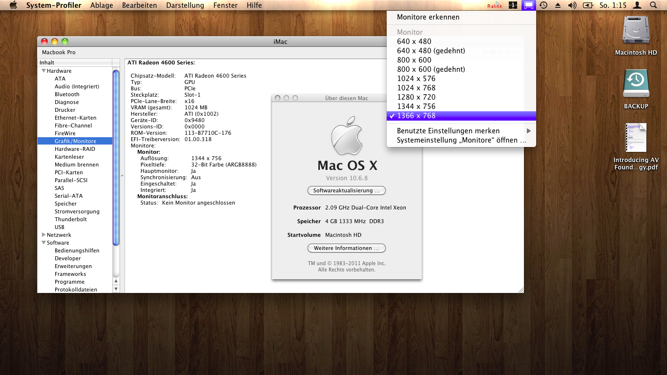

smartie77 Posted July 9, 2011 Author Share Posted July 9, 2011 I tried out the new boot file and for me it gave me a Black screen instead of activating my card, so I had to revert to the original boot file. Your new ATI 4600 kext worked fine (after I added my Device ID 0x94881002) so the modifications you made for VGA / HDMI haven't affected anything. I might be able to test the VGA with my HDTV and VGA cable I have. I haven't tried your ATI_Init.kext yet. Btw rebuilding permissions for the DVD player didn't fix it. Front Row also crashes when you put a DVD in to play. But VLC and I found a Mac Bluray player, play DVD's fine. I'll muck around and maybe one day find a solution for those bits. I tried the AnyInsight Kext file, it just makes my internal Webcamera look likes its an Apple camera in the USB setup, but it doesn't actually make my Camera work. Possibly using some other Hardware Vendor ID's from Apple there might be a combination that makes internal UVC cameras work using this kext - Do you know where a list like this could be found, so I could play with the Vendor ID substitution stuff it does? As you see : it is all try and error , that's both the fun part as well the frustrating part.. The ATY_Init is only a text file, I made it yesterday ( the kext is not mine, I modified it for our card and framebuffer ) it tells OSX to load the Shrike framebuffer for our 9480 model- the booter did that before on a hardware level; it is an attempt to no longer need "GraphicsEnabler" and therefore no special boot file. Basically we can use any ( or the newest ) Chameleon with it , drop GE=Yes from our boot config and still have fully working ATI mobility. Because the problem with our "boot" solution is that we are limited to very few and old files or need to program our owns. Having only one extra kext in /S/L/E is more efficient and frees us from the boot trouble. AnyiSight.kext is only cosmetical. It does nothing but only change "UVC xy blah webcam" to "Apple integrated iSight". Thing is : Either a cam works just out of the Box or it doesn't. You have seen it with the Logitech you bought - it works without any kext, just plug and play. I dont know what camera is in your Laptop - in my is a "Chicony" UVC 1.3MP Cam. ( compared to isight and logitech HD it is {censored} .. ) - when I launch photobooth for example the blue light in the cam goes on but I have no picture, only black.. PhotoBooth after activated cam in Camtwist : QuicktimeX Videorecording with internal webcam : Picture of the Laptops cam - see the cigarette .. I can even operate Photobooth and QT X recording at the same time with camtwist : Like I Said before : "Camtwist" is the solution for problem cams in OSX . It can activate the cards that do not play nice with Apples apps. First launch the bad App, then launch camtwist and activate card from there, close camtwist. Now Photobooth/ichat/Quicktime have video from the cam. This is because Apple broke the UVC protocol in OSX, they have so to say their own way of doing things ( mainly so that their isight solution internal works ). Has nothing to do with webcam or videodrivers. Get Camtwist 2.1 here ( freeware ) : Camtwist for leo/Snow This or a external cam that is mac compatible. ( Logitech makes their "mac" cams so that the UVC protocol is implemented like Apple does it for their own apps .. Microsoft cams for example dont work out of the box) Link to comment https://www.insanelymac.com/forum/topic/260786-multi-update-qeci-kextpack-1068-new-mobility4650-kexts-toshiba/#findComment-1711939 Share on other sites More sharing options...

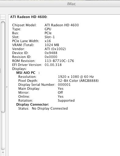

pbg4 Posted July 9, 2011 Share Posted July 9, 2011 smartie77 can you help me with my graphic card. I have similar ATI Mobility Radeon 1GB with device ID 9480x1002 My laptop is Fujitsu Lifebook AH530 I've try your kext from 10.6.8, I could only get the HDMI output to show up. I've try many other kexts posted here in the forum,but none seem to work. I want to edit my own personalities, but dong's radeon kexts don't work for me. Any suggestion(s) would me. I like to get this working. I've dump the video rom,but don't know what to do with it. I've manage to get this info. ATOM BIOS Rom: SubsystemVendorID: 0x10cf SubsystemID: 0x1615 IOBaseAddress: 0x2000 Filename: BR37696.002 BIOS Bootup Message: BR37696.002 M96 DDR3 128bit 450e/600m Connector at index 0 type: VGA (1) Connector's i2cid: 95 Connector at index 1 type: HDMI-A (11) Connector's i2cid: 90 Connector at index 2 type: LVDS (7) Connector's i2cid: 94 Link to comment https://www.insanelymac.com/forum/topic/260786-multi-update-qeci-kextpack-1068-new-mobility4650-kexts-toshiba/#findComment-1711965 Share on other sites More sharing options...
smartie77 Posted July 10, 2011 Author Share Posted July 10, 2011 Hmmm... Okay, I've found a new one in the web and replaced it with the same error but I'll try yours. By the way: My described steps above I've made correctly, or? yes so far yes. smartie77 can you help me with my graphic card.I have similar ATI Mobility Radeon 1GB with device ID 9480x1002 My laptop is Fujitsu Lifebook AH530 I've try your kext from 10.6.8, I could only get the HDMI output to show up. I've try many other kexts posted here in the forum,but none seem to work. I want to edit my own personalities, but dong's radeon kexts don't work for me. Any suggestion(s) would me. I like to get this working. I've dump the video rom,but don't know what to do with it. I've manage to get this info. ATOM BIOS Rom: SubsystemVendorID: 0x10cf SubsystemID: 0x1615 IOBaseAddress: 0x2000 Filename: BR37696.002 BIOS Bootup Message: BR37696.002 M96 DDR3 128bit 450e/600m Connector at index 0 type: VGA (1) Connector's i2cid: 95 Connector at index 1 type: HDMI-A (11) Connector's i2cid: 90 Connector at index 2 type: LVDS (7) Connector's i2cid: 94 put my ( or your ) GPU rom file in /extra , set Mac Model via smbios.plist to imac 9,1 10,1 or 11,1 , please go to this guy here : 4650m Script patcherand load the script and the Ati4600 controller and the ATY_init he has made . or the script to work, open it with textedit and rename the Name of the Harddisk in the script to what you have given name in OSX. ( or rename your Harddisk to Macintosh HD ) . . That lets you Use Apples own ATI.kexts, only open them for the device ID of 94801002 , change the entries in Info.plist ( of ATI4600controller.kext and ATIRadeonX2000.kext ). This needs a 64bit boot to work ( arch=x86_x64 ) . NO GraphicsEnabler. No special boot file. Just any chameleon, the two extra kexts in /Extra and running that script ( as root of course ) . Try that. Its a very very good solution, even better then my own I think. Discovered only minutes ago, he contacted me. the script patches the kexts automatically for Shrike FB and LVDS. Link to comment https://www.insanelymac.com/forum/topic/260786-multi-update-qeci-kextpack-1068-new-mobility4650-kexts-toshiba/#findComment-1711990 Share on other sites More sharing options...
pbg4 Posted July 10, 2011 Share Posted July 10, 2011 It's doesn't work for me Still the same, but I notice that ATY_int.kext does not load. Put it in the Extra folder repair permission and still won't load. Any more suggestion(s). Thanks! Link to comment https://www.insanelymac.com/forum/topic/260786-multi-update-qeci-kextpack-1068-new-mobility4650-kexts-toshiba/#findComment-1712013 Share on other sites More sharing options...
