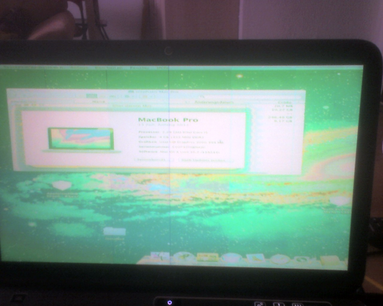

Peterpower Posted August 1, 2011 Share Posted August 1, 2011 Hi folks, I have an Intel HD 3000 in my Dell XPS with Intel i5 2410m, my ID is 0116 so it works out of the box. But the Screen is all green and totally messed up. I guess it is because my CPU is used in the Mac Mini. How can i change my Connectors so it only used LVDS output and screw all other? I need a SNB Buffer kext that is modded in a way that smbios.plist of MacbookPro8.1 only points to LVDS connector. Thanks in advance // The Pictures states everthing is corretly listed, Intel HD Graphics 3000 and Intel Core i5, sry for the Quality but u can see the Screen is all messed up. EDIT: ok i did it on my own but no improvement at all But thanks to bcc9, all the things u figured out and the bash commands... wow professional IT u must be. Link to comment https://www.insanelymac.com/forum/topic/259705-editing-custom-connector-info-for-intel-hd-3000-graphics-sandy-bridge-osx-lion/page/3/#findComment-1727306 Share on other sites More sharing options...

Peterpower Posted August 3, 2011 Share Posted August 3, 2011 Bcc9, could u may look into the thing with the Intel HD 3000 graphics with Hardware ID 0116? All users with this ID get a green screen while only the left half of the display is working, QE/CI works out of the box. The Problem is in the AppleIntelSNBGraphicsFB.kext. When i use the Snow Leopard kext screen works wonderful but unfortunately AppleIntelHDGraphics.kext from Lion wont boot with Snow Leo AppleIntelSNBGraphicsFB.kext. When i delete AppleIntelHDGraphics.kext i have full resolution and everthing working but as AppleIntelHDGraphics.kext controlls QE/CI we cant have QE/CI and both half of the screen. Lion HD Graphics + Lion SNB Buffer = Green Screen bug and only 50% visible QE/CI working Lion HD Graphics + SL SNB Buffer = Kernel Panic while booting caused by Lion HD Graphics SL HD Graphics + SL SNB Buffer = Some artifacts, full resolution, no QE/CI No HD Graphics + SL SNB Buffer= very nice screen, no artifacts, full resolution, no QE/CI This Problem only occour to people with the ID 0116 which all "m" Models of the Sandy Bridge processors use. It would be wonderful to find out what in the Lion SNB Framebuffer causes the Green Screen, i coundnt see any difference between the wonderfully working Sl SNB Framebuffer and the green-screen-u-cant-do-anything-but-play-chess-with-QE-CI Lion SNB Framebuffer the attachment show the green screen thing, sry for the quality but u see what i mean Link to comment https://www.insanelymac.com/forum/topic/259705-editing-custom-connector-info-for-intel-hd-3000-graphics-sandy-bridge-osx-lion/page/3/#findComment-1728808 Share on other sites More sharing options...
dougaa Posted August 3, 2011 Share Posted August 3, 2011 Bcc9, could u may look into the thing with the Intel HD 3000 graphics with Hardware ID 0116?All users with this ID get a green screen while only the left half of the display is working, QE/CI works out of the box. The Problem is in the AppleIntelSNBGraphicsFB.kext. When i use the Snow Leopard kext screen works wonderful but unfortunately AppleIntelHDGraphics.kext from Lion wont boot with Snow Leo AppleIntelSNBGraphicsFB.kext. When i delete AppleIntelHDGraphics.kext i have full resolution and everthing working but as AppleIntelHDGraphics.kext controlls QE/CI we cant have QE/CI and both half of the screen. Lion HD Graphics + Lion SNB Buffer = Green Screen bug and only 50% visible QE/CI working Lion HD Graphics + SL SNB Buffer = Kernel Panic while booting caused by Lion HD Graphics SL HD Graphics + SL SNB Buffer = Some artifacts, full resolution, no QE/CI No HD Graphics + SL SNB Buffer= very nice screen, no artifacts, full resolution, no QE/CI This Problem only occour to people with the ID 0116 which all "m" Models of the Sandy Bridge processors use. The native ID for my i5-2500K is 0112, and I change the ID to 0116 in the DSDT. I also tried changing the ID to 0126. I didn't notice any difference between using 0116 or 0126, and didn't see any problem like you describe. DVI works fine after editing the connector list. (This is all in Lion.) So I don't think the problem is just using ID 0116. If your native ID is 0116, that implies you must have a laptop, since 0116 is the ID for mobile HD3000. One possibility is that there is some difference between your built-in display and the display in Mac laptops so that the driver doesn't work correctly with your display. If that's the problem, there may not be any complete solution. Link to comment https://www.insanelymac.com/forum/topic/259705-editing-custom-connector-info-for-intel-hd-3000-graphics-sandy-bridge-osx-lion/page/3/#findComment-1728814 Share on other sites More sharing options...
Peterpower Posted August 3, 2011 Share Posted August 3, 2011 The native ID for my i5-2500K is 0112, and I change the ID to 0116 in the DSDT. I also tried changing the ID to 0126. I didn't notice any difference between using 0116 or 0126, and didn't see any problem like you describe. DVI works fine after editing the connector list. (This is all in Lion.) So I don't think the problem is just using ID 0116. If your native ID is 0116, that implies you must have a laptop, since 0116 is the ID for mobile HD3000. One possibility is that there is some difference between your built-in display and the display in Mac laptops so that the driver doesn't work correctly with your display. If that's the problem, there may not be any complete solution. I dont think that is the problem, macbooks cant change their Display when updating from Snow Leopard (which works just fine whit id 0116 (full resolution and QE/CI) and Lion what cuase the green screen thing) Original Macs with ID 0116 work with SL & Lion. Link to comment https://www.insanelymac.com/forum/topic/259705-editing-custom-connector-info-for-intel-hd-3000-graphics-sandy-bridge-osx-lion/page/3/#findComment-1728819 Share on other sites More sharing options...

dougaa Posted August 3, 2011 Share Posted August 3, 2011 I dont think that is the problem, macbooks cant change their Display when updating from Snow Leopard (which works just fine whit id 0116 (full resolution and QE/CI) and Lion what cuase the green screen thing) Original Macs with ID 0116 work with SL & Lion. I see what you mean, but we know that the Snow Leopard and Lion drivers are different. One difference is in how they handle the connector list. There could be a hardware difference which doesn't matter to the Snow Leopard driver but does matter to the Lion driver. Of course, this is all speculation. Link to comment https://www.insanelymac.com/forum/topic/259705-editing-custom-connector-info-for-intel-hd-3000-graphics-sandy-bridge-osx-lion/page/3/#findComment-1728919 Share on other sites More sharing options...
