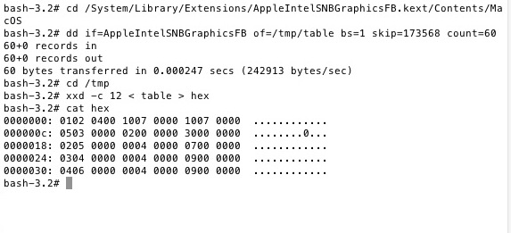

dougaa Posted July 18, 2011 Share Posted July 18, 2011 I have a GA-H67A-UD3H-B3 motherboard, and I found the connector table to use for DVI as the main display: 0000000: 0102 0300 1007 0000 1007 0000 ............ 000000c: 0205 0000 0004 0000 0700 0000 ............ 0000018: 0304 0000 0004 0000 0900 0000 ............ 0000024: 0406 0000 0004 0000 0900 0000 ............ 0000030: 0000 0000 0000 0000 0000 0000 ............ For DVI, I removed the connector entry for the LVDS display, and shifted the remaining entries up. Link to comment https://www.insanelymac.com/forum/topic/259705-editing-custom-connector-info-for-intel-hd-3000-graphics-sandy-bridge-osx-lion/page/2/#findComment-1716300 Share on other sites More sharing options...
bcc9 Posted July 18, 2011 Author Share Posted July 18, 2011 For DVI, I removed the connector entry for the LVDS display, and shifted the remaining entries up.Great, so your DVI port was in the same order as in post #7. I suspect the layout is the same for all sandy bridge desktops that have dvi&dp&hdmi. The motherboards without dp might be more interesting. Link to comment https://www.insanelymac.com/forum/topic/259705-editing-custom-connector-info-for-intel-hd-3000-graphics-sandy-bridge-osx-lion/page/2/#findComment-1716324 Share on other sites More sharing options...

rimmi2002 Posted July 24, 2011 Share Posted July 24, 2011 Alrite I got hexedit and opened up AppleIntelSNBGraphicsFB and changed the entrees individually. My original output for the connectors was: 0000000: 0102 0400 1007 0000 1007 0000 ............ 000000c: 0503 0000 0200 0000 3000 0000 ........0... 0000018: 0205 0000 0004 0000 0700 0000 ............ 0000024: 0304 0000 0004 0000 0900 0000 ............ 0000030: 0406 0000 0004 0000 0900 0000 ............ Now my output looks like: 0000000: 0102 0300 1007 0000 1007 0000 ............ 000000c: 0205 0000 0004 0000 0700 0000 ............ 0000018: 0304 0000 0004 0000 0900 0000 ............ 0000024: 0406 0000 0004 0000 0900 0000 ............ 0000030: 0000 0000 0000 0000 0000 0000 ............ I changed one of the IOPCIPrimaryMatch device ID to 0x0112 form 0x0102. I got native resolution for my monitor. However no video playback. Anyway to activate videoplayback or is this the best we can do? Also bccc9..had a questions if you can please help me out. I put in this command: (count = 96) dd if=AppleIntelSNBGraphicsFB of=/tmp/table bs=1 skip=173568 count=96 This is the output I got 0000000: 0102 0400 1007 0000 1007 0000 ............ 000000c: 0503 0000 0200 0000 3000 0000 ........0... 0000018: 0205 0000 0004 0000 0700 0000 ............ 0000024: 0304 0000 0004 0000 0900 0000 ............ 0000030: 0406 0000 0004 0000 0900 0000 ............ 000003c: 0102 0100 1007 0000 1007 0000 ............ 0000048: 0503 0000 0200 0000 3000 0000 ........0... 0000054: 0000 0000 0100 0000 4000 0000 ........@... Seems like this code in the one that is execute when there is no display that is found? 000003c: 0102 0100 1007 0000 1007 0000 ............ 0000048: 0503 0000 0200 0000 3000 0000 ........0... Any benefit in changing it? I changed it to- 000003c: 0102 0100 1007 0000 1007 0000 ............ 0000048: 0205 0000 0004 0000 0700 0000 ........0... Still didn't get any video playback. Also in my AppleIntelSNBGraphicsFB the code was repeated twice. One is earlier in the file (which is what is output with bcc9's method - I tested it) The second in much later in the file. There were two occurences of: 0000000: 0102 0400 1007 0000 1007 0000 ............ 000000c: 0503 0000 0200 0000 3000 0000 ........0... 0000018: 0205 0000 0004 0000 0700 0000 ............ 0000024: 0304 0000 0004 0000 0900 0000 ............ 0000030: 0406 0000 0004 0000 0900 0000 ............ 000003c: 0102 0100 1007 0000 1007 0000 ............ 0000048: 0503 0000 0200 0000 3000 0000 ........0... I changed them both to 0000000: 0102 0300 1007 0000 1007 0000 ............ 000000c: 0205 0000 0004 0000 0700 0000 ............ 0000018: 0304 0000 0004 0000 0900 0000 ............ 0000024: 0406 0000 0004 0000 0900 0000 ............ 0000030: 0000 0000 0000 0000 0000 0000 ............ 000003c: 0102 0100 1007 0000 1007 0000 ............ 0000048: 0205 0000 0004 0000 0700 0000 ........0... First time I got a kernel panic on startup telling me to restart. On restart it went through. Still no video. I tried to change all 3 occurrences of <key>IOPCIPrimaryMatch</key> <string>0x01128086</string>. Went back 1024x768. So Went back to my baseline..... So still no luck with video playback. Any advice from anyone? Link to comment https://www.insanelymac.com/forum/topic/259705-editing-custom-connector-info-for-intel-hd-3000-graphics-sandy-bridge-osx-lion/page/2/#findComment-1720956 Share on other sites More sharing options...

rimmi2002 Posted July 24, 2011 Share Posted July 24, 2011 I noticed bcc mention that this might be different for boards without a display port. Mine has only three connectors. VGA/DVI/HDMI. When the above layout I (01, 02, 03, 04, 00) I get both VGA and DVI to work. Didn't test HDMI. I'll try different combos i guess 03 first and then 04 first and see it makes a difference. I'm assuming you are also changing the information in info.plist you add your device id. Mine is 0x0112. Or are no alterations being made to info.plist. Also was curious in smbios.plist what mac model and and smproductid are people using? Link to comment https://www.insanelymac.com/forum/topic/259705-editing-custom-connector-info-for-intel-hd-3000-graphics-sandy-bridge-osx-lion/page/2/#findComment-1721556 Share on other sites More sharing options...
dougaa Posted July 24, 2011 Share Posted July 24, 2011 I noticed bcc mention that this might be different for boards without a display port. Mine has only three connectors. VGA/DVI/HDMI. When the above layout I (01, 02, 03, 04, 00) I get both VGA and DVI to work. Didn't test HDMI. I'll try different combos i guess 03 first and then 04 first and see it makes a different. I'm assuming you are also changing the information in info.plist you add your device id. Mine is 0x0112. Or are no alterations being made to info.plist. Also was curios in smbios.plist what mac model and and smproductid are people using? By injecting the device in the DSDT I don't have to change info.plist. Mine is also 0x0112, but I used 0x0116 in the DSDT, which the kexts support. 0x0116 is the mobile version of 0x0112. Here is my smbios.plist: <?xml version="1.0" encoding="UTF-8"?> <!DOCTYPE plist PUBLIC "-//Apple//DTD PLIST 1.0//EN" "http://www.apple.com/DTDs/PropertyList-1.0.dtd"> <plist version="1.0"> <dict> <key>SMfamily</key> <string>MacBook Pro</string> <key>SMproductname</key> <string>MacBookPro8,1</string> <key>SMboardproduct</key> <string>Mac-94245B3640C91C81</string> <key>SMserial</key> <string>C02F93FQDH2G</string> <key>SMbiosversion</key> <string>MBP81.0047.B0E</string> <key>SMmemspeed</key> <string>1333</string> </dict> </plist> Link to comment https://www.insanelymac.com/forum/topic/259705-editing-custom-connector-info-for-intel-hd-3000-graphics-sandy-bridge-osx-lion/page/2/#findComment-1721587 Share on other sites More sharing options...

rimmi2002 Posted July 24, 2011 Share Posted July 24, 2011 Alrite tried all there combos (02... first and then 03.... first and the 04.....first) doesnt make a difference. All get full resolution via DVI (which happens to be display # "02") but no video display. This is what I get in console when I try to run VLC. Jul 24 16:16:51 macintosh [0x0-0xa00a].org.videolan.vlc[125]: m_el[mi_level] == NULL Jul 24 16:16:51 macintosh [0x0-0xa00a].org.videolan.vlc[125]: arrrrrrrrrrrrrg Up cannot escape itself Jul 24 16:16:51 macintosh [0x0-0xa00a].org.videolan.vlc[125]: m_el[mi_level] == NULL Jul 24 16:16:51 macintosh [0x0-0xa00a].org.videolan.vlc[125]: arrrrrrrrrrrrrg Up cannot escape itself Jul 24 16:16:51 macintosh [0x0-0xa00a].org.videolan.vlc[125]: No accelerated IMDCT transform found For XBMC the program does not even run: This is the error Jul 24 16:20:25 Macintosh XBMC[285]: invalid pixel format Jul 24 16:20:25 Macintosh XBMC[285]: invalid context Jul 24 16:20:25 Macintosh [0x0-0x2c02c].com.teamxbmc.xbmc[285]: ERROR: Unable to create application. Exiting Jul 24 16:20:25 Macintosh XBMCHelper[294]: XBMCHelper 0.7 starting up... Jul 24 16:20:25 Macintosh [0x0-0x2c02c].com.teamxbmc.xbmc[285]: 2011-07-24 16:20:25.781 XBMCHelper[294:707] XBMCHelper 0.7 starting up... Jul 24 16:20:25 Macintosh XBMCHelper[294]: [ERROR] Driver has not found any remotes it could use. Will use remotes as they become available. Jul 24 16:20:25 Macintosh [0x0-0x2c02c].com.teamxbmc.xbmc[285]: 2011-07-24 16:20:25.791 XBMCHelper[294:707] [ERROR] Driver has not found any remotes it could use. Will use remotes as they become available. Jul 24 16:20:25 Macintosh [0x0-0x2c02c].com.teamxbmc.xbmc[285]: Asking helper to start Right now only way I can get full resolution is by changing one the setting in info.plist to 0x0112. Maybe the way to go is to inject a valid apple device Id into the DSDT. If someone can teach me how to do or link me to a place that has info on it...that'll be great. Thanks for your help! Link to comment https://www.insanelymac.com/forum/topic/259705-editing-custom-connector-info-for-intel-hd-3000-graphics-sandy-bridge-osx-lion/page/2/#findComment-1721701 Share on other sites More sharing options...
