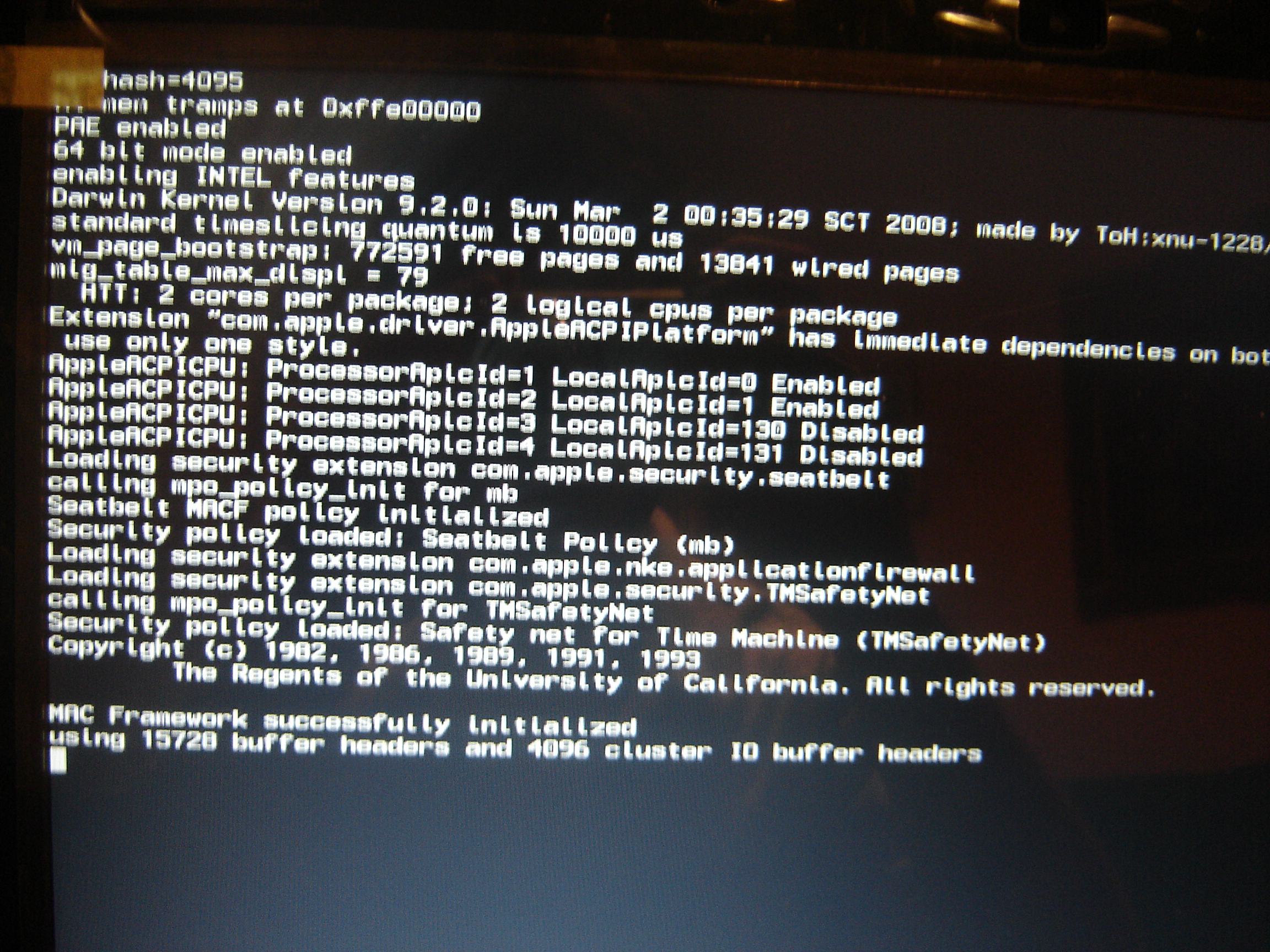

kamykazee Posted May 30, 2011 Author Share Posted May 30, 2011 Here's the screen i get upon attempting to boot the successfully installed ideneb v1.3 Link to comment https://www.insanelymac.com/forum/topic/257981-os-x-1056/#findComment-1690803 Share on other sites More sharing options...
Gringo Vermelho Posted May 30, 2011 Share Posted May 30, 2011 That's not a kernel panic. It's hanging right before it should display "mbinit: done". I have been able to "fix" this in the past by doing a CMOS reset (on two different ASUS boards). Make sure to enter your BIOS and set it back the way it was after doing this and before booting again. Don't ask me how to do a CMOS reset on a laptop though. In the BIOS, make sure ACPI 2.0 and ACPI APIC are enabled if you have such settings. Enable all "advanced CPU features" except CPUID Limit. From a quick google, iDeneb 1.3 was a 10.5.5 distro - why are you using the 9.2.0 kernel? You can use the vanilla kernel - that would be 9.5.0 for 10.5.5. Use google/forum search to find what other ASUS K50I owners have done. Link to comment https://www.insanelymac.com/forum/topic/257981-os-x-1056/#findComment-1690829 Share on other sites More sharing options...
