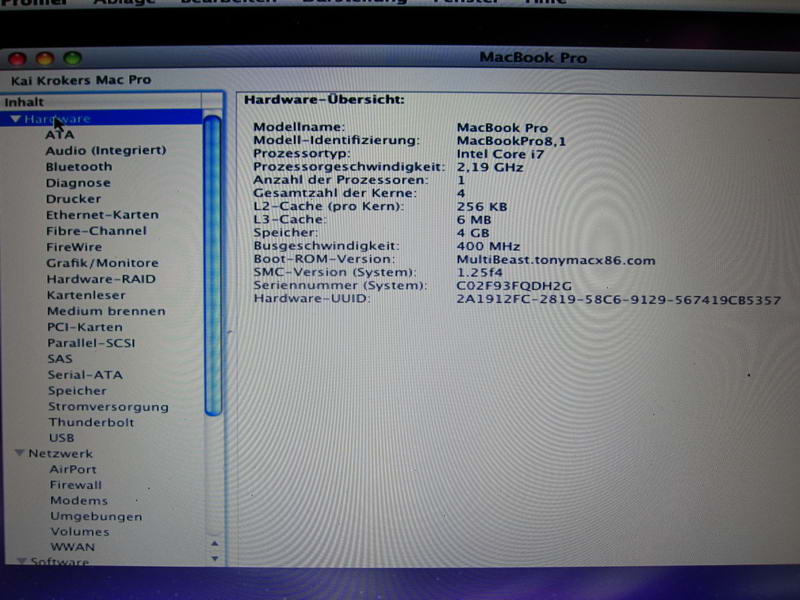

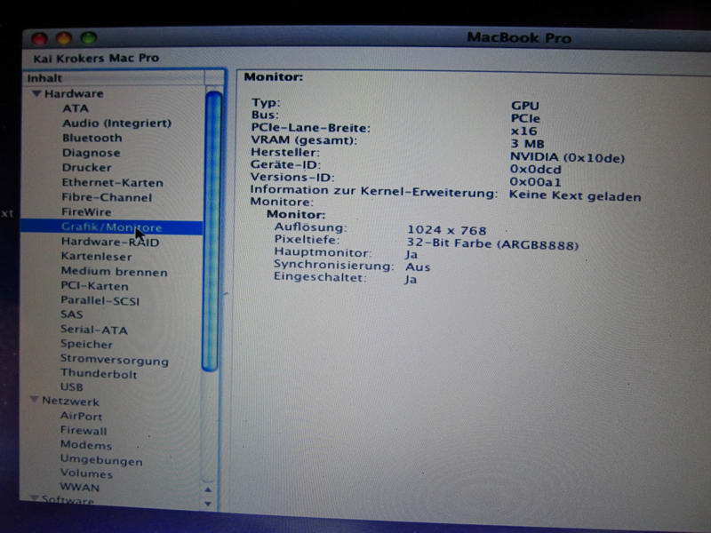

hi guys,
finally i got to the point that i can boot into 10.6.8 (on my l702x with 3D),
but to get there i had to install the kernel from bridgehelper2.1 and had to replace AppleACPIPlatform.kext and IOPCIfamily.kext after updating to 10.6.8.
all the rest i used exactly wen1´s guide.
But now the Nvidia Card (555) dont work (only 1024x768,3mb vram)and also in hardware profiler it says System-Bus Speed is 400Mhz,but the cpu is right.
Does anybody have an idea,could be the DSDT causing the problem?
If i boot with I-Boot legacy it comes up in 1920x1080.
Soon as i use [url=&quot;http://www.insanelymac.com/forum/topic/279450-why-insanelymac-does-not-support-tonymacx86/&quot;]#####[/url] and DSDT it wont work.
I would really thankfull for any idea,since im trying for 2 weeks now to get this to an end.
I attched pics of the hardwrae profiler showing the graphic status and the 400mhz issue!
Thanks a lot guys for your help!!!!!!
@wen1,sybexs,steverings...
hi guys,
Are you using your own dsdt or the one supplied in the first post? When using a dsdt it is always good to generate your own in windows and then make the edits necessary to the dsdt to make it work properly.
To get the 555M working use http://www.tonymacx86.com/1010110101/tonym...pdate-2.0.0.zip. I believe everything works including QE/CI with that installed. I havent tried the hdmi ports tho. One thing i am still having problems with is the audio. No matter what i do i can not get sound to work.
When you get your DSDT properly edited things like bluetooth will be enabled (depending on card). What are the complete specs of your laptop? I have the 17 hd i72720 with gt555m and 16 gig of ram. Also are you booting in 32 or 64?
hi sybexs,
thanks for your answer.
yes i was using the dsdt from wen1,which i think is made for the optimus,problem is i have no idea how to edit the dsdt in the right way.
im using the dell l702x with gt555m with 3D,cpu is i7 2720.i use 2 hdd´s and the intel advanced 2630 (bluetooth is working on this).system is running in 64bit....so seems we have the same xps,is yours 3D?
if you could help me with the dsdt i would be really happy!
sound worked after the 10.6.8 update but i had to go to the audio settings and had to select the internal speaker,by default its set to digital...i guess you checked that but just in case you didnt you should have a look...in fact i thought it didnt worked for me because normally its set to internal speakerit wont change to headphone automaticly if you plug in one.
maybe i will send my dsdt to the guy wen1 mentioned,hope he can help.but if you have an idea please let me know.
btw,which kernel you are using and did you made a benchmark with Geekbench??mine is showing around 7300 points,it should be at 10000-11000.would be interested in other peoples benchmark results.
im not sure if the kernel from bridgehelper2.1 is the best one,but its the only one working for me!
Thanks and greets kai
btw. the system-bus speed issue (mine shows 400mhz) seems a "bug" in chimera as they say here:
System Bus Speed Issue
Hello rawbkk,
Your system has 3D, which means it does not have optimus. Just patch a new DSDT (ask MaLd0n) and install like sybexs said and all should be fine.
About the kernel in bridgehelper2.1, I think it is more stable than one in 10.6.8.
rawbkk,
A custom DSDT for your laptop is the answer to most of your other problems. REach out to mald0n for help. He is a great guy and responds very fast. I will link the thread here in a minute
http://www.insanelymac.com/forum/index.php...523&st=3820
use this to generate the files first and then reach out to mald0n via the first link
http://www.insanelymac.com/forum/index.php...st&id=81816
For the nvidia card, you just need to get the right nvidia driver as mentioned by sybexs earlier.
Sound quality is not great but is definitely usable. It is kind of boomy and missing on the high frequencies.
The DSDT in the fist post is purely for the L502X. I will add a note for that effect.
Also, if you do get a DSDT created and share it here, i will add it to the first post.

@wen1
thanks for your answer!
im using the tonymac nvidia update driver and it works fine as long as im booting with [url=&quot;http://www.insanelymac.com/forum/topic/279450-why-insanelymac-does-not-support-tonymacx86/&quot;]#####[/url] legacy without dsdt,i think here is the problem...so nvidia works fine just need to get the dsdt sorted out,i was sending it just before to MaLd0n.
i will post it here when i got it to work as well as the steps different from your guide so people with 3d/no optimus can use your guide.

try this dsdt, we have almost the exact same laptop spec's. I am still editing it so let me know how it works.
DSDT.rar
DSDT.rar
hi sybexs,
thanks for the DSDT...unfortunately it didnt change anything,still no nvidia graphics.i did install tonymac nvidia update again but same result.
but you have the 3D version right???strange that it doesnt work but as i said if i boot with [url=&quot;http://www.insanelymac.com/forum/topic/279450-why-insanelymac-does-not-support-tonymacx86/&quot;]#####[/url] legacy nvidia works.
i will wait for the other guy,hopefully he will find the problem.but thanks anyway!!!
