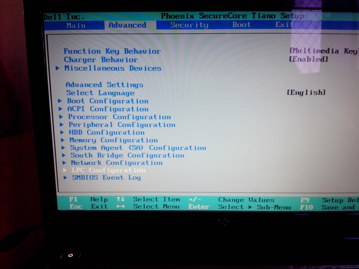

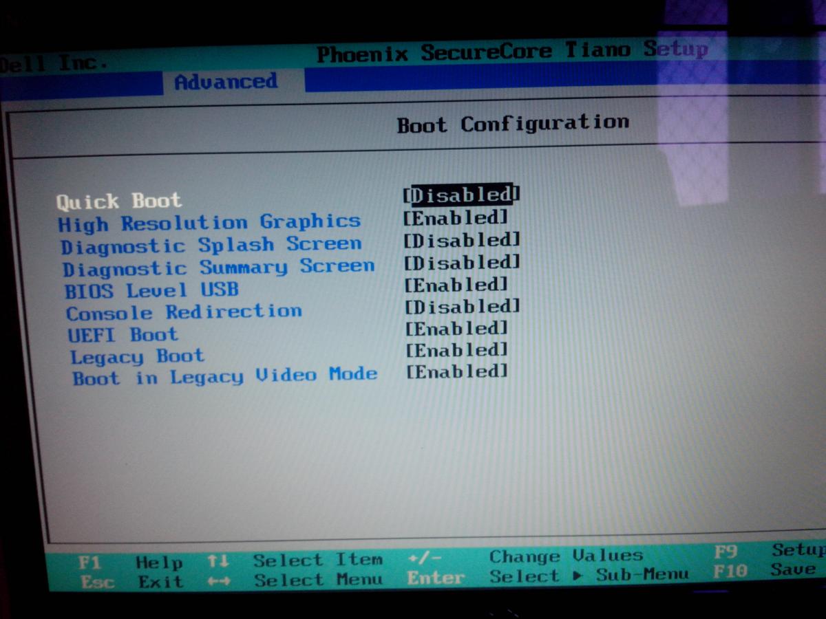

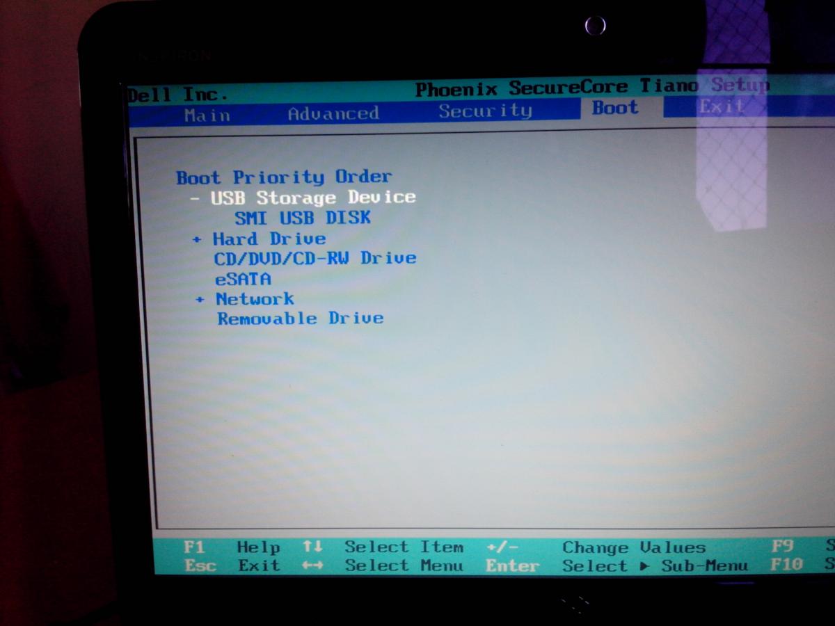

DavidRocha Posted October 9, 2013 Share Posted October 9, 2013 Look how is the bios! Link to comment https://www.insanelymac.com/forum/topic/257950-guide-dell-xps-15-l502x-early-2011-snow-leopard-install-possibly-l702x-too/page/109/#findComment-1952807 Share on other sites More sharing options...

DawTaylor Posted October 9, 2013 Share Posted October 9, 2013 @DavidRocha, My system doesn't boots from clover usb stick, I always use chameleon when creating usb install media. Assuming that you already have a functional install that doesn't boots. Which Clover version are you using? Did you tried to replace your EFI folder with Tw's EFI folder? Btw, when installing clover with UEFI option, EFI folder is located in a EFI partition. You can follow this guide to find / mount it. http://themacadmin.com/?p=603 Be aware that resizing, repartitioning this disk through disk utility will erase this partition's content and remove clover, so you may want to have a backup. @t6590, I don't have and extra folder, I use /S/L/E instead. But these are the kexts I used to get my 10.9 DPx to GM working. https://www.dropbox.com/s/ktb0gcav2gko35s/mav-kexts.zip Link to comment https://www.insanelymac.com/forum/topic/257950-guide-dell-xps-15-l502x-early-2011-snow-leopard-install-possibly-l702x-too/page/109/#findComment-1952844 Share on other sites More sharing options...
DavidRocha Posted October 9, 2013 Share Posted October 9, 2013 I think there's something wrong, because whenever I put in Legacy Boot Disable the system does not work up to the USB or with cdboot! How did you do to activate the boot with Chameleon? Link to comment https://www.insanelymac.com/forum/topic/257950-guide-dell-xps-15-l502x-early-2011-snow-leopard-install-possibly-l702x-too/page/109/#findComment-1952868 Share on other sites More sharing options...
DawTaylor Posted October 9, 2013 Share Posted October 9, 2013 I don't need to disable legacy boot, I have both of them (legacy and uefi) enabled right now. I only use Chameleon for usb sticks, for hard drive I use Clover. Anyway, I never needed to change anything to get chameleon working. Link to comment https://www.insanelymac.com/forum/topic/257950-guide-dell-xps-15-l502x-early-2011-snow-leopard-install-possibly-l702x-too/page/109/#findComment-1952873 Share on other sites More sharing options...

DawTaylor Posted October 10, 2013 Share Posted October 10, 2013 Accordingly to your bios setup, there is nothing but clover setup that would prevent your system from booting up. You should double check; 1. Clover setup 2. EFI folder content Can you tell exactly the error message? Do you have more than one hard drive in your system? That may seem odd, but I messed up my system a couple of times before I realized that I was trying to tweak the EFI folder on the wrong disk. Estou tão acostumado a lidar com estrangeiros aqui que nem me liguei no seu nome. Mals ae. Como o tópico é em inglês, achei de bom tom postar em inglês o conteúdo que pode vir a ser util a outros. ----- De acordo com as opções da sua bios, não há nada que possa estar ocasionando o erro a não ser a instalação do Clover. Você deveria re-checar; 1. Instalação do Clover 2. Conteúdo da pasta EFI Se o erro persistir, me passe a mensagem exata de erro que está recebendo. Preciso saber se está chegando no bootloader ou não. Você tem mais de um hd instalado? Pode parecer besteira, mas eu baguncei muito as coisas aqui antes de me ligar que estava mexendo na partição EFI do disco errado. Veja como fica a minha partição EFI. Link to comment https://www.insanelymac.com/forum/topic/257950-guide-dell-xps-15-l502x-early-2011-snow-leopard-install-possibly-l702x-too/page/109/#findComment-1952987 Share on other sites More sharing options...
