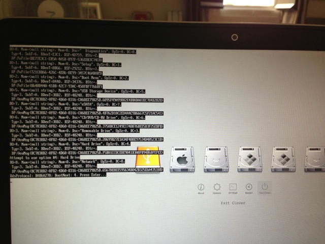

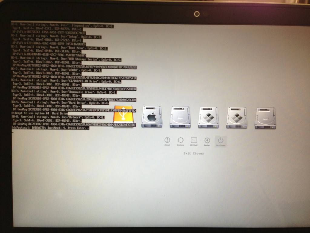

jkbuha Posted August 31, 2013 Share Posted August 31, 2013 uploading the image.. Upon pressing Enter the system reboots and displays the Dell logo and loads the boot partition Link to comment https://www.insanelymac.com/forum/topic/257950-guide-dell-xps-15-l502x-early-2011-snow-leopard-install-possibly-l702x-too/page/102/#findComment-1942457 Share on other sites More sharing options...
TimeWalker75a Posted August 31, 2013 Share Posted August 31, 2013 What gets loaded exactly (OS, boot manager, UEFI or Legacy?), I see it's choosing the primary Hard drive (I can see it from debug log), but what gets loaded? What you have on that primary hard drive? Link to comment https://www.insanelymac.com/forum/topic/257950-guide-dell-xps-15-l502x-early-2011-snow-leopard-install-possibly-l702x-too/page/102/#findComment-1942463 Share on other sites More sharing options...
jkbuha Posted August 31, 2013 Share Posted August 31, 2013 HD0: Primary Hard Drive has Win Recovery BCD. So when I boot via CloverUSB using your patched Clover the sequence is as follows: UEFI -> Clover -> Exit -> Dell Logo Screen -> HD0: WinBCD (MBR) So even if I had the USB in the drive, upon choosing the Exit option in Clover I get the above screenshot, then when pressing Enter the laptop reboots showing the Dell Logo and then goes straight to the HD even if I've set the BIOS to look at the USB port first. Hope this helps. Also, back to the GPT/MBR discussion, when doing a gptgen and rebooting, the HD0 still has a 'Operation System not found' error even if I copied all the Win UEFI bootmgr/bootfmwgr efis to the recovery partition. However I've just realised that under MBR the 'active' or 'boot' flags would need to be set ahead of booting; what is the equivalent gpt tool/command to set this? Link to comment https://www.insanelymac.com/forum/topic/257950-guide-dell-xps-15-l502x-early-2011-snow-leopard-install-possibly-l702x-too/page/102/#findComment-1942479 Share on other sites More sharing options...
TimeWalker75a Posted August 31, 2013 Share Posted August 31, 2013 UEFI -> Clover -> Exit -> Dell Logo Screen -> HD0: WinBCD (MBR) So even if I had the USB in the drive, upon choosing the Exit option in Clover I get the above screenshot, then when pressing Enter the laptop reboots showing the Dell Logo and then goes straight to the HD even if I've set the BIOS to look at the USB port first. Also, back to the GPT/MBR discussion, when doing a gptgen and rebooting, the HD0 still has a 'Operation System not found' error even if I copied all the Win UEFI bootmgr/bootfmwgr efis to the recovery partition. However I've just realised that under MBR the 'active' or 'boot' flags would need to be set ahead of booting; what is the equivalent gpt tool/command to set this? The thing is, it doesn't reboot, the Dell logo is already rendered and is just redrawn when BDS initiates. So essentially, if you had Clover on secondary HD (DVD-caddy) after exiting, it would proceed to boot the primary HD with your Legacy OSes, is that correct? Cause this is the legacy workaround currently in mind for Tiano. And it works the way I just described for me to boot HD0 with Windows 8 Legacy on it. diskpart list disk (assuming your disk is 0) select disk 0 list partition select partition 1 delete partition create partition EFI size=100 offset=1 format quick fs=fat32 label="System" assign letter=E exit bcdboot c:\windows /s e: /f UEFI (assuming your main windows partition is C:) Link to comment https://www.insanelymac.com/forum/topic/257950-guide-dell-xps-15-l502x-early-2011-snow-leopard-install-possibly-l702x-too/page/102/#findComment-1942488 Share on other sites More sharing options...
