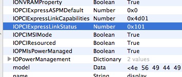

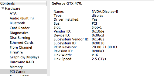

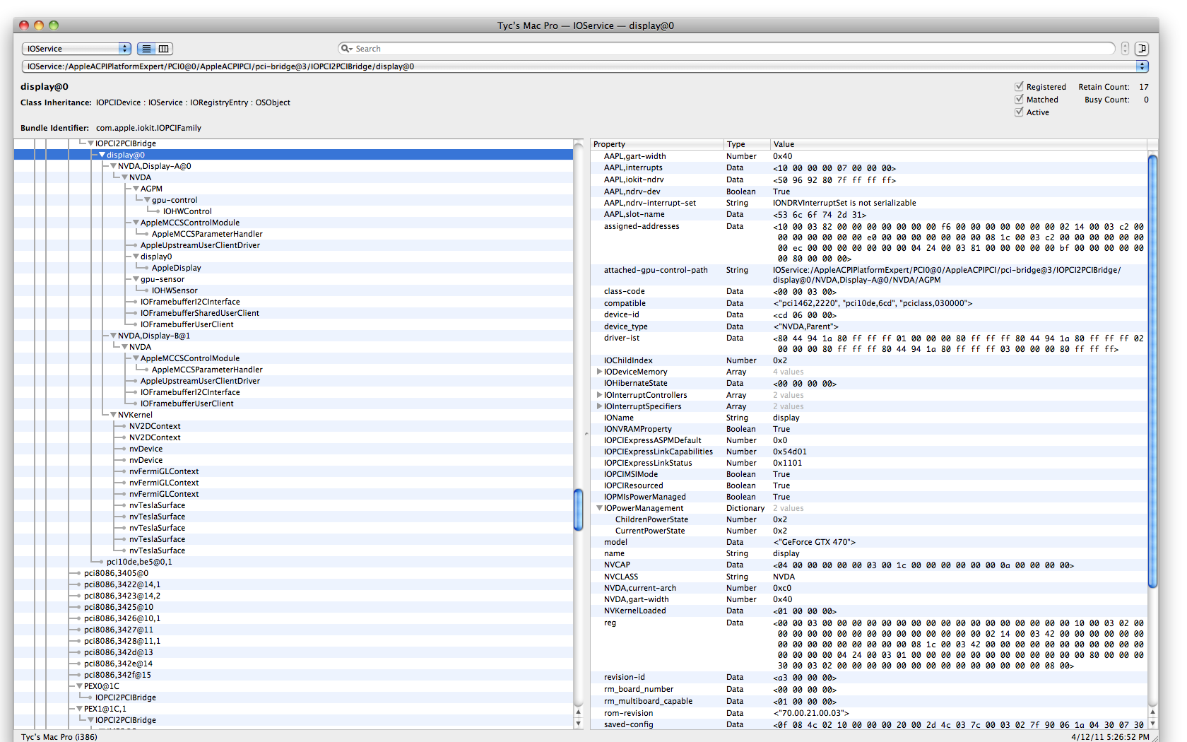

rominator Posted April 11, 2011 Share Posted April 11, 2011 Hi, I'm working on some issues affecting Resolve with Fermi cards and was consulting with a certain genius buddy of mine. We have come upon some interesting things regarding full PCIE 2.0 function on Macs and Hacks. Has anyone got an Nvidia card running at full 2.0 spec? This would be 16 lanes at 5.0 GT/s. You can check this in System Profiler under "PCI Cards" or in IOReg as IOPCIExpresslinkstatus where 1101 is 2.5 and 1102 is 5.0 An even better way to check is to install CUDA and then run CUDA-Z to check memory throughput to CPU. I am attaching results from that test. I am curious if anyone has 5.0 working on an Nvidia card in a hack and if so how they have done this. 480_50.html 480___25.html Link to comment Share on other sites More sharing options...

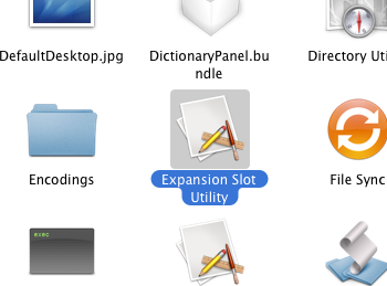

Gringo Vermelho Posted April 12, 2011 Share Posted April 12, 2011 Interesting. Mine says 2,5 GT/s. Is it possible that it could be just cosmetic? What should the memory throughput be like in CUDA-Z at 5.0 GT/s? You probably know this already but just in case: It's in System/Library/CoreServices. I remember being able to run that on 10.5.x when using (if I recall correctly) MacPro2,1 for model identifier. I think it's supposed to let you assign the available lanes or link speeds or whatever it's called among the PCI-E slots. Of course it doesn't do anything on a PC but maybe this utility will be useful somehow in finding the information you're looking for. You probably saw this already too but what the hell, look, http://www.insanelymac.com/forum/index.php...t&p=1668143 Compare Graebags' screenshot to mine. Does that mean his is doing 5.0 GT/s? Link to comment Share on other sites More sharing options...

myrorym Posted April 12, 2011 Share Posted April 12, 2011 I posted benchmark on other thread. However IOReg and SYS profile both indicate slower speed than CUDA-Z, I think. Am I looking in the correct spot in IOReg? Link to comment Share on other sites More sharing options...
Gringo Vermelho Posted April 12, 2011 Share Posted April 12, 2011 IOReg and SYS profile both indicate slower speed than CUDA-Z, I think. Which means that the answer to... Mine says 2,5 GT/s. Is it possible that it could be just cosmetic? ...is yes. And that means it just got harder to figure out why it isn't working for me. Am I looking in the correct spot in IOReg? Yes I believe so. What injection method are you using? I'm using Chameleon 2.0 RC5 GraphicsEnabler. Link to comment Share on other sites More sharing options...
rominator Posted April 12, 2011 Author Share Posted April 12, 2011 Which means that the answer to... ...is yes. And that means it just got harder to figure out why it isn't working for me. Yes I believe so. What injection method are you using? I'm using Chameleon 2.0 RC5 GraphicsEnabler. Ahh, yes. It appears that both of the methods of checking aren't accurate. Netkas was able to get his to say "5.0" but it gave CUDA speeds that said "2.5"...so I think ultimately using CUDA-Z or the Bandwidth test is going to be what matters. It appears that System Profiler may as well say "Purple Petunias" for all it's bearing on Hacks. Frustrating, but glad I asked. Link to comment Share on other sites More sharing options...
