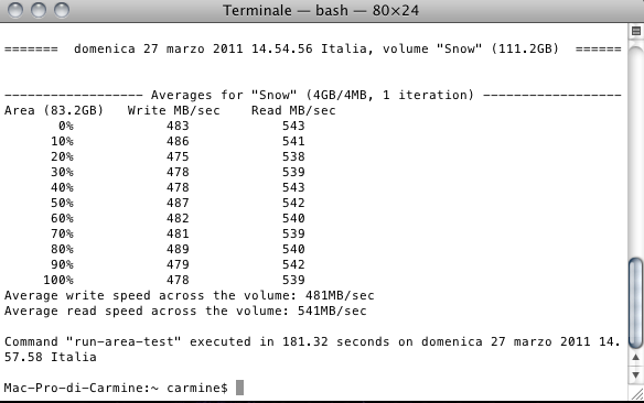

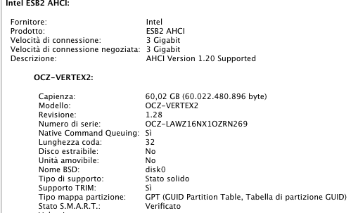

magnifico Posted March 27, 2011 Share Posted March 27, 2011 Ok , perfect job now Perfect result on my ssd vertex 2 in raid 0 Link to comment https://www.insanelymac.com/forum/topic/251966-trim-for-third-party-ssd/#findComment-1661651 Share on other sites More sharing options...
magnifico Posted March 27, 2011 Share Posted March 27, 2011 Yes you see is WORK !!!I see you hav RAID ? i hav normal as AHCI-Mode my 2x SSD-Drive. And i hav 1 HDD (Seagate 1TB) installed. I happy that by you works. Greeting from germany to Itali Raid Software 0 on my SSD VERTEX 2 Thanks for greeting Link to comment https://www.insanelymac.com/forum/topic/251966-trim-for-third-party-ssd/#findComment-1661666 Share on other sites More sharing options...
