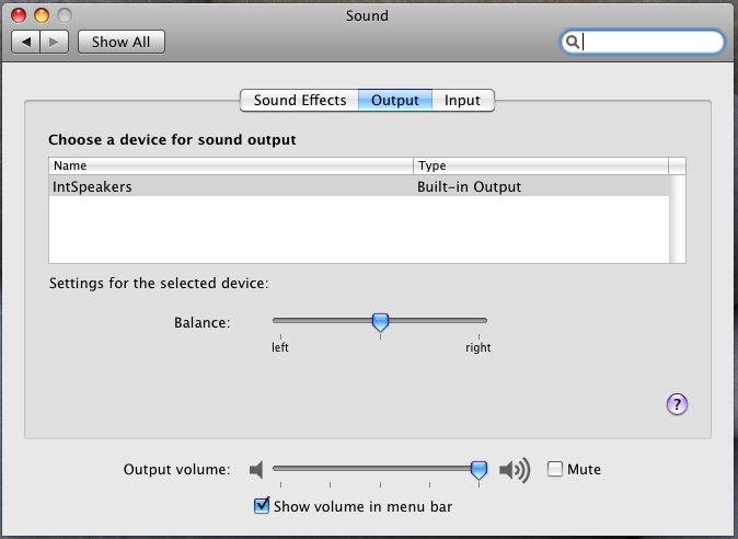

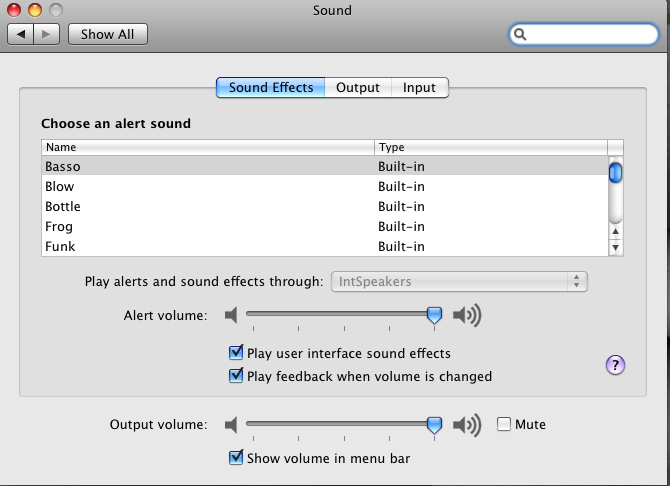

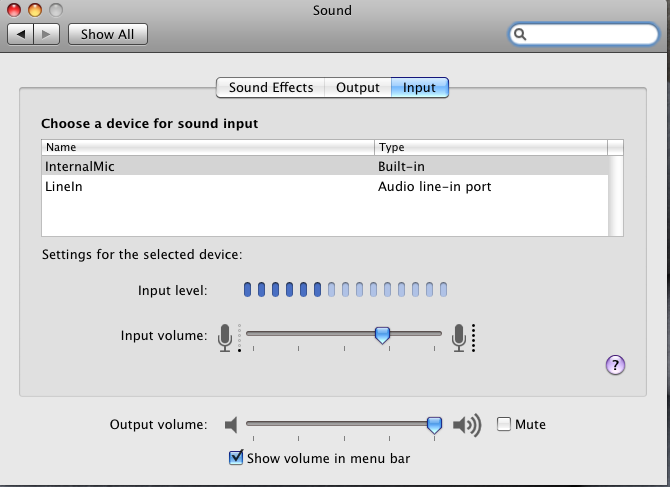

charlescw Posted January 13, 2008 Share Posted January 13, 2008 I tested both the AppleHDA.kext in the first thread and the Sigmatel9220Audio.Support.pkg mention above on my Dell XPS M1210 running Kalyway leopard 10.5.1. Mine is Sigmatel 92xx, vendor is 8384, device is 7680. Here are the results: The AppleHDA.kext works, but only for earphone, and the sound coming out from Left is very good, but from the Right is bad with a lot of noise. I used Kext Helper to finish the kext file installation. Here is what Kext Helper did: "cp -R /Users/charlescao/Downloads/AppleHDA.kext /System/Library/Extensions/ chown -R root:wheel /System/Library/Extensions/AppleHDA.kext chmod -R 755 /System/Library/Extensions/AppleHDA.kext touch /System/Library/Extensions exit sudo -k" The .pkg above did not work unfortunately. It's a self installation package, after installation and reboot, the system said the "IO...kext" and "..controller..kext" stuff are not installed correctly. And there is no audio device found. I had to deleted the AppleHDA.kext from the Extension folder. I suddenly realize if I need to delete the original AppleHDA.kext first, then run the .pkg!? Anyway, I will make a try. BTW many thanks for your guys work. Sorry for my English if I didn't make myself clear. Link to comment https://www.insanelymac.com/forum/topic/25188-howto-working-audio-fix-for-sigmatel-9220-sigmatel-975253-sis-7012/page/4/#findComment-577547 Share on other sites More sharing options...
