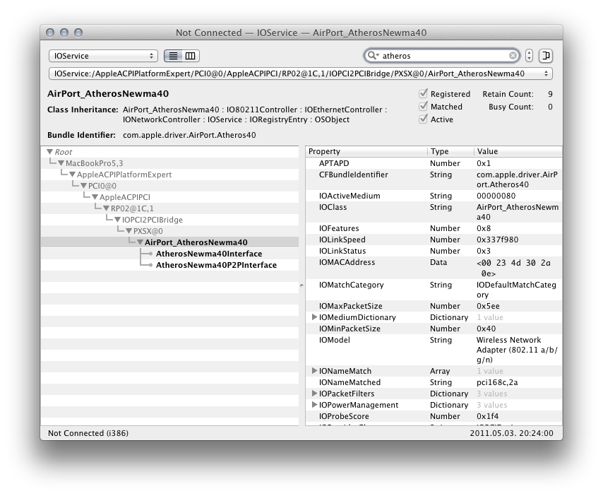

miqlas Posted March 4, 2011 Share Posted March 4, 2011 Hello! I have secefully installed the Lion on my lappie, it works, but there is a great problem. It is very slow... I checked the kextstat, and i have seen 2 Atheros kext is loaded for my WiFi adapter (pci168c,2a - AR928X): AiPort_Atheros21.kext and AirPort_Atheros40.kext (In SnowLeo the WiFi works very well with AirPort_Atheros_21.kext). In the network prefs i see my WiFi interface, but it says "Wifi turned Off" and i can't turn it On. First i tought maybe i don't need the AirPort_Atheros40.kext, renamed and kextcache removed. Reboot: Slow as hell Then i removed the AiPort_Atheros21.kext, reboot. Yay, fast! Then there is a problem with the WiFi driver. I replaced the whole IO80211Family.kext wit the old version frem 10.6.6 (it works in SnowLeo for me), but it is slow again. I checked the Console, and here i found tons of crashreport: Process: configd [474] Path: /usr/libexec/configd Identifier: configd Version: ??? (???) Code Type: X86-64 (Native) Parent Process: launchd [1] Date/Time: 2011-03-04 11:37:18.226 +0100 OS Version: Mac OS X 10.7 (11A390) Report Version: 8 Crashed Thread: 4 Exception Type: EXC_BAD_ACCESS (SIGSEGV) Exception Codes: KERN_INVALID_ADDRESS at 0x0000000000000000 VM Regions Near 0: --> __TEXT 000000010f610000-000000010f63a000 [ 168K] r-x/rwx SM=COW /usr/libexec/configd Application Specific Information: objc[474]: garbage collection is OFF Thread 0 name: SCDynamicStore Dispatch queue: com.apple.main-thread Thread 0: 0 libsystem_kernel.dylib 0x00007fff8c2c76b6 mach_msg_trap + 10 1 libsystem_kernel.dylib 0x00007fff8c2c6dad mach_msg + 73 2 com.apple.CoreFoundation 0x00007fff8f7501ec __CFRunLoopServiceMachPort + 188 3 com.apple.CoreFoundation 0x00007fff8f6afa44 __CFRunLoopRun + 1204 4 com.apple.CoreFoundation 0x00007fff8f6af356 CFRunLoopRunSpecific + 230 5 configd 0x000000010f6121b8 0x10f610000 + 8632 6 configd 0x000000010f6118b3 0x10f610000 + 6323 7 configd 0x000000010f6110fc 0x10f610000 + 4348 Thread 1 name: Dispatch queue: com.apple.libdispatch-manager Thread 1: 0 libsystem_kernel.dylib 0x00007fff8c2c8e26 __select_nocancel + 10 1 libdispatch.dylib 0x00007fff93909786 _dispatch_mgr_invoke + 244 2 libdispatch.dylib 0x00007fff9390a877 _dispatch_queue_invoke + 63 3 libdispatch.dylib 0x00007fff9390a070 _dispatch_worker_thread2 + 198 4 libsystem_c.dylib 0x00007fff8dc6331f _pthread_wqthread + 316 5 libsystem_c.dylib 0x00007fff8dc64599 start_wqthread + 13 Thread 2: 0 libsystem_kernel.dylib 0x00007fff8c2c91b2 __workq_kernreturn + 10 1 libsystem_c.dylib 0x00007fff8dc634d9 _pthread_wqthread + 758 2 libsystem_c.dylib 0x00007fff8dc64599 start_wqthread + 13 Thread 3: 0 libsystem_kernel.dylib 0x00007fff8c2c91b2 __workq_kernreturn + 10 1 libsystem_c.dylib 0x00007fff8dc634d9 _pthread_wqthread + 758 2 libsystem_c.dylib 0x00007fff8dc64599 start_wqthread + 13 Thread 4 Crashed: 0 com.apple.CoreFoundation 0x00007fff8f685152 CFDataGetBytePtr + 18 1 com.apple.SystemConfiguration.Apple80211 0x000000010f8d1a3e 0x10f8d0000 + 6718 2 com.apple.SystemConfiguration.Apple80211 0x000000010f8d3b59 0x10f8d0000 + 15193 3 com.apple.SystemConfiguration.Apple80211 0x000000010f8d5cf2 ioDriverInit + 1933 4 com.apple.SystemConfiguration.Apple80211 0x000000010f8d81a1 start + 240 5 configd 0x000000010f61327f 0x10f610000 + 12927 6 com.apple.CoreFoundation 0x00007fff8f694164 CFArrayApplyFunction + 68 7 configd 0x000000010f612b26 0x10f610000 + 11046 8 libsystem_c.dylib 0x00007fff8dc61804 _pthread_start + 335 9 libsystem_c.dylib 0x00007fff8dc64589 thread_start + 13 Thread 5 name: com.apple.CFSocket.private Thread 5: 0 libsystem_kernel.dylib 0x00007fff8c2c8e12 __select + 10 1 com.apple.CoreFoundation 0x00007fff8f6cee1b __CFSocketManager + 1355 2 libsystem_c.dylib 0x00007fff8dc61804 _pthread_start + 335 3 libsystem_c.dylib 0x00007fff8dc64589 thread_start + 13 Thread 6: 0 libsystem_kernel.dylib 0x00007fff8c2c76b6 mach_msg_trap + 10 1 libsystem_kernel.dylib 0x00007fff8c2c6dad mach_msg + 73 2 com.apple.CoreFoundation 0x00007fff8f7501ec __CFRunLoopServiceMachPort + 188 3 com.apple.CoreFoundation 0x00007fff8f6afa44 __CFRunLoopRun + 1204 4 com.apple.CoreFoundation 0x00007fff8f6af356 CFRunLoopRunSpecific + 230 5 com.apple.CoreFoundation 0x00007fff8f6af23f CFRunLoopRun + 95 6 com.apple.SystemConfiguration.PPPController 0x000000010f9fce1a pppcntl_run_thread + 2194 7 libsystem_c.dylib 0x00007fff8dc61804 _pthread_start + 335 8 libsystem_c.dylib 0x00007fff8dc64589 thread_start + 13 Thread 7: 0 libsystem_kernel.dylib 0x00007fff8c2c91b2 __workq_kernreturn + 10 1 libsystem_c.dylib 0x00007fff8dc634d9 _pthread_wqthread + 758 2 libsystem_c.dylib 0x00007fff8dc64599 start_wqthread + 13 Thread 4 crashed with X86 Thread State (64-bit): rax: 0x00000000ffffffff rbx: 0x0000000000000000 rcx: 0x0000000000000036 rdx: 0x000000000000000a rdi: 0x0000000000000000 rsi: 0x000000010f904881 rbp: 0x000000010f8be2a0 rsp: 0x000000010f8be290 r8: 0x000000000000003f r9: 0x00007fcce143b170 r10: 0x0000000090ee0008 r11: 0x0000000006c1f4d9 r12: 0x00007fff7b01c568 r13: 0x0000000000000000 r14: 0x0000000000000001 r15: 0x00007fcce2013f50 rip: 0x00007fff8f685152 rfl: 0x0000000000010246 cr2: 0x0000000000000000 Logical CPU: 0 Binary Images: 0x10f610000 - 0x10f639ff7 configd (??? - ???) /usr/libexec/configd 0x10f8c1000 - 0x10f8c1fff com.apple.SystemConfiguration.wwanConfig (2.5.0 - 2.5.0b2) <4FBFFBBC-A691-39C6-981D-CE6C9D0DDC9F> /System/Library/SystemConfiguration/wwanConfig.bundle/Contents/MacOS/wwanConfig 0x10f8c5000 - 0x10f8c6ff7 com.apple.print.notification (7.0 - 354) <075C7167-E817-3252-9034-9D85243423CE> /System/Library/SystemConfiguration/PrinterNotifications.bundle/Contents/MacOS/PrinterNotifications 0x10f8cb000 - 0x10f8cbfff com.apple.SystemConfiguration.Bluetooth (2.5 - 2.5b13) /System/Library/SystemConfiguration/Bluetooth.bundle/Contents/MacOS/Bluetooth 0x10f8d0000 - 0x10f914fff com.apple.SystemConfiguration.Apple80211 (7.0 - 700.23.9) /System/Library/SystemConfiguration/Apple80211Monitor.bundle/Contents/MacOS/Apple80211Monitor 0x10f927000 - 0x10f957fef libpcap.A.dylib (??? - ???) /usr/lib/libpcap.A.dylib 0x10f962000 - 0x10f968fff com.apple.SystemConfiguration.EAPOLController (11.0.0 - 11.0) /System/Library/SystemConfiguration/EAPOLController.bundle/Contents/MacOS/EAPOLController 0x10f96f000 - 0x10f997ff7 com.apple.SystemConfiguration.EAP8021X (11.0.0 - 11.0) <7B4775AF-5778-3F70-8C22-9C213FF1CD50> /System/Library/PrivateFrameworks/EAP8021X.framework/Versions/A/EAP8021X 0x10f9a8000 - 0x10f9dffff com.apple.SystemConfiguration.IPConfiguration (11.0.0 - ???) <4D6AA17B-DBE1-32D7-A026-1CD13A91B78A> /System/Library/SystemConfiguration/IPConfiguration.bundle/Contents/MacOS/IPConfiguration 0x10f9ef000 - 0x10fa30fff com.apple.SystemConfiguration.PPPController (1.7 - 1.7) <7DDBF819-C333-3337-BFC1-2E31D0B19729> /System/Library/SystemConfiguration/PPPController.bundle/Contents/MacOS/PPPController 0x10fa49000 - 0x10fa4eff7 libipsec.A.dylib (300.0.0 - compatibility 1.0.0) /usr/lib/libipsec.A.dylib 0x7fff6f210000 - 0x7fff6f2451ff dyld (195 - ???) <71093406-21CF-3DBE-A001-802259ED5300> /usr/lib/dyld 0x7fff8a6b8000 - 0x7fff8a6cbfff libCRFSuite.dylib (??? - ???) /usr/lib/libCRFSuite.dylib 0x7fff8a931000 - 0x7fff8a936fff libcompiler_rt.dylib (6.0.0 - compatibility 1.0.0) /usr/lib/system/libcompiler_rt.dylib 0x7fff8a93c000 - 0x7fff8a93dfff libdnsinfo.dylib (391.1.0 - compatibility 1.0.0) <44CED159-EF23-3BFE-A7A9-BC335023FCB7> /usr/lib/system/libdnsinfo.dylib 0x7fff8aa01000 - 0x7fff8aa18fff com.apple.CFOpenDirectory (10.7 - 131) <6612DF7E-FB0B-39A5-B7CF-81D4AD5C0067> /System/Library/Frameworks/OpenDirectory.framework/Versions/A/Frameworks/CFOpenDirectory.framework/Versions/A/CFOpenDirectory 0x7fff8aa2d000 - 0x7fff8ab8aff7 com.apple.CFNetwork (515.1 - 515.1) <7B76A853-15D5-3015-8F4D-B5256A56E611> /System/Library/Frameworks/CoreServices.framework/Versions/A/Frameworks/CFNetwork.framework/Versions/A/CFNetwork 0x7fff8b38b000 - 0x7fff8b391ff7 libcopyfile.dylib (79.0.0 - compatibility 1.0.0) /usr/lib/system/libcopyfile.dylib 0x7fff8b446000 - 0x7fff8b44efff libsystem_dnssd.dylib (??? - ???) <2FFD07DA-8485-301D-B3A3-7FDCB2B39C78> /usr/lib/system/libsystem_dnssd.dylib 0x7fff8c0ae000 - 0x7fff8c0c0ff7 libbsm.0.dylib (??? - ???) <5AF216D6-878B-3F34-8C6C-60BD4799E753> /usr/lib/libbsm.0.dylib 0x7fff8c2b2000 - 0x7fff8c2d2fff libsystem_kernel.dylib (1699.21.15 - compatibility 1.0.0) <210D1831-CCE8-3D38-81BB-4279A89348C4> /usr/lib/system/libsystem_kernel.dylib 0x7fff8c313000 - 0x7fff8c361ff7 libauto.dylib (??? - ???) /usr/lib/libauto.dylib 0x7fff8c362000 - 0x7fff8c363ff7 libsystem_blocks.dylib (51.0.0 - compatibility 1.0.0) <364CE34D-5100-3566-A368-DDF2BEC6EDB4> /usr/lib/system/libsystem_blocks.dylib 0x7fff8c7a8000 - 0x7fff8c823ff7 com.apple.Metadata (10.7.0 - 601.1) /System/Library/Frameworks/CoreServices.framework/Versions/A/Frameworks/Metadata.framework/Versions/A/Metadata 0x7fff8c824000 - 0x7fff8c826fff com.apple.TrustEvaluationAgent (2.0 - 1) <36DAF1C0-E2BC-385D-BF75-91F363460AE1> /System/Library/PrivateFrameworks/TrustEvaluationAgent.framework/Versions/A/TrustEvaluationAgent 0x7fff8ca0e000 - 0x7fff8cae0ff7 com.apple.CoreServices.OSServices (467.6 - 467.6) /System/Library/Frameworks/CoreServices.framework/Versions/A/Frameworks/OSServices.framework/Versions/A/OSServices 0x7fff8cb41000 - 0x7fff8cb6efe7 libSystem.B.dylib (159.0.0 - compatibility 1.0.0) /usr/lib/libSystem.B.dylib 0x7fff8cbfe000 - 0x7fff8cc03fff libcache.dylib (47.0.0 - compatibility 1.0.0) <48963E04-CABF-38BE-84FB-142FE33439D6> /usr/lib/system/libcache.dylib 0x7fff8d05b000 - 0x7fff8d05cfff libsystem_sandbox.dylib (??? - ???) /usr/lib/system/libsystem_sandbox.dylib 0x7fff8d828000 - 0x7fff8d86dfff com.apple.framework.CoreWLAN (2.0 - 200.24.4) <6212E780-1303-3005-B9A5-F3238B2A01BB> /System/Library/Frameworks/CoreWLAN.framework/Versions/A/CoreWLAN 0x7fff8dc12000 - 0x7fff8dcf2fe7 libsystem_c.dylib (750.0.0 - compatibility 1.0.0) /usr/lib/system/libsystem_c.dylib 0x7fff8de5b000 - 0x7fff8de5ffff libdyld.dylib (195.0.0 - compatibility 1.0.0) <17D183CC-4756-3DCB-8CFF-1C40C3338E51> /usr/lib/system/libdyld.dylib 0x7fff8dea2000 - 0x7fff8df85567 libobjc.A.dylib (227.0.0 - compatibility 1.0.0) /usr/lib/libobjc.A.dylib 0x7fff8df95000 - 0x7fff8dfd3ff7 com.apple.AE (520 - 520) <18F66860-D659-3934-AC92-EF21B64CDF9B> /System/Library/Frameworks/CoreServices.framework/Versions/A/Frameworks/AE.framework/Versions/A/AE 0x7fff8dfd4000 - 0x7fff8dfd6fff libquarantine.dylib (32.0.0 - compatibility 1.0.0) <9E519CCE-D871-3BAF-9127-6A7A9809EE8D> /usr/lib/system/libquarantine.dylib 0x7fff8e415000 - 0x7fff8e416fff libDiagnosticMessagesClient.dylib (??? - ???) <589F39D4-3155-3E27-B766-8AE55F697D33> /usr/lib/libDiagnosticMessagesClient.dylib 0x7fff8e452000 - 0x7fff8e728ff7 com.apple.security (7.0 - 1) <36F14A45-6389-3CB8-8293-0F8AF9136B55> /System/Library/Frameworks/Security.framework/Versions/A/Security 0x7fff8e846000 - 0x7fff8e84cfff libmacho.dylib (800.0.0 - compatibility 1.0.0) /usr/lib/system/libmacho.dylib 0x7fff8ebbf000 - 0x7fff8edc2fff libicucore.A.dylib (46.0.0 - compatibility 1.0.0) <1122C83D-27F2-35E9-9289-D0CB678FA2D0> /usr/lib/libicucore.A.dylib 0x7fff8edc3000 - 0x7fff8edc6ff7 libsystem_network.dylib (??? - ???) /usr/lib/system/libsystem_network.dylib 0x7fff8ee9b000 - 0x7fff8efa8fef libcrypto.0.9.8.dylib (0.9.8 - compatibility 0.9.8) <6300F2D5-CA5C-36E1-8A8C-28E29A685DD0> /usr/lib/libcrypto.0.9.8.dylib 0x7fff8efa9000 - 0x7fff8eff3ff7 com.apple.SystemConfiguration (1.11 - 1.11) <41067F8D-9E24-3077-AD77-99E9BCC76591> /System/Library/Frameworks/SystemConfiguration.framework/Versions/A/SystemConfiguration 0x7fff8f500000 - 0x7fff8f541ff7 libcommonCrypto.dylib (40787.0.0 - compatibility 1.0.0) /usr/lib/system/libcommonCrypto.dylib 0x7fff8f542000 - 0x7fff8f548fff com.apple.DiskArbitration (2.4 - 2.4) <8D403755-B313-3E1E-8CB1-7D5F24CE1D77> /System/Library/Frameworks/DiskArbitration.framework/Versions/A/DiskArbitration 0x7fff8f5b8000 - 0x7fff8f5c2fff liblaunch.dylib (386.0.0 - compatibility 1.0.0) /usr/lib/system/liblaunch.dylib 0x7fff8f5c3000 - 0x7fff8f665ff7 com.apple.securityfoundation (5.0 - 1) <7AE152D9-B0AA-39EC-9FC4-7243738E93CD> /System/Library/Frameworks/SecurityFoundation.framework/Versions/A/SecurityFoundation 0x7fff8f666000 - 0x7fff8f834fef com.apple.CoreFoundation (6.7 - 612.3) /System/Library/Frameworks/CoreFoundation.framework/Versions/A/CoreFoundation 0x7fff8fae4000 - 0x7fff8fbe6ff7 libxml2.2.dylib (10.3.0 - compatibility 10.0.0) <6E0D2022-54BA-3AB3-B0D8-7F8A93197150> /usr/lib/libxml2.2.dylib 0x7fff8fc34000 - 0x7fff8fc35fff liblangid.dylib (??? - ???) /usr/lib/liblangid.dylib 0x7fff8fc5f000 - 0x7fff8fcd2fff libstdc++.6.dylib (52.0.0 - compatibility 7.0.0) /usr/lib/libstdc++.6.dylib 0x7fff8fe78000 - 0x7fff8fe78fff com.apple.CoreServices (53 - 53) <2F9398AC-A3A7-36FA-A0C2-7BD4492AD959> /System/Library/Frameworks/CoreServices.framework/Versions/A/CoreServices 0x7fff8feda000 - 0x7fff8ff05ff7 libxslt.1.dylib (3.24.0 - compatibility 3.0.0) <73642886-4044-365E-AB4B-042D924C604A> /usr/lib/libxslt.1.dylib 0x7fff8ff06000 - 0x7fff8ff0bfff libpam.2.dylib (3.0.0 - compatibility 3.0.0) <34A0F95D-42A6-3EE0-AB04-856B566E05D7> /usr/lib/libpam.2.dylib 0x7fff900e9000 - 0x7fff900f0fff com.apple.NetFS (4.0 - 4.0) <22C82EDE-046C-31B6-AC8D-0B1560CC3E58> /System/Library/Frameworks/NetFS.framework/Versions/A/NetFS 0x7fff90126000 - 0x7fff90137fff libz.1.dylib (1.2.3 - compatibility 1.0.0) <790375DB-50CA-3F23-88AA-42F1CFB88216> /usr/lib/libz.1.dylib 0x7fff902d1000 - 0x7fff902dfff7 libkxld.dylib (??? - ???) <265619DC-D32C-3B05-9C19-0C2D7708E44E> /usr/lib/system/libkxld.dylib 0x7fff9077f000 - 0x7fff9078dfff com.apple.NetAuth (1.0 - 3.0) /System/Library/PrivateFrameworks/NetAuth.framework/Versions/A/NetAuth 0x7fff9078e000 - 0x7fff90ad1ff7 com.apple.CoreServices.CarbonCore (952 - 952.1) <5647761E-3E07-3CEC-AE90-5C9084F88D8B> /System/Library/Frameworks/CoreServices.framework/Versions/A/Frameworks/CarbonCore.framework/Versions/A/CarbonCore 0x7fff90ad2000 - 0x7fff90b47ff7 libc++.1.dylib (15.0.0 - compatibility 1.0.0) <33088BB6-A281-3D0E-B2A1-029593EE5E97> /usr/lib/libc++.1.dylib 0x7fff90bc9000 - 0x7fff90bf1ff7 com.apple.framework.Apple80211 (7.0 - 700.23.9) <99FF7CF4-4A2B-3390-8E86-2DC46C740C6A> /System/Library/PrivateFrameworks/Apple80211.framework/Versions/A/Apple80211 0x7fff915d1000 - 0x7fff9166dfff com.apple.LaunchServices (470.2 - 470.2) <4EB2AD6F-0502-383A-BD42-BD680FFEC2B5> /System/Library/Frameworks/CoreServices.framework/Versions/A/Frameworks/LaunchServices.framework/Versions/A/LaunchServices 0x7fff92b37000 - 0x7fff92b42ff7 libc++abi.dylib (12.1.0 - compatibility 1.0.0) <2CE52446-9C76-35B7-8C8A-C1C325B4174E> /usr/lib/libc++abi.dylib 0x7fff93527000 - 0x7fff935c1ff7 com.apple.SearchKit (1.4.0 - 1.4.0) <49A439EF-2800-39C5-916E-791EB120BAA2> /System/Library/Frameworks/CoreServices.framework/Versions/A/Frameworks/SearchKit.framework/Versions/A/SearchKit 0x7fff935c2000 - 0x7fff93631fff com.apple.datadetectorscore (3.0 - 171.0) <78987E50-BF36-3880-85FB-CE682F70B5C7> /System/Library/PrivateFrameworks/DataDetectorsCore.framework/Versions/A/DataDetectorsCore 0x7fff93641000 - 0x7fff93647ff7 libunwind.dylib (30.0.0 - compatibility 1.0.0) /usr/lib/system/libunwind.dylib 0x7fff93908000 - 0x7fff93915fff libdispatch.dylib (177.0.0 - compatibility 1.0.0) <4EA7573D-8382-389E-B20A-2F9A8DD8B0E9> /usr/lib/system/libdispatch.dylib 0x7fff93cd6000 - 0x7fff93cdffff libnotify.dylib (79.0.0 - compatibility 1.0.0) <5EB7E668-15FB-37EE-A4AE-18E2BD07E4D6> /usr/lib/system/libnotify.dylib 0x7fff93ce0000 - 0x7fff93de2fe7 libsqlite3.dylib (9.6.0 - compatibility 9.0.0) <9094242E-E83B-30D7-856D-3C7EFA449E61> /usr/lib/libsqlite3.dylib 0x7fff93de5000 - 0x7fff93de6fff libunc.dylib (24.0.0 - compatibility 1.0.0) <2310BA6B-14AC-3459-A529-A21EA92F4943> /usr/lib/system/libunc.dylib 0x7fff94b62000 - 0x7fff94bcaff7 com.apple.framework.IOKit (2.0 - ???) <147E61B3-5698-3D18-A81B-F5AB9D1C141A> /System/Library/Frameworks/IOKit.framework/Versions/A/IOKit 0x7fff94c2c000 - 0x7fff94c45ff7 libxpc.dylib (63.2.0 - compatibility 1.0.0) <236FDFAA-13DC-3411-AA15-6B4EEB9A3947> /usr/lib/system/libxpc.dylib 0x7fff94c46000 - 0x7fff94c4afff libmathCommon.A.dylib (2026.0.0 - compatibility 1.0.0) /usr/lib/system/libmathCommon.A.dylib 0x7fff94dc2000 - 0x7fff94dc2fff libkeymgr.dylib (23.0.0 - compatibility 1.0.0) /usr/lib/system/libkeymgr.dylib 0x7fff94e07000 - 0x7fff94e35fff com.apple.DictionaryServices (1.2 - 147) <91D387D0-FDFD-33C5-A181-646D08E8C5E8> /System/Library/Frameworks/CoreServices.framework/Versions/A/Frameworks/DictionaryServices.framework/Versions/A/DictionaryServices 0x7fff9569b000 - 0x7fff95980fff com.apple.Foundation (6.7 - 812.2) <166B7644-BC08-3842-87E5-2F71D0F02B15> /System/Library/Frameworks/Foundation.framework/Versions/C/Foundation 0x7fff959a8000 - 0x7fff959e3fff libsystem_info.dylib (??? - ???) /usr/lib/system/libsystem_info.dylib 0x7fff95a69000 - 0x7fff95a6aff7 libremovefile.dylib (21.0.0 - compatibility 1.0.0) <0831B417-1AE4-3078-B719-811A20139FCC> /usr/lib/system/libremovefile.dylib VM Region Summary: ReadOnly portion of Libraries: Total=72.4M resident=52.6M(73%) swapped_out_or_unallocated=19.8M(27%) Writable regions: Total=43.0M written=600K(1%) resident=1232K(3%) swapped_out=0K(0%) unallocated=41.8M(97%) REGION TYPE VIRTUAL =========== ======= MALLOC 21.0M see MALLOC ZONE table below MALLOC freed, no zone 10.0M MALLOC guard page 48K MALLOC metadata 532K STACK GUARD 56.0M Stack 11.1M VM_ALLOCATE 40K __DATA 3168K __LINKEDIT 43.4M __TEXT 29.1M __UNICODE 544K shared memory 16K =========== ======= TOTAL 174.8M VIRTUAL ALLOCATION BYTES MALLOC ZONE SIZE COUNT ALLOCATED % FULL =========== ======= ========= ========= ====== DefaultMallocZone_0x10f64b000 18.0M 5184 639K 3% DispatchContinuations_0x10f67d000 2048K 4 224 0% environ_0x10fa53000 1024K 1 16 0% =========== ======= ========= ========= ====== TOTAL 21.0M 5189 639K 2% I made an IORegistryExplorer report in Lion, and now i try to check it, there is some differences. I found some new keys (IOPowerManagement/MaxPowerState), and the Lion can't find the IO80211CountryCode. Maybe this is the problem. An ideas? Thx! Z. Link to comment https://www.insanelymac.com/forum/topic/250252-107-slow-lion/ Share on other sites More sharing options...

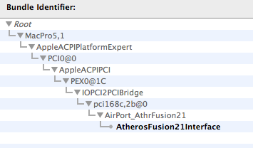

miqlas Posted May 3, 2011 Author Share Posted May 3, 2011 Search for Atheros in IOReg.Exp. Check the father node (in my example PXSX) Search for feather node in your DSDT. Patch it. Done. Link to comment https://www.insanelymac.com/forum/topic/250252-107-slow-lion/#findComment-1678479 Share on other sites More sharing options...

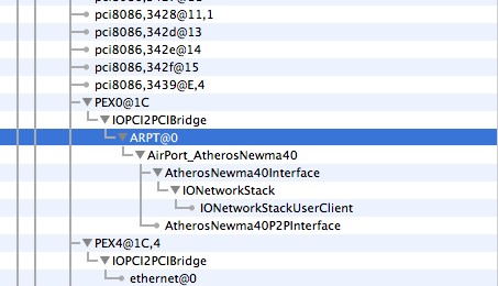

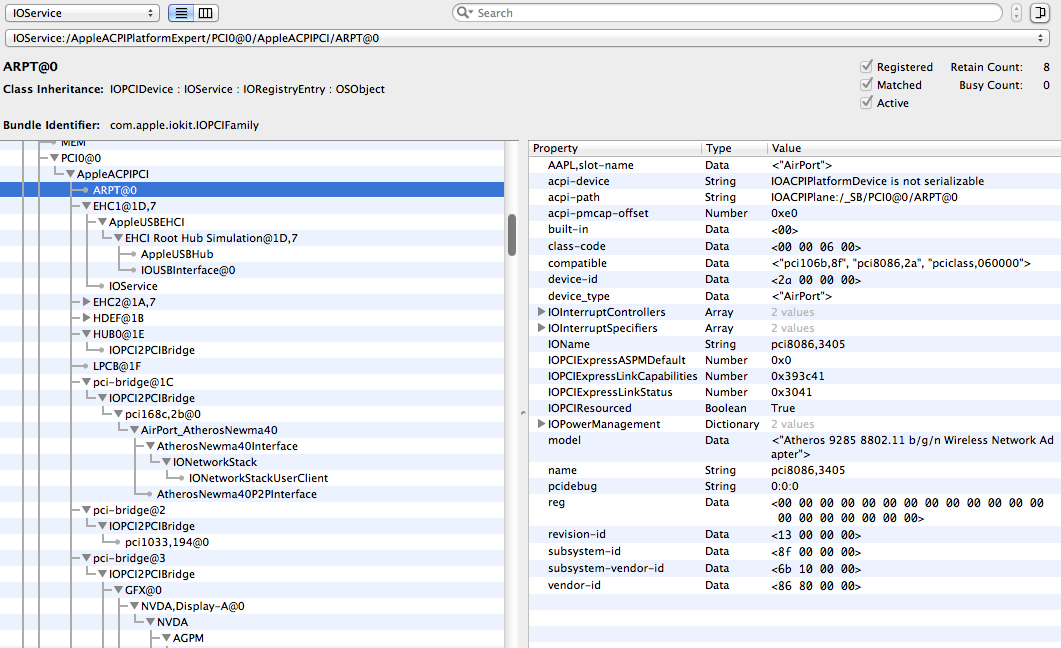

iLeopod Posted May 3, 2011 Share Posted May 3, 2011 Before: IOREG E. resulting dstdt code: Device (RP02) { Name (_ADR, 0x000F0000) Device (ARPT) { Name (_ADR, 0x000A0000) Name (_SUN, Zero) Method (_DSM, 4, NotSerialized) { Store (Package () { "AAPL,slot-name", Buffer () { "AirPort" }, "class-code", Buffer (0x04) {0x00, 0x80, 0x02, 0x00}, "device-id", Buffer (0x04) {0x1C, 0x00, 0x00, 0x00}, "model", Buffer (0x0E) { "Netgear W311T" }, "device_type", Buffer (0x08) { "AirPort" }, "built-in", Buffer (One) { 0x00 }, "subsystem-id", Buffer (0x04) {0x87, 0x00, 0x00, 0x00}, "subsystem-vendor-id", Buffer (0x04) {0x6B, 0x10, 0x00, 0x00}, "vendor-id", Buffer (0x04) {0x8C, 0x16, 0x00, 0x00} }, Local0) DTGP (Arg0, Arg1, Arg2, Arg3, RefOf (Local0)) Return (Local0) } } important is @f @a what is in DSDT Name (_ADR, 0x000F0000) and Name (_ADR, 0x000A0000) Link to comment https://www.insanelymac.com/forum/topic/250252-107-slow-lion/#findComment-1678528 Share on other sites More sharing options...
Jordan2Delta Posted May 4, 2011 Share Posted May 4, 2011 Thanks for your help both of you. Could you please check my modified version for errors? It all compiled correctly but it had no effect on my Lion install. I have tried it already on Lion, but console log says interface exists, p2p, segmentation error, crash. I had the same errors without modifying my DSDT. (I only added the vendor and device id to AirPortAtheros40.kext at that time) During that time trying to access to my wlan network the rainbow of death slows down my machine like hell. Only deactivating Wi-fi helps. ******Original Version******* Device (PEX0) { Name (_ADR, 0x001C0000) Method (_STA, 0, NotSerialized) { Return (0x0F) } Method (_PRW, 0, NotSerialized) { Return (Package (0x02) { 0x09, 0x05 }) } *****Modified Version***** Device (ARPT) { Name (_ADR, 0x001C0000) // or should I better change this to 'Zero' or '0x00' ? Name (_PRW, Package (0x02) { 0x0B, 0x05 }) Method (_DSM, 4, NotSerialized) { Store (Package (0x0C) { "AAPL,slot-name", Buffer (0x08) { "AirPort" }, "device-id", Unicode ("*"), "device_type", Buffer (0x08) { "AirPort" }, "model", Buffer (0x34) { "Atheros 9285 8802.11 b/g/n Wireless Network Adapter" }, "subsystem-id", Buffer (0x04) { 0x8F, 0x00, 0x00, 0x00 }, "subsystem-vendor-id", Buffer (0x04) { 0x6B, 0x10, 0x00, 0x00 } }, Local0) DTGP (Arg0, Arg1, Arg2, Arg3, RefOf (Local0)) Return (Local0) } Link to comment https://www.insanelymac.com/forum/topic/250252-107-slow-lion/#findComment-1678695 Share on other sites More sharing options...
iLeopod Posted May 4, 2011 Share Posted May 4, 2011 Name (_ADR, 0x001C0000) // or should I better change this to 'Zero' or '0x00' ? yes it should be zero. Link to comment https://www.insanelymac.com/forum/topic/250252-107-slow-lion/#findComment-1678759 Share on other sites More sharing options...

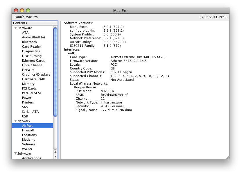

Jordan2Delta Posted May 4, 2011 Share Posted May 4, 2011 Ok, I set it to 'Zero'. Unfortunately, the following still happens when trying to connect to my WLAN router: The Airport menu shows I would be connected to my network but there is an exclamation mark which means: Internet connection not available. createP2PInterface seems to be the culprit. It repeatedly mentions: "ERROR: P2P device interface exists" Please have also a look at my ioreg. My Atheros 9285 04:00.0 Network controller [0280]: Atheros Communications Inc. AR9285 Wireless Network Adapter (PCI-Express) [168c:002b] (rev 01) is mentioned on ARPT@0 and pci-bridge@1C 5/4/11 2:14:19.000 PM kernel: 403.879785: createP2PInterface: ERROR: P2P device interface exists 5/4/11 2:14:19.000 PM kernel: 403.879788: setVIRTUAL_IF_CREATE: createP2PInterface call FAILED 5/4/11 2:14:19.000 PM kernel: en2: BSSID changed to 30:33:4b:e1:c4:a2 5/4/11 2:14:25.314 PM System Preferences: GetDYLDEntryPointWithImage(/System/Library/Frameworks/AppKit.framework/Versions/C/AppKit,_NSFullScreenWindowTransitionState) failed. 5/4/11 2:14:28.482 PM airportd: __SCDynamicStoreReconnectNotifications: SCDynamicStoreSetNotificationKeys() failed 5/4/11 2:14:28.482 PM airportd: SCDynamicStore server failed, notification (inform w/dispatch) not restored 5/4/11 2:14:28.494 PM mDNSResponder: mDNSPlatformSetDNSConfig: Error: dns_configuration_copy returned NULL 5/4/11 2:14:28.495 PM mDNSResponder: mDNSPlatformSetDNSConfig: Error: dns_configuration_copy returned NULL 5/4/11 2:14:28.527 PM airportd: _processDLILEvent: en2 attached (up) 5/4/11 2:14:28.528 PM configd: _createP2PDeviceInterface: Failed to create P2P device interface for en2 (Operation already in progress) 5/4/11 2:14:28.862 PM com.apple.launchd: (com.apple.configd[425]) Job appears to have crashed: Segmentation fault: 11 5/4/11 2:14:28.862 PM com.apple.launchd: (com.apple.configd) Throttling respawn: Will start in 10 seconds 5/4/11 2:14:28.908 PM ReportCrash: Saved crash report for configd[425] version ??? (???) to /Library/Logs/DiagnosticReports/configd_2011-05-04-141428_localhost.crash 5/4/11 2:14:29.000 PM kernel: 414.275418: createP2PInterface: ERROR: P2P device interface exists 5/4/11 2:14:29.000 PM kernel: 414.275421: setVIRTUAL_IF_CREATE: createP2PInterface call FAILED 5/4/11 2:14:29.000 PM kernel: en2: BSSID changed to 30:33:4b:e1:c4:a2 The errors above and the AtherosNewma40P2PInterface on ioreg vanish if Apple80211Monitor.bundle removed. Then it connects to internet but the AirPort menu is greyed out. No indication how strong the signal is. Link to comment https://www.insanelymac.com/forum/topic/250252-107-slow-lion/#findComment-1678904 Share on other sites More sharing options...
iLeopod Posted May 4, 2011 Share Posted May 4, 2011 Dont delete the pci bridge: Device (RP02) { Name (_ADR, 0x001C0000) Device (ARPT) { Name (_ADR, Zero) Name (_SUN, Zero) Method (_DSM, 4, NotSerialized) {//device info .... Link to comment https://www.insanelymac.com/forum/topic/250252-107-slow-lion/#findComment-1678908 Share on other sites More sharing options...
Jordan2Delta Posted May 6, 2011 Share Posted May 6, 2011 Thanks for your help, iLeopod. I followed your hint and could integrate the two devices together. Please look at the image. For some reason I still get these error messages and the symptoms hasn't changed a little bit. Needless to say in SL it connects just fine. The network PCIe card is 99% functioning as an AirPort substitute. Only 'n' mode doesn't work. 5/6/11 1:50:54.939 PM configd: _createP2PDeviceInterface: Failed to create P2P device interface for en2 (Operation already in progress) 5/6/11 1:50:54.000 PM kernel: 259.965835: createP2PInterface: ERROR: P2P device interface exists 5/6/11 1:50:54.000 PM kernel: 259.965838: setVIRTUAL_IF_CREATE: createP2PInterface call FAILED 5/6/11 1:50:54.000 PM kernel: AirPort: Link Down on en2. Reason 8 (Disassociated because station leaving). 5/6/11 1:50:54.000 PM kernel: en2: BSSID changed to 30:33:4b:e1:c4:a2 5/6/11 1:50:54.000 PM kernel: 259.971120: setDISASSOC from disconnectVap 5/6/11 1:50:54.000 PM kernel: 259.983849: setDISASSOCIATE ****STA SYNC DISASSOC SUCCESS 5/6/11 1:50:54.000 PM kernel: 259.983855: switchVap from 1 to 1 5/6/11 1:50:54.970 PM UserEventAgent: CaptiveNetworkSupport:CaptivePublishState:1211 en2 - PreProbe 5/6/11 1:50:54.972 PM configd: bootp_session_transmit: bpf_write(en2) failed: Network is down (50) 5/6/11 1:50:54.972 PM configd: DHCP en2: INIT transmit failed 5/6/11 1:50:54.987 PM configd: ioctl(SIOCGIFCAP) failed: Device not configured 5/6/11 1:50:54.987 PM configd: ioctl(SIOCGIFCAP) failed: Device not configured 5/6/11 1:50:54.990 PM configd: network configuration changed. 5/6/11 1:50:55.102 PM airportd: _processDLILEvent: en2 attached (up) 5/6/11 1:50:55.167 PM System Preferences: SCDynamicStore server failed, notification () not restored 5/6/11 1:50:55.176 PM ReportCrash: DebugSymbols was unable to start a spotlight query: spotlight is not responding or disabled. 5/6/11 1:50:55.422 PM com.apple.launchd: (com.apple.airportd[448]) Job appears to have crashed: Segmentation fault: 11 5/6/11 1:50:55.498 PM ReportCrash: Saved crash report for airportd[448] version ??? (???) to /Library/Logs/DiagnosticReports/airportd_2011-05-06-135055_localhost.crash Link to comment https://www.insanelymac.com/forum/topic/250252-107-slow-lion/#findComment-1680108 Share on other sites More sharing options...
Jordan2Delta Posted May 27, 2011 Share Posted May 27, 2011 Thanks for your help, iLeopod. I followed your hint and could integrate the two devices together. Please look at the image. For some reason I still get these error messages and the symptoms hasn't changed a little bit. Needless to say in SL it connects just fine. The network PCIe card is 99% functioning as an AirPort substitute. Only 'n' mode doesn't work. 5/6/11 1:50:54.939 PM configd: _createP2PDeviceInterface: Failed to create P2P device interface for en2 (Operation already in progress) 5/6/11 1:50:54.000 PM kernel: 259.965835: createP2PInterface: ERROR: P2P device interface exists 5/6/11 1:50:54.000 PM kernel: 259.965838: setVIRTUAL_IF_CREATE: createP2PInterface call FAILED 5/6/11 1:50:54.000 PM kernel: AirPort: Link Down on en2. Reason 8 (Disassociated because station leaving). 5/6/11 1:50:54.000 PM kernel: en2: BSSID changed to 30:33:4b:e1:c4:a2 5/6/11 1:50:54.000 PM kernel: 259.971120: setDISASSOC from disconnectVap 5/6/11 1:50:54.000 PM kernel: 259.983849: setDISASSOCIATE ****STA SYNC DISASSOC SUCCESS 5/6/11 1:50:54.000 PM kernel: 259.983855: switchVap from 1 to 1 5/6/11 1:50:54.970 PM UserEventAgent: CaptiveNetworkSupport:CaptivePublishState:1211 en2 - PreProbe 5/6/11 1:50:54.972 PM configd: bootp_session_transmit: bpf_write(en2) failed: Network is down (50) 5/6/11 1:50:54.972 PM configd: DHCP en2: INIT transmit failed 5/6/11 1:50:54.987 PM configd: ioctl(SIOCGIFCAP) failed: Device not configured 5/6/11 1:50:54.987 PM configd: ioctl(SIOCGIFCAP) failed: Device not configured 5/6/11 1:50:54.990 PM configd: network configuration changed. 5/6/11 1:50:55.102 PM airportd: _processDLILEvent: en2 attached (up) 5/6/11 1:50:55.167 PM System Preferences: SCDynamicStore server failed, notification () not restored 5/6/11 1:50:55.176 PM ReportCrash: DebugSymbols was unable to start a spotlight query: spotlight is not responding or disabled. 5/6/11 1:50:55.422 PM com.apple.launchd: (com.apple.airportd[448]) Job appears to have crashed: Segmentation fault: 11 5/6/11 1:50:55.498 PM ReportCrash: Saved crash report for airportd[448] version ??? (???) to /Library/Logs/DiagnosticReports/airportd_2011-05-06-135055_localhost.crash Update: I borrowed an orginal Apple branded card from a friend and put it in my machine. I also did a fresh install with that card, but I still get those nasty Segmantation Errors and configd crashes. Is this a Lion beta thing or could this be caused by Chameleon? I might add it's working 100% on Snow Leopard out of box without ANY modifications, enablers or whatsoever. Link to comment https://www.insanelymac.com/forum/topic/250252-107-slow-lion/#findComment-1689333 Share on other sites More sharing options...
