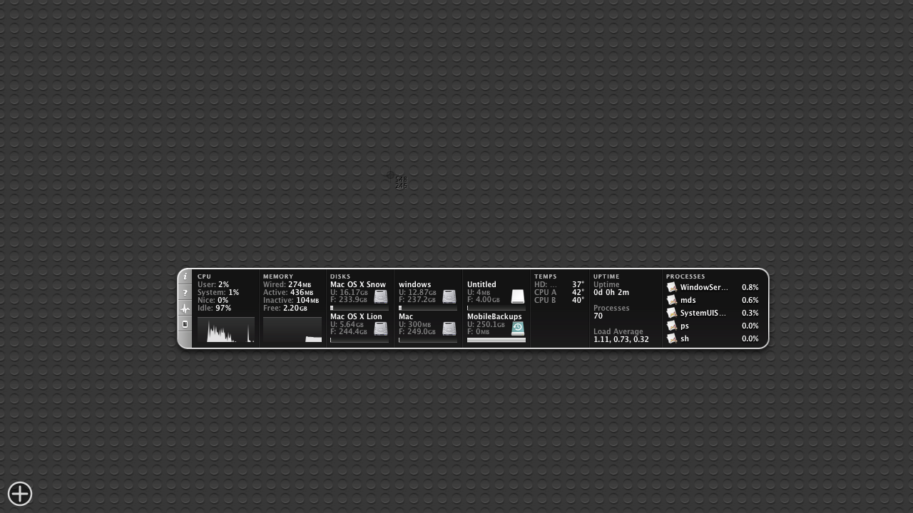

Crosx86 Posted March 16, 2011 Share Posted March 16, 2011 http://www.insanelymac.com/forum/index.php?showtopic=224878 Old testei o repouco do monitor e ele não apagou o monitor,mais sumiu o mouse,vou por uma imagem ai do istat e testar o reboot. Acho que ta tudo certo... Link to comment https://www.insanelymac.com/forum/topic/249773-guia-instalando-macosx-lion-developer-preview-3-iboot/page/5/#findComment-1655919 Share on other sites More sharing options...

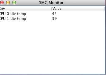

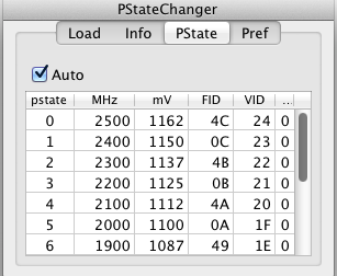

oldnapalm Posted March 16, 2011 Share Posted March 16, 2011 Use o SMC Monitor e o IntelCPUMonitor para verificar o SpeedStep http://www.insanelymac.com/forum/index.php?showtopic=244959 Link to comment https://www.insanelymac.com/forum/topic/249773-guia-instalando-macosx-lion-developer-preview-3-iboot/page/5/#findComment-1655921 Share on other sites More sharing options...

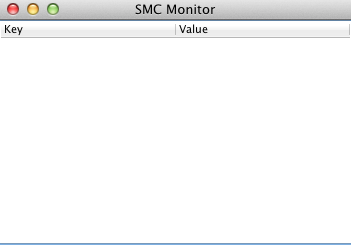

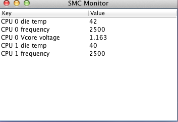

Crosx86 Posted March 16, 2011 Share Posted March 16, 2011 Use o SMC Monitor e o IntelCPUMonitor para verificar o SpeedStephttp://www.insanelymac.com/forum/index.php?showtopic=244959 Old a informação que ele me da é essa aqui: com a kext IntelCPUMonitor em /s/l/e. restart pela metade,para na tela preta,mais o resto ta tudo funcionando. Link to comment https://www.insanelymac.com/forum/topic/249773-guia-instalando-macosx-lion-developer-preview-3-iboot/page/5/#findComment-1655924 Share on other sites More sharing options...

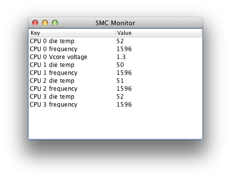

oldnapalm Posted March 16, 2011 Share Posted March 16, 2011 Estranho, deveria mostrar a "Vcore voltage" do CPU e a "frequency" de todos os cores. Você está usando a FakeSMC que funciona com plugins? Link to comment https://www.insanelymac.com/forum/topic/249773-guia-instalando-macosx-lion-developer-preview-3-iboot/page/5/#findComment-1655930 Share on other sites More sharing options...
Crosx86 Posted March 16, 2011 Share Posted March 16, 2011 Estranho, deveria mostrar a "Vcore voltage" do CPU e a "frequency" de todos os cores. Você está usando a FakeSMC que funciona com plugins? não to usando a 2.5. se voçe tiver link da que funciona com plugins me passa eu instalo. ja to inslando,vo deixar o dsdt ai por favor veja se cometi algum erro. dsdt.aml.zip Old piorou a com plugins não mostra nada: com essa aqui funcinou: FakeSMC.kext.zip imagem: Link to comment https://www.insanelymac.com/forum/topic/249773-guia-instalando-macosx-lion-developer-preview-3-iboot/page/5/#findComment-1655932 Share on other sites More sharing options...
oldnapalm Posted March 16, 2011 Share Posted March 16, 2011 A FakeSMC vem no pacote do tópico, você precisa usá-la em conjunto com a IntelCPUMonitor. Aqui está funcionando no Lion, apesar das frequências não serem exatas porque o [url="http://www.insanelymac.com/forum/topic/279450-why-insanelymac-does-not-support-tonymacx86/"]#####[/url] detecta o FSB errado A única diferença é que eu carreguei manualmente a da partição do Snow. No próximo boot vou tentar copiar a IntelCPUMonitor para /S/L/E do Lion para ver se funciona. Não esqueça de remover o kernelcache quando adiciona ou modifica kexts em /S/L/E. Quanto ao DSDT, aparentemente está certo, só não sei quanto aos valores FID e VID. Link to comment https://www.insanelymac.com/forum/topic/249773-guia-instalando-macosx-lion-developer-preview-3-iboot/page/5/#findComment-1655937 Share on other sites More sharing options...
Crosx86 Posted March 16, 2011 Share Posted March 16, 2011 A FakeSMC vem no pacote do tópico, você precisa usá-la em conjunto com a IntelCPUMonitor. Aqui está funcionando no Lion, apesar das frequências não serem exatas porque o [url="http://www.insanelymac.com/forum/topic/279450-why-insanelymac-does-not-support-tonymacx86/"]#####[/url] detecta o FSB errado A única diferença é que eu carreguei manualmente a da partição do Snow. No próximo boot vou tentar copiar a IntelCPUMonitor para /S/L/E do Lion para ver se funciona. Não esqueça de remover o kernelcache quando adiciona ou modifica kexts em /S/L/E. Quanto ao DSDT, aparentemente está certo, só não sei quanto aos valores FID e VID. Old com a kext que vem no pacote saiu essa imagem: Link to comment https://www.insanelymac.com/forum/topic/249773-guia-instalando-macosx-lion-developer-preview-3-iboot/page/5/#findComment-1655939 Share on other sites More sharing options...

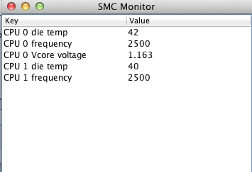

oldnapalm Posted March 16, 2011 Share Posted March 16, 2011 Mas as frequências oscilam ou ficam paradas em 2500? Link to comment https://www.insanelymac.com/forum/topic/249773-guia-instalando-macosx-lion-developer-preview-3-iboot/page/5/#findComment-1655940 Share on other sites More sharing options...

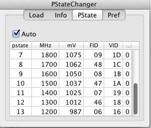

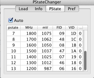

Crosx86 Posted March 16, 2011 Share Posted March 16, 2011 @OLDNAPALM Ficam paradas em 2500. O PStateschanger não funciona aqui,fica em branco. Link to comment https://www.insanelymac.com/forum/topic/249773-guia-instalando-macosx-lion-developer-preview-3-iboot/page/5/#findComment-1655941 Share on other sites More sharing options...
oldnapalm Posted March 16, 2011 Share Posted March 16, 2011 Você precisa carregar a kext que vem junto com o PStateChanger para que ele mostre os valores. No Snow as frequências variam? Entre no Snow usando o Chameleon RC5 com os generate states ativados e extraia a SSDT perl -e 'open(CMD, "ioreg -lw0 \| grep SSDT|") or die; while(<CMD>) { chomp; if($_ =~ /\"SSDT\.?\d?\"=<([^>]*)>/) { $buff = $1; open(PIP, "|xxd -r -p > ~/Desktop/SSDT.aml") or die; print PIP "$1"; } }' Tente extrair também a FACP e coloque no [url="http://www.insanelymac.com/forum/topic/279450-why-insanelymac-does-not-support-tonymacx86/"]#####[/url] para ver se resolve o restart perl -e 'open(CMD, "ioreg -lw0 \| grep FACP|") or die; while(<CMD>) { chomp; if($_ =~ /\"FACP\.?\d?\"=<([^>]*)>/) { $buff = $1; open(PIP, "|xxd -r -p > ~/Desktop/FACP.aml") or die; print PIP "$1"; } }' As versões anteriores do [url="http://www.insanelymac.com/forum/topic/279450-why-insanelymac-does-not-support-tonymacx86/"]#####[/url] carregavam estas tabelas, a 1.4 eu não sei se não carrega apenas a DSDT. Link to comment https://www.insanelymac.com/forum/topic/249773-guia-instalando-macosx-lion-developer-preview-3-iboot/page/5/#findComment-1655944 Share on other sites More sharing options...

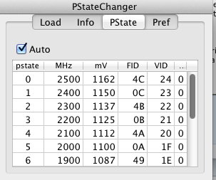

oldnapalm Posted March 16, 2011 Share Posted March 16, 2011 A SSDT só tem os C states, os P devem estar na SSDT-1 perl -e 'open(CMD, "ioreg -lw0 \| grep SSDT-1|") or die; while(<CMD>) { chomp; if($_ =~ /\"SSDT-1\.?\d?\"=<([^>]*)>/) { $buff = $1; open(PIP, "|xxd -r -p > ~/Desktop/SSDT-1.aml") or die; print PIP "$1"; } }' Até a versão anterior do [url="http://www.insanelymac.com/forum/topic/279450-why-insanelymac-does-not-support-tonymacx86/"]#####[/url] todas as tabelas iam na pasta efi/acpi/oem. Na atual (1.4) só tem a pasta efi/dsdt, então não sei se ele carrega as outras tabelas, não tenho como testar pois na minha placa só funciona o DSDT patching na versão 1.2 usando o módulo AcpiPatcher. Os P e C states podem ser colocados na DSDT. O fix do restart tem que ser na FACP mesmo. Link to comment https://www.insanelymac.com/forum/topic/249773-guia-instalando-macosx-lion-developer-preview-3-iboot/page/5/#findComment-1655972 Share on other sites More sharing options...
Crosx86 Posted March 16, 2011 Share Posted March 16, 2011 A SSDT só tem os C states, os P devem estar na SSDT-1 perl -e 'open(CMD, "ioreg -lw0 \| grep SSDT-1|") or die; while(<CMD>) { chomp; if($_ =~ /\"SSDT-1\.?\d?\"=<([^>]*)>/) { $buff = $1; open(PIP, "|xxd -r -p > ~/Desktop/SSDT-1.aml") or die; print PIP "$1"; } }' Até a versão anterior do [url="http://www.insanelymac.com/forum/topic/279450-why-insanelymac-does-not-support-tonymacx86/"]#####[/url] todas as tabelas iam na pasta efi/acpi/oem. Na atual (1.4) só tem a pasta efi/dsdt, então não sei se ele carrega as outras tabelas, não tenho como testar pois na minha placa só funciona o DSDT patching na versão 1.2 usando o módulo AcpiPatcher. Os P e C states podem ser colocados na DSDT. O fix do restart tem que ser na FACP mesmo. No Snow as frequências variam? No snow não funciona,acho eu que é pq o chameleon esta a fazer...?e quando eu rodei os comandos e dei o primeiro reboot depois de instalar bagunçou toda a bios,por isso demorei um pouco pra voltar,mais as coisas abaixaram por aqui inclusive as temperaturas e o FACP não esta no [url="http://www.insanelymac.com/forum/topic/279450-why-insanelymac-does-not-support-tonymacx86/"]#####[/url] ele abre na bios as serial port e da tela preta no boot do [url="http://www.insanelymac.com/forum/topic/279450-why-insanelymac-does-not-support-tonymacx86/"]#####[/url] eu retirei. vai ai as imagen PStates: imagem do SMC monitor: agora vou testar o restart,mesmo com o FACP no [url="http://www.insanelymac.com/forum/topic/279450-why-insanelymac-does-not-support-tonymacx86/"]#####[/url] não funcionou. Link to comment https://www.insanelymac.com/forum/topic/249773-guia-instalando-macosx-lion-developer-preview-3-iboot/page/5/#findComment-1655976 Share on other sites More sharing options...

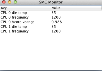

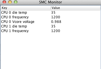

oldnapalm Posted March 16, 2011 Share Posted March 16, 2011 @CROSX86 Não entendi por que perdeu as configurações do BIOS, talvez esta versão do [url="http://www.insanelymac.com/forum/topic/279450-why-insanelymac-does-not-support-tonymacx86/"]#####[/url] não funcione com outras tabelas ACPI além da DSDT. Mas se as frequências baixaram, está tudo certo, talvez no início estavam sempre altas por causa do Spotlight, aqui também ele ficou trabalhando um bom tempo nos primeiros boots do Lion. Os valores FID e VID estão certos, vi que tem no DSDT Editor o patch pronto para o seu CPU. @C.Frio A FakeSMC mais recente você encontra aqui http://www.insanelymac.com/forum/index.php?showtopic=244959 @JahRastaMaN Pode usar as kexts para Snow Leopard, elas funcionam sem problemas no Lion. Link to comment https://www.insanelymac.com/forum/topic/249773-guia-instalando-macosx-lion-developer-preview-3-iboot/page/5/#findComment-1656098 Share on other sites More sharing options...
Crosx86 Posted March 16, 2011 Share Posted March 16, 2011 @Oldnapalm Opa old boa tarde,sim baixaram,eu tb não entendi mais bagunçou somente a hora e a aba acpi (power configuration). Eu usei o path pronto no dsdt:E5200__P001_4.txtme parece estar tudo ok,tudo funcionando aqui,rede,video,audio e agora gerenciamento de energia nativa,vamos testar e antes de mais nada obg video:NVEnabler.kext.zip rede:RTGMac_v2.0.5.zip audio:VoodooHDA_2.7.Jackieboy8.pkg.zip gerenciamento de energia nativa:dsdt.aml + PStateChangerv1.0.3__1_.zip + voodoopstate.v4.zip mouse e teclado PS/2:AppleACPIPS2Nub.kext.zip + VoodooPS2Controller.kext.zip É isso ai Link to comment https://www.insanelymac.com/forum/topic/249773-guia-instalando-macosx-lion-developer-preview-3-iboot/page/5/#findComment-1656115 Share on other sites More sharing options...
