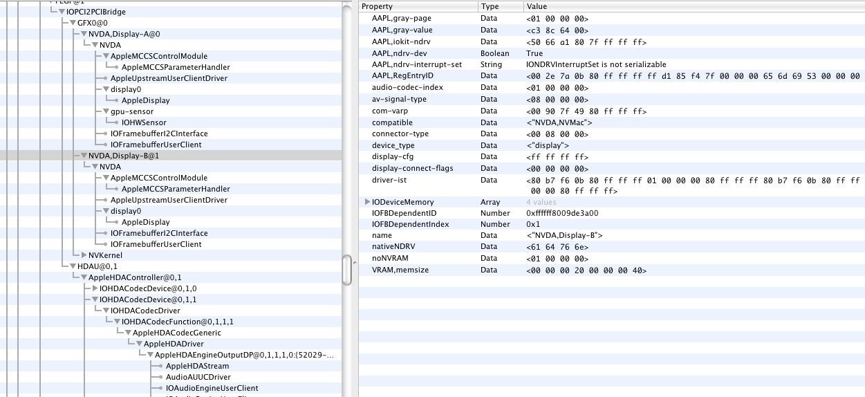

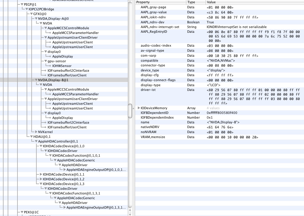

bcc9 Posted March 21, 2011 Author Share Posted March 21, 2011 The nvcap was derived from graphic card's ROM file. The same method works for other notebook model but not on sony. The internal LCD doesn't detected at all (in IORegistry).Hmm, a lot of unknown/guess fields described in those posts. Not as far along as we are here with the ATI driver PS: I'd love to know what field to set in NVCAP or NVMT or display-cfg to get the connector-type to come out as HDMI (0x00000800). Link to comment https://www.insanelymac.com/forum/topic/249642-editing-custom-personalities-for-ati-radeon-hd45xx/page/10/#findComment-1658583 Share on other sites More sharing options...

VCH888 Posted March 25, 2011 Share Posted March 25, 2011 Hmm, a lot of unknown/guess fields described in those posts. Not as far along as we are here with the ATI driver PS: I'd love to know what field to set in NVCAP or NVMT or display-cfg to get the connector-type to come out as HDMI (0x00000800). Off the topic add these lines in dsdt for getting HDMI audio. Credit to toleda. "@1,connector-type", Buffer (0x04) { 0x00, 0x08, 0x00, 0x00 }, Link to comment https://www.insanelymac.com/forum/topic/249642-editing-custom-personalities-for-ati-radeon-hd45xx/page/10/#findComment-1660667 Share on other sites More sharing options...

bcc9 Posted March 25, 2011 Author Share Posted March 25, 2011 add these lines in dsdt for getting HDMI audio. Thanks, I had tried that and it isn't sufficient to get working audio in my 9400m case. It's good to hear that setting connector-type is sufficient for some other nvidia cases (fermi cards). A few weeks ago when I digged further into NVDAResman, I saw that in the nvidia case, av-signal-type must also be set correctly, where 0x8 is the working hdmi value, but it turns up as 0x2 for the 9400m. Unfortunately av-signal-type is set by NVDAResman and injecting the working value has no effect. I was able to patch NVDAResman to cause av-signal-type to come out with the expected value, at which point the HDMI audio option finally did automatically hotplug on my 9400m. However audio doesn't actually pass thru If I could figure out the logic NVDAResman is using to set av-signal-type (based upon NVMT? NVCAP? display-cfg?) then I think I might have a working solution. av-signal-type is coming up as 0x8 automatically in the fermi case? Link to comment https://www.insanelymac.com/forum/topic/249642-editing-custom-personalities-for-ati-radeon-hd45xx/page/10/#findComment-1660697 Share on other sites More sharing options...
