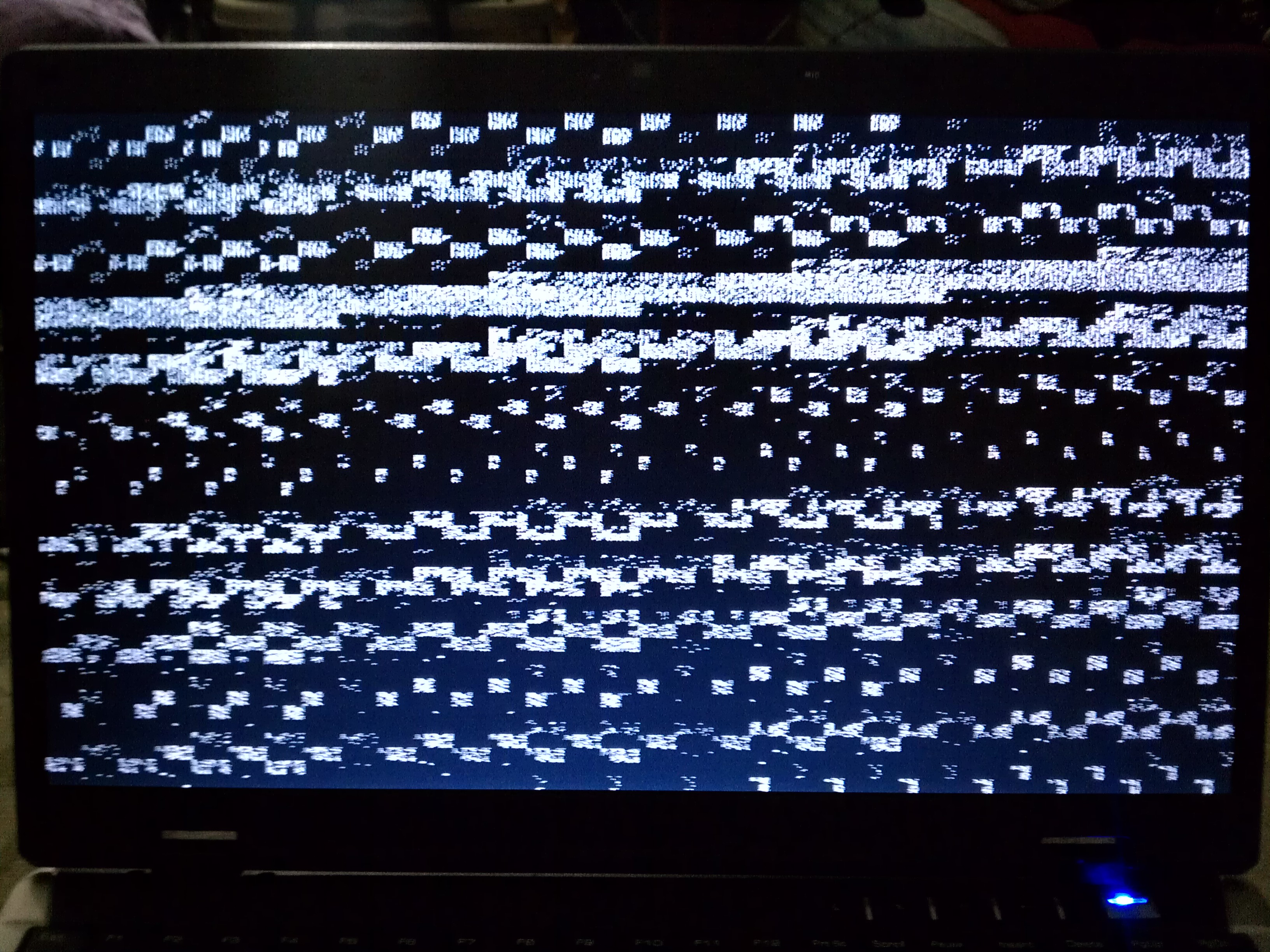

c0ke Posted October 9, 2011 Share Posted October 9, 2011 I tried the method and it still gave me garbled screen. I have attached the image as you requested. Hi, I'm happy to know about your progresses, we're almost there You don't need to modify any atisupport or other kexts as far as I know. First of all, are you using the peregrine modified boot file of chameleon? Do you apply chmod, chown and touch after any modify to S/L/E? Then, have you got an external vga display to know if even the external port is working? We must also know which of the extensions are loaded when you see the screen you posted... Once you understand the system is loaded, try to load system profiler and save a profile on the desktop or wherever you prefer to find it. You could set system profiler to load at login, then working blindly with the keyboard shortcut: save the profile (command + S) giving it an easy name (like profile00000 that you could then easily find). Then boot up with radeonHD with g.e. = no and see what's in the profile or better post it... We must know if the right extensions are loaded, if the card is correctly recognized and if it's using peregrine... Link to comment https://www.insanelymac.com/forum/topic/245308-mobility-radeon-10667-guide-for-qeci-testing-107/page/21/#findComment-1757744 Share on other sites More sharing options...
haunteddevil619 Posted October 9, 2011 Share Posted October 9, 2011 Hi, I'm happy to know about your progresses, we're almost there You don't need to modify any atisupport or other kexts as far as I know. First of all, are you using the peregrine modified boot file of chameleon? Do you apply chmod, chown and touch after any modify to S/L/E? Then, have you got an external vga display to know if even the external port is working? We must also know which of the extensions are loaded when you see the screen you posted... Once you understand the system is loaded, try to load system profiler and save a profile on the desktop or wherever you prefer to find it. You could set system profiler to load at login, then working blindly with the keyboard shortcut: save the profile (command + S) giving it an easy name (like profile00000 that you could then easily find). Then boot up with radeonHD with g.e. = no and see what's in the profile or better post it... We must know if the right extensions are loaded, if the card is correctly recognized and if it's using peregrine... Yes I am using the bootloader which you attached in the post above. I just replaced the boot file in root folder with the new one. No. I actually use kext helper to install the kext and then at restart using -f flag to rebuild the cache. I assume it is the same thing. Yes I have an external display Should I save the system configuration when using radeonHD. Because otherwise I cannot work on anything using the garbled screen. EDIT- Do I have to save the system profiler status using radeonHD.kext Because right now there is no kext loaded and it misinterprets my Graphics memory too. I also can't change the resolution from 1024x768. Even with specifying a particular resolution in boot.plist and before startup Link to comment https://www.insanelymac.com/forum/topic/245308-mobility-radeon-10667-guide-for-qeci-testing-107/page/21/#findComment-1757823 Share on other sites More sharing options...

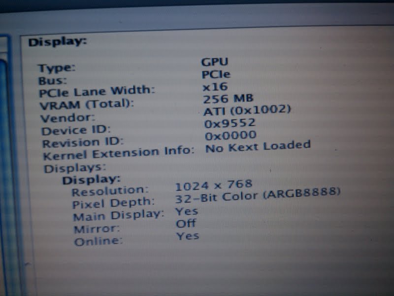

haunteddevil619 Posted October 9, 2011 Share Posted October 9, 2011 No, you need to know the system profile without radeonhd and with g.e. = no.You should be able to program a batch, maybe with Automator or with applescript editor and open the script at startup, if you can't do it blindly, when the screen is garbled.... The profile with radeonhd is useful. However what if the external display is plugged in when the lvds is garbled? I don't know how to get it without radeonHD and ge=No. I always get a garbled screen. I dont think the os is loaded properly since I try to eject the DVD drive using the F12 button and sound shortcut keys dont work. I have never tried the VGA output using mac. I have attached a pic of profile with radeonhd.kext and the profile file. I have also noticed that with ge=yes and evoenabler and in -x mode, the system correctly recognizes my card and memory (and i used chameleon2 rc5). Do you want the pic of tht configuration. Should I try the bootloader you provided with modified frame buffer and evoenabler with device id in 4600controller and x2000? MacBook_Pro.zip Link to comment https://www.insanelymac.com/forum/topic/245308-mobility-radeon-10667-guide-for-qeci-testing-107/page/21/#findComment-1757974 Share on other sites More sharing options...
c0ke Posted October 10, 2011 Share Posted October 10, 2011 I don't know how to get it without radeonHD and ge=No. I always get a garbled screen. I dont think the os is loaded properly since I try to eject the DVD drive using the F12 button and sound shortcut keys dont work. I have never tried the VGA output using mac. I have attached a pic of profile with radeonhd.kext and the profile file. I have also noticed that with ge=yes and evoenabler and in -x mode, the system correctly recognizes my card and memory (and i used chameleon2 rc5). Do you want the pic of tht configuration. Should I try the bootloader you provided with modified frame buffer and evoenabler with device id in 4600controller and x2000? Hmmm.. if you think the OS is not properly loaded maybe a kp occours. try to boot with -v to be sure and see where it hangs. I'm not sure anyway, because if you see the garbled screen after the grey apple logo with spinning wheel it seems the desktop should be loaded without kp. Maybe also your keyboard is not properly recognized (you could try to test it with an external keyboard too). I don't think it is a bootloader issue. In the profile you posted, the card is not recognized. And only atisupport and atiRadeonx2000 are loaded. However we've got no enough info since we need the profile taken with the garbled screen to know what's happening. I remember I was able to do it blindly when I was testing different framebuffer solutions.. Link to comment https://www.insanelymac.com/forum/topic/245308-mobility-radeon-10667-guide-for-qeci-testing-107/page/21/#findComment-1758111 Share on other sites More sharing options...

c0ke Posted October 13, 2011 Share Posted October 13, 2011 Holla Coke, I have got the breakthrough!! I managed to get system profiler information saved from blank display. When ge=on, the graphic card is recognized with proper vram. but it seems that it is not connected to any display connector. i tried lvds and vga both. I have attached them here. One is with ge=on and other with ge=off. in ge=on i was getting a blank screen after the os loads and in off, i was with the verbose screen. other easy ways to get it saved are - from safe mode attach system profiler to startup after you log in the account. this can be done from accounts in system preferences -other way is to drag the mouse pointer to top right corner and click on spotlight. enter system profiler and click enter. it will open up. Well! the "on" profile indicate that everything is loading well. the card is properly recognized in graphic/dispaly and in pci board too with the correct fb assigned. All the kexts are loaded: ati4600controller, atiframebuffer, radeonx2000 and atisupport. If neither your patched version of atiframebuffer and kizwan's one works I think the patch is not the right one for your card. No display was detected so it seems there is not a proper connection instruction on both ports. It means it's still a different card than mine. I think you should follow mucha's guide to figure out the right values for your card's connectorType, transmitter, encoder, ports, senseid and whatever else... So you could patch your framebuffer from zero. You can try to do it using the 10.7 (linked above) solution on an external vga display (the internal lvds gets wrong colors) Link to comment https://www.insanelymac.com/forum/topic/245308-mobility-radeon-10667-guide-for-qeci-testing-107/page/21/#findComment-1759277 Share on other sites More sharing options...
haunteddevil619 Posted October 13, 2011 Share Posted October 13, 2011 Well! the "on" profile indicate that everything is loading well.the card is properly recognized in graphic/dispaly and in pci board too with the correct fb assigned. All the kexts are loaded: ati4600controller, atiframebuffer, radeonx2000 and atisupport. If neither your patched version of atiframebuffer and kizwan's one works I think the patch is not the right one for your card. No display was detected so it seems there is not a proper connection instruction on both ports. It means it's still a different card than mine. I think you should follow mucha's guide to figure out the right values for your card's connectorType, transmitter, encoder, ports, senseid and whatever else... So you could patch your framebuffer from zero. You can try to do it using the 10.7 (linked above) solution on an external vga display (the internal lvds gets wrong colors) OK. Guess I will have to do everything else further by myself. But before continuing, can you tell me how should I identify my ATIFramebuffer. Because I am not sure my card uses Peregrine. Because MSI has released other similar design laptops with HDMI and same video card. So they might have put the internals for HDMI in my card but not just put the interface. So if I can confirm which framebuffer I use, I can go ahead. Also does everst work to get mobility bios dump? Link to comment https://www.insanelymac.com/forum/topic/245308-mobility-radeon-10667-guide-for-qeci-testing-107/page/21/#findComment-1759378 Share on other sites More sharing options...
