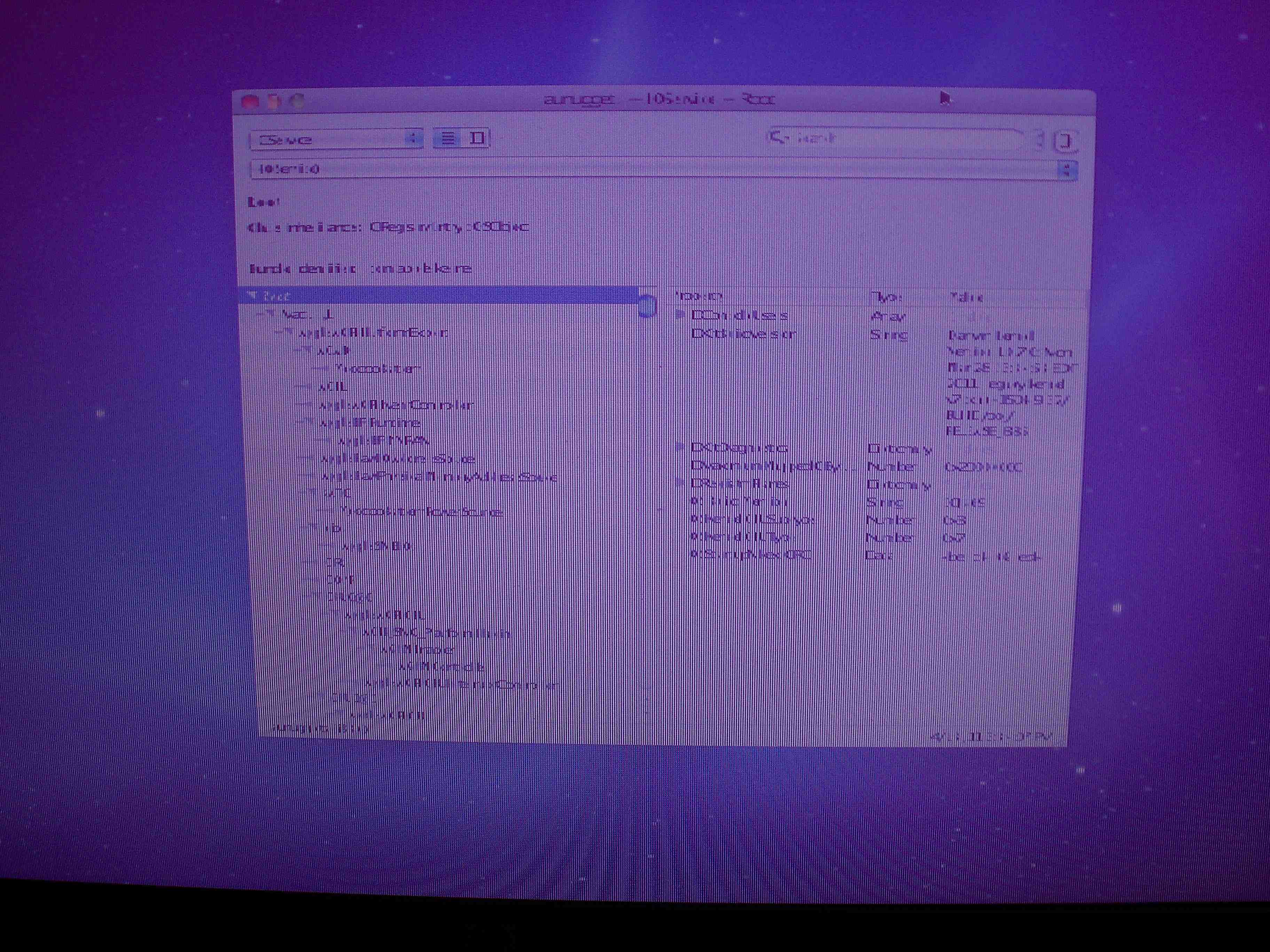

linus4200 Posted April 24, 2011 Share Posted April 24, 2011 Hola after trying nearly all the solutions I found google*ing around, to get my ATI Mobility Radeon HD 4530 to run dual screen with full Resolution, I was able to get both screens running. The external screen is working OK, however the "Laptop Screen" shows up in System Preferences with full Resolution 1600x900 but all you see gets a touch of purple and everything has distortions so that you can see the finder items, but you have to guess what's written, as you can not read anything. I am using ATIFramebuffer: Shrike 02 00 00 00 40 00 00 00 09 01 00 00 02 01 00 07 (LVDS) 10 00 00 00 10 00 00 00 00 01 00 00 10 10 01 06 (VGA) 00 08 00 00 00 02 00 00 00 01 00 00 20 00 02 02 (HDMI NONE) I tried to inject into dsdt.aml dual link fix but maybe not correctly. dsdt.aml.zip A resume of the Info I gather including ioreg up to what I achieved so far : LINUS_Ati_Mobility_Radeon_4530_Info.pdf LINUS_ioregDualLinkFix.ioreg.zip Well it seems that I am near but after trying to apply all I learned so far without getting it done, maybe someone here could have a look if I am trying to do something impossible. Thx for any tip and help. linus Link to comment https://www.insanelymac.com/forum/topic/245308-mobility-radeon-10667-guide-for-qeci-testing-107/page/18/#findComment-1674094 Share on other sites More sharing options...
crazybirdy Posted April 27, 2011 Share Posted April 27, 2011 however the "Laptop Screen" shows up in System Preferences with full Resolution 1600x900 but all you see gets a touch of purple and everything has distortions so that you can see the finder items, but you have to guess what's written, as you can not read anything. How about add EDID for LVDS ? Try it. Link to comment https://www.insanelymac.com/forum/topic/245308-mobility-radeon-10667-guide-for-qeci-testing-107/page/18/#findComment-1675176 Share on other sites More sharing options...
