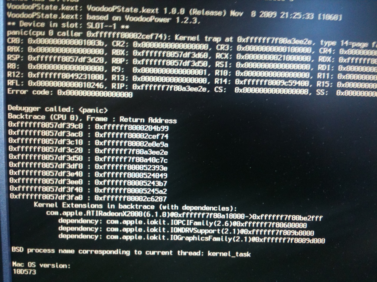

gwmarthe Posted January 16, 2011 Share Posted January 16, 2011 Hey everyone, I am slowly making progress with my hackintosh!!! I used iATKOS v3 and got the OS installed and went to reboot and still get an error... I have attached a screenshot of it, please take a look to see if you know what this means!!! It looks like its a cpu error but I am not really sure i'm just a noob... please let me know...I think I am so close!!!!!!! Please help!!! Quote Link to comment Share on other sites More sharing options...
Nameci Posted January 16, 2011 Share Posted January 16, 2011 Post your rig specs so others can look at it if it is compatible or not. Seems like your gfx card is causing it, I maybe wrong. Quote Link to comment Share on other sites More sharing options...
Steven M Posted January 16, 2011 Share Posted January 16, 2011 It seems like the ATI driver that you're using in that install isn't working, maybe try another bootdisk or install another Kext in Extra/Extensions? Quote Link to comment Share on other sites More sharing options...
gwmarthe Posted January 16, 2011 Author Share Posted January 16, 2011 Sorry about that!!! Motherboard - Gigabyte x48 DS4 CPU - Intel core 2 duo e8500 video card - ATI 4850 Ram -4 Gb G Skill Thanks for the quick response Post your rig specs so others can look at it if it is compatible or not. Seems like your gfx card is causing it, I maybe wrong. Thanks for the quick responses!! Sorry, I forgot to list specs... Motherboard - Gigabyte x48 DS4 CPU - Intel core 2 duo e8500 Video card - ATI 4850 I have tried several boot cds like [url="http://www.insanelymac.com/forum/topic/279450-why-insanelymac-does-not-support-tonymacx86/"]#####[/url], empire efi, and a few others and they never work, which is annoying because i bought the retail snow leopard 10.6.3... I then tried iatkos and it installed the os but now just having this issue!!! Thanks for the help!!! Quote Link to comment Share on other sites More sharing options...
gwmarthe Posted January 16, 2011 Author Share Posted January 16, 2011 UPDATE!!!!!! Booted up with -v -x and was able to create an account and actually get on to the desktop.. Clearly in safe mode I wont be able to fix my resultion or anything... Is this a good sign will I be able to modify anything in safe mode or is this pretty much worthless... I was excited to get on but then I realized it s safe mode and I probably wont be able to make any changes... Please let me know, thanks!!! Quote Link to comment Share on other sites More sharing options...
Nameci Posted January 17, 2011 Share Posted January 17, 2011 it is your gfx card messing up and not compatible with the driver/extensions that is being loaded. Boot in safe mode and look for extensions that is compatible with your gfx card which is ati 4850. Or maybe you can try EFI strings on your com.apple.boot.plist... Quote Link to comment Share on other sites More sharing options...
