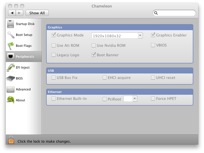

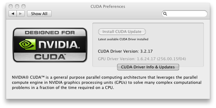

hmorris48 Posted January 20, 2011 Share Posted January 20, 2011 Since you're on a desktop and your should have a open slot for a graphics card, (from the hp specs for your system)Integrated graphics using Intel GMA 3100*Integrated video is not available if a graphics card is installed Integrated graphics using Intel GMA 3100 Also supports PCI Express x16 graphics cards* I would go with a any of the newer nvidia card. I using a GeForce 9600 GT 512MB card on 10.6.5 with the lastest nvidia drivers and CUDA drivers without any problems with all the heavy lifting being done by the Chameleon boot loader. Just turn on the Graphics Enabler in you com.apple.Boot.plist and let the lizard do a the dirty work. My /Extra/com.apple.Boot.plist: <?xml version="1.0" encoding="UTF-8"?> <!DOCTYPE plist PUBLIC "-//Apple//DTD PLIST 1.0//EN" "http://www.apple.com/DTDs/PropertyList-1.0.dtd"> <plist version="1.0"> <dict> <key>GenerateCStates</key> <string>Yes</string> <key>GeneratePStates</key> <string>Yes</string> <key>Graphics Mode</key> <string>1920x1080x32</string> <key>GraphicsEnabler</key> <string>Yes</string> <key>Instant Menu</key> <string>Yes</string> <key>Kernel</key> <string>mach_kernel</string> <key>Kernel Flags</key> <string></string> <key>SMBIOSdefaults</key> <string>No</string> <key>Theme</key> <string>Default</string> </dict> </plist> Quote Link to comment https://www.insanelymac.com/forum/topic/243611-how-do-i-get-quartz-extreme-to-work-on-my-hackintosh/#findComment-1625970 Share on other sites More sharing options...
