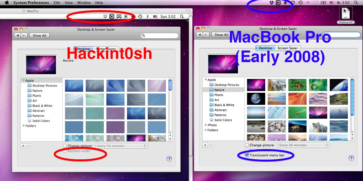

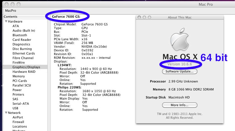

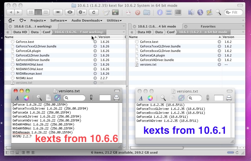

v_g Posted January 16, 2011 Share Posted January 16, 2011 Just install 10.6.6 combo. Blue screen, no mouse (Graphic Adapter: nVidia GeForce 7600 GS) So, i decide to replace some kexts from 10.6.1 and got display working: GeForce 1.6.2.35 (18.6.5f11) GeForce7xxxGLDriver 1.6.2.35 (18.6.5f11) GeForce8xxxGLDriver 1.6.2.35 (18.6.5f11) GeForceGA 1.6.2.35 (18.6.5f11) GeForceVADriver 1.6.2.35 (18.6.5f11) But i can't get "translucent menu bar" working. May be you know how to fix it. [..I didn't keep any graphics\video kexts on Chameleon boot volume (external flash drive) like NVInject...] Screenshots: Quote Link to comment https://www.insanelymac.com/forum/topic/243598-1066-post-installation-experience-and-tips/#findComment-1623630 Share on other sites More sharing options...

Gringo Vermelho Posted January 16, 2011 Share Posted January 16, 2011 Just install 10.6.6 combo. Blue screen, no mouse (Graphic Adapter: nVidia GeForce 7600 GS) You must boot boot in 32-bit kernel and drivers mode, there is no full 64-bit driver for the 7x00 series since 10.6.2. Quote Link to comment https://www.insanelymac.com/forum/topic/243598-1066-post-installation-experience-and-tips/#findComment-1623826 Share on other sites More sharing options...
