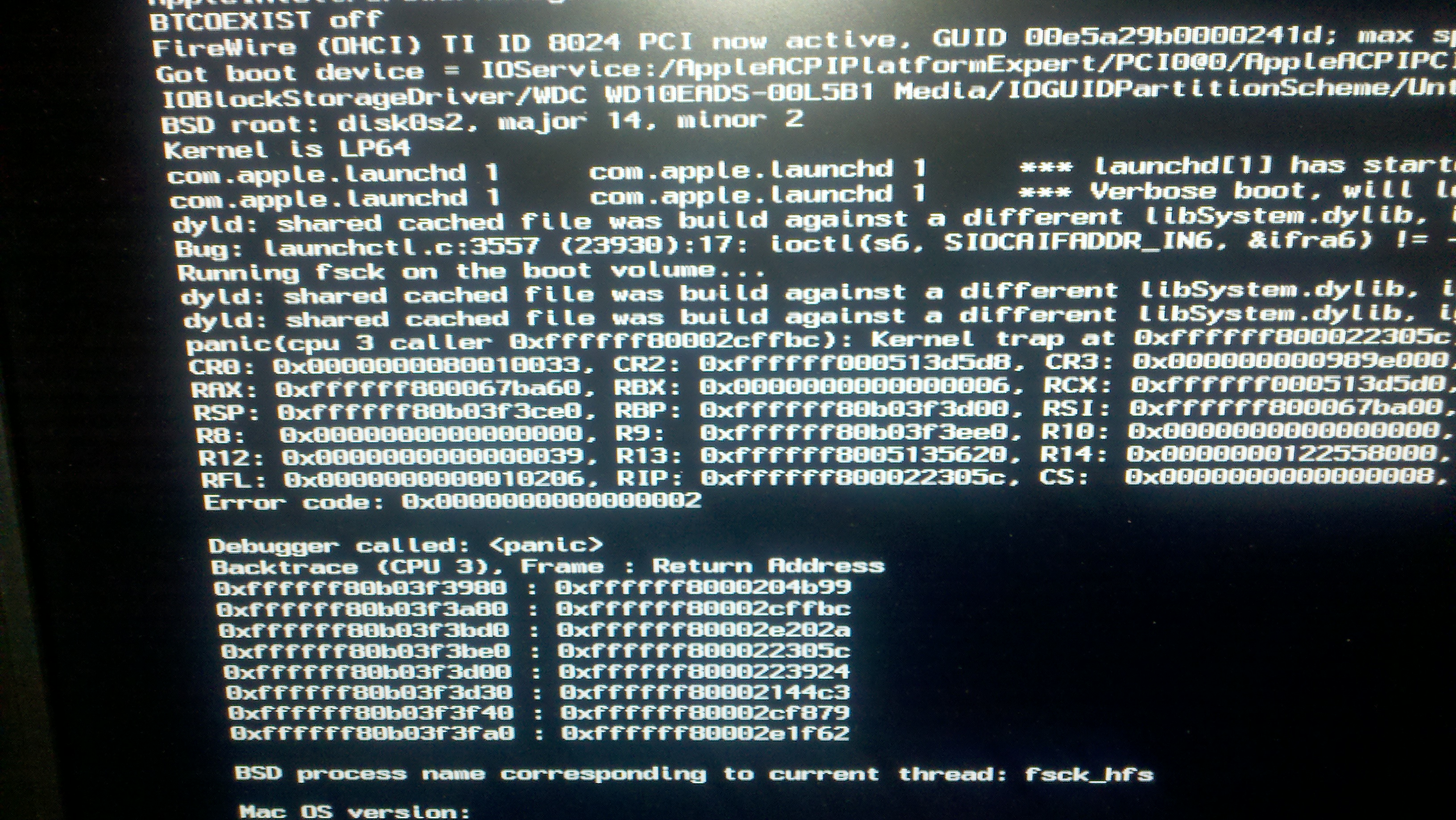

ElShotte Posted January 8, 2011 Share Posted January 8, 2011 You're getting a Kernel panic. What hardware are you using? I am assuming since you built it with compliant hardware you installed Snow Leo retail? Here's the next thing, this won't fix the problem, just give us more details about it. Instead of booting with the -x flag, boot with the -v flag, the v stands for verbose. It will show you everything that the computer is loading and hopefully the root of the problem. If you have a digital camera or a cellphone, I'd recommend taking a picture of the screen. Link to comment https://www.insanelymac.com/forum/topic/242212-1066-hackintosh-lifehacker-guide-you-need-to-restart-your-computer/#findComment-1618260 Share on other sites More sharing options...
MacUser2525 Posted January 8, 2011 Share Posted January 8, 2011 i will go try that now. Ok, i tried that and a bar came up under the wheel and apple logo, got to about 10% and then got the dark grey screen and prompt to restart again. Thank you so much for taking the time to help me troubleshoot this. Does not sound like you used the F8 key during it loading to get to the Chameleon boot prompt (text based not graphical) where you would enter that -x. Also you may want to consider either making a signature with all the hardware in your machine or post it in the thread so we know what is in the system. Link to comment https://www.insanelymac.com/forum/topic/242212-1066-hackintosh-lifehacker-guide-you-need-to-restart-your-computer/#findComment-1618266 Share on other sites More sharing options...

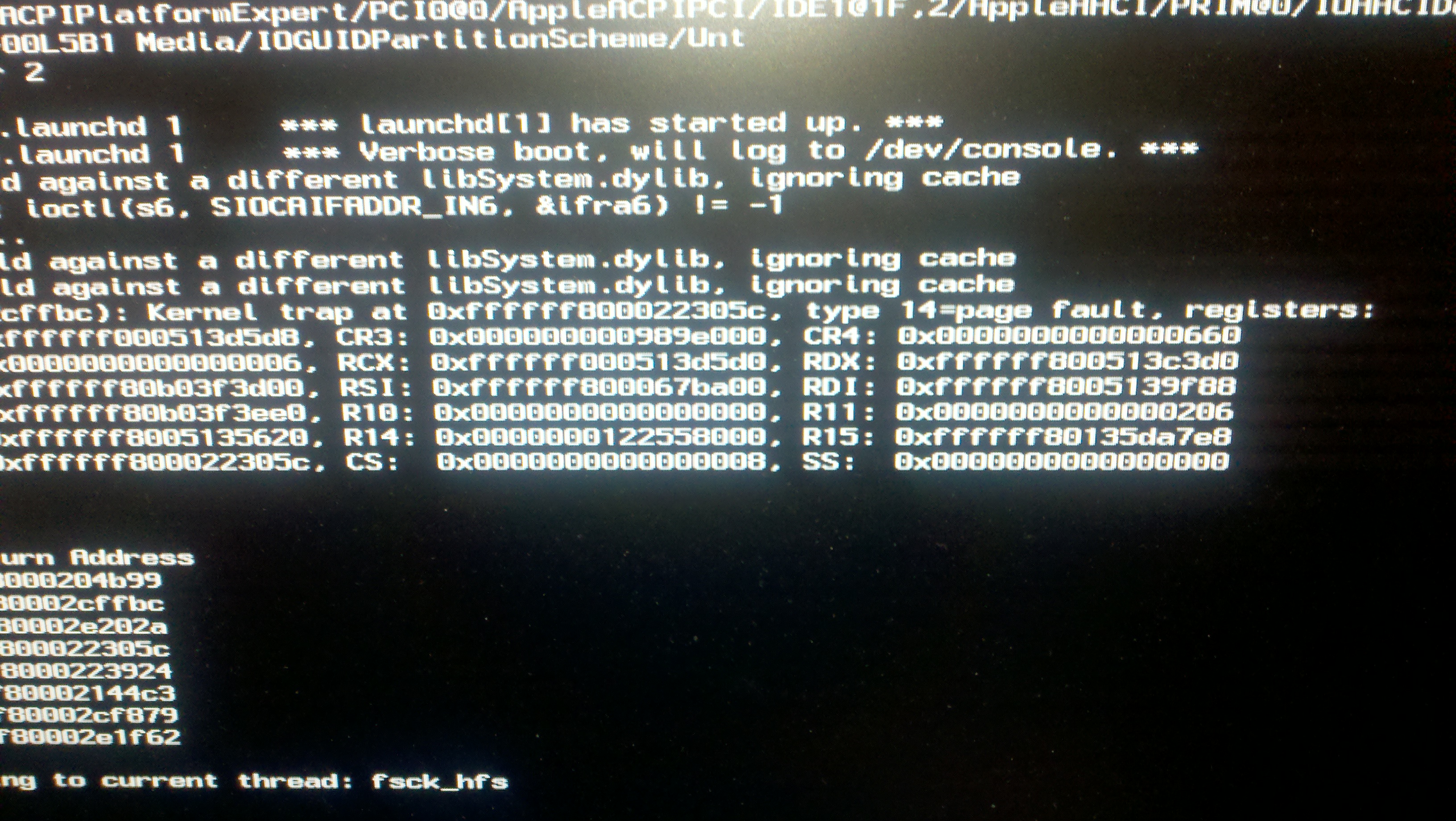

U J Posted January 9, 2011 Share Posted January 9, 2011 Thanks... I will check that out, but I wouldn't know how to fix anything once I got back in. I will wait for analysis from people who requested the pics of the verbose. thanks! Did u remove the sleepenabler.kext from the system/library/extensions before upgrading it to 10.6.6 ..because many people are having kernel panic due to that kext not being removed !! lemme know..and the pic that u posted wasnt clear for me..can u just take a pic of the last screen that gets stuck in the verbose mode !!! Link to comment https://www.insanelymac.com/forum/topic/242212-1066-hackintosh-lifehacker-guide-you-need-to-restart-your-computer/#findComment-1618601 Share on other sites More sharing options...
Charlie97L Posted January 9, 2011 Author Share Posted January 9, 2011 Did u remove the sleepenabler.kext from the system/library/extensions before upgrading it to 10.6.6 ..because many people are having kernel panic due to that kext not being removed !! lemme know..and the pic that u posted wasnt clear for me..can u just take a pic of the last screen that gets stuck in the verbose mode !!! no, i don't think i did. is there anyway to fix that easily? i can take some more pictures. Link to comment https://www.insanelymac.com/forum/topic/242212-1066-hackintosh-lifehacker-guide-you-need-to-restart-your-computer/#findComment-1619048 Share on other sites More sharing options...
MacUser2525 Posted January 10, 2011 Share Posted January 10, 2011 no, i don't think i did. is there anyway to fix that easily? i can take some more pictures. Some what that Life Hacker method has you using boot cd + retail install disk does it not or at least a distro installer dvd? If so then you can boot the retail disk using it the in the Utilities menu you will see at the top of screen select Terminal or if distro open in there. Once it opens use something like this. rm -r /Volumes/Install_Name/Extra/Extensions/sleepenabler.kext Changing the path/name.kext to the correct one for your install once you have removed it you would need to rebuild the cache if in /Extra directory with similar to this. kextcache -v 1 -a i386 -a x86_64 -m /Volumes/Install_Name/Extra/Extensions.mkext /Volumes/Install_Name/Extra/Extensions Again changing to your situation if it was in the /System/Library/Extensions then. touch /Volumes/Install_Name/System/Library/Extensions Reboot and hopefully it works now if not post a picture of it failing. Link to comment https://www.insanelymac.com/forum/topic/242212-1066-hackintosh-lifehacker-guide-you-need-to-restart-your-computer/#findComment-1619142 Share on other sites More sharing options...
