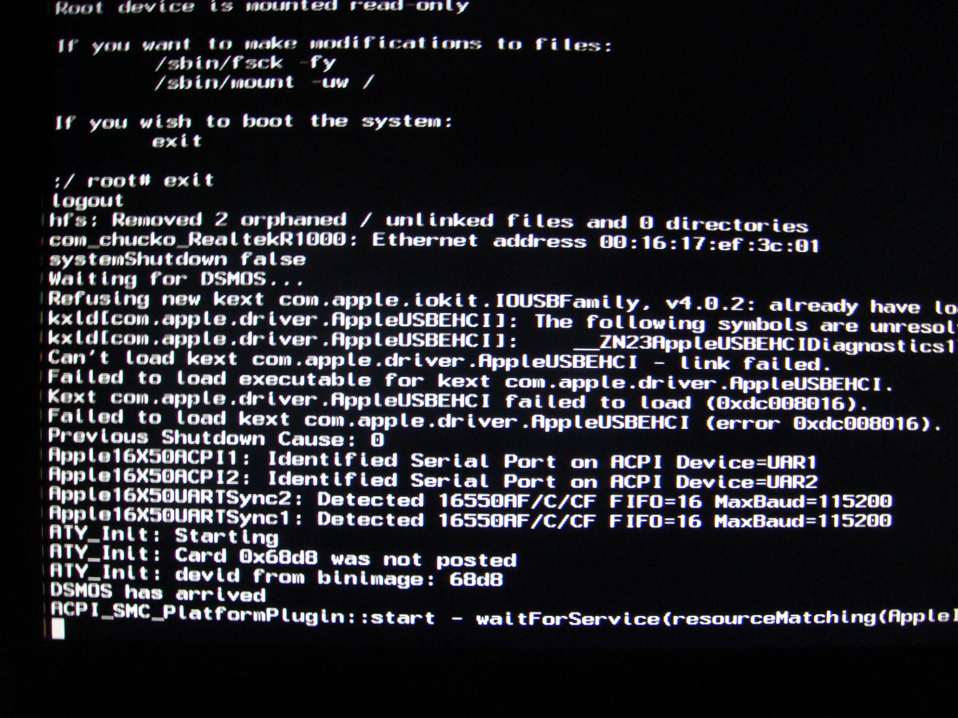

OK. now after i reboot the 1st time the bootloader works but right before i get into the GUI the screen goes black. I know its loading cause my drive is blinking but no screen.
Here is the last thing i see before it blacks out.
By the way i dont know if it matters but i have iATKOS S3 10.6.3 upgraded to 10.6.4
Wrong framebuffer in ATY_init most likely. The ATY_Init provided here uses Eulemur as far as i remember but for my ASUS 5670 1GB only Baboon works fine. That or doucle check if you installed all kexts in the correct order...
