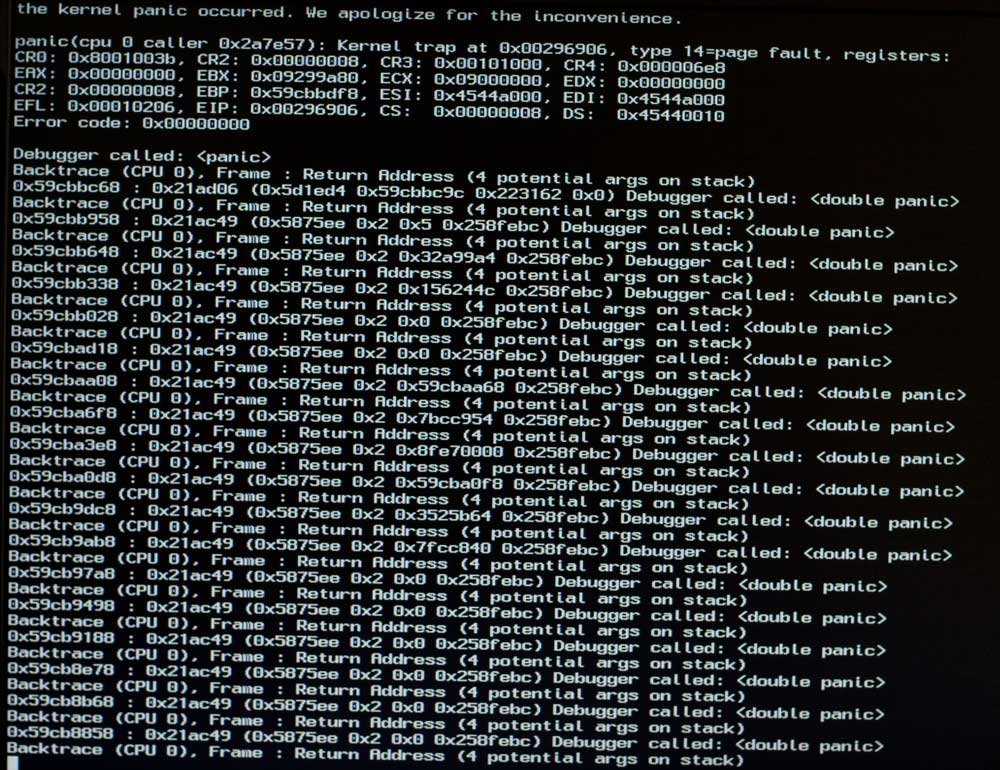

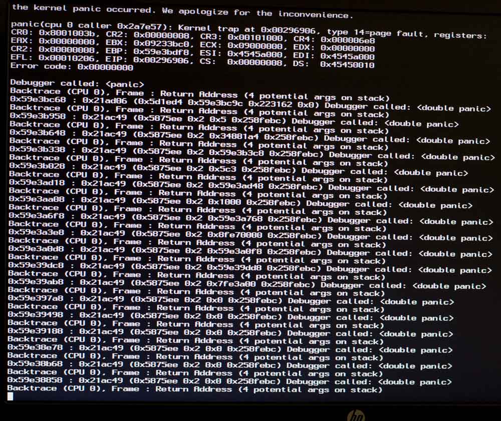

lol actually, the messages you posted doesn't help at all, what will help is where the "various messages" part. :rolleyes:
grab a camera, take a pic of the screen with the kernel panic and post it here.
Share this post
Link to post

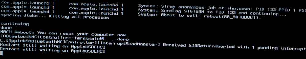

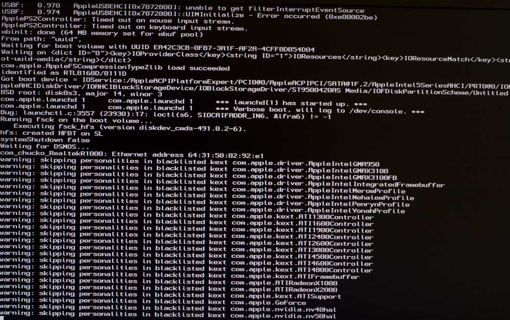

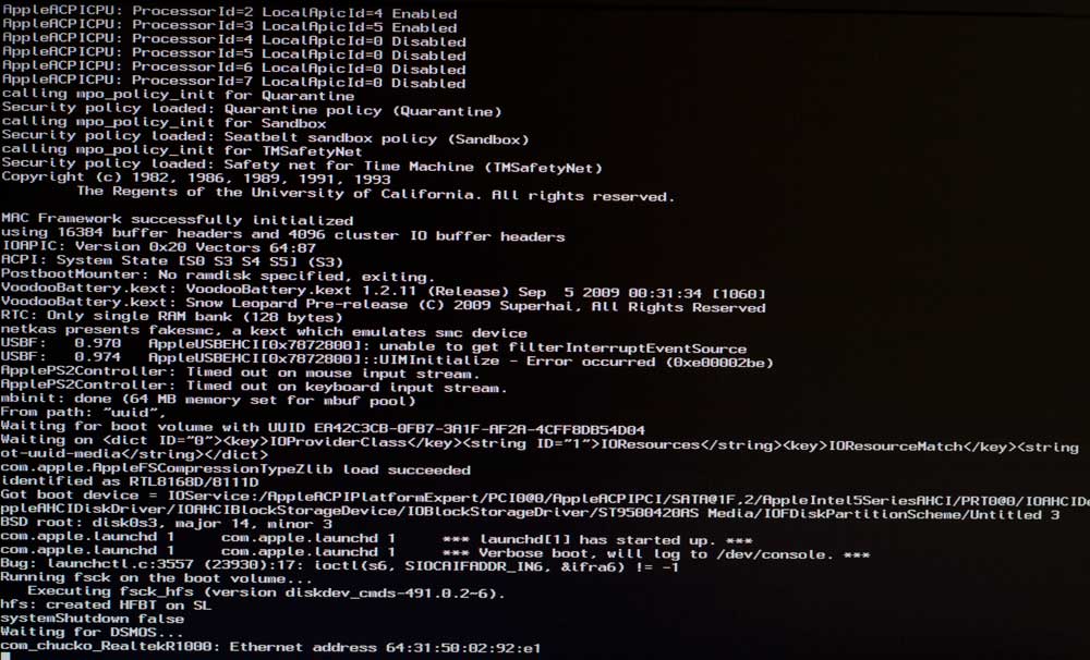

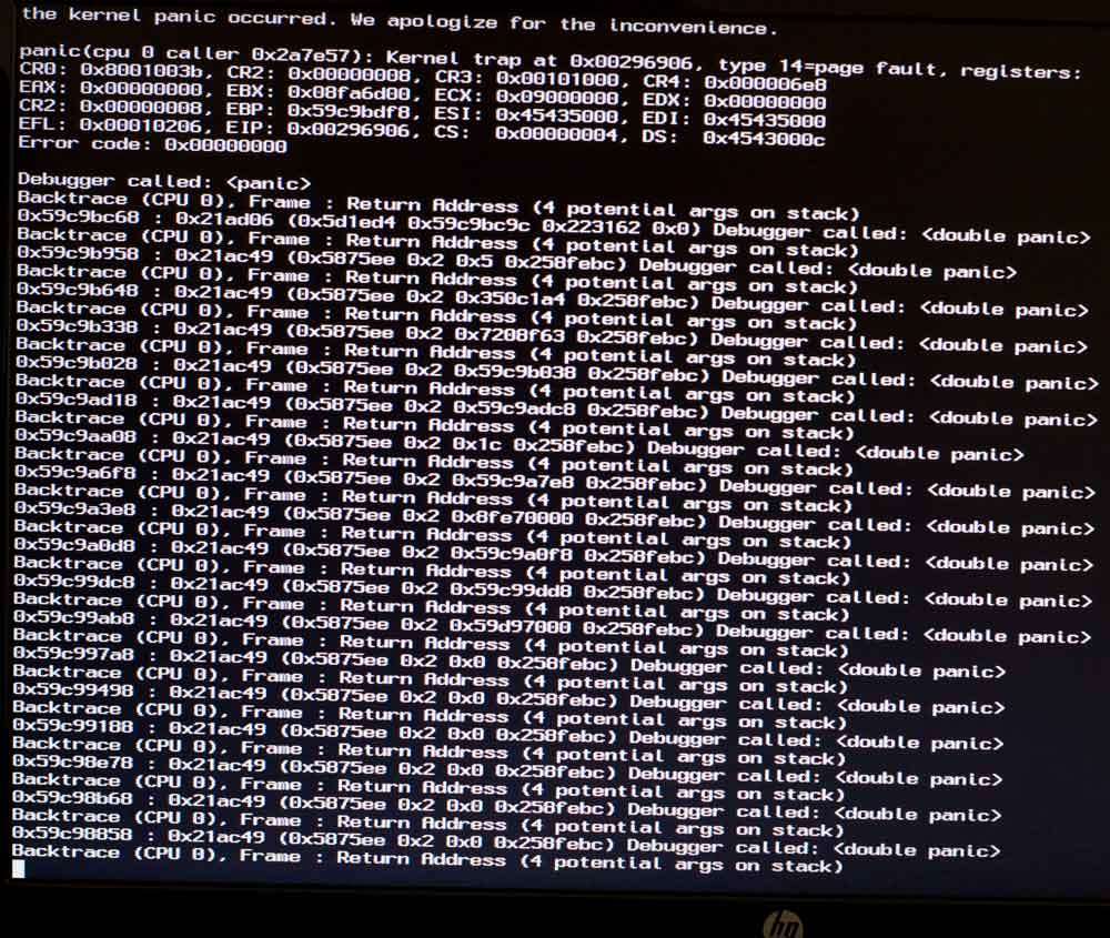

thanks guys again.. Please see the pics as attached. Pic are named according to the boot flag used while booting up.
First of all I am well aware of the Busratio site
http://3rr0rists.com/macintosh/busratio-fo...processors.html and know very well that my processor is not included there. Hence I tried various busratios while installing SL from iATKOS S3 v2 and only this bootflag installs SL successfully...
-v arch=i386 busratio=17
Share this post
Link to post

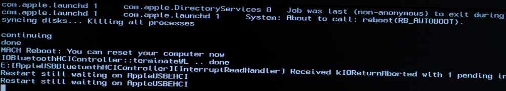

Hi All..I have reinstalled SL again but this time I took pics step by step. Still same issues but thought these pics might help you guys to assist me better.
Basically I installed SL with this Bootflag:
And when the Installation finished I rebooted my laptop with nawcom modcd.
Then selected my SL Harddrive and bootup with this Bootflag:
-v -f arch=i386 busratio=17
Following screen messages are attached as well. Pics are marked from 1-13 (as it happened).

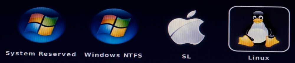

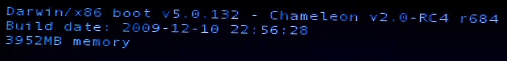

Still not solved..but I have done couple more things now..I have fresh installed Ubuntu 10.10 now and GRUB bootloader is installed the in Ubuntu Installation directory e.g. /dev/sd5/ (and not at the root).
Now when I boot up, my laptop first boot up with Chameleon Bootloader RC4..then I press anykey and it goes to the next screen to show different OS in the Laptop..I choose Linux and Grub boot loader comes up and then I can choose different OS to boot up from.
Ubuntu and win7 is working however Mac OS (SL) not working. I tried both 32bit and 64bit options for SL (in the GRUB bootloader). None works. Pics are numbered as my computer is booting up.

Why don't you try the latest Chameleon RC5 trunk...i don't remember which but the latest trunk of course. got no problem so far. I just reinstall few days ago after some graphic driver {censored} up my SL. and using the same method except now i'm using Chameleon v2 RC5.

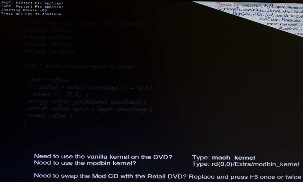

Insert the nawcom ModCD and boot up your laptop (obviously you need to select in BIOS for the laptop to boot from DVD drive. When the laptop boots up this is how the screen will look like.
Take out nawcom ModCD and insert iAtkos S3 10.6.3 ver.2 DVD. Wait for 30 secs and press F5. Your screen will look like this:
Use the arrow key to select iATKOS DVD and then type the following:

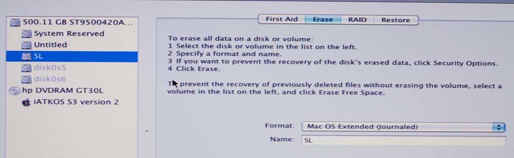

You now need to pepare a partition to install SL..
Choose Disc Utility under Utilities
Prepare your partition as shown in these pics..

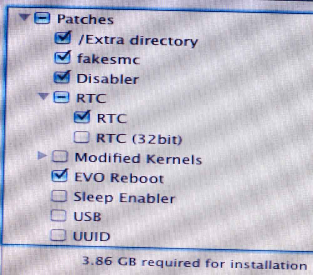

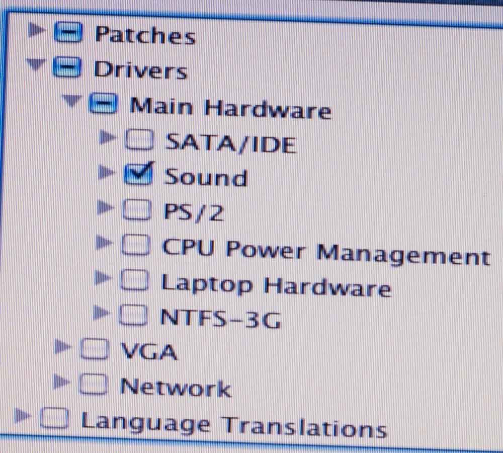

Now you need to customize the SL installation..Click customize button as shown..
see different options I had chosen:
I have used Chameleon Bootloader..you can use either version.

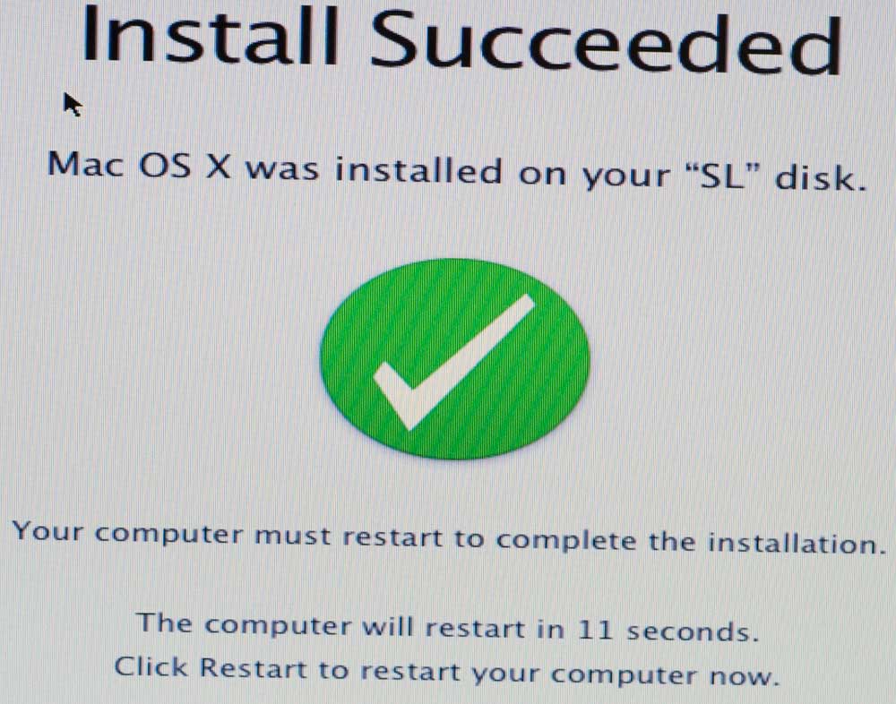

Once ok..SL will install in this laptop

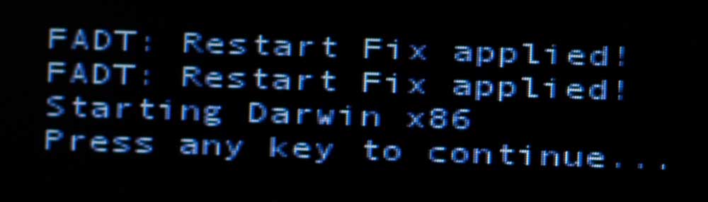

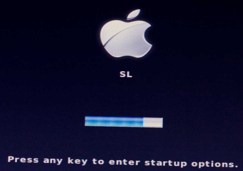

When the laptop restarts you will see this screen..
Press any key
Yes..my laptop is triple boot..Win7, Ubuntu and Snow Leopard.
You choose your SL drive and must type busratio=18
And now your laptop is booting SL for the first time
