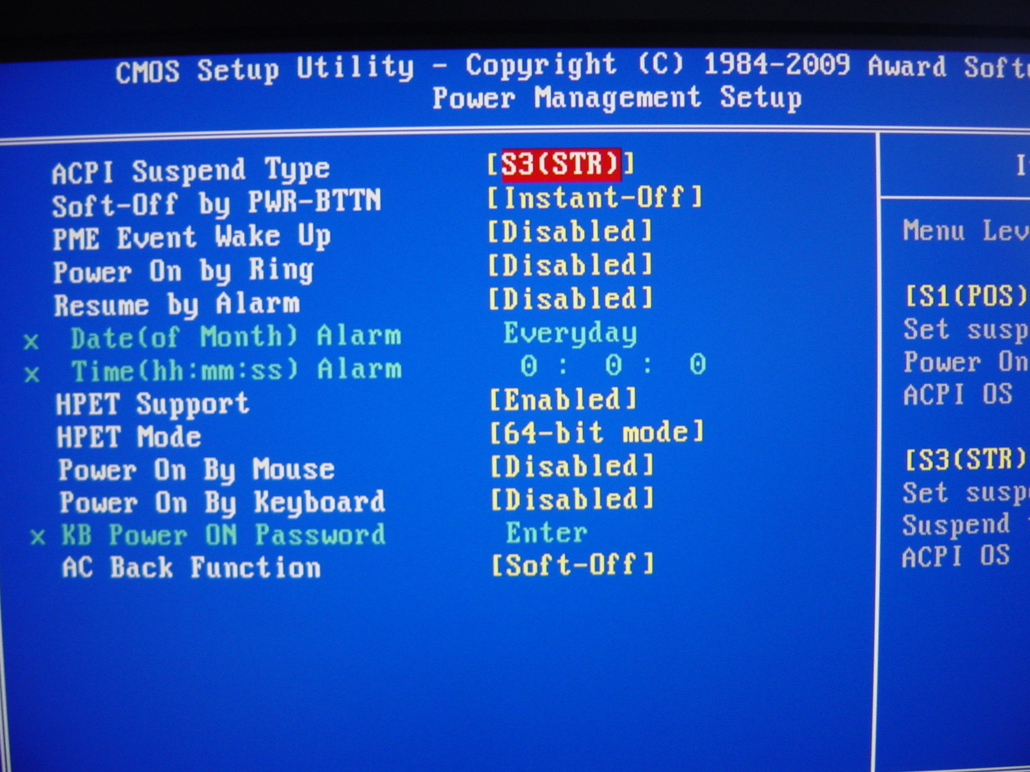

RemoteWorks Posted November 19, 2010 Share Posted November 19, 2010 Hi there, I hope you can help me. If I want my Hackintosh to sleep, he closes the eyes, but then he instantly wakes up again and shows the loginscreen. Do you have any Idea? My System: Gigabyte GA-P35C-DS3R Ati Sapphire 4850 512MB Snow Leopward 10.6.5 Thank you! could be a bios setting > see picture for reference (different board, but should look similar) RW Link to comment https://www.insanelymac.com/forum/topic/237667-solved-doesnt-sleep-instant-wake-up/#findComment-1587510 Share on other sites More sharing options...
seltsam23 Posted November 20, 2010 Author Share Posted November 20, 2010 Thank you for your post, but I've similar bios-settings already. Any other ideas? Link to comment https://www.insanelymac.com/forum/topic/237667-solved-doesnt-sleep-instant-wake-up/#findComment-1587568 Share on other sites More sharing options...
