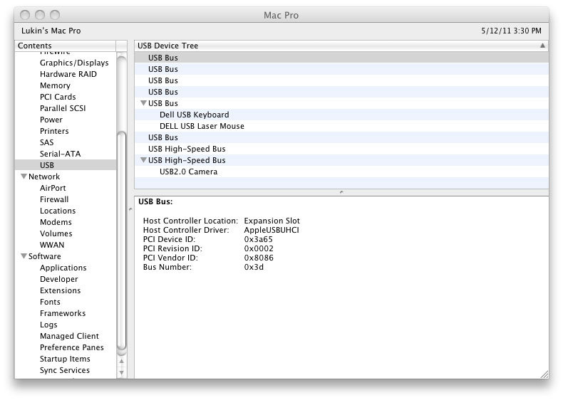

lukin Posted May 12, 2011 Share Posted May 12, 2011 Hi MaldOn... Lukin again, my system is Dell Optiplex 780 Desktop. chipset North Bridge Intel Eaglelake Q45 South Bridge Intel 82801JDO ICH10DO when I applied your last dsdt, i noticed under USB bus it says Expansion Slot....Shouldn`t it be BUILT-IN. maybe that could fix my wake from sleep problem? what do you think? Link to comment https://www.insanelymac.com/forum/topic/235523-dsdt-auto-patcher/page/134/#findComment-1682707 Share on other sites More sharing options...

lukin Posted May 12, 2011 Share Posted May 12, 2011 So Sorry MaldOn! Use Wait=Yes Where do i edit THAT....what file? Link to comment https://www.insanelymac.com/forum/topic/235523-dsdt-auto-patcher/page/134/#findComment-1682771 Share on other sites More sharing options...
MaLd0n Posted May 12, 2011 Author Share Posted May 12, 2011 So Sorry MaldOn! Use Wait=Yes Where do i edit THAT....what file? see if the DSDT being read Wait=Yes in boot screen Link to comment https://www.insanelymac.com/forum/topic/235523-dsdt-auto-patcher/page/134/#findComment-1682779 Share on other sites More sharing options...
lukin Posted May 12, 2011 Share Posted May 12, 2011 see if the DSDT being read Wait=Yes in boot screen I applied it and the system booted just fine but USB Bus still comes out as Expansion Slot under system profiler... how can i check if the DSDT is READ properly....i don`t see anything happening on WAIT=yes... Link to comment https://www.insanelymac.com/forum/topic/235523-dsdt-auto-patcher/page/134/#findComment-1682815 Share on other sites More sharing options...

MaLd0n Posted May 12, 2011 Author Share Posted May 12, 2011 I applied it and the system booted just fine but USB Bus still comes out as Expansion Slot under system profiler...how can i check if the DSDT is READ properly....i don`t see anything happening on WAIT=yes... use it http://www.insanelymac.com/forum/index.php...st&id=92954 reboot after reboot run on terminal perl -e 'open(CMD, "ioreg -lw0 \| grep DSDT|") or die; while(<CMD>) { chomp; if($_ =~ /\"DSDT\.?\d?\"=<([^>]*)>/) { $buff = $1; open(PIP, "|xxd -r -p > ~/Desktop/dsdt.aml") or die; print PIP "$1"; } }' send me the DSDT that will be generated on the desktop USE DSDT IN FOLDER EXTRA or ROOT of the HD Machine info: HP DV6-6001sg (Germany) -- DSDT needed Bios F06 HM 65 (B2 windows says, B3 HP site says) i7 2630qm 4gb Ram Ati 6770m 1gb Audio: in progress Wlan: in progress Lan: in progress send me files Link to comment https://www.insanelymac.com/forum/topic/235523-dsdt-auto-patcher/page/134/#findComment-1682822 Share on other sites More sharing options...
lukin Posted May 12, 2011 Share Posted May 12, 2011 O.K. Here you go! file attached just to make sure i should use the DSDT generated on the desktop (with your terminal-command) in the Extra folder, right? dsdt.aml.zip Link to comment https://www.insanelymac.com/forum/topic/235523-dsdt-auto-patcher/page/134/#findComment-1682839 Share on other sites More sharing options...

MaLd0n Posted May 12, 2011 Author Share Posted May 12, 2011 O.K. Here you go! file attached just to make sure i should use the DSDT generated on the desktop (with your terminal-command) in the Extra folder, right? the command will extract the DSDT in use dsdt.lukin_02.zip use only one DSDT or root or in extra is this it, so i only need to put this dsdt.aml into the extra folder ?or do i need to patch it with the dv6 i patch package (2 txt files ... patch.txt + ....txt) ? patch for nehalem your notebook is sandy bridge dsdt.roger8ds.zip Link to comment https://www.insanelymac.com/forum/topic/235523-dsdt-auto-patcher/page/134/#findComment-1682852 Share on other sites More sharing options...
lukin Posted May 12, 2011 Share Posted May 12, 2011 the command will extract the DSDT in use dsdt.lukin_02.zip use only one DSDT or root or in extra This time USB bus shows up as BUILT-IN under system profiler. so i guess this is good, but when i put the system to sleep with the power button, and if click on the mouse or the keyboard the system wakes up but BLACK SCREEN like on standby. weird!!! Link to comment https://www.insanelymac.com/forum/topic/235523-dsdt-auto-patcher/page/134/#findComment-1682863 Share on other sites More sharing options...
