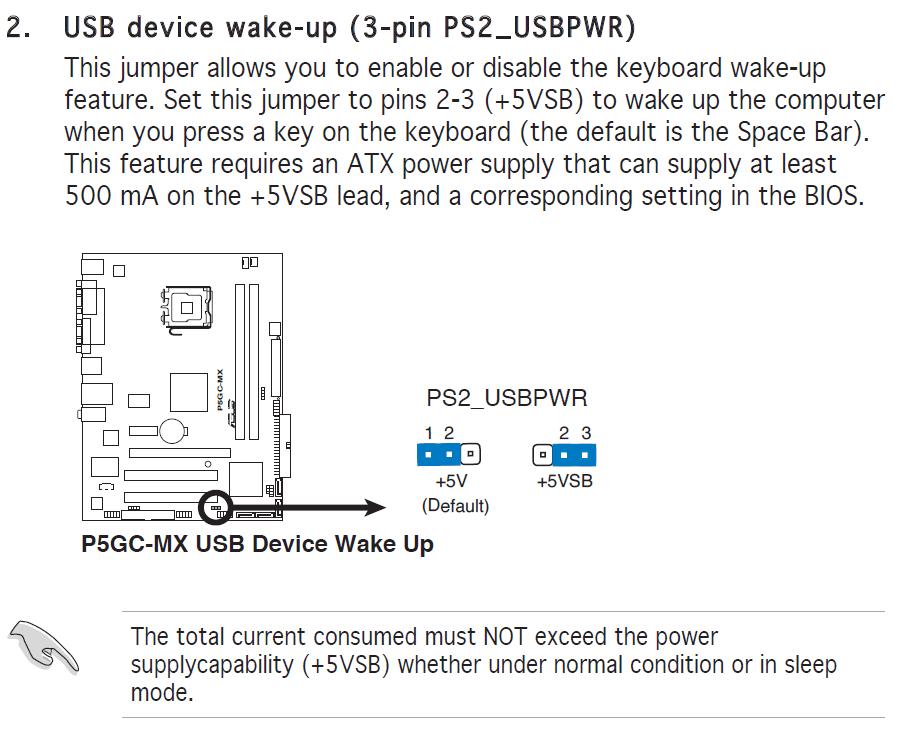

MaLd0n Posted May 10, 2011 Author Share Posted May 10, 2011 Wake from sleep is not working....my computer goes to sleep just fine but never wakes up!!! that you've said I wonder what happens the screen is black? etc. Link to comment https://www.insanelymac.com/forum/topic/235523-dsdt-auto-patcher/page/133/#findComment-1681727 Share on other sites More sharing options...
lukin Posted May 10, 2011 Share Posted May 10, 2011 that you've saidI wonder what happens the screen is black? etc. yes, yes...sorry MaldOn, i didn`t get you...when i power my computer after sleep, i hear the cpu fan running and my router lights up but the screen like you said is just black like on standby mode or something. Link to comment https://www.insanelymac.com/forum/topic/235523-dsdt-auto-patcher/page/133/#findComment-1681735 Share on other sites More sharing options...
MaLd0n Posted May 10, 2011 Author Share Posted May 10, 2011 yes, yes...sorry MaldOn, i didn`t get you...when i power my computer after sleep, i hear the cpu fan running and my router lights up but the screen like you said is just black like on standby mode or something. this problem happens in some cases with Asus motherboards I do not know a solution to this I did some testing etc. and can not resolve Some users have resolved this way Link to comment https://www.insanelymac.com/forum/topic/235523-dsdt-auto-patcher/page/133/#findComment-1681745 Share on other sites More sharing options...
lukin Posted May 10, 2011 Share Posted May 10, 2011 O.K. MaldOn....i get it now thx so much for everything. i`m not good at electronics, no idea what that illustration wants me to hack into, what a bummer!!! Link to comment https://www.insanelymac.com/forum/topic/235523-dsdt-auto-patcher/page/133/#findComment-1681756 Share on other sites More sharing options...
MaLd0n Posted May 10, 2011 Author Share Posted May 10, 2011 O.K. MaldOn....i get it now thx so much for everything. i`m not good at electronics, no idea what that illustration wants me to hack into, what a bummer!!! what model of motherboard and chipset? Link to comment https://www.insanelymac.com/forum/topic/235523-dsdt-auto-patcher/page/133/#findComment-1681758 Share on other sites More sharing options...

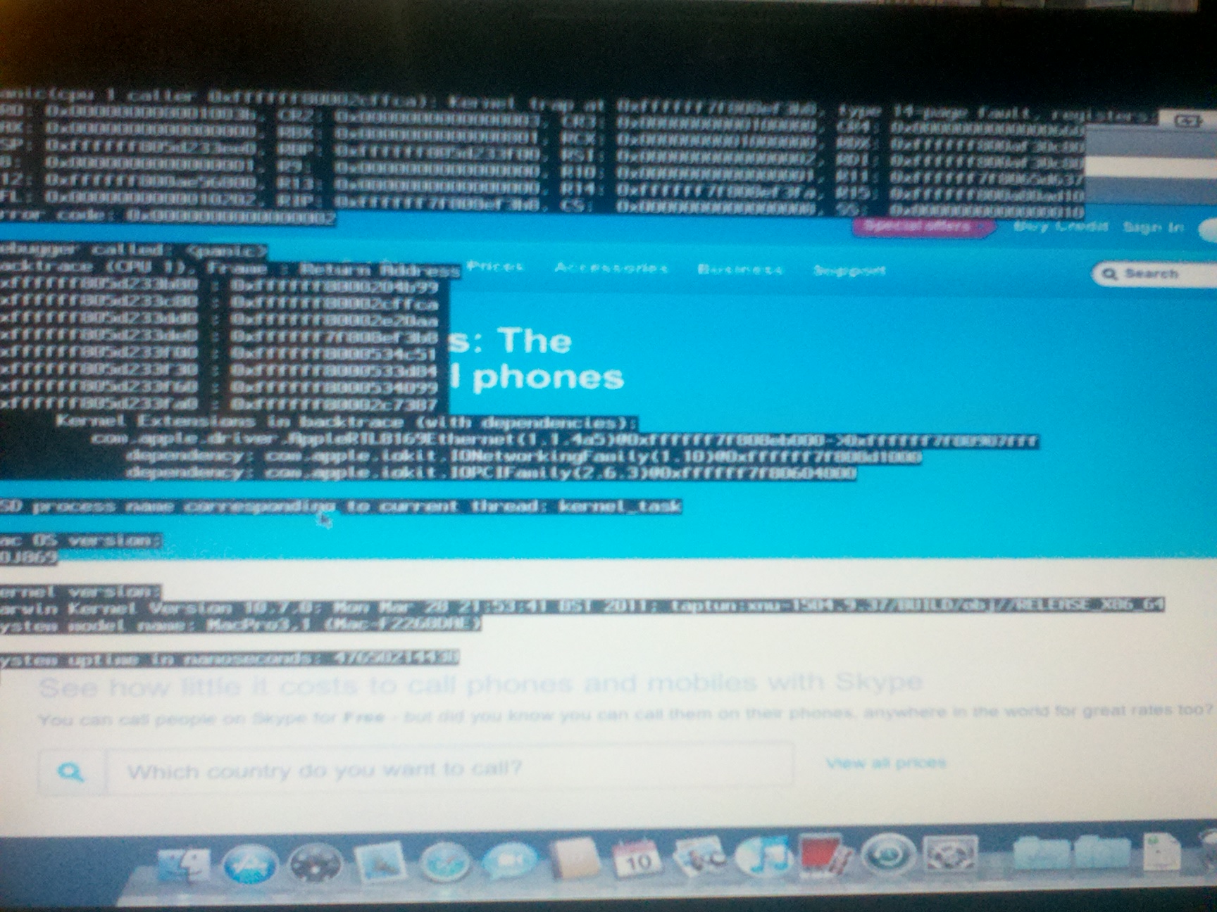

eramoscas Posted May 10, 2011 Share Posted May 10, 2011 Thanks again. I did create the folder and added to it the dsdt you sent me. However when I run the Rtl2Mac program the ethernet works for a few minutes and then a panic happens ... please see the attachment... Any suggestions ??? What Am I ding wrong ?? Please help .... Obrigado create Link to comment https://www.insanelymac.com/forum/topic/235523-dsdt-auto-patcher/page/133/#findComment-1681941 Share on other sites More sharing options...
MaLd0n Posted May 10, 2011 Author Share Posted May 10, 2011 Thanks again. I did create the folder and added to it the dsdt you sent me.However when I run the Rtl2Mac program the ethernet works for a few minutes and then a panic happens ... please see the attachment... Any suggestions ??? What Am I ding wrong ?? Please help .... Obrigado remove AppleRTL8169EEthernet Link to comment https://www.insanelymac.com/forum/topic/235523-dsdt-auto-patcher/page/133/#findComment-1681948 Share on other sites More sharing options...
eramoscas Posted May 11, 2011 Share Posted May 11, 2011 ... sorry .... from where ??? remove AppleRTL8169EEthernet Link to comment https://www.insanelymac.com/forum/topic/235523-dsdt-auto-patcher/page/133/#findComment-1681999 Share on other sites More sharing options...
MaLd0n Posted May 11, 2011 Author Share Posted May 11, 2011 ... sorry .... from where ??? System/Library/Extensions/IONetworkingFamily.kext/Contents/PlugIns/AppleRTL8169Ethernet.kext Link to comment https://www.insanelymac.com/forum/topic/235523-dsdt-auto-patcher/page/133/#findComment-1682003 Share on other sites More sharing options...
eramoscas Posted May 11, 2011 Share Posted May 11, 2011 Thank you ... System/Library/Extensions/IONetworkingFamily.kext/Contents/PlugIns/AppleRTL8169Ethernet.kext Done .... now i can not connect to the internet ... ethernet does not get ip address ... any idea ?? System/Library/Extensions/IONetworkingFamily.kext/Contents/PlugIns/AppleRTL8169Ethernet.kext Link to comment https://www.insanelymac.com/forum/topic/235523-dsdt-auto-patcher/page/133/#findComment-1682007 Share on other sites More sharing options...
MaLd0n Posted May 11, 2011 Author Share Posted May 11, 2011 Thank you ...Done .... now i can not connect to the internet ... ethernet does not get ip address ... any idea ?? http://lnx2mac.blogspot.com/p/realtekrtl81xx-osx-driver.html Link to comment https://www.insanelymac.com/forum/topic/235523-dsdt-auto-patcher/page/133/#findComment-1682009 Share on other sites More sharing options...
eramoscas Posted May 11, 2011 Share Posted May 11, 2011 going to try .... thanks http://lnx2mac.blogspot.com/p/realtekrtl81xx-osx-driver.html Link to comment https://www.insanelymac.com/forum/topic/235523-dsdt-auto-patcher/page/133/#findComment-1682010 Share on other sites More sharing options...
