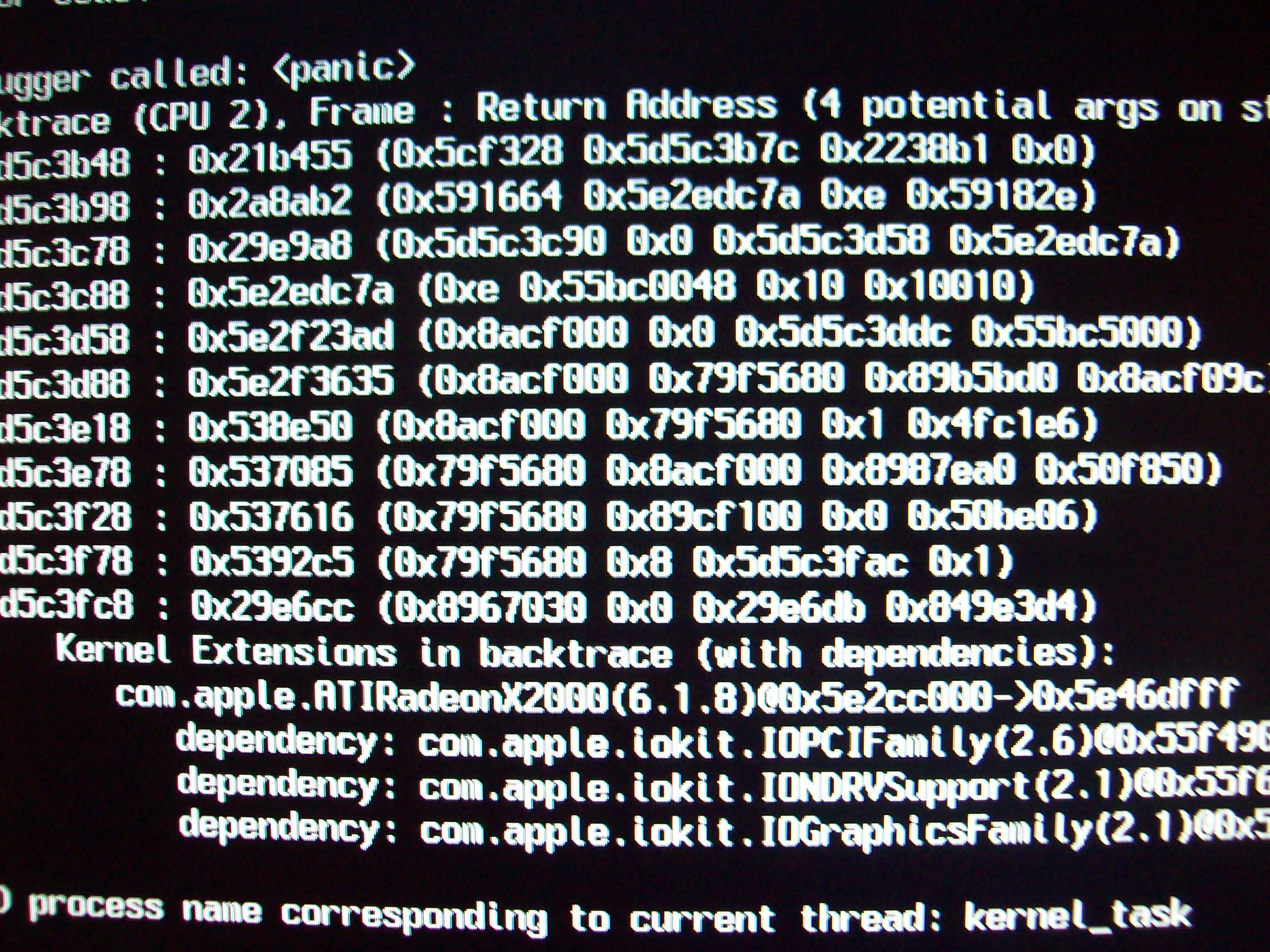

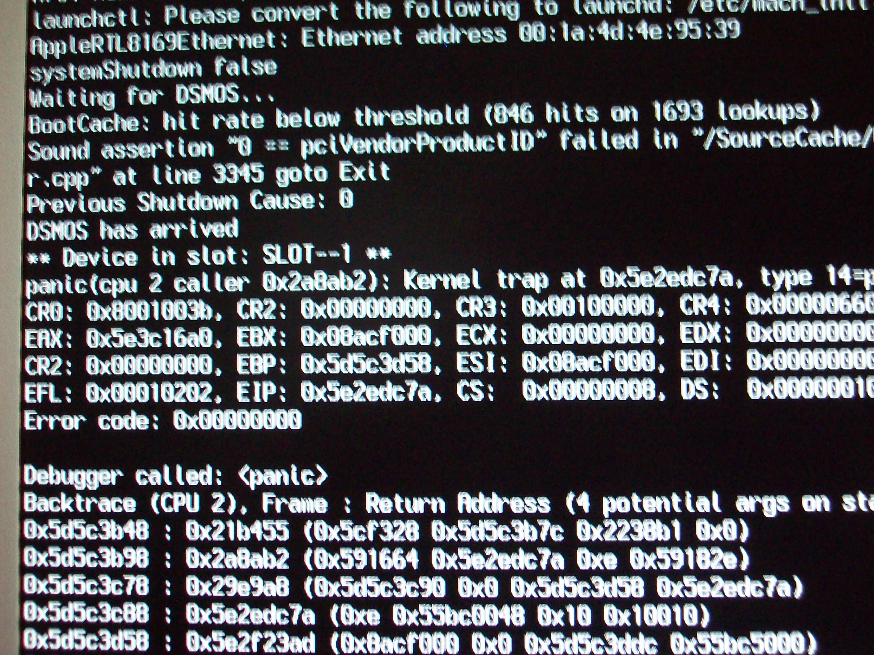

Krillinballz Posted September 23, 2010 Author Share Posted September 23, 2010 i dont know what the hell im doing worng i mean i was handed pre-working kext files and bootloader but im still stuck on atiradeonx2000.kext kernel panic. here are the screen shots Link to comment https://www.insanelymac.com/forum/topic/231482-ati-hd-4650-and-mac-os-x-retil-snow-leopard-1064/#findComment-1553152 Share on other sites More sharing options...
Krillinballz Posted September 23, 2010 Author Share Posted September 23, 2010 Ok i booted in safe mode i used kextutility to install all the new kext i got from mr.errandwolfe which he was more then wonderful with all the help i got from him. Well i got the kext installed with no kernel panic but now my screen goes black after the os boots up. any ideas. Link to comment https://www.insanelymac.com/forum/topic/231482-ati-hd-4650-and-mac-os-x-retil-snow-leopard-1064/#findComment-1553417 Share on other sites More sharing options...
errandwolfe Posted September 23, 2010 Share Posted September 23, 2010 Ok i booted in safe mode i used kextutility to install all the new kext i got from mr.errandwolfe which he was more then wonderful with all the help i got from him. Well i got the kext installed with no kernel panic but now my screen goes black after the os boots up. any ideas. Krillin, what cable config are you using to attach your monitors? I am using DVI to VGA convertor on the DVI port and VGA on VGA port. The DVI port then gives me working video and the VGA boots up to black screen on GUI load. If I try to go straight DVI from the DVI port then I get both screens black. So if you are using straight out DVI that could be your issue. Link to comment https://www.insanelymac.com/forum/topic/231482-ati-hd-4650-and-mac-os-x-retil-snow-leopard-1064/#findComment-1553429 Share on other sites More sharing options...
