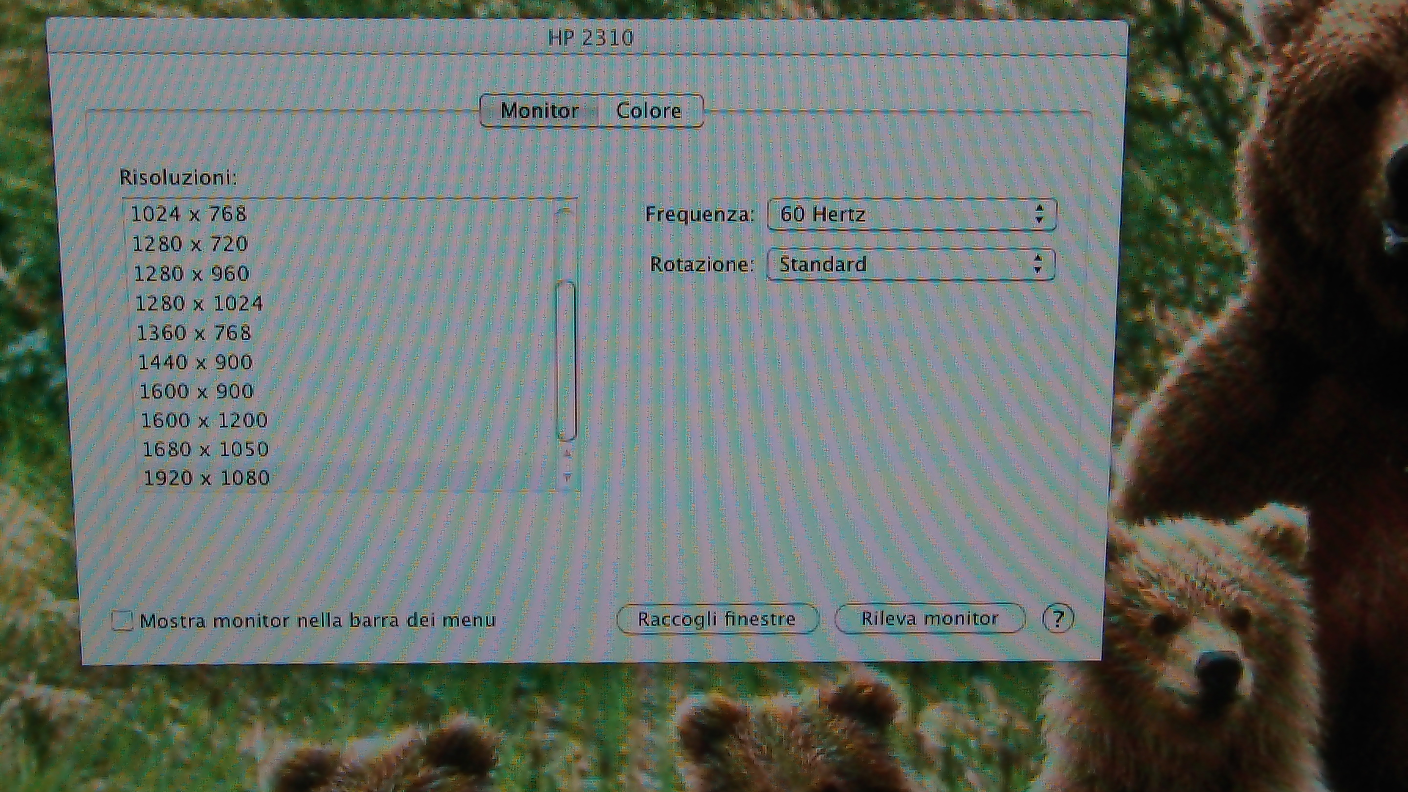

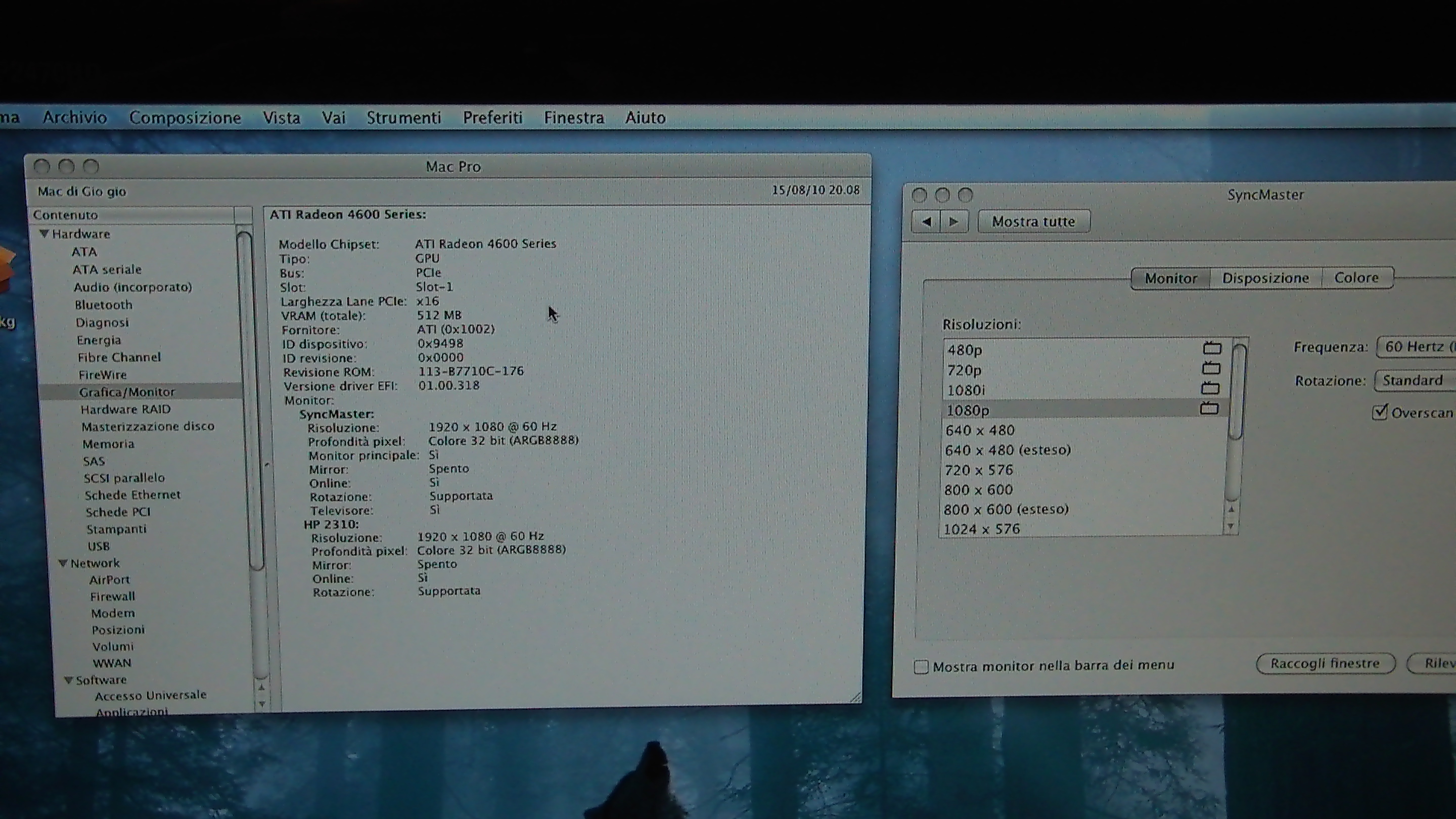

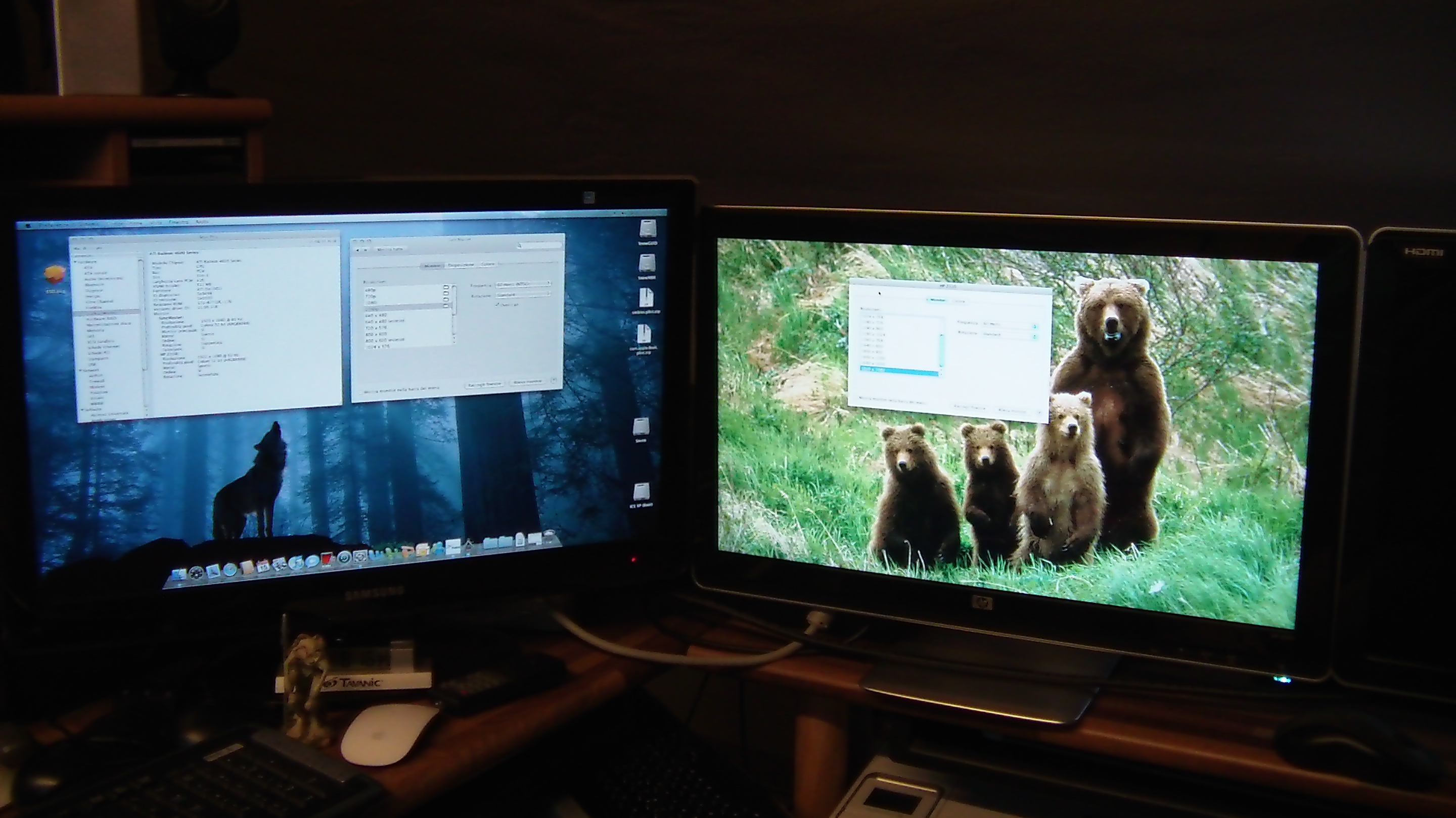

Hardware: Asrock Conroe 1333-D667 CPU Intel E6600 3GB RAM 800 DDR2, Graphic Card Asus EAH4650/DI/512MD2 0x94981002 with 3 outputs: HDMI, DVI, VGA
Monitor 1: Samsung Syncmaster P2470HD with HDMI link (HDMI works only if also VGA output is linked)
Monitor 2 HP 2310i with VGA link (or DVI output with DVI-VGA adapter)

Thanks for the screen shot, I feel better knowing now beyond a doubt that someone does have this working. Two things I notice that differ between your screens and mine.
1.) Memory - You have 512 I have 1 Gb
2.) Your display list actually lists the brand/model of your monitors. Mine simply says "Display" and then for the second monitor "Display Connector"
Displays:
Display:
Resolution: 1280 x 1024 @ 75 Hz
Pixel Depth: 32-Bit Color (ARGB8888)
Main Display: Yes
Mirror: Off
Online: Yes
Rotation: Supported
Display Connector:
Status: No Display Connected
Can you please verify you are using Chameleon RC4 and not another modified distro like AserteBLN? At this point I am running totally out of ideas as to why you can get it to work and others can't. My final thought is that it may be a difference in architecture between 512 and 1 Gb cards but that seems like a long shot.

I use chameleon 2.0 RC4 non modified.
In my opinion the difference in RAM amount can be the problem (but i don't understand why)

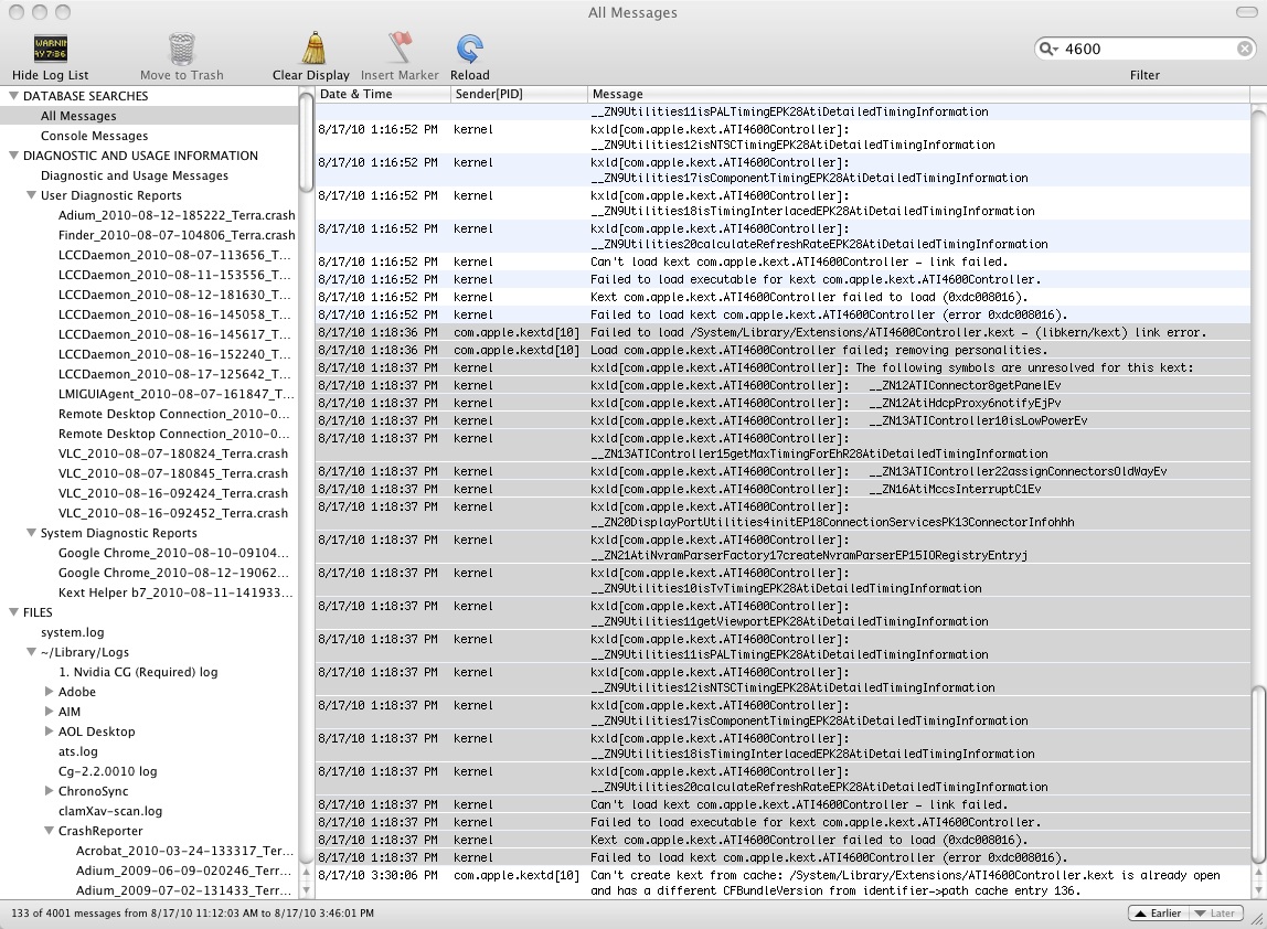

Just an update, went back and checked some of my logs....
It looks like when I was using Chameleon RC4 and PC-EFI 10.6 the reason I was getting the KPs was the 4600Controller kext was failing to load, kicking out the following errors.
