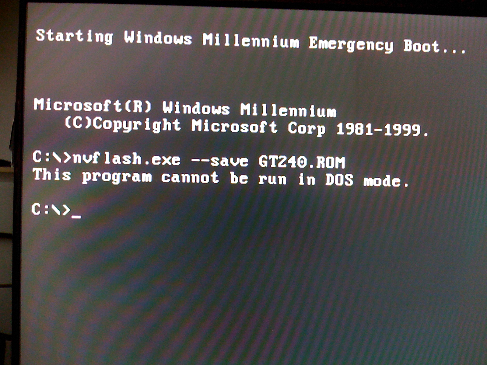

Plucka Posted July 22, 2010 Author Share Posted July 22, 2010 Hey WallyFTW Have been trying your method but I get stuck at step 5 I get an error stating that this command cannot be carried out in DOS? I get C:\> then I enter nvflash.exe --save GT240.ROM See pic for error? Any ideas mate? Cheers, Plucka 1 Link to comment Share on other sites More sharing options...
WallyFTW Posted July 22, 2010 Share Posted July 22, 2010 Whoops I think that's my bad. Try the nvflash.exe located in this download. Link to comment Share on other sites More sharing options...

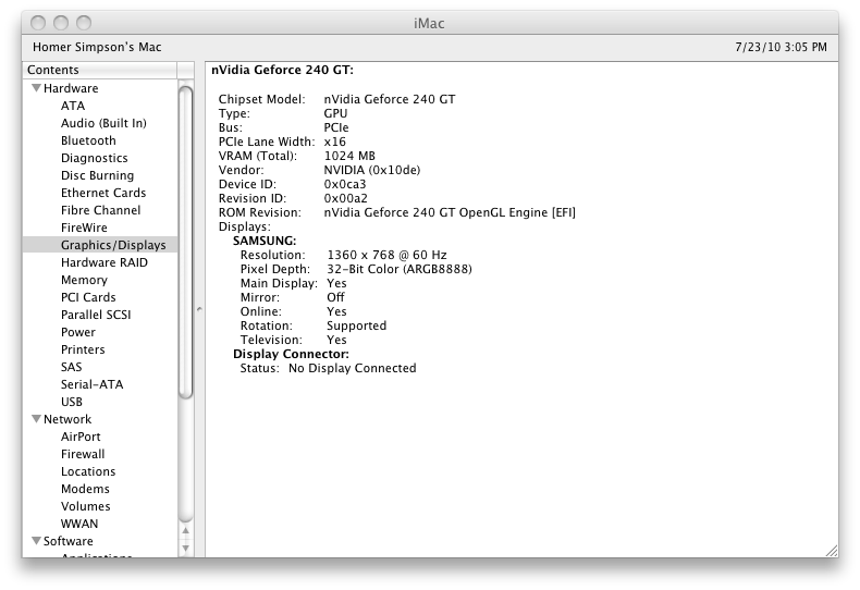

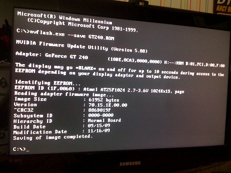

Plucka Posted July 23, 2010 Author Share Posted July 23, 2010 Hey WallyFTW, Succes, thank you very very much for your help and patience your new link worked a treat, and here are the pics to show it. It all worked properly and my only mistake was thinking I had a 512 mb card, as it showed up in windows as a 1024 mb card. So I installed it in windows using the official nVidia drivers for this card and in adapter info it showed 1024 mb. Anyway I hope this helps some other people as well, if anyone has this card and needs the efi string info give WallyFTW's method a go. Once again thank you ever so much and have a great day, afternoon, night, cheers mate, Plucka 1 Link to comment Share on other sites More sharing options...
