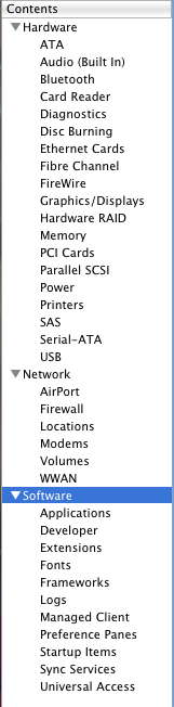

effatum Posted December 23, 2010 Author Share Posted December 23, 2010 ok rather than clicking on one of the submenus click on "software" that will answer my question and i have already removed the carpet, changed the thermal gel and all yet i still overheat from time to time (playin wow etc.) i have to keep the backside lifted when i dont it overheats. i guess the next think would be putting a bronze pad between the heatsink and the gpu... and maybe a grill in the middle if i can fix it correctly without wielding...etc. lol good that wwan sets did the job i'll try the controllermate but i don't think i'll mingle with it much, i'm happy with how it works for now. i have rc3 if i am not mistaken, on the other computer i run rc5, no difference at all oh an not to brag, but i'm postin a screenshot xD oh and btw could you run a geekbench and see your score? on 64bit Link to comment https://www.insanelymac.com/forum/topic/223470-guide-how-to-install-snow-leopard-vanilla-on-xps-m1530-detailed-walkthrough/page/2/#findComment-1607742 Share on other sites More sharing options...

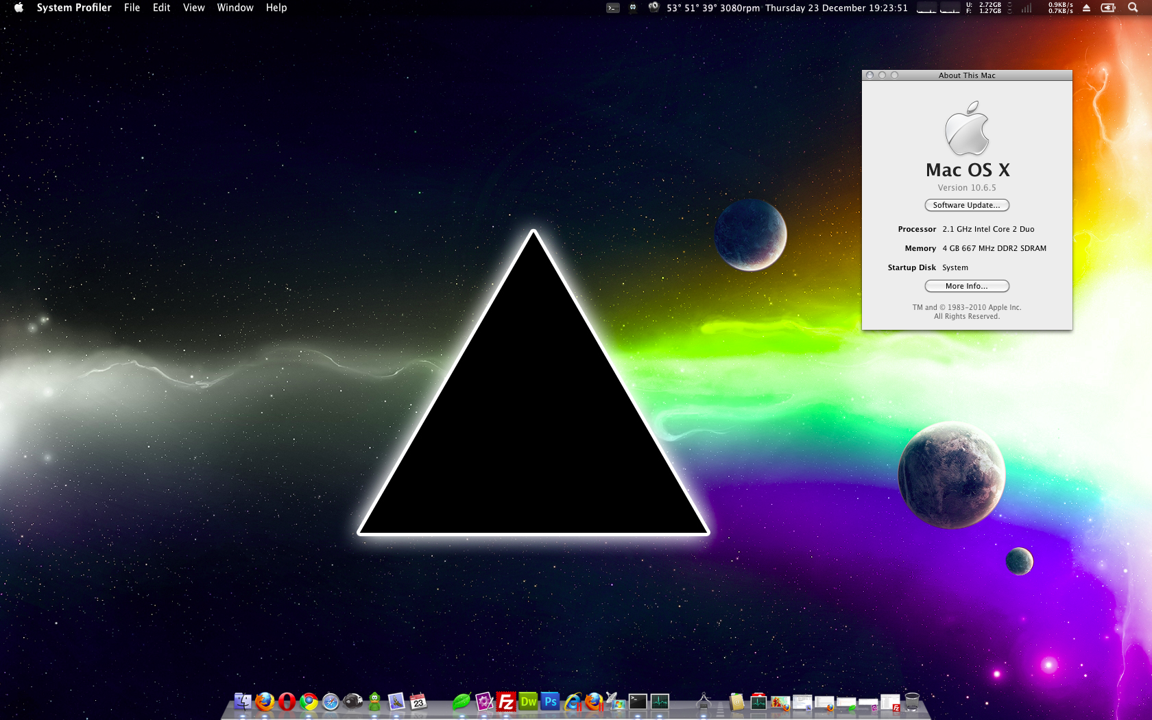

devtone Posted December 23, 2010 Share Posted December 23, 2010 Platform: Mac OS X x86 (64-bit) Compiler: GCC 4.0.1 (Apple Inc. build 5494) Operating System: Mac OS X 10.6.5 (Build 10H574) Model: MacBookPro5,1 Motherboard: Dell Inc. XPS M1530 Processor: Intel® Core™2 Duo CPU T8100 @ 2.10GHz Processor ID: GenuineIntel Family 6 Model 23 Stepping 6 Logical Processors: 2 Physical Processors: 1 Processor Frequency: 2.10 GHz L1 Instruction Cache: 32.0 KB L1 Data Cache: 32.0 KB L2 Cache: 3.00 MB L3 Cache: 0.00 B Bus Frequency: 800 MHz Memory: 4.00 GB Memory Type: 667 MHz DDR2 SDRAM SIMD: 1 BIOS: Apple Inc. MBP51.88Z.0074.B00.0810241236 Processor Model: Intel® Core™2 Duo CPU T8100 @ 2.10GHz Processor Cores: 2 Integer (Score: 2885) Blowfish single-threaded scalar -- 1366, , 60.0 MB/sec Blowfish multi-threaded scalar -- 2836, , 116.3 MB/sec Text Compress single-threaded scalar -- 1871, , 5.98 MB/sec Text Compress multi-threaded scalar -- 3496, , 11.5 MB/sec Text Decompress single-threaded scalar -- 1612, , 6.62 MB/sec Text Decompress multi-threaded scalar -- 3230, , 12.9 MB/sec Image Compress single-threaded scalar -- 1810, , 15.0 Mpixels/sec Image Compress multi-threaded scalar -- 3431, , 28.9 Mpixels/sec Image Decompress single-threaded scalar -- 1825, , 30.7 Mpixels/sec Image Decompress multi-threaded scalar -- 3450, , 56.3 Mpixels/sec Lua single-threaded scalar -- 3375, , 1.30 Mnodes/sec Lua multi-threaded scalar -- 6324, , 2.43 Mnodes/sec Floating Point (Score: 4511) Mandelbrot single-threaded scalar -- 1566, , 1.04 Gflops Mandelbrot multi-threaded scalar -- 3101, , 2.03 Gflops Dot Product single-threaded scalar -- 2837, , 1.37 Gflops Dot Product multi-threaded scalar -- 5874, , 2.68 Gflops Dot Product single-threaded vector -- 2203, , 2.64 Gflops Dot Product multi-threaded vector -- 4939, , 5.14 Gflops LU Decomposition single-threaded scalar -- 1221, , 1.09 Gflops LU Decomposition multi-threaded scalar -- 2295, , 2.01 Gflops Primality Test single-threaded scalar -- 3900, , 582.5 Mflops Primality Test multi-threaded scalar -- 6032, , 1.12 Gflops Sharpen Image single-threaded scalar -- 4429, , 10.3 Mpixels/sec Sharpen Image multi-threaded scalar -- 8589, , 19.8 Mpixels/sec Blur Image single-threaded scalar -- 5501, , 4.35 Mpixels/sec Blur Image multi-threaded scalar -- 10672, , 8.39 Mpixels/sec Memory (Score: 2350) Read Sequential single-threaded scalar -- 3188, , 3.90 GB/sec Write Sequential single-threaded scalar -- 2634, , 1.80 GB/sec Stdlib Allocate single-threaded scalar -- 2069, , 7.72 Mallocs/sec Stdlib Write single-threaded scalar -- 1840, , 3.81 GB/sec Stdlib Copy single-threaded scalar -- 2021, , 2.08 GB/sec Stream (Score: 1814) Stream Copy single-threaded scalar -- 1744, , 2.39 GB/sec Stream Copy single-threaded vector -- 1880, , 2.44 GB/sec Stream Scale single-threaded scalar -- 1741, , 2.26 GB/sec Stream Scale single-threaded vector -- 1898, , 2.56 GB/sec Stream Add single-threaded scalar -- 1788, , 2.70 GB/sec Stream Add single-threaded vector -- 1965, , 2.73 GB/sec Stream Triad single-threaded scalar -- 2055, , 2.84 GB/sec Stream Triad single-threaded vector -- 1448, , 2.71 GB/sec 600 less than yours! How did you get the calander on the left? and what does the orb on the right do? Link to comment https://www.insanelymac.com/forum/topic/223470-guide-how-to-install-snow-leopard-vanilla-on-xps-m1530-detailed-walkthrough/page/2/#findComment-1607800 Share on other sites More sharing options...
effatum Posted December 23, 2010 Author Share Posted December 23, 2010 wow nice xD and i have a t7500 xD the calendar on the left is a program called dateline, the orb thing to the right is called iPulse and it graphically gives the main infos from the activity monitor Link to comment https://www.insanelymac.com/forum/topic/223470-guide-how-to-install-snow-leopard-vanilla-on-xps-m1530-detailed-walkthrough/page/2/#findComment-1607851 Share on other sites More sharing options...

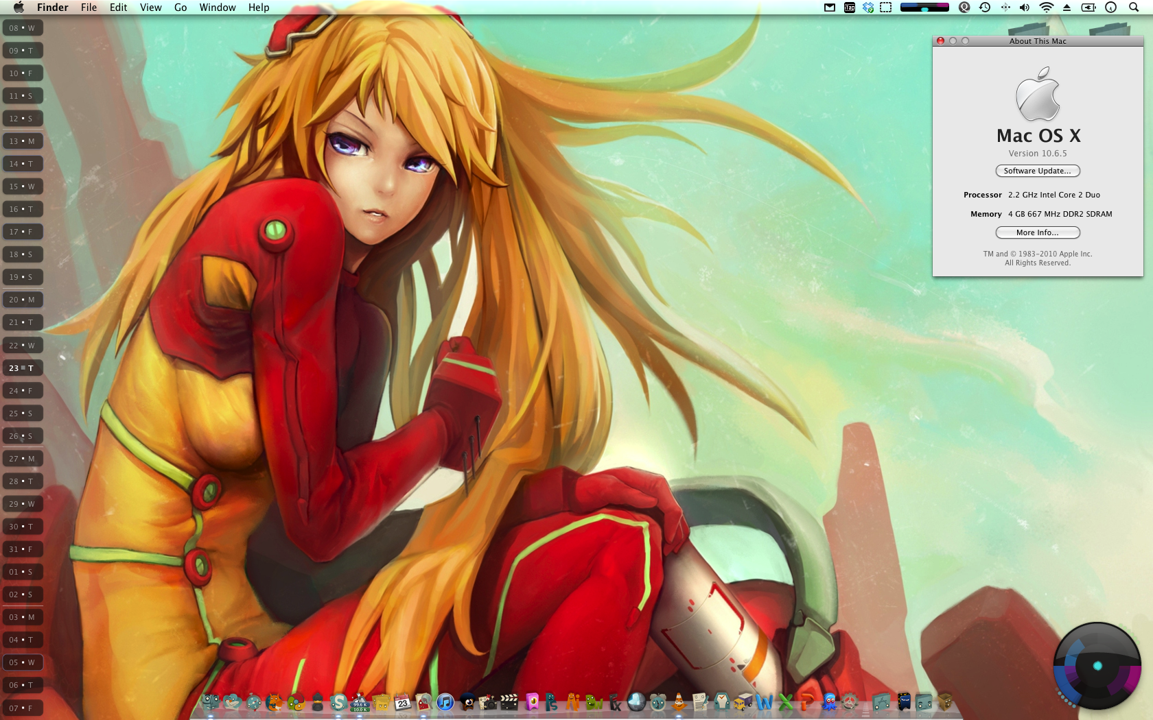

Vexir Posted December 24, 2010 Share Posted December 24, 2010 Devtone how did you get it to display all that information in the upper right hand corner? Link to comment https://www.insanelymac.com/forum/topic/223470-guide-how-to-install-snow-leopard-vanilla-on-xps-m1530-detailed-walkthrough/page/2/#findComment-1608000 Share on other sites More sharing options...
effatum Posted December 24, 2010 Author Share Posted December 24, 2010 istats on the right part, temp monitor on the left Link to comment https://www.insanelymac.com/forum/topic/223470-guide-how-to-install-snow-leopard-vanilla-on-xps-m1530-detailed-walkthrough/page/2/#findComment-1608114 Share on other sites More sharing options...

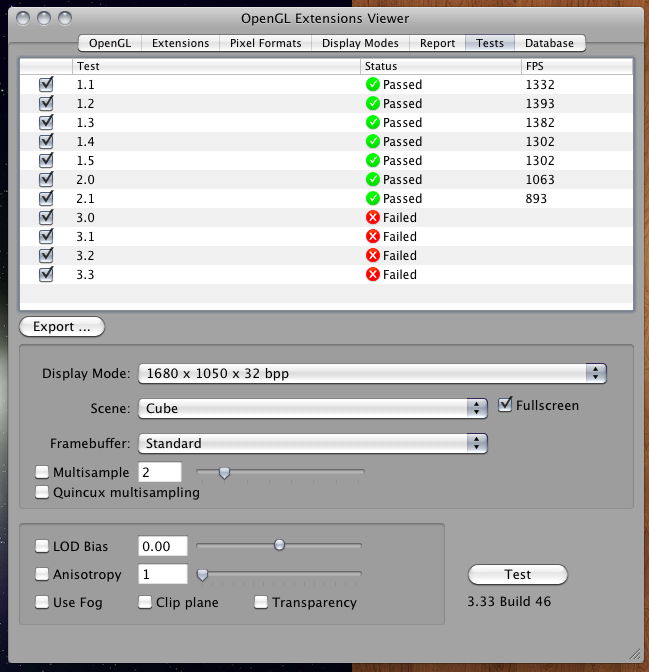

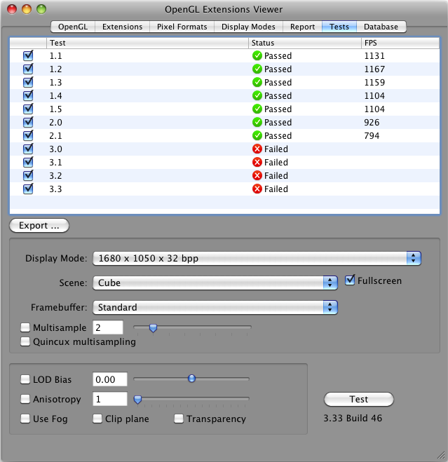

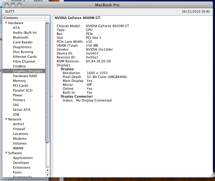

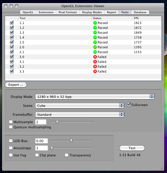

devtone Posted December 26, 2010 Share Posted December 26, 2010 After having a very high CPU usage when running Youtube I've tried installing other nVidia drivers. 1. The driver http://www.nvidia.com/object/quadro-macosx...a23-driver.html 2. Unpack it with Pacifist, dump the files in /S/L/E. 3. Repair rights. And what do you know Youtubevideo went from 50% (1 core) to about 20% CPU. The GPU went up to 45%. You can check the CPU GPU usage with atMonitor. Install CUDA to check the installed driver version in the panel. Ive also run the OpenGL Extensions Viewer tests.. Can anyone with the vanilla drivers run the test to compare? Link to comment https://www.insanelymac.com/forum/topic/223470-guide-how-to-install-snow-leopard-vanilla-on-xps-m1530-detailed-walkthrough/page/2/#findComment-1608989 Share on other sites More sharing options...
effatum Posted December 26, 2010 Author Share Posted December 26, 2010 don't see much of a difference... i'll try after activating quartz extreme will try it with your drivers as well do u have any problems with that? Link to comment https://www.insanelymac.com/forum/topic/223470-guide-how-to-install-snow-leopard-vanilla-on-xps-m1530-detailed-walkthrough/page/2/#findComment-1609119 Share on other sites More sharing options...
devtone Posted December 26, 2010 Share Posted December 26, 2010 don't see much of a difference... i'll try after activating quartz extremewill try it with your drivers as well do u have any problems with that? 200+ fps is not bad with a driver update only I'm not sure if I have QE running. The system profiler does not have the QE option. (Also normal with the new SystemProfiler) Quartz Extreme Check.app tells "Display 1 is accelerated" Also OSX86Tools can't enable\disable it with the following message; Can’t make "The domain/default pair of (com.apple.windowserver, QuartzGLEnabled) does not exist" into type boolean. (-1700) (this is normal) Running "defaults read /Library/Preferences/com.apple.windowserver GLCompositor" Outputs: { tileHeight = 256; tileWidth = 256; } Geekbench crashed during startup.. Frontrow does work just fine, Ive read somewhere that FR uses QE. Also my menubar is, as always, translucent. So QE is working just fine Link to comment https://www.insanelymac.com/forum/topic/223470-guide-how-to-install-snow-leopard-vanilla-on-xps-m1530-detailed-walkthrough/page/2/#findComment-1609167 Share on other sites More sharing options...
effatum Posted December 26, 2010 Author Share Posted December 26, 2010 200+ fps is not bad with a driver update only I'm not sure if I have QE running. The system profiler does not have the QE option. (Also normal with the new SystemProfiler) Quartz Extreme Check.app tells "Display 1 is accelerated" Also OSX86Tools can't enable\disable it with the following message; Can’t make "The domain/default pair of (com.apple.windowserver, QuartzGLEnabled) does not exist" into type boolean. (-1700) (this is normal) Running "defaults read /Library/Preferences/com.apple.windowserver GLCompositor" Outputs: { tileHeight = 256; tileWidth = 256; } Geekbench crashed during startup.. Frontrow does work just fine, Ive read somewhere that FR uses QE. Also my menubar is, as always, translucent. So QE is working just fine i had huge problems with the drivers, system crashed, returning to backup... hopefully it will work. btw which kexts did u use from the voodoo pkg? Link to comment https://www.insanelymac.com/forum/topic/223470-guide-how-to-install-snow-leopard-vanilla-on-xps-m1530-detailed-walkthrough/page/2/#findComment-1609184 Share on other sites More sharing options...
